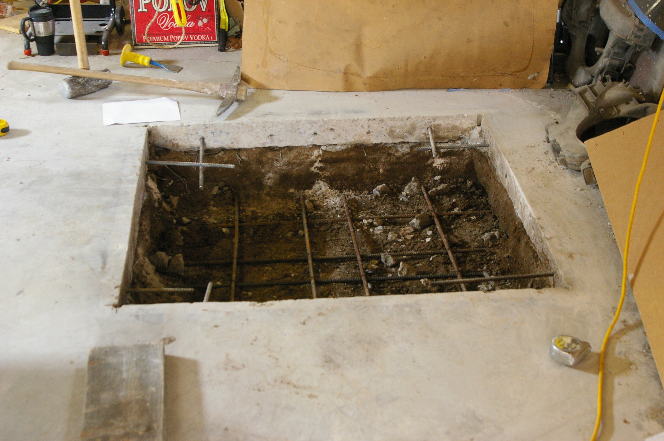

Did you have to reinforce/ rep our the garage floor to a deeper than standard floor slab to mount the lifts?. It looks like there is a different pour by the stands. How high can you get the car off the ground?
I only have a 9 foot ceiling in my garage, but I'd love to get a lift like this.

QUOTE(GeorgeRud @ Aug 2 2014, 12:41 PM) *
Yep, I cut out a 4' x 4' pad and dug it out to 10" deep and pinned it to the existing slab, poured 4000 psi concrete. About 48" lift
About 9' to the joists

QUOTE(rick 918-S @ Aug 3 2014, 05:48 AM) *
Nice Lift! Hey how's the back? I hope you weren't swinging that pick axe! (IMG:style_emoticons/default/unsure.gif)
No swinging the pick axe for me. All the cement work was done last May before I had my back surgery and I hired a contractor to do the cement pour. I waited about a month after the surgery before I did anything so I wouldn't mess the back up. Still not lifting anything more than about 20 lbs. (IMG:style_emoticons/default/hissyfit.gif)
This lift is "Cat's Ass" (IMG:style_emoticons/default/w00t.gif) I can sit in a low office chair and roll around under the car and have clear access to everything. Now I just need to do some actual work.

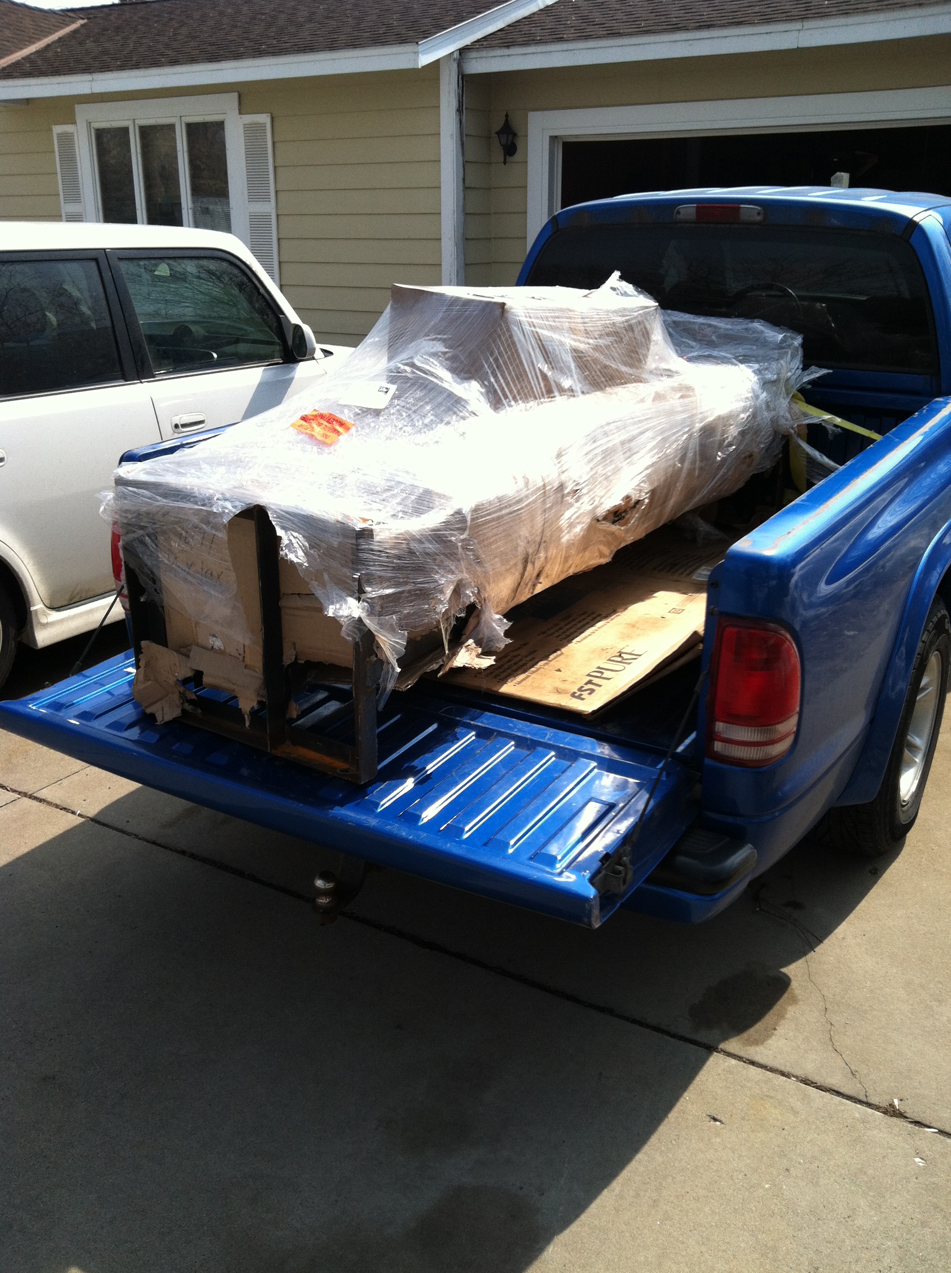

Member No.: 1,590
QUOTE(rhodyguy @ Aug 3 2014, 05:26 AM) *
Dannmar maxjax. $2299.99+shp and handling. that's a costco price.
I got it on sale for $2100.00 with free shipping. I picked it up at the local freight company and they put it in the back of my truck. I used a chain hoist back at home to lift it off the truck bed.
