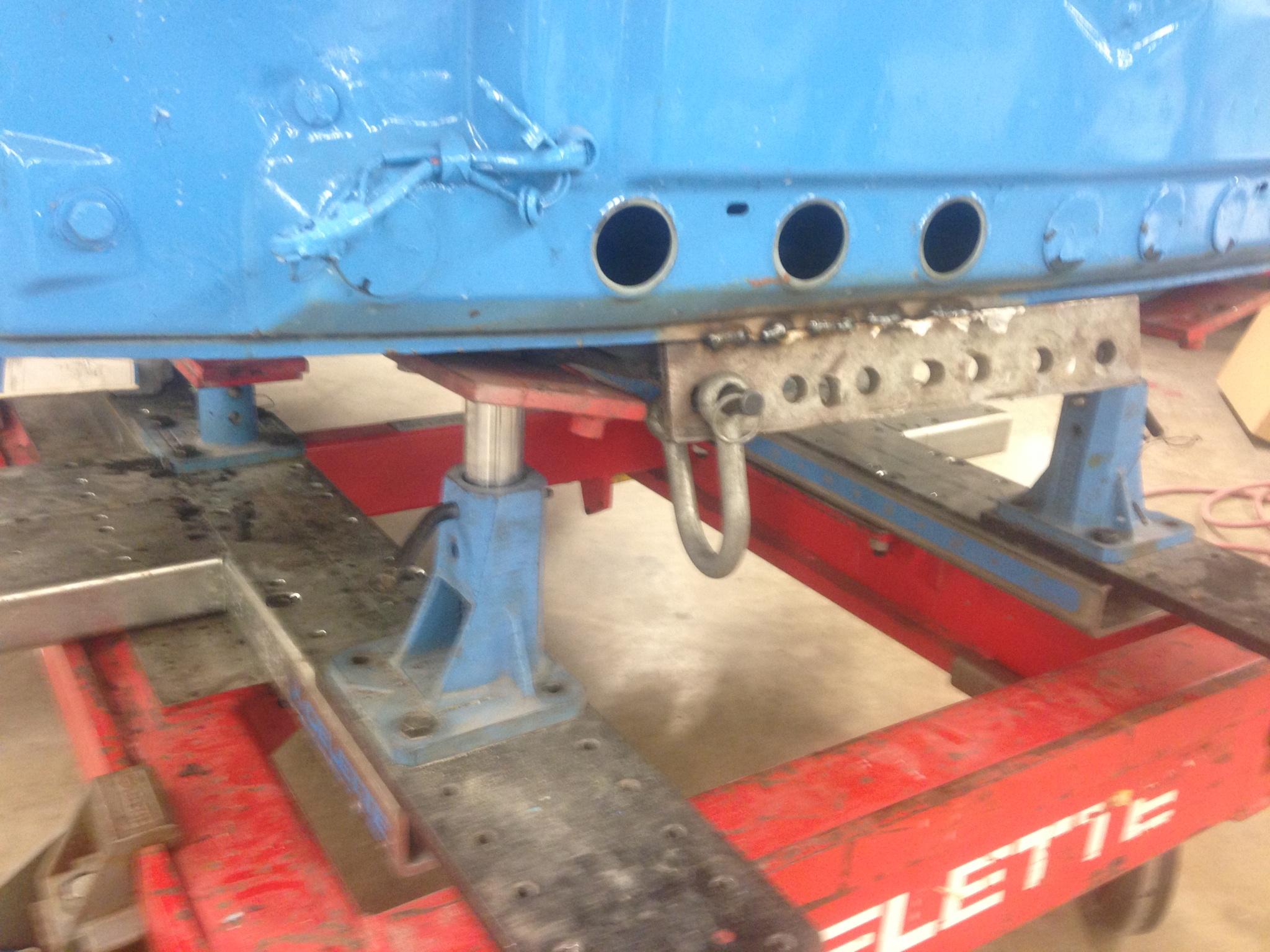

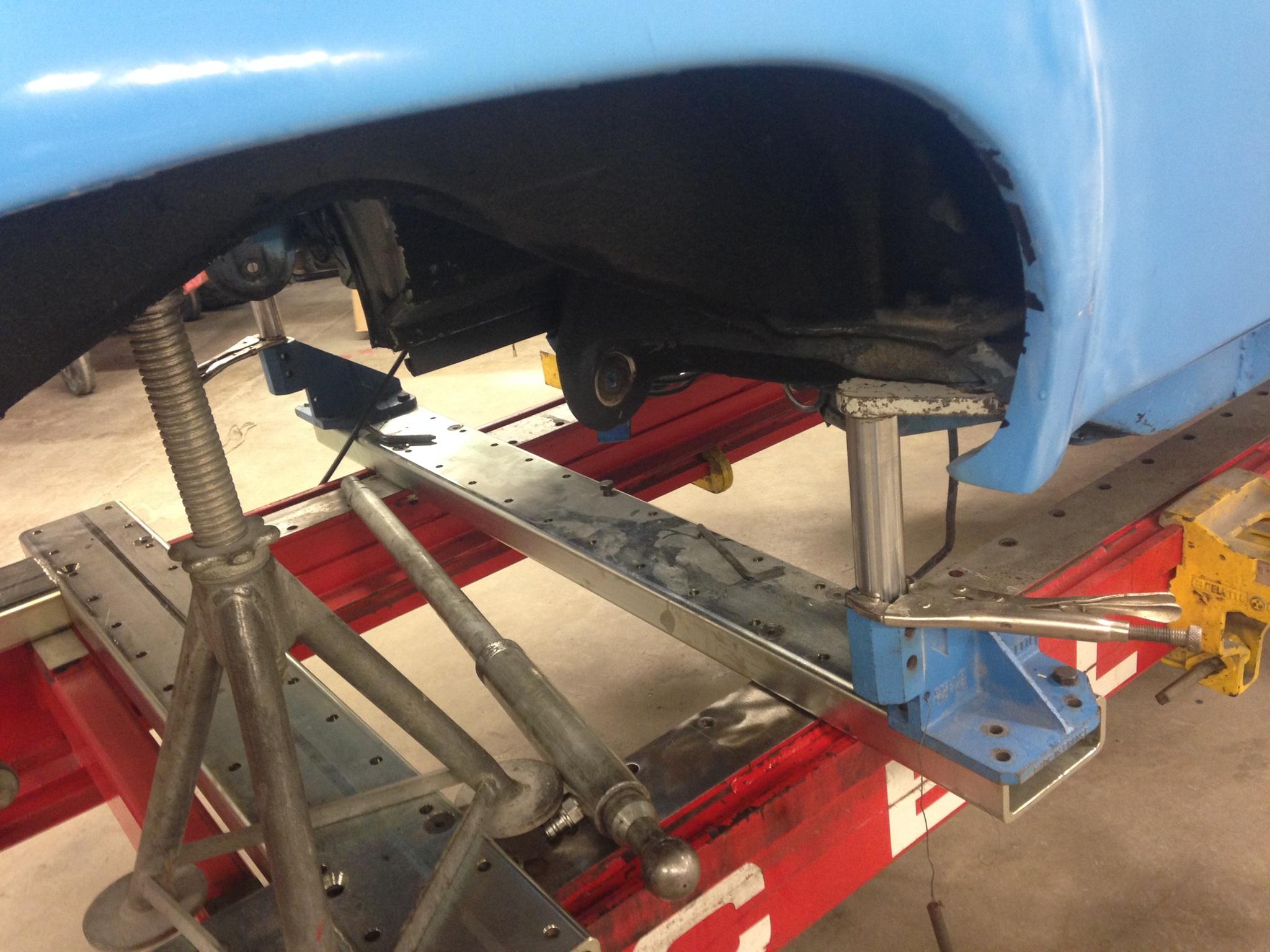

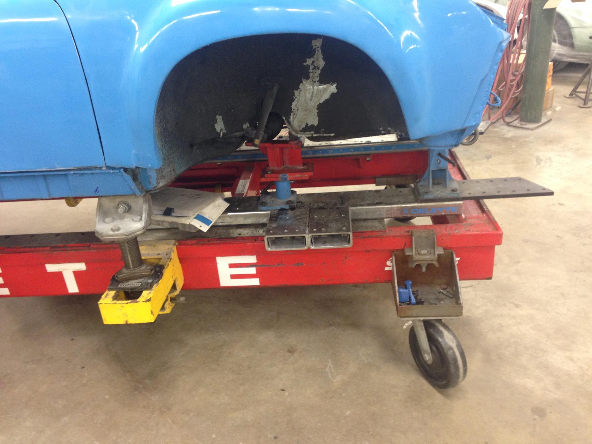

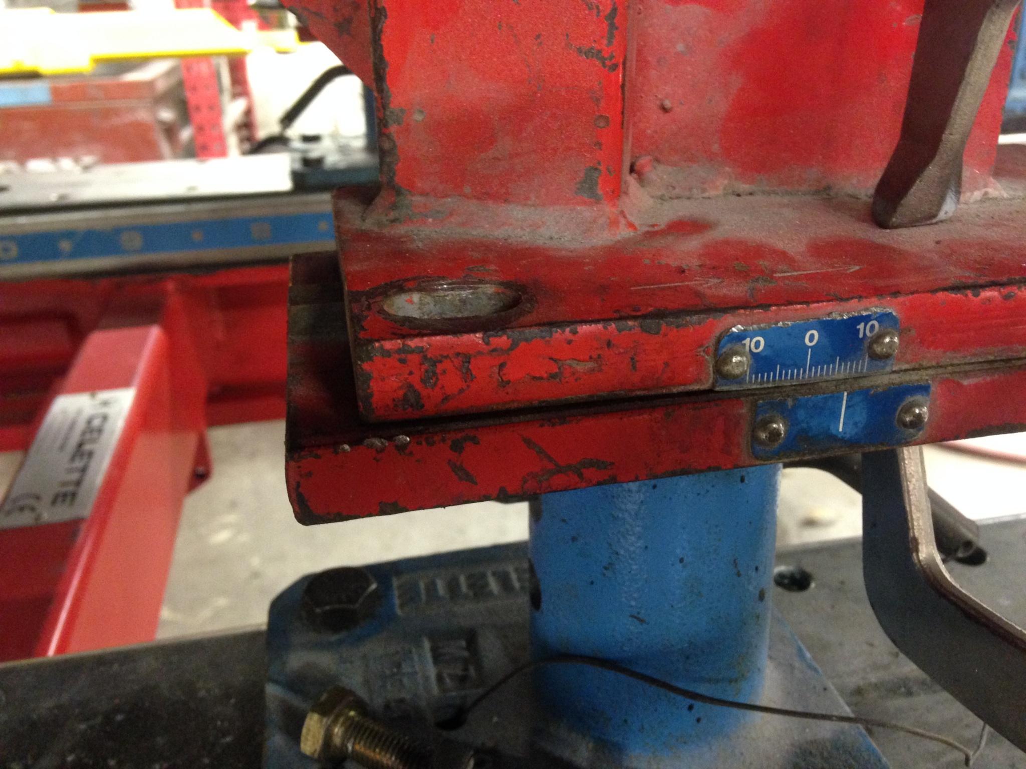

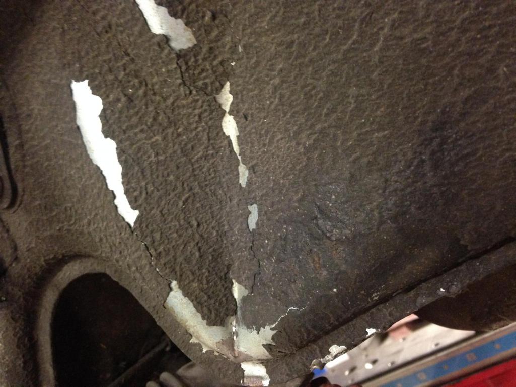

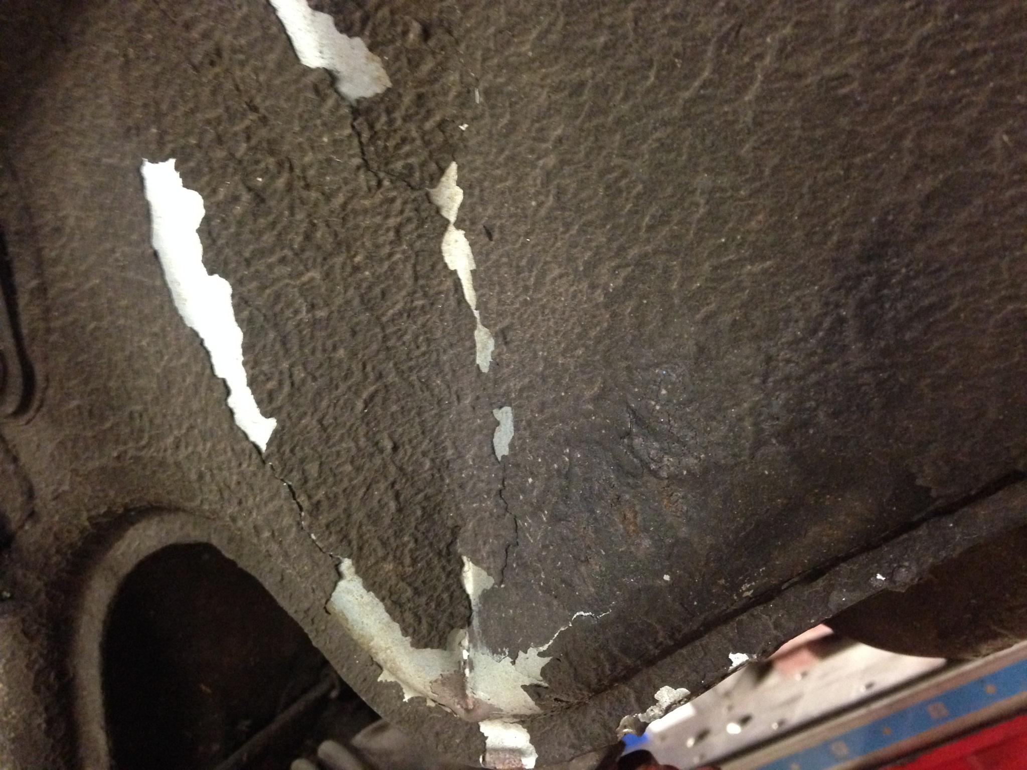

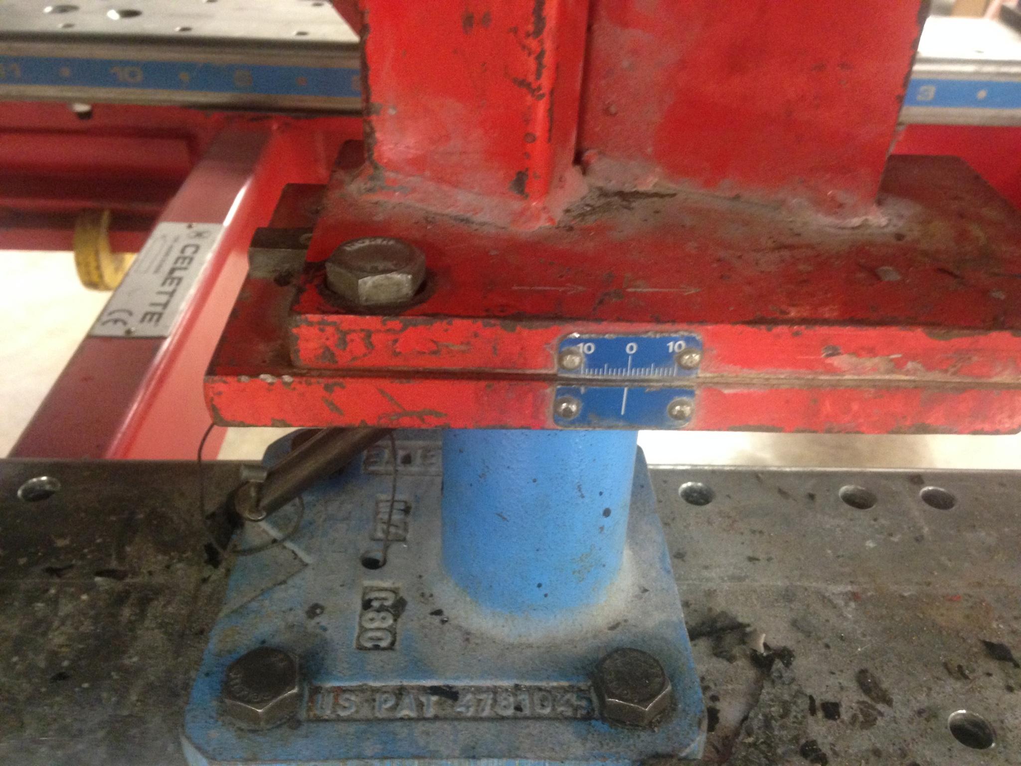

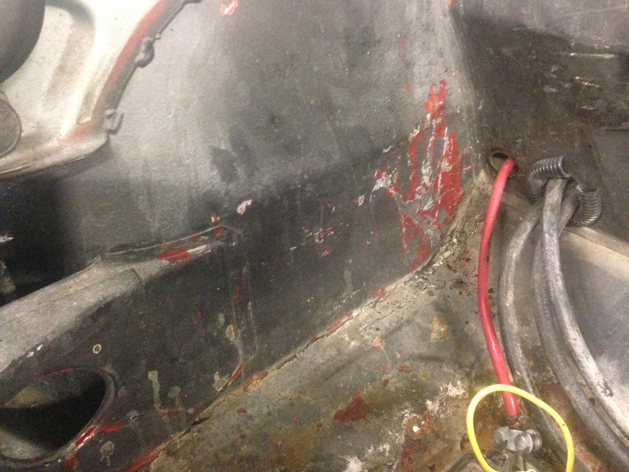

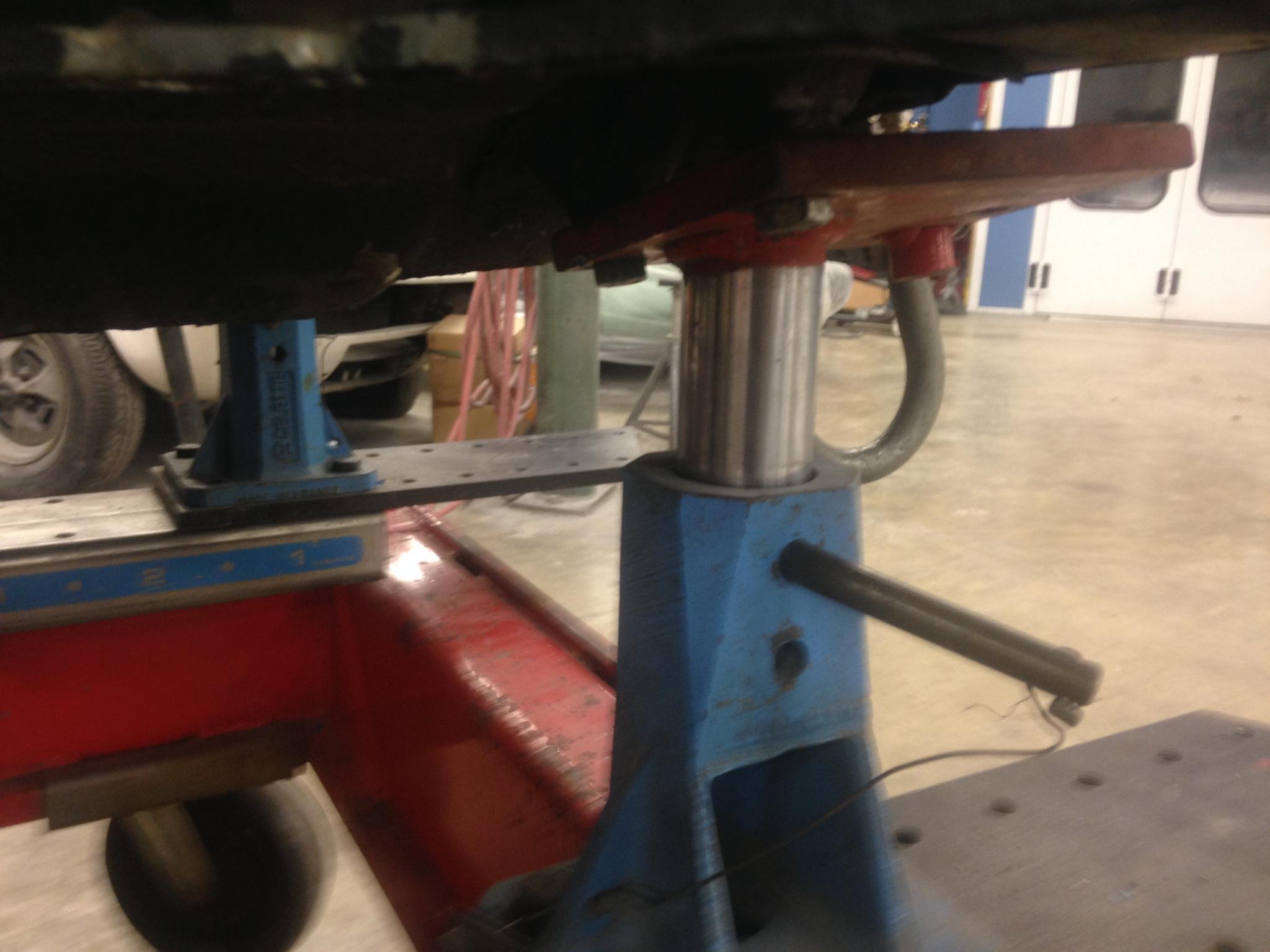

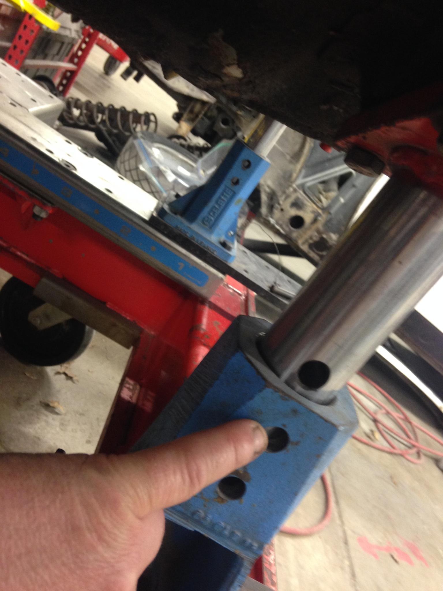

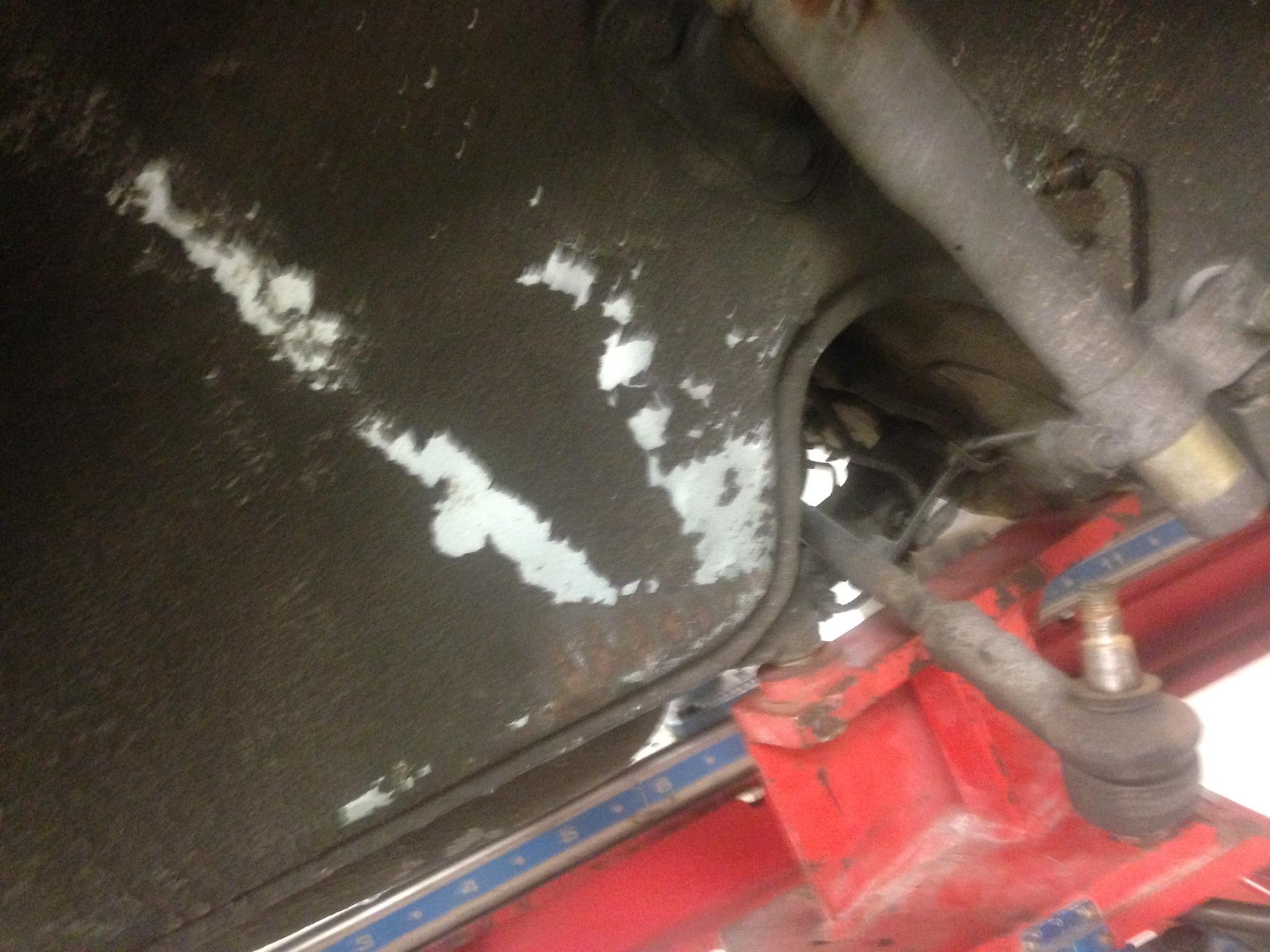

Ok, fast forward...car is on the celette rack. looks like the right front was pushed up about 2 inches and the front mounts driven back about 7 mm..
final pictures show that all the pins are in and the car is square. Not shown was some bending to the rear. It could have been from the impact transferring to the rear due to the cage, but my money is a previous hit around the rear of the drivers door when this was a pca race car...
Attached Image Attached Image Attached Image Attached Image Attached Image Attached Image

more....

and this one...

you can see the difference from the original front picture and the last one....wow! I want a frame rack for my shop...
