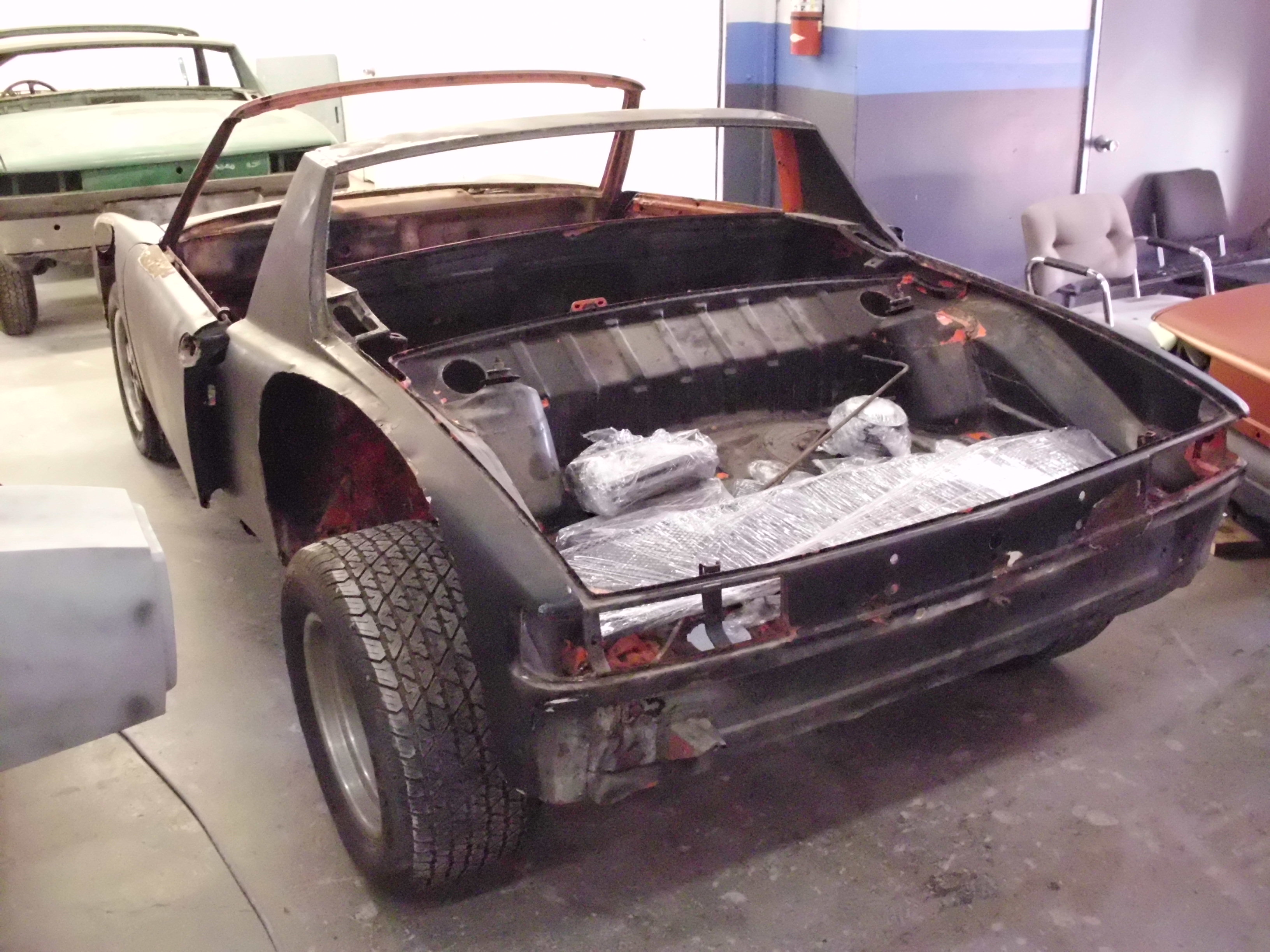

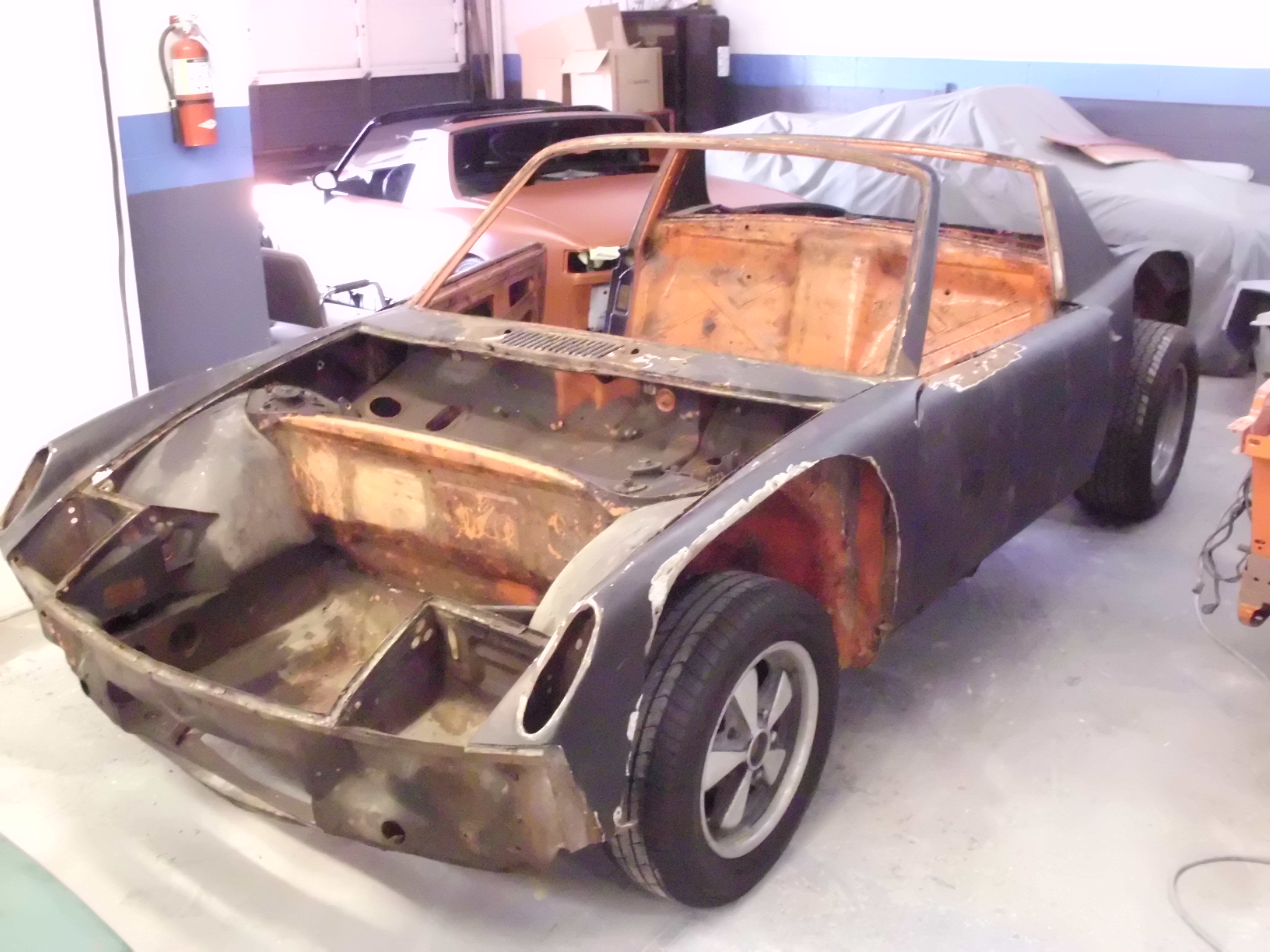

Hi all, I’m still a newbie here on world, I’ve made a few posts but have not yet formally introduced myself. My name is Kent and I have been restoring cars for over 20 years now. I did the reconstruction, body and paint on Andy’s (socalandy) 914-6. I immediately became hooked on 914,s and bought and built a 914 V8 conversion. I am starting a new restoration on another 914-6 so I will be posting pics of the progress as I go. The owner of this cars name is Jim and he has done a nice job of rounding up and restoring many of the parts thus far so this will no doubt be a nice car in the end. Andy (socalandy) posted a thread on this car a few months back and now it is in my shop and I’m ready to begin.

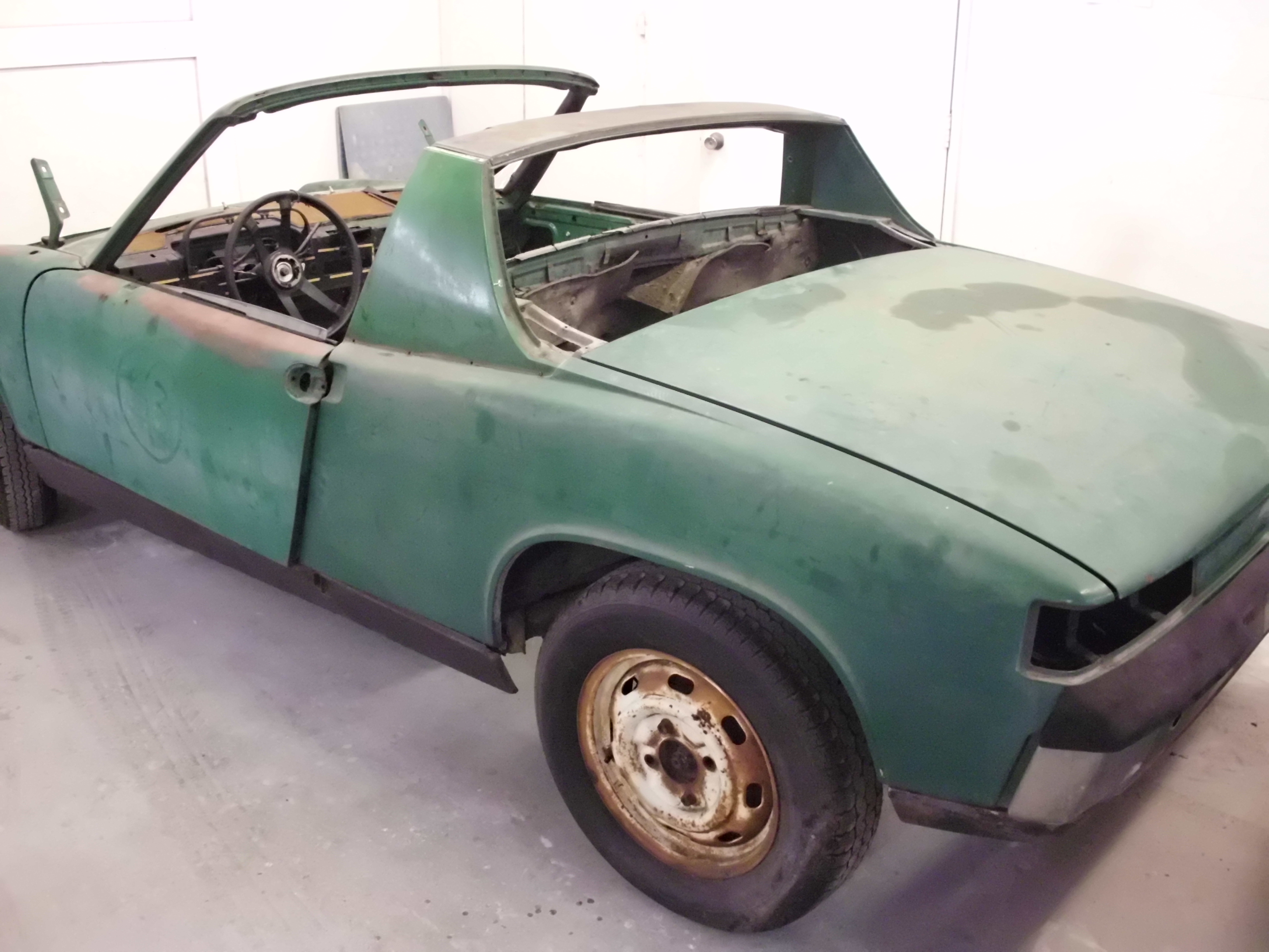

The Donor Car. R.I.P. I will be using the fenders and Quarter Panels from this car as well as some other areas/sections.

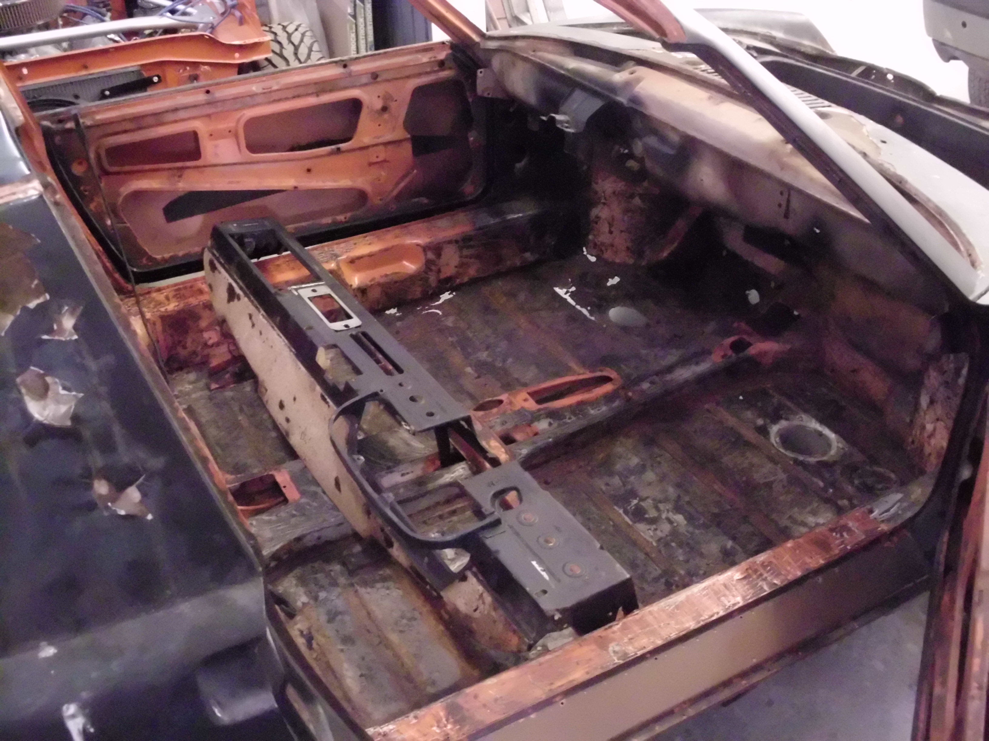

Spent today trimming the panels off of the car and getting it ready for media blasting.

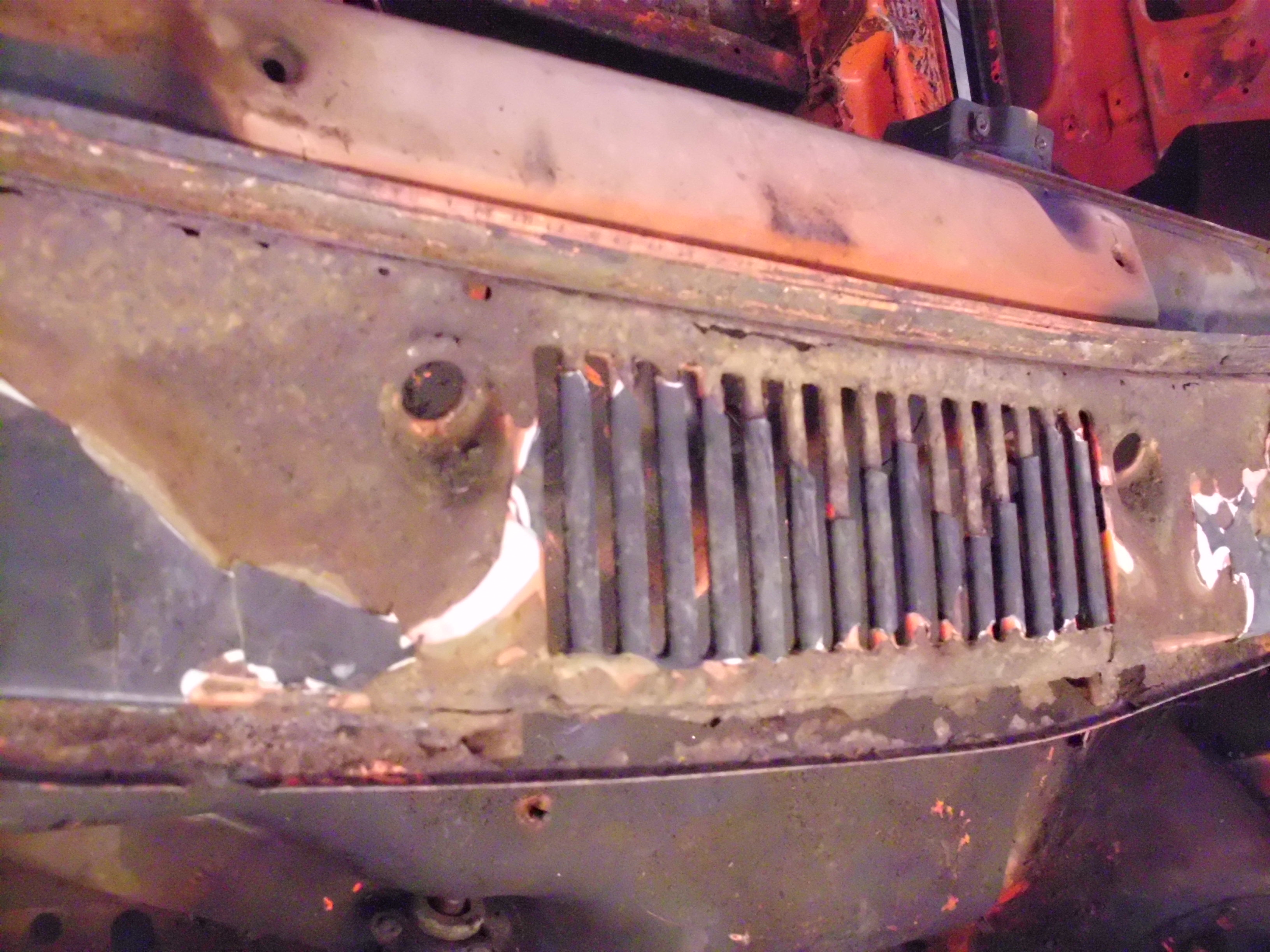

The inner Roll Bar structure is in great condition. Not rotted out on the lower area like they can be.

What did you use to remove the panels? What ever it was it seemed to go well.
| 914350 |
Oct 29 2014, 08:09 PM
#20
Senior Member ![]() ![]() ![]() Group: Members Posts: 548 Joined: 21-April 14 From: Torrance Ca. Member No.: 17,275 Region Association: Southern California |
What did you use to remove the panels? What ever it was it seemed to go well. There's many different tools that are used, I use a sawzall/Reciprocating saw (large and small) and a cut off wheel to cut the panel back to the edges then a spot weld drill bit to help with separating the spot welds and even a air chisel at some points but being carful not to damage the lip/edge that the new panel will attach to. there's lots of different ways to go about it, sometimes the welds just snap loose as you twist the metal away. Attached thumbnail(s) |
