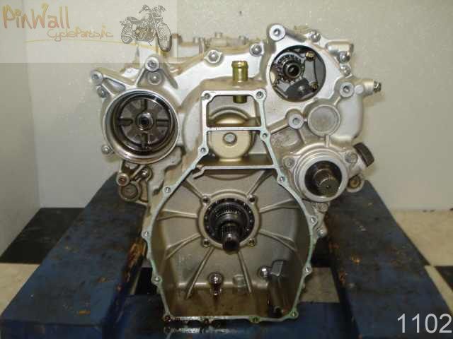

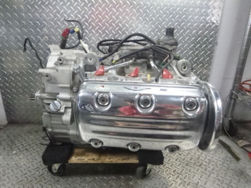

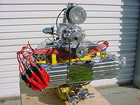

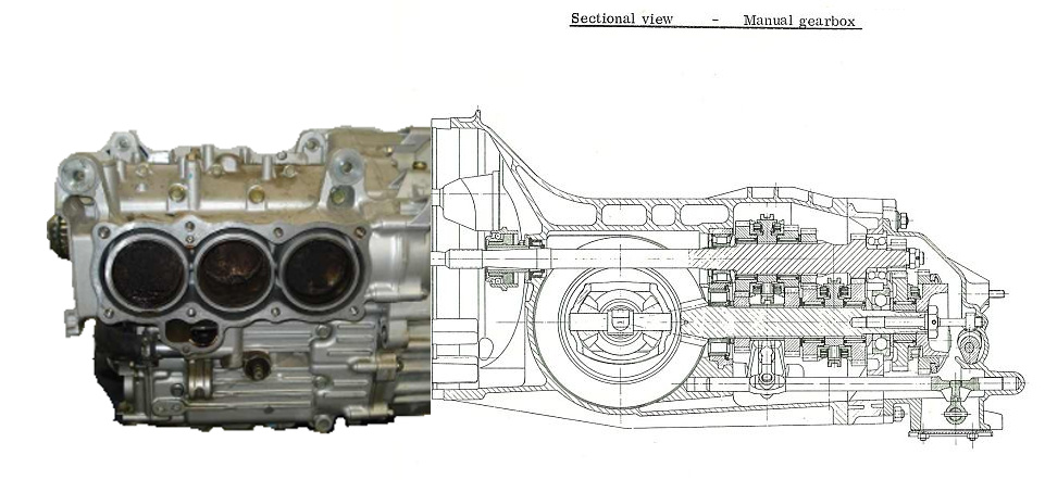

Attached ImageAttached Image
The blower solves the torque curve. http://www.magnacharger.com/c-120-supercharger-kits.aspx
Honda Valkrie bike engineAttached Image
You can see the trans input shaft and the boss above that carries the crankshaft end.
https://www.google.ca/search?q=honda+valkyr...F%3B3648%3B2736
http://www.ebay.com/bhp/honda-valkyrie-parts
http://stores.ebay.com/suncoastcyclesports...=p2047675.l2563
http://stores.ebay.com/Los-Angeles-Motorcy...n=1&_ipg=48
https://www.facebook.com/pinwallcycle
Honda GoldWing bike engine
https://www.google.ca/search?q=honda+valkyr...ne&imgdii=_
http://www.ebay.com/bhp/goldwing-1500-engine
http://volksrods.com/forum/showthread.php?t=34625
At these prices and condition,hard to dismiss.
Nothing simple to adapt,cutting and hacking needed.
Gut the gearbox,an adapter must be made,and so on.
(Illustration is an approximation,bore is 71mm,od of ring gear =?)
Something like this with a heavier flywheel,modded remote oil filter and much more.
Adding a blower makes for a decent output.Flat 6 SOHC 1.5L liquid cooled efi.
