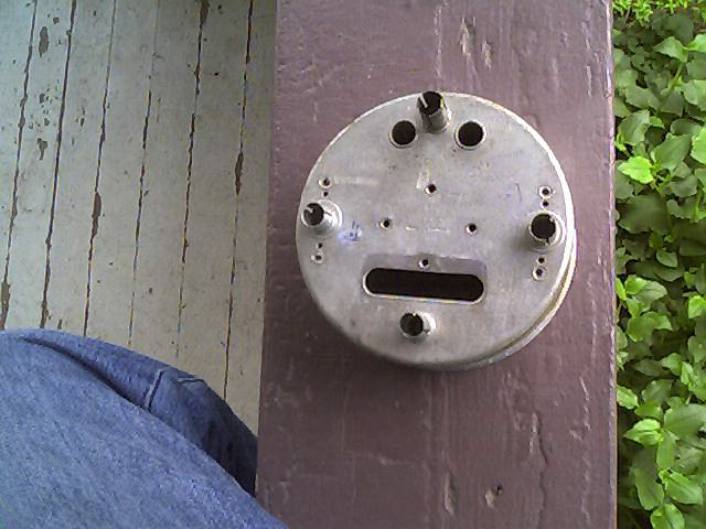

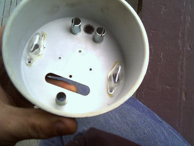

Booyah! Success! I have managed to install a factory looking 4th light into my gauge. Its the one on the top between the two for the turn signal lights. I had to tell you because it looks like it belongs! (IMG:http://www.914world.com/bbs2/html/emoticons/wink.gif)

Innerds

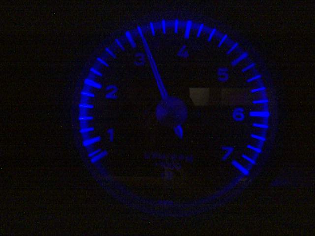

Its alive! The latest and greatest innovations from my evil 914 lab are a success. I have painted the needle white (much better), and the third light for the speedo works like a champ (IMG:http://www.914world.com/bbs2/html/emoticons/smilie_pokal.gif)
Proof:
2 light standard (before, how inadequate (IMG:http://www.914world.com/bbs2/html/emoticons/sad.gif) . Can lighting be described as flacid? ) Note the dead zone between 3 and 5K. This is with the white needle and it looks better thatn stock.

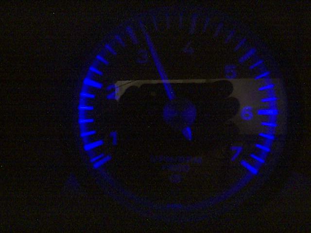

After with the 3rd light on. The fact that you can see the needle is testament to how much better white needles are with blue/white light. My camera is sooo crapy that it would not pick up the orange needle.
