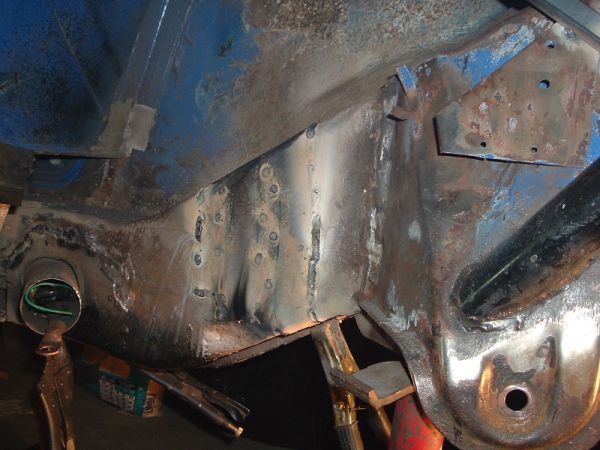

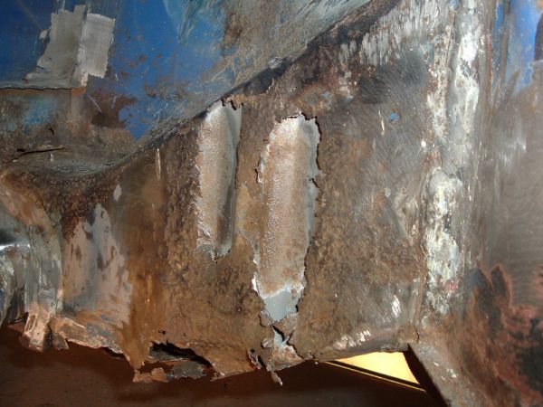

It seemed like it was going to take forever to make some progress on my rust repair. After spending the entire winter locating parts, grinding, cuting, painting, and learning to weld, I was finally ready to take the plunge....
Also thanks to everyone on the board, I would have never had enough confidence to tackle this without this site!!!
BTW: I must be getting addicted to the "914 lifestyle" as I had withdrawal when the site was down. (IMG:http://www.914world.com/bbs2/html/emoticons/happy11.gif)

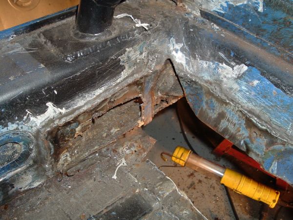

Fist Pic : The Rust

Where the motor mount was.

Here we go.

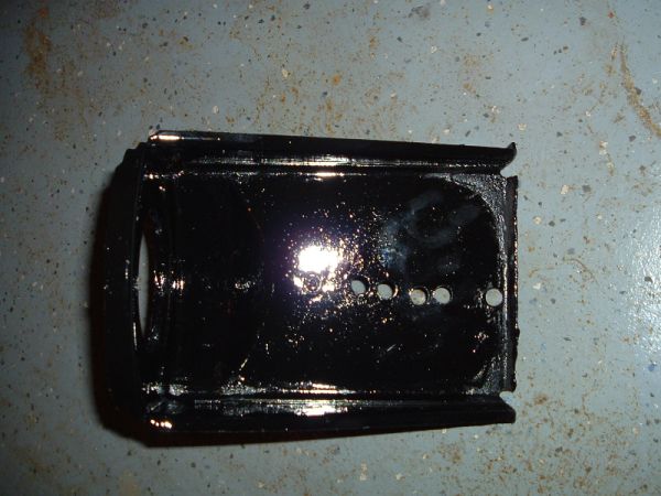

The repair piece from a parts car.

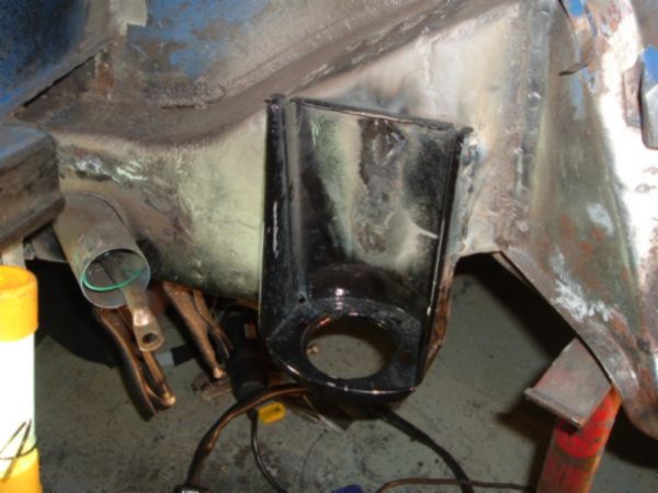

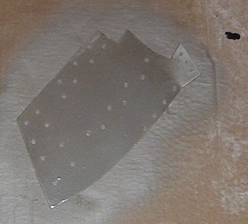

The patch for the frame under the engine mount.
cdmcse
post Feb 13 2005, 12:22 AM
Posts: 340
Joined: 17-December 04
From: Georgetown, Ky
Member No.: 3,305
Patch welded in.
cdmcse
post Feb 13 2005, 12:23 AM
Posts: 340
Member No.: 3,305
This part is next, after a little clean up in the welds.

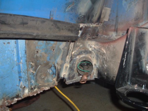

Whats with the electrical cable coming out of the heater tube??
Geoff

These cables in the heater tubes are for a front trunk mounted battery and some aux gauges. I am moving them to the center tunnel when I replace the rear floorpan.

Motor Mount is in, I can practially hear the engine running (as soon as I put in a new floor pan (IMG:http://www.914world.com/bbs2/html/emoticons/dry.gif) )

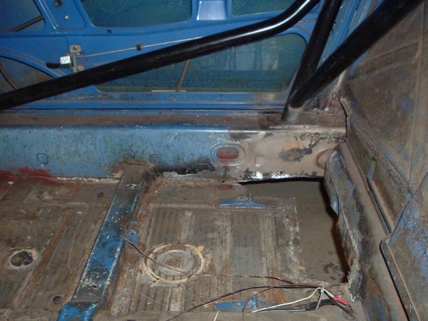

Made some more progress
Before:
cdmcse
post Feb 23 2005, 11:42 PM
Posts: 340
Member No.: 3,305
After:

Outer Firewall back in:
post Feb 23 2005, 11:57 PM
Resident German
Posts: 42,360
Joined: 21-January 03
From: Oakland, Kalifornia
Member No.: 179
did you spray plenty of "metal-ready" inside that long before you closed it up?
looked like there was quite some surface rust in there.
i'd hate to see it rust from the inside out again ...
nice work!
