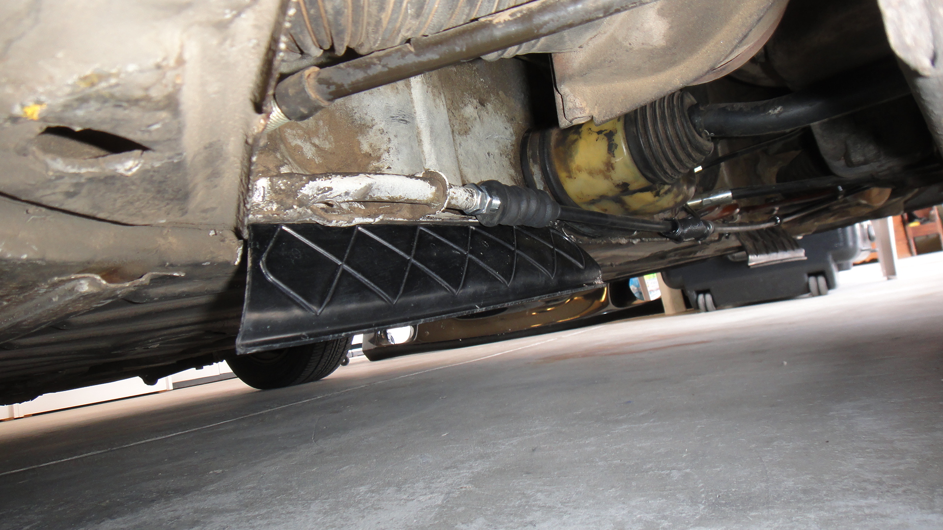

Wasn't to bad, would've been much easier with a 4 post lift. I only had drive up ramps and jack stands. All went well. Attached Image Attached Image

Stupid question, but what purpose do the deflectors have? What years had them?

The plastic flaps or deflectors are to create a low pressure area under the engine which allows the engine cooling to work better, assuming all the engine tin is in place and the thermostat/flaps are working properly.

I believe 73 on, helps with cooling.
