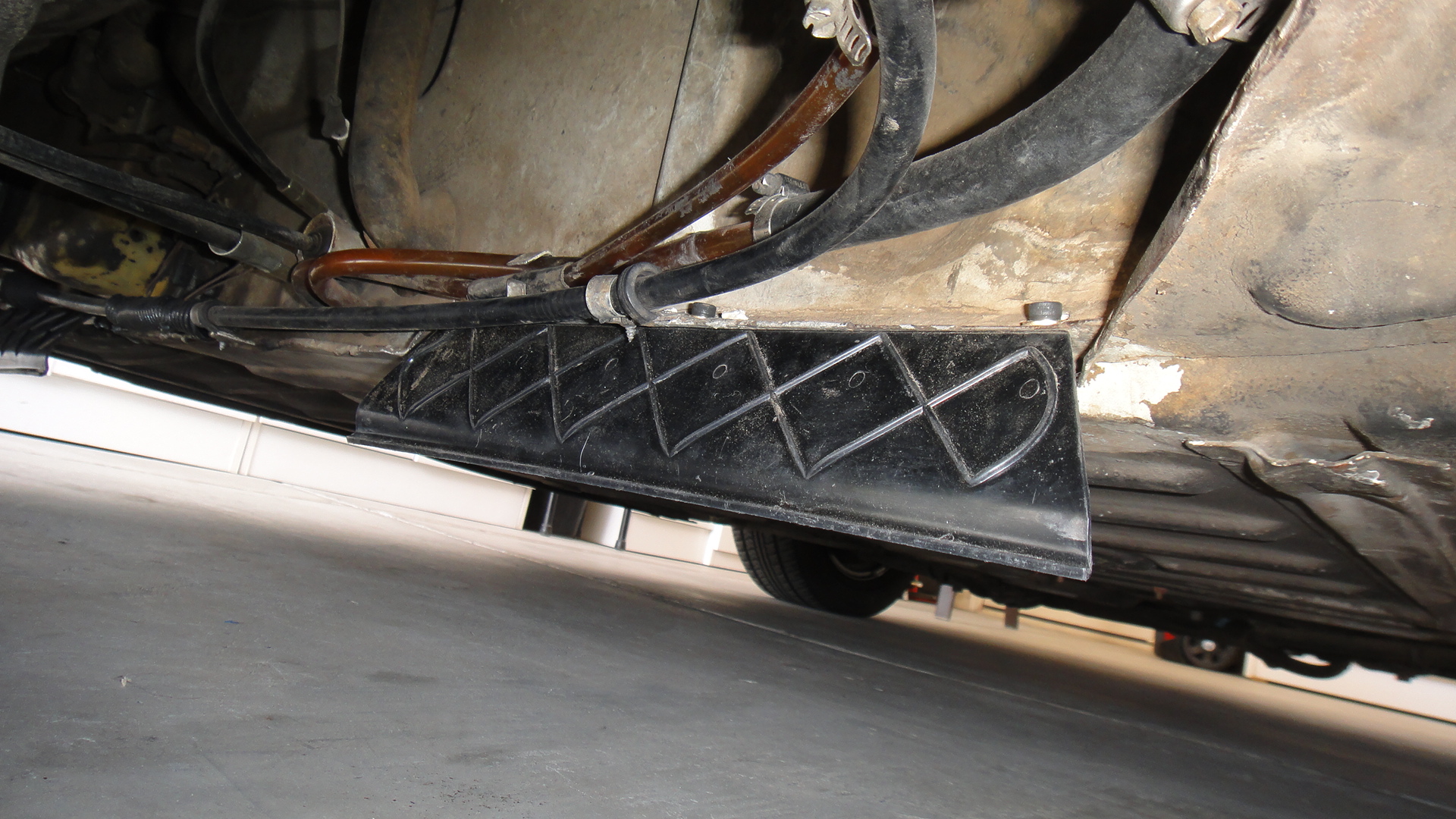

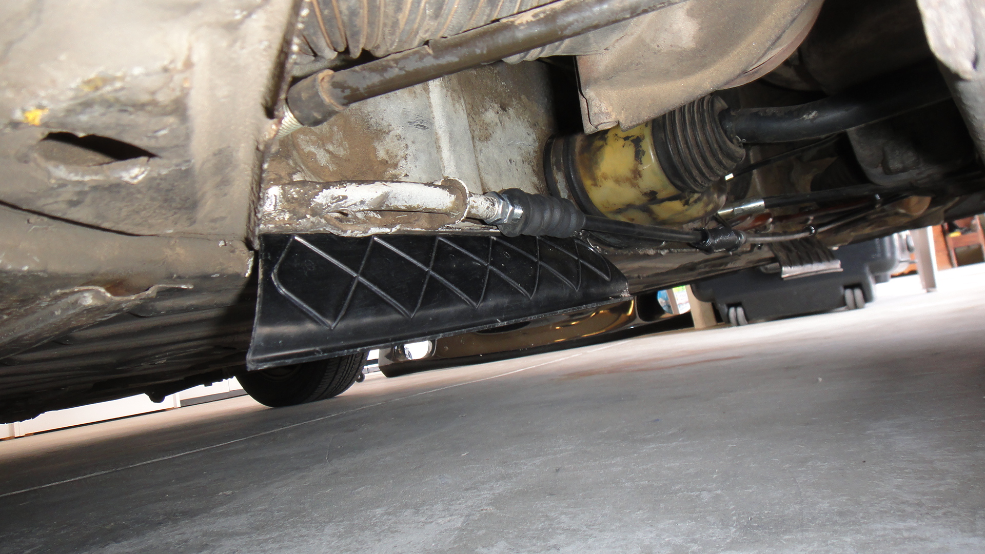

Wasn't to bad, would've been much easier with a 4 post lift. I only had drive up ramps and jack stands. All went well.

Stupid question, but what purpose do the deflectors have? What years had them?

Some would like to know the purpose of the plastic rail(s) under the engine. Me too.

The plastic flaps or deflectors are to create a low pressure area under the engine which allows the engine cooling to work better, assuming all the engine tin is in place and the thermostat/flaps are working properly.

Where did you find a set of new looking deflectors?

Got the deflector flaps from Garold Shaffer. I don't know if he has more.
Not new, just cleaned up.
cpavlenko
Jun 23 2015, 08:51 PM
QUOTE(rudedude @ Jun 23 2015, 06:28 PM)
Got the deflector flaps from Garold Shaffer. Don't know if he has anymore.

I believe 73 on, helps with cooling.

Don't bother taking them off. That's not your problem. They do work and they work well.

QUOTE(Garold Shaffer @ Jun 23 2015, 07:49 PM)
QUOTE(cpavlenko @ Jun 23 2015, 09:45 PM)
QUOTE(budk @ Jun 23 2015, 05:50 PM)
yep, just used some simple green, let soak for 10 mins. then used a hand cleaning brush to scrub the dirt build up. they look good for used.
