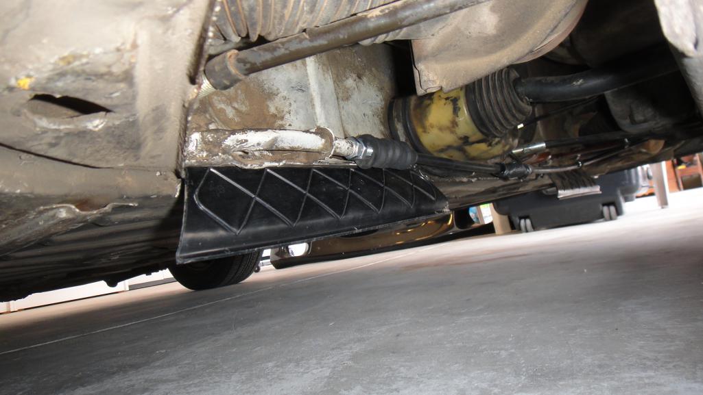

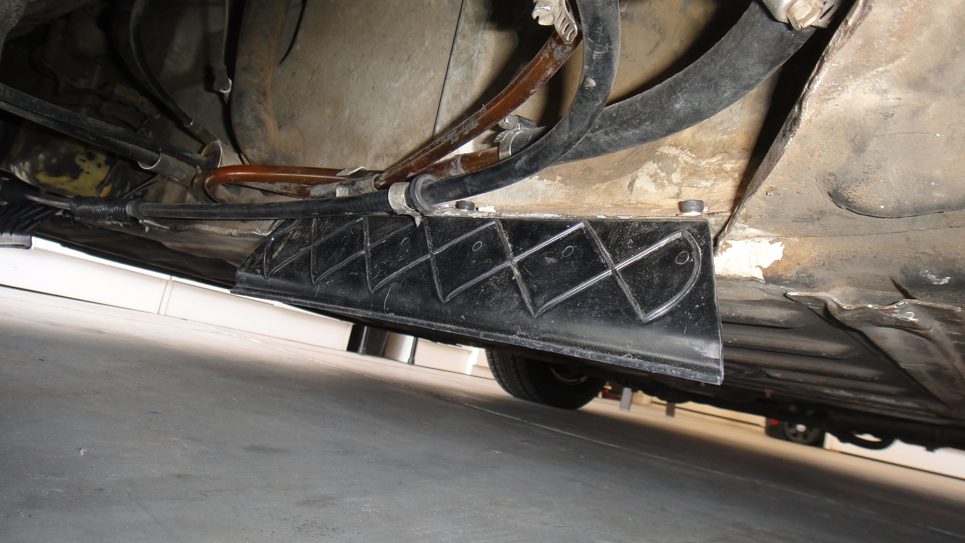

Wasn't to bad, would've been much easier with a 4 post lift. I only had drive up ramps and jack stands. All went well. Attached Image Attached Image

Looks good, next upgrade I would do is replace the old tunnel fuel lines with SS, and check the rubber lines while you're at it.

Rubber fuel line hose through the whole car was completed, less than a year ago. I've heard u have to drop motor and what about the gas tank. The gas tank was pulled and checked and everything was surprisingly clean in tank and where it drops in. All the wires looked good and clean, replaced bottom tank seals also. I always keep a eye on the fuel hose.

I'd suggest using FI clamps instead of the ones you're using as they typically have a rounded edge are less likely to cut into the rubber fuel line.

Stupid question, but what purpose do the deflectors have? What years had them?

If they are cutting you over tightened, or the rubber hose ID is too big.

The plastic flaps or deflectors are to create a low pressure area under the engine which allows the engine cooling to work better, assuming all the engine tin is in place and the thermostat/flaps are working properly.

QUOTE(914Mels @ Jun 23 2015, 01:05 PM) *
I believe 73 on, helps with cooling.

Don't bother taking them off. That's not your problem. They do work and they work well.
I'm guessing your heater flapper bellows are not working properly. You may want to remove that and put it in boiling water to see how it responds. Also, make sure the cable is hooked up properly to the armature on the flappers.
