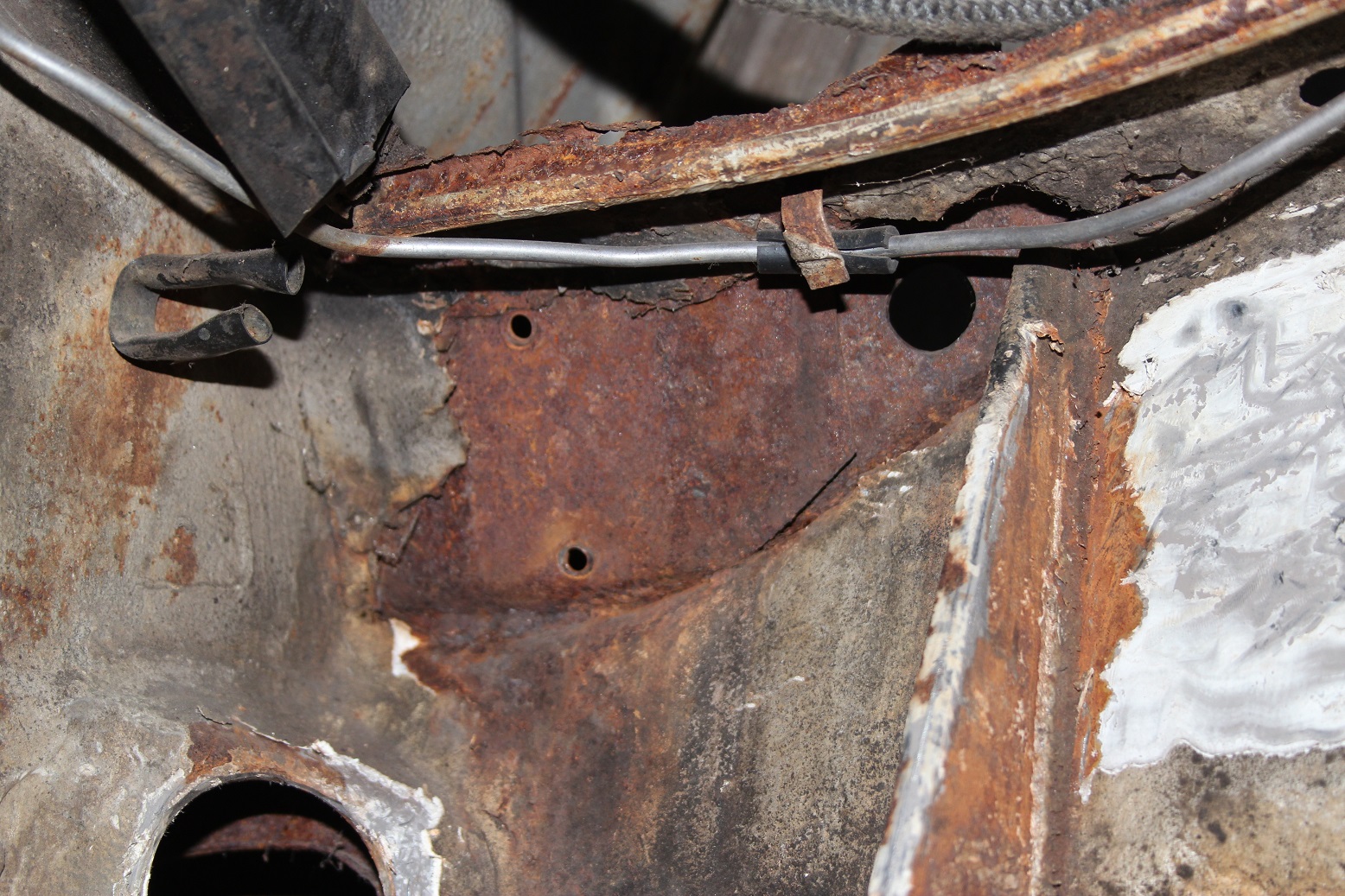

I was hoping to get away with something like that. But the suspension pylon needs to be removed, and so far as I've seen in searching this site, I'll have to cut the quarter panel. Please correct me if I'm wrong on this because I would really rather not. But look at this:
When I poked at this, the hole just kept getting bigger and bigger. Rust and sunflower hulls were pouring out of it. Got a whole bag full.

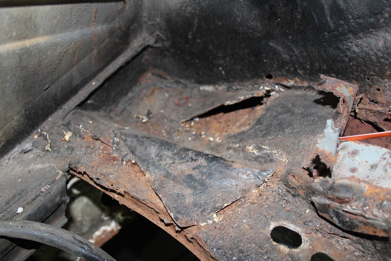

While the outer pylon seems solid, the metal of the long around it is cheese. Cut the long open and this is looking aft and up, inside the long from just aft of the jack point (it looks backwards because it's looking in a mirror). You can see the entrance to the wee beastie's nest.
I'm betting his little skeleton might still be inside the pylon.

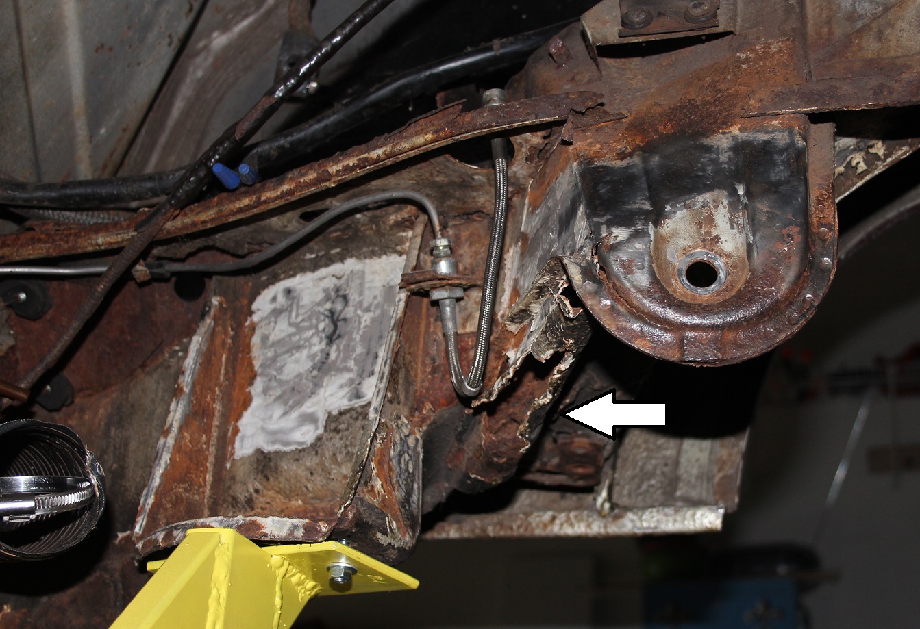

Just for good measure, here's a top down view of my properly hellish hell hole:

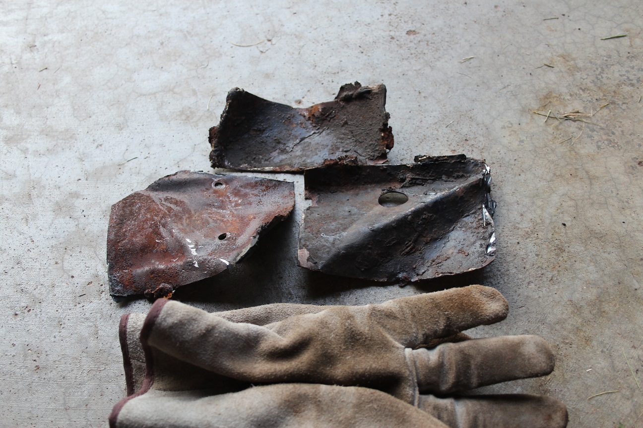

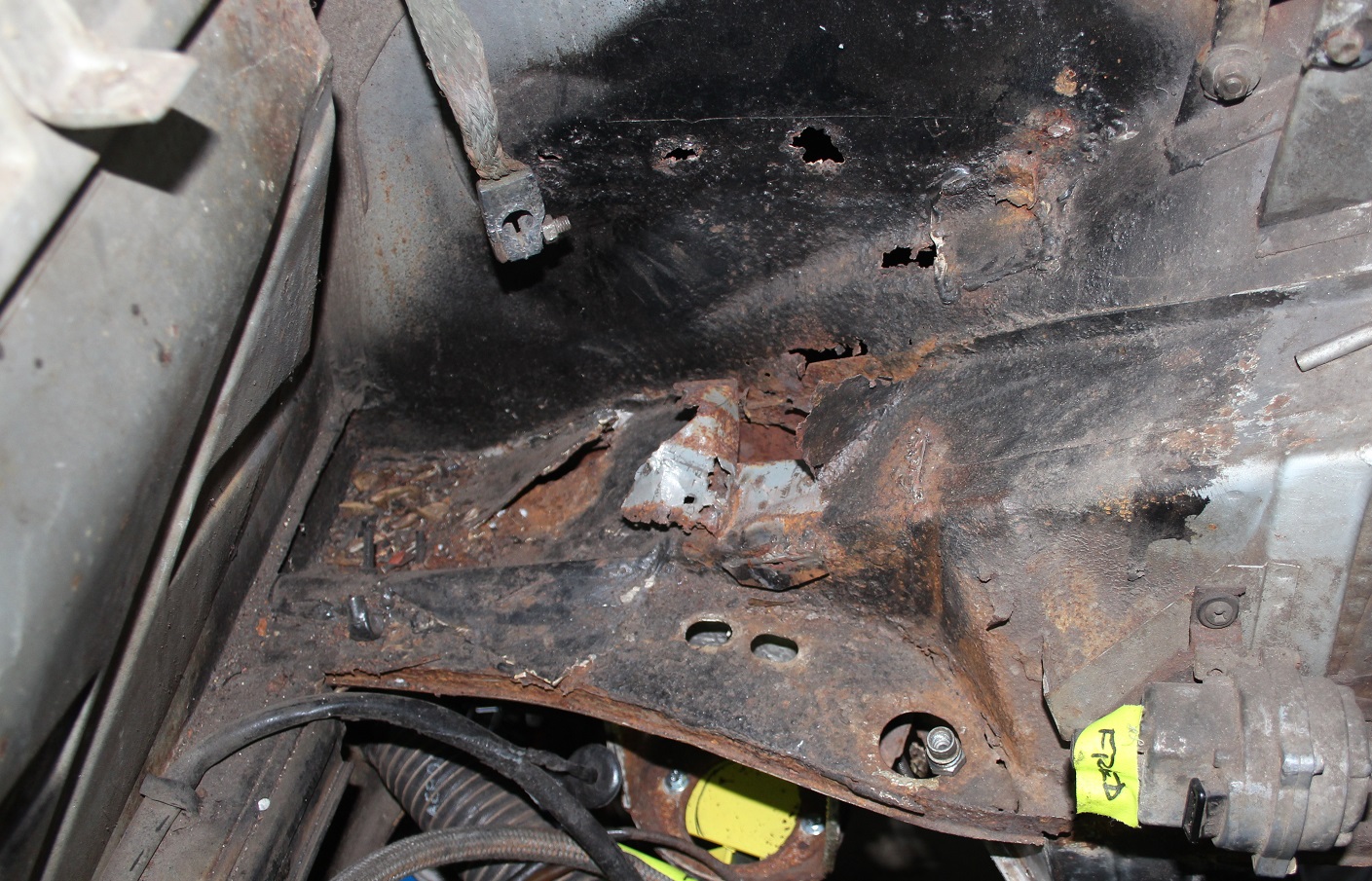

Guess I better update you guys... Some PO welded in some random patches, have to dig them out and find out where the original metal starts. This is the underside of the hell hole:
And from above... Looks like grandma's quilt:
Pulled it all out. This is the PO's "hell hole repair kit"

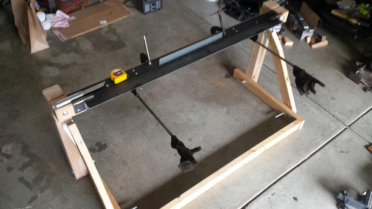

I'm planning on buying a bunch of sheet metal from RD. But to help stay within budget, I made a bending brake- this will be the source of my new inner longs. I've got a pile of 18g, but I have a piece of 12g to test the limits of this thing. If it can handle it, I may just make the inner longs from 12g. No additional stiffening kit required!
Using test strips to get set up:
Breakfast of champions:
