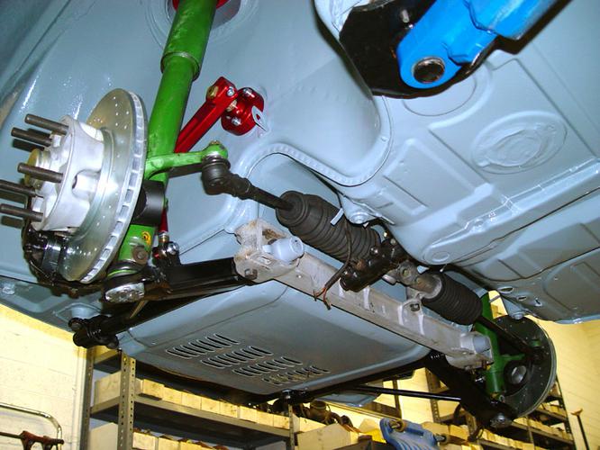

Pms website has lots of pics.

I had a scroll through the PMS pics, and sorry if I am being a muppet and missing some obvious ones, I just can't see a nice detail shot of the louvred belly pan itself.
Would be nice to get a nice clean shot of a front trunk with the pan installed, and before a cooler and shroud (obv.!) has been fitted.
The third one is the best angle... shame its such a small jpg (and a questionable install?)
These are the best I could turn up thru the PMS links:

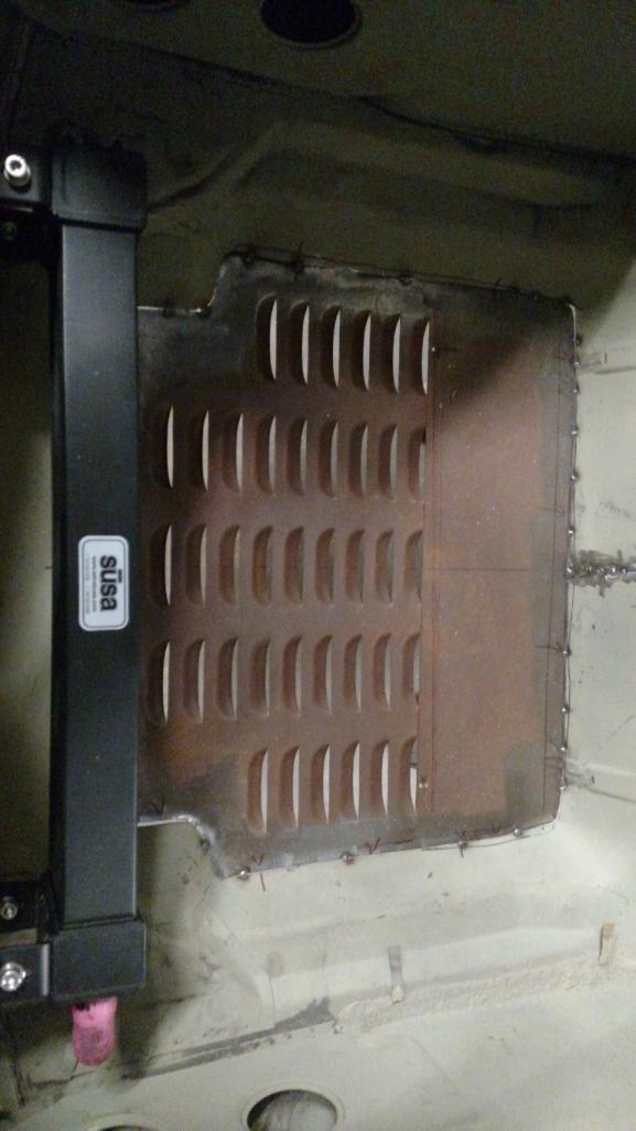

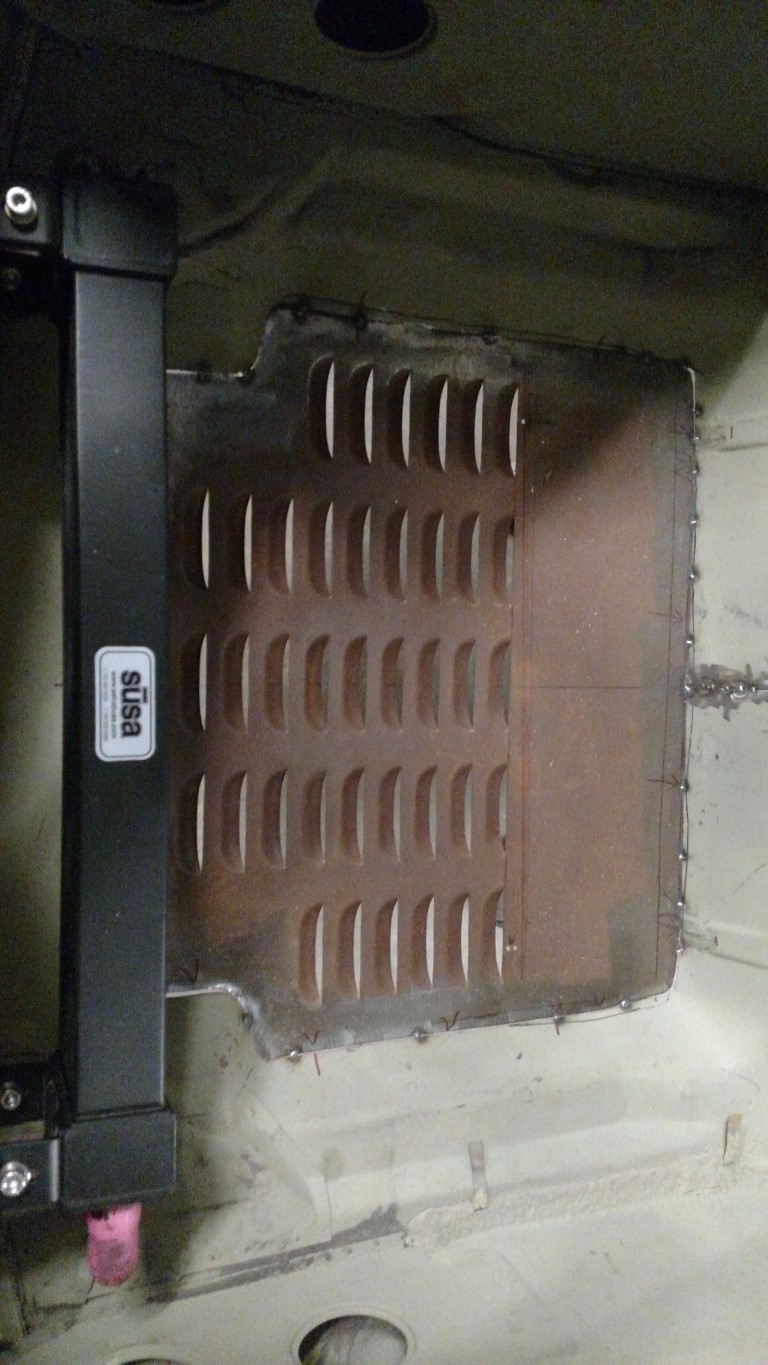

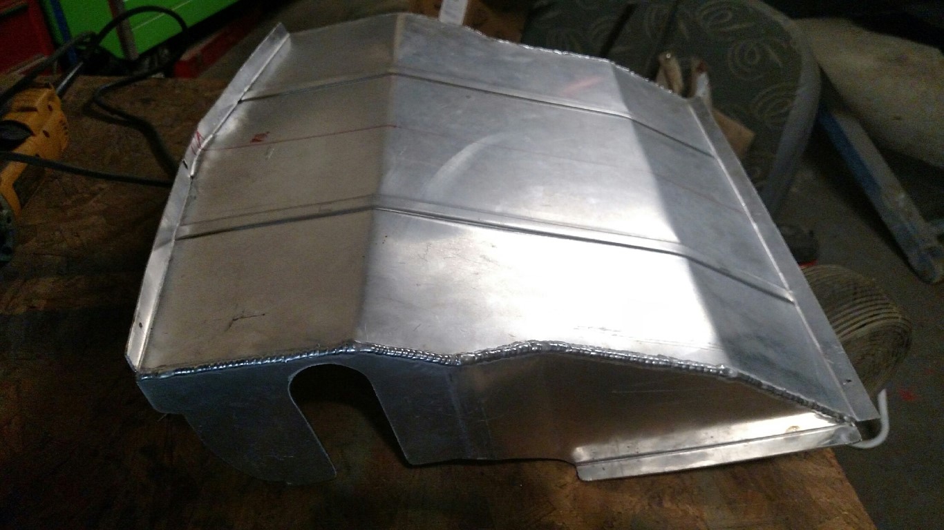

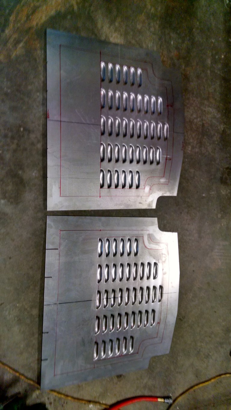

I wanted max air flow so I asked scotty to make me up a custom set of louvers. The aluminum shroud was his idea.

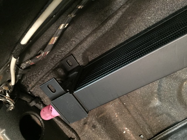

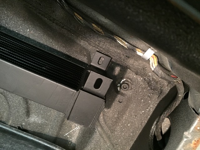

We went a different route with Huey because we drive him for trips and want to use the front trunk area. We got a flatter style cooler and mounted it on the floor, that way the air is not heated up until it passes through the cooler and out, and the shroud does not get hot thus heating up everything in the front trunk (like the beer cooler that fits nicely up there!!). It also allows for a much flatter shroud meaning you have more open depth to use, but it takes up more of the floor space...so a trade off...
Unfortunately I don't have a picture of it (for some reason??) and its currently at the shop to get the rear suspension fixed. If I can sneak over there and get a few pics, I will
For Papa Smurf, we fabricated a bracket system to vent it out the hood...

Really nice work on the louvers and Al shroud.

That custom made one in mepstein's post above does fit well, some nice fabricating went into that.
And I guess the extra louvres help allay any concerns about the (hot) air pressure physics.

That would be true in a static environment.
However, if you increase air speed after the cooler you can expel that same air just as efficiently with a smaller size outlet.
Which is exactly what the louvers do ...

Now you guys have me worried. I have the exact same set-up as Mark with louvers in the trunk floor, like PMS has on their car above. I am going to go out a limb here and say if PMS selected this method to expel hot air from their car, it will be good enough for my street driver. However, you got me thinking for a minute there....

QUOTE(Cairo94507 @ Oct 19 2015, 03:10 PM) *
Michael - you have nothing to worry about. Remember, the front cooler is a supplement to your on engine cooler. Your covered.
I removed my on engine cooler so I'm relying solely on the front cooler. If it gets to warm I will add back the engine cooler.

That wasn't my point, but yes, a fan will help when not moving.
My point was that the design of the louvers will increase the air speed of the hot air while the car is moving, thus offsetting some of the surface area required for the exit holes.
