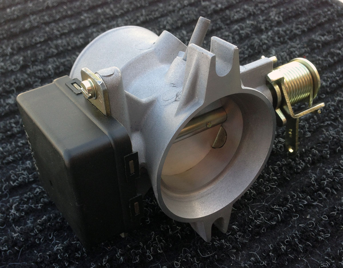

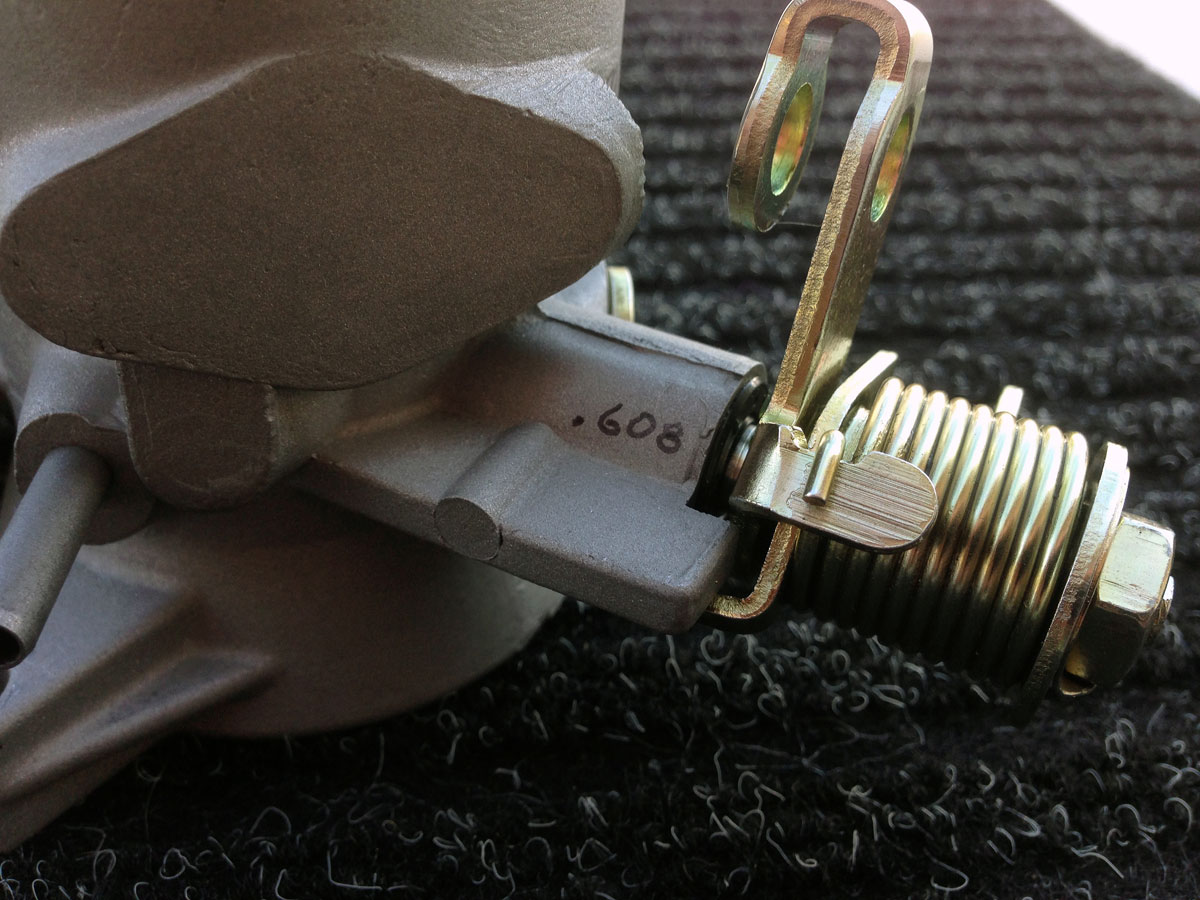

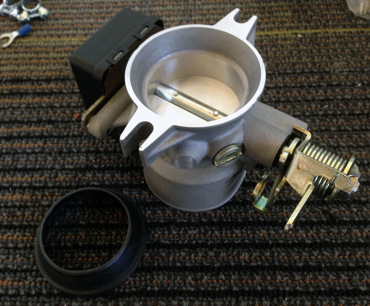

Just got my TB back from a total rebuild. Came out really nice. Done by a machinist on the Samba user name whip618 does really nice work.
Machined with bearings and seals, new Pivot shaft, new Butterfly, over bored, rebuilt TPS, All fresh cad plating, machined mounting surfaces. Pressure tested. I just put it in today, but have not had time to try it out. (IMG:style_emoticons/default/aktion035.gif)
Also a new seal by 914 Rubber.
Will post follow up.

Did you have this done to address a particular problem with your engine?
Also, can you loosen or remove the big idle adjustment screw, maybe showing how it selectively leaks air?
Thanks, it's beautiful!

I had it rebuilt because of wear on the butterfly and leaking shaft pivots.
Very happy with the results of the rebuild.

Do you know if they replaced or just cad plated the spring?
I had one fracture after about 90k miles of normal operation, leaving me stranded.
Also does anyone know of a source for a replacement spring?

Was it a new return spring?

Not sure if the spring is replaced. He does lots of these for VW applications. Some of the sticking is due to the butterfly wearing against the side wall allowing it to over close and stick. Mine was worn in this area.

Just got my tb back from Phil.
It drives so smoothly it is almost sinful.
The problem I had (and apparently common) is that the throttle plate would stick in the closed position and would need a blip on the throttle to disengage the throttle plate and then you could feed in the power.
Phil also added a mod -an adjustable stop on the tbspindle assy to stop the throttle plate from jamming on the wall of the tb
Now, I have to change my driving style as you can accelerate silky smooth from rest. A very rewarding result. $295 shipped to Aus.
Thanks Phil
The other plus is that I can now have the secondary return spring which goes from the bell housing tinware to the tb spindle. The secondary spring is obligatory for track use but the car was impossible to drive with one before the rebuild.

My car runs so much better after the rebuild. It just would not idle cold before rebuild. Now never stalls and idles at 900

The position sensor looks new. Did he replace it?
nihil44
post Feb 26 2016, 01:16 PM
Posts: 157
Joined: 28-January 12
From: Brisbane, Australia
Member No.: 14,058
Don't know.
My guess it has just had a bit a clean up
