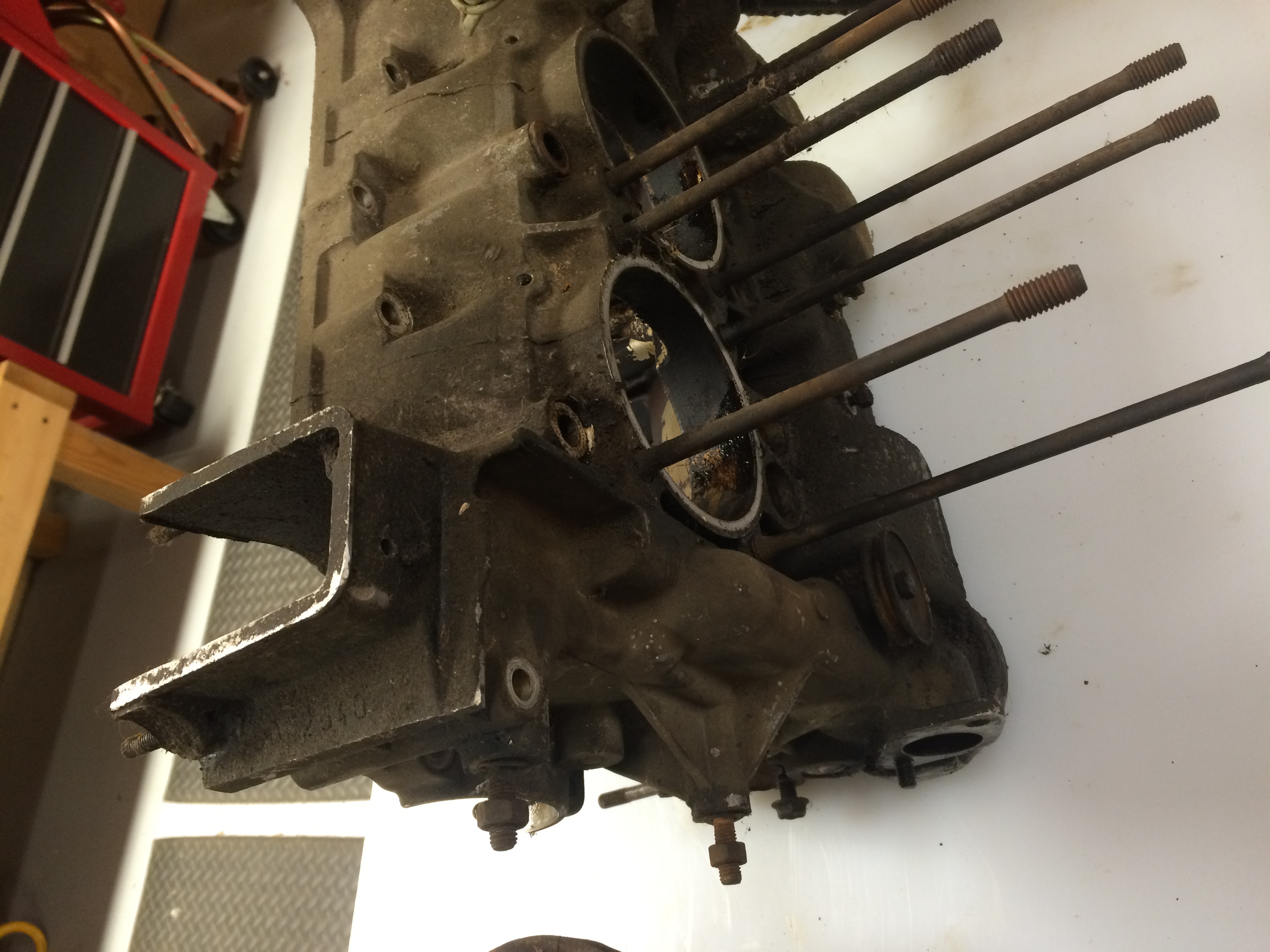

Valy - thanks for the info. The case I am hoping to use does not have a hole for a dipstick. I suppose I can drill one?
See pic...

Why not source a 914 case?
Good question. I had this laying around and hoped to use it (free and all). I may have to buy cases...

Yup, check condition of the case before you put more work into it. You can drill a new dipstick hole if the case is good.

QUOTE(McMark @ Jan 15 2016, 06:47 AM) *
sdoolin,
Here is a link to the quick and easy dipstick tube fix. It's super easy and very good quality. I've done several. Best part is you can do it locally.
Good luck on your build. It is post #18 down at the bottom of the thread.
http://www.914world.com/bbs2/index.php?sho...stick+tube+fix#
