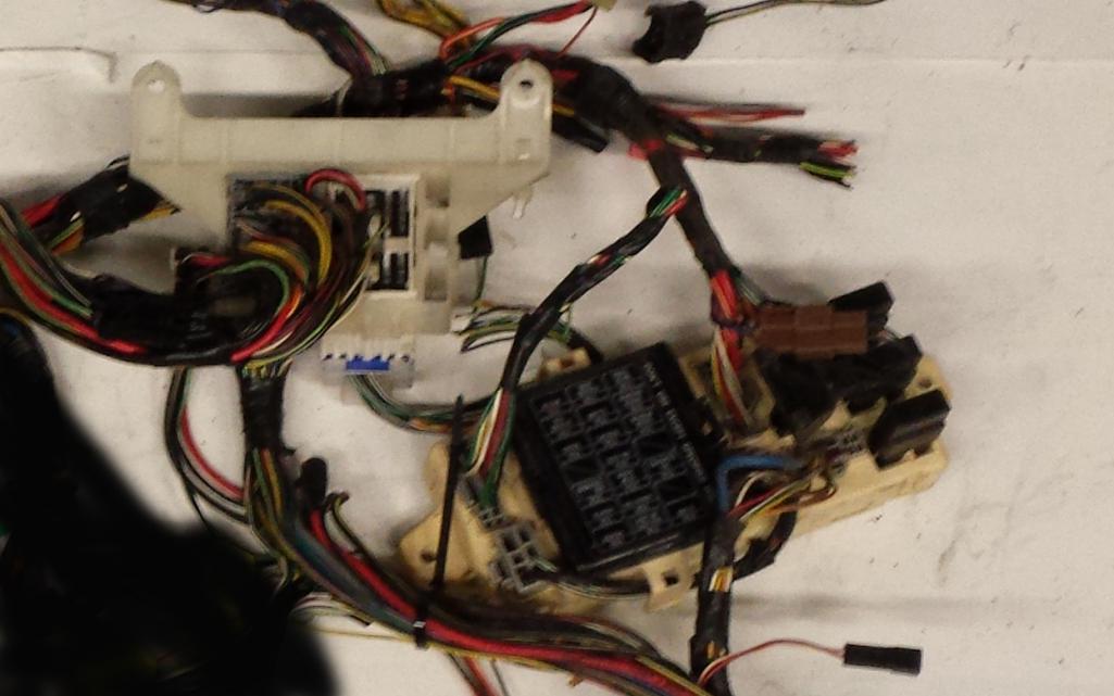

here is a pic of my harness with most sheathing removed.
there are a few good harness modification links on the internet but i am stumped at the moment as to what else i can cut off this harness.

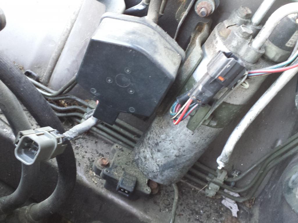

i cut plugs, 1,2 4. they are for abs, cruise control and ac. i believe. pic at bottom showing all 3 male side connectors on car.

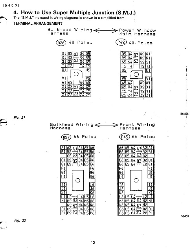

my biggest question is all the wires that go thru these two big junction boxes and which ones i can cut. especially the one with 2 smj's on it. i could use a pin out for these 2 smj's.
looks like i can cut all wires to the smaller one as it is labeled - power windows. ??
it is hard to parse loose wires when they are running thru an smj. i may cut all and tape them together, parse loose ones, and the solder the remaining needed ones.

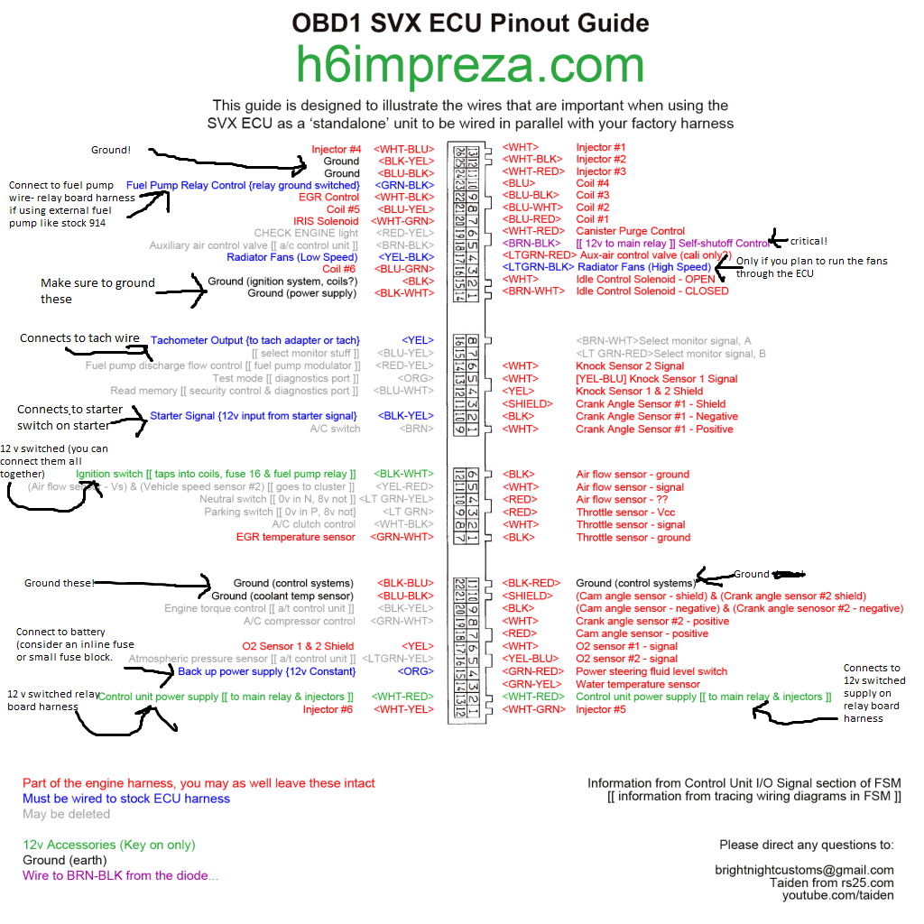

What you need to search the internet for is a "pinout diagram" that shows what wires are used when doing a Subaru conversion. These start at the ECU plugs and go from there. It doesn't have to be a 914. I have one for an SVX...looks like this:
Careful using this one it probably will not match at all. Just a reference. Lots of VWs have 2.2Ls in them now, so check The Samba.
If you click this link you will also find resources for the 1990 Legacy wiring diagrams:
Link to legacy wiring diagrams
You need this to understand how everything works. One CRITICAL thing you can't remove is the diode. The car won't start without it. You end up cutting most of the harness the way I did it. You do use the fuel pump relay, starter relay from the Subaru. And of course the whole engine wiring harness.

the harness parsing video i saw of a later model legacy went so smooth and easy but he had no smj's in that harness. the smj's make for a bunch of extra hours of removing them prior to the initial parse, it seems. thanks (IMG:style_emoticons/default/bye1.gif)

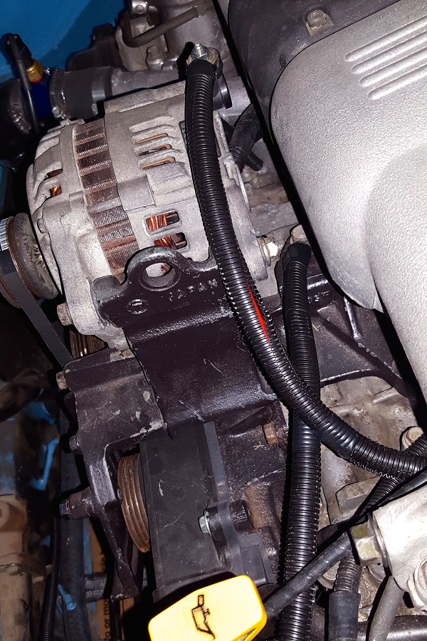

Yep, you HAVE to find where that diode goes and put it back where it was or the car will not start. You can actually wire the alternator directly to the battery using a new fatter wire. Check my thread and see how I did it.

chris,
thanks and i see your alt wire pic. are you not using the other wire bundle (red connector) that connects to alt, that gives ecu, alt power info?
jim

so one fat wire from alt to battery.
the other plug on alt is for dummy light and guage.
one problem conprehended (IMG:style_emoticons/default/biggrin.gif)
thanks jeff

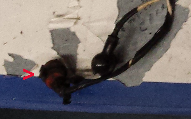

if this is a pic of diode on precut harness, its wires seems to run to one of the engine bay engine connectors. i should be able to verify tonight.

most wires i cut at smj soldered back up. gonna sit back down with harness to find the two wires for diode to connect to.
