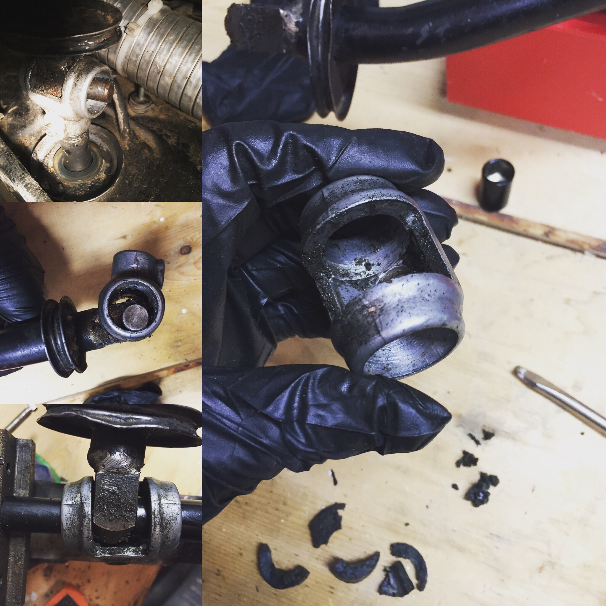

> Lost 4th and 5th now I know why

Surprise it would still even shift I guess it's time to make more new parts

That was pretty easy. But I did get some ideas of how to make these a little more serviceable.
Here's how I seated the bushings.

We had the same thing happen the day after we returned from RT66 -2013. You can also use a 1/4" long stove bolt and washer as a puller for those bushings.

I struggled with adjusting my gear shift for a couple days before I realized I had the same issue.

yes these are a paint to deal with. I'm driving today, but there is nothing you can do (other than to limp it back in 3rd) when these go out. I have a new super sexy solution to make these easy to service. Right now they only get serviced when they fail.

I had vague shifting last week and then over the weekend lost 4th and 5th. Pulled the rear shift cover off and that bushing was intact (albeit loose). I pulled the bellows off the shift coupler and not only was the shift coupler bushing gone, but so was the firewall bushing! Surprised I could even get 3rd gear.

i thin I am likely suffering from the same issue on my '76.
Lost 4th and 5th recently.
Tried adjusting the shift linkage in case the left to right calibration was off, but I noticed tons of free play between the rear linkage bar and my shift lever in the cockpit.
Is the coupling on the rear side of the firewall or inside the car under my center armrest?
Can I inspect the coupling without removing the entire linkage?
Is there a trick to removing the rubber boot at the rear of the firewall? I didn't notice any clamps and I was afraid to make a tear by pulling on it too hard.

The coupling is on the rear side of the firewall. It can be inspected by moving the rubber boot which is only held onto the firewall by friction.

Had this happen to me when I pulled the car from storage. I was driving around and went to down shift from 5 to 4 and when I went for 4 it hesitated a bit and i knew something was off. Slowly let the clutch out and rpms started to creep up. Almost down shifted from 5th to 2nd at 45-50 mph.

Just pulled my linkage out tonight.
Bushings were blown completely apart.
The knowledge I learned from this thread made it a quick job.
Set it in my vice with some sockets and the pin came out easily.
Now to wait for the pelican parts bushing kit to arrive.
