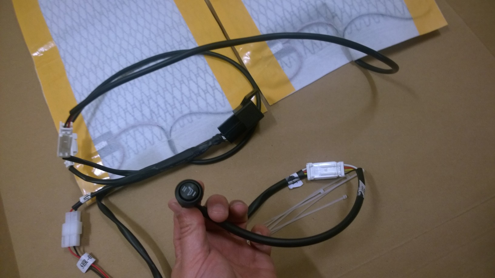

I've been selling these for awhile. There are several different kits you can buy.
I think these are the best for a few reasons
1- they are a carbon fiber net that can be trimmed easily to fit.
2-they are self contained requiring no additional parts - relay included, on off switch included. Harness is included
3-They have directions
4- Low current draw
5- They are reasonably priced
http://shop.914rubber.com/Seat-heater-asse...m?categoryId=-1

i installed these in my seats and the are awesome!! I have a center console so I put the on/off buttons in there, and ran my wiring back to the battery directly, and yes they are on their own fuse in back , only draw back is that they are not switched with ignition but, I have a quick release on the battery and usually flip that off anyway. -
