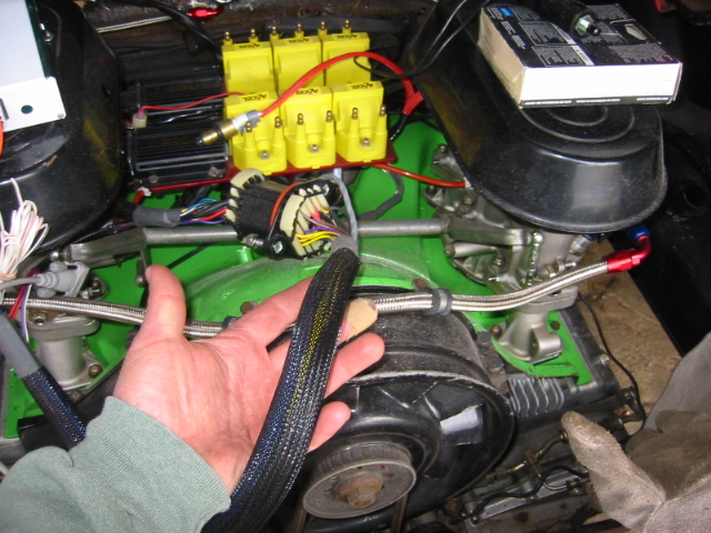

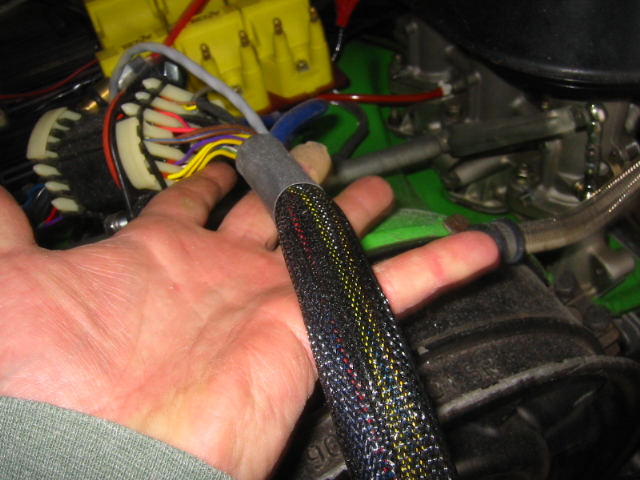

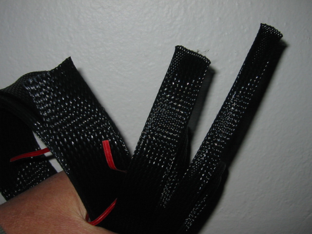

TimT
post May 2 2005, 07:17 PM
retired
Posts: 4,033
Joined: 18-February 03
From: Wantagh, NY
Member No.: 313
I also think split tube looks cheesy and cheap.. even if it is OEM. I use braided material, and heat shrink tubing. The braided material comes in a number of different sizes, and can accomodate as few as 1 to over 50 conductors..
With this braided sleeve you can branch out conductors where ever needed, Use some heat shrink at the branches and terminations.

Hey Tim....what the heck is that connector attached to the wiring harness???
