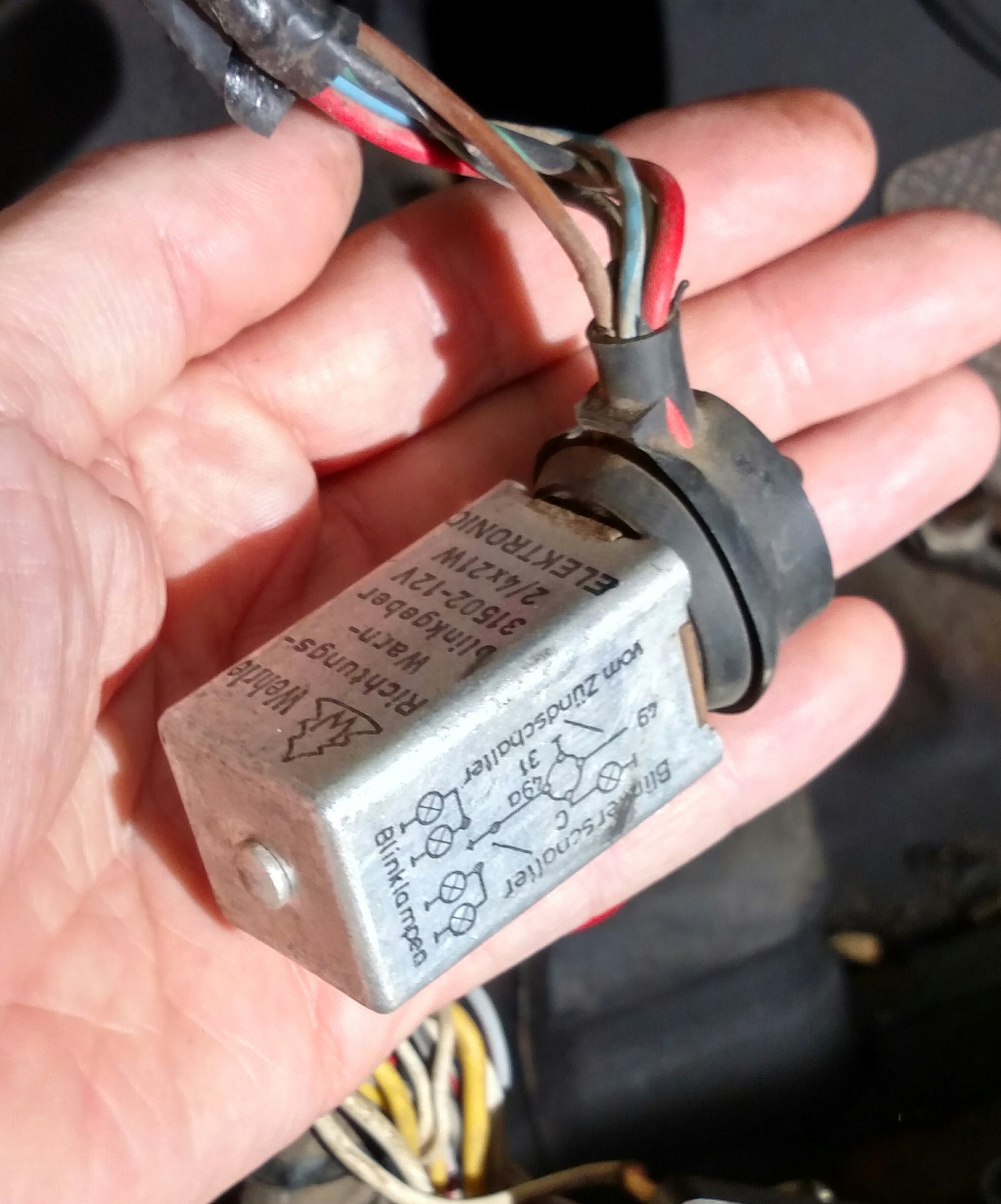

Attached is a pic of a relay stuffed in the dash. This buzzes. Is it supposed to buzz? I thought the buzzer was saposed to be under the pass seat.

The relay you picture is the flasher relay.
