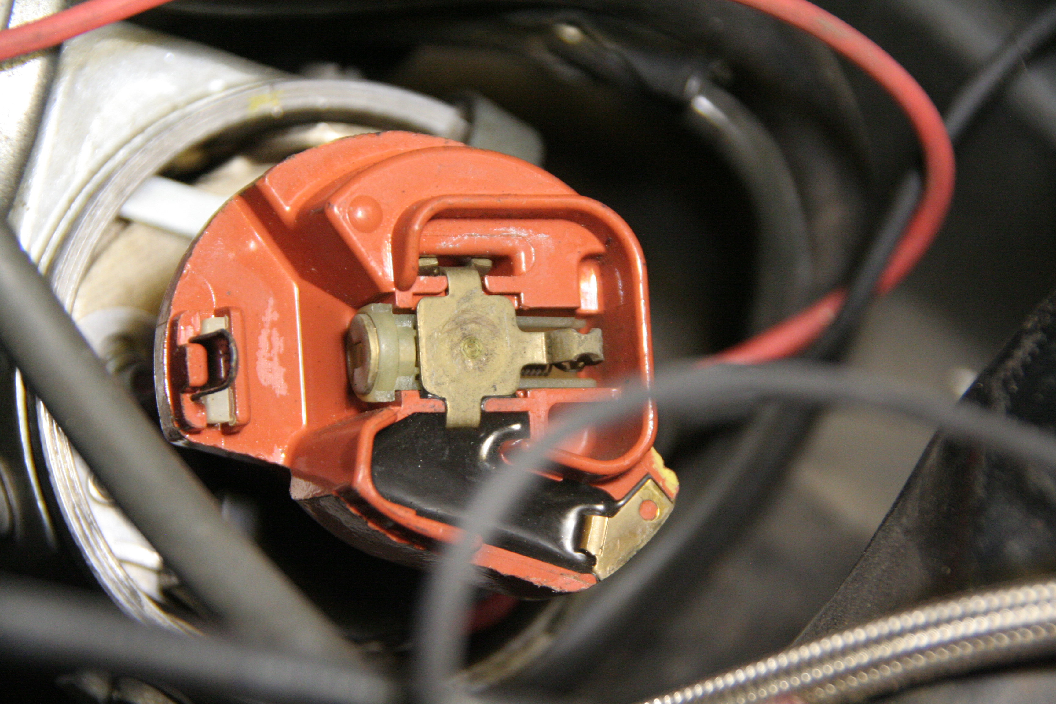

914 RZ-1

Rotor pic:

I've checked the following so far:
1. Fuel injectors are all good. I checked them with a 9V battery and they all click. They all had gas on them, too.
2. Coil looks original. Haynes manual says to test voltage at terminal #15. What do I connect the leads to? The terminal and then ground the other one? Sorry if this is a stupid question; the Haynes manual assumes I know what I'm doing, but this is all new to me.
3,4.: I posted pics, but these seem to look good. Let me know. I ordered new ones from Pelican anyway.
