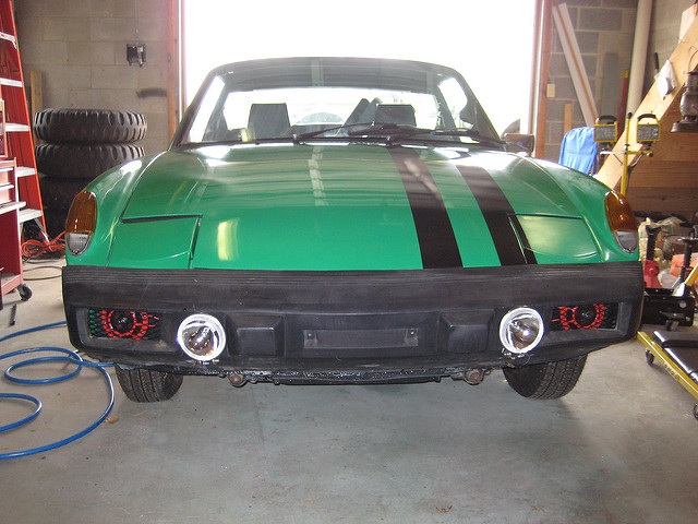

(IMG:http://www.914world.com/bbs2/uploads_offsite/c2.staticflickr.com-1435-1494298941.1.jpg)
You can see how I mounted mine.
With the supertones, they are directional horns. They are a lot louder in the direction they are facing. So if they are placed facing towards the street, or off to the side, you are going to loose some of their effectiveness.
Also, if you don't use the relay, my experience is that the horns are not very loud, and they sound almost like they are winding up.
With the relay, and a fat gauge wire that goes to the battery to feed them, they are instantly LOUD. Which is what you want in a horn.
Mine make the people in front of me jump when I use them.
Zach
