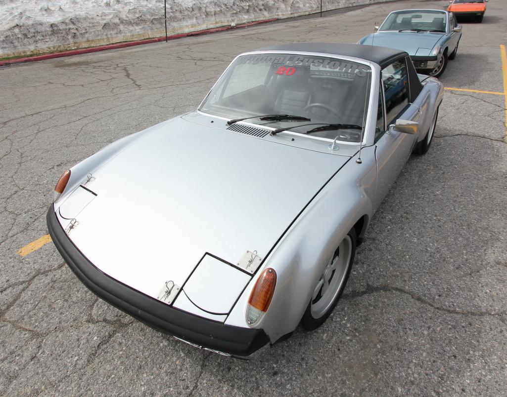

If you're a friend of Eric Shea on Facebook, he outlines a pretty detailed GT build with his car...
And it looks amazing!

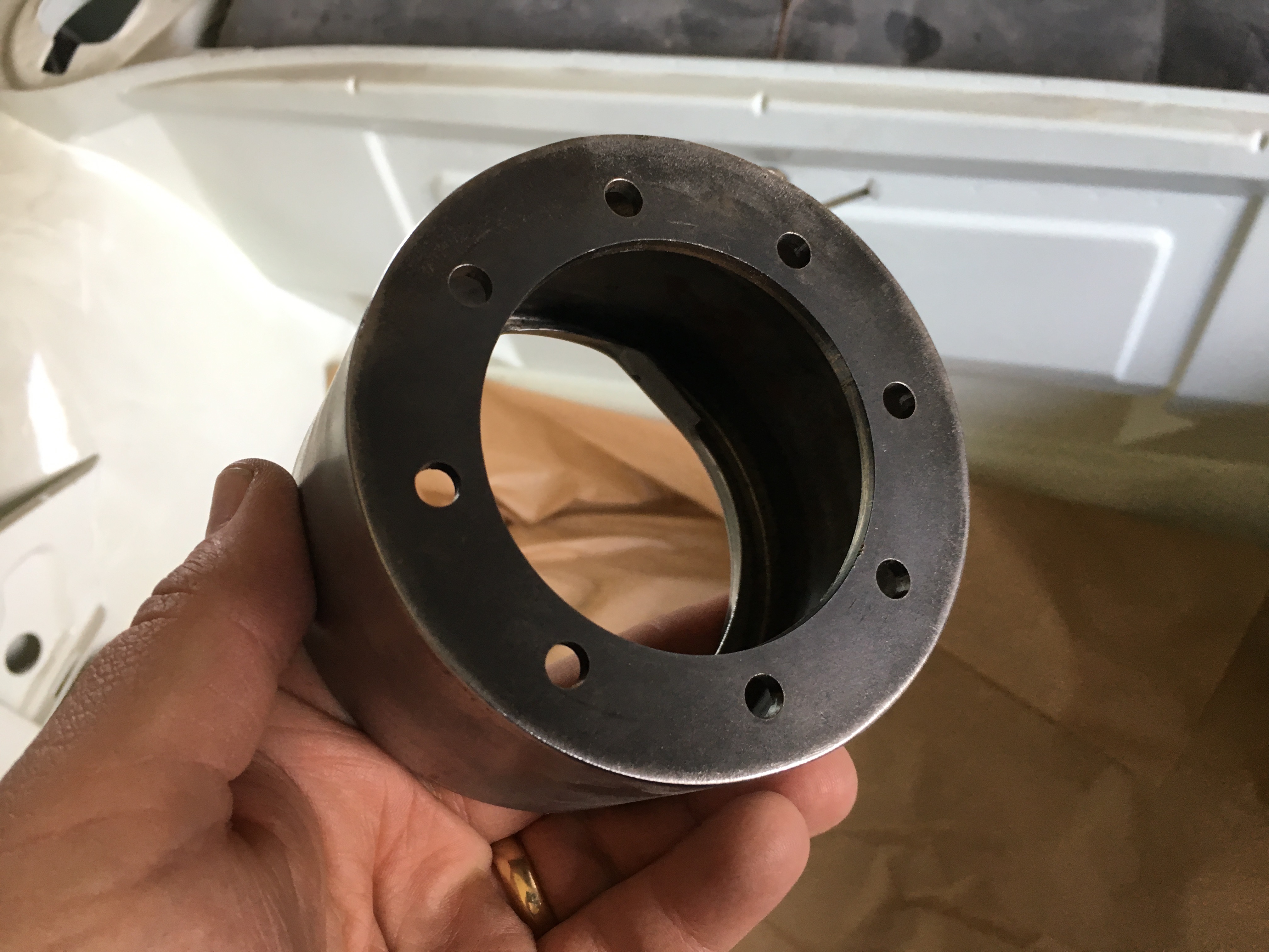

Hi guys
As I wrote in my for sale tread of the Hood pin kit
http://www.914world.com/bbs2/index.php?showtopic=308364
We are working ( in final production ) on a "plug and play kit" with no welding requiered
I did the kit , most dealers sell like SMC, restoration design etc a good 5 years ago
http://www.sierramadrecollection.com/911-R...Kit-p25309.html
The kit will have the same Blau 110 mm cap and 5 hole fin
it will have the "dog bowl" overfill etc in basic all you need will be in the kit
To give you a idea how it works , you simply just screw it on ,
the kneck will have the correct angle to the hood and will line up at the same height
I cant show you all the secrets right now (IMG:style_emoticons/default/WTF.gif) but you will like it for sure (IMG:style_emoticons/default/biggrin.gif)
I will soon make a for sale tread ,we are just in final production packing these
,and we will be shipping these in august for sure , so dont spend all your cash on your girlfriend in the hollydays :-) priced ca at 350 EURO

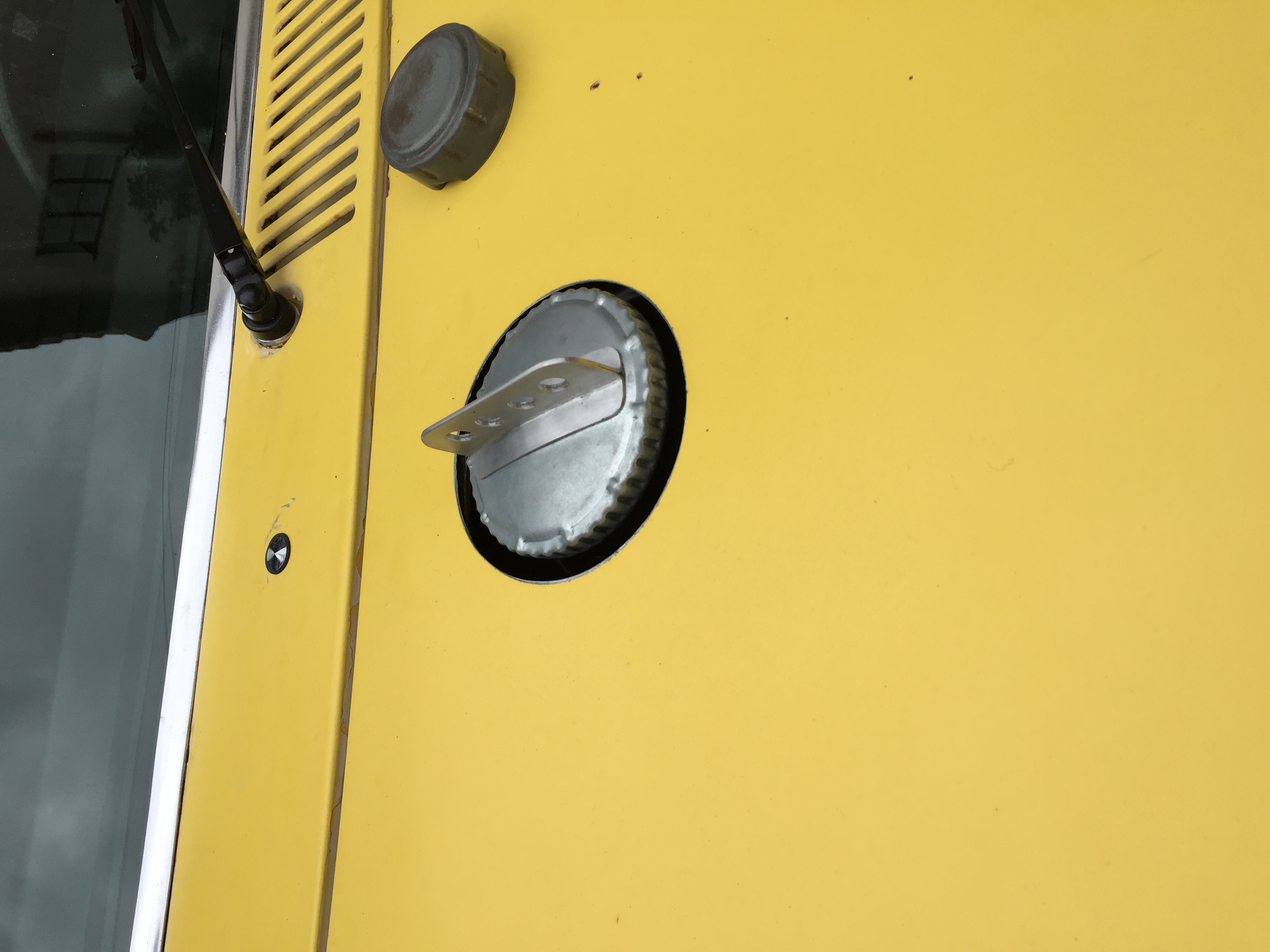

Went to a salvage yard and had them cut out the filler door section on a 99 Ford Pickup. Trimmed the sheet metal and cut a hole in the hood to match. Stitch welded the opening in the hood for a flush mount.Attached Image Attached Image
