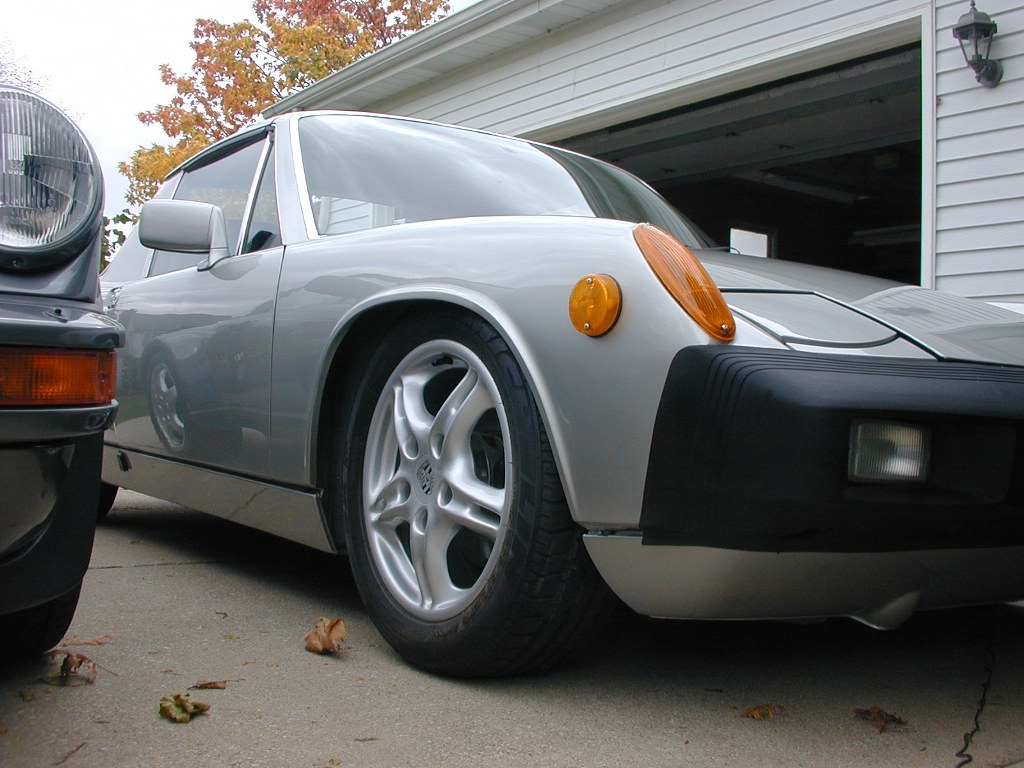

I am shopping for 16" Boxster wheels for my six. Love the look on Jim's car below. They are 6's and 7's. I want four the same, don't care which width. Anyone have the same interest? If I find four I want to swap with someone else so we each have four of the same size. Jim has all 7's on his car now. He says 6's on the front require a spacer to bring the wheel out a bit for appearance. I see them go for $300-400 a set on Ebay.

I think 7's would be too small on a flared car, at least if it had standard GT flares.........you'd need about a 2" spacer in the front and a 3" spacer in the rear to look halfway decent with GT flares
the 7's have a 40mm offset ("just" about right for the rear, you might want a 5mm spacer)
for the fronts with a 7", a 1" spacer will make it look better....
the 6' has a 50mm offset

Here is a picture of my car with chromed Boxster rims. I have 7" in the front and back. In the I have 1 3/4" spacers and in the rear I have 1" spacers. The rear tires are 245X50X16 and the front tires are 205X55X16.

I love those boxster rims on the silver 914!!! What 5 lug conversions can you do with the 7" wide and w/ the 6" wide? When would you need spacers? oh yeah no fender flares here. thanks

6x16 with 195/55's on all four, stock fenders.
Goose2 and I did the trade mentioned in the first post. He has the 7's.

I went with all 7X16's with 205's. No spacers, no fender mods.....perfect offset for the teener!
