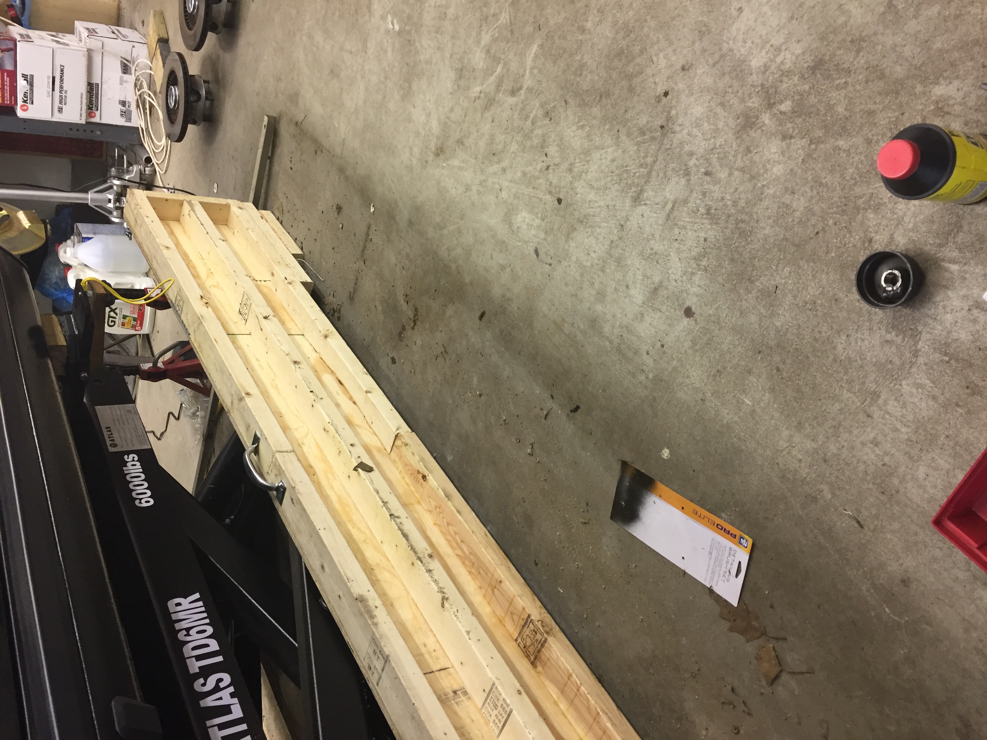

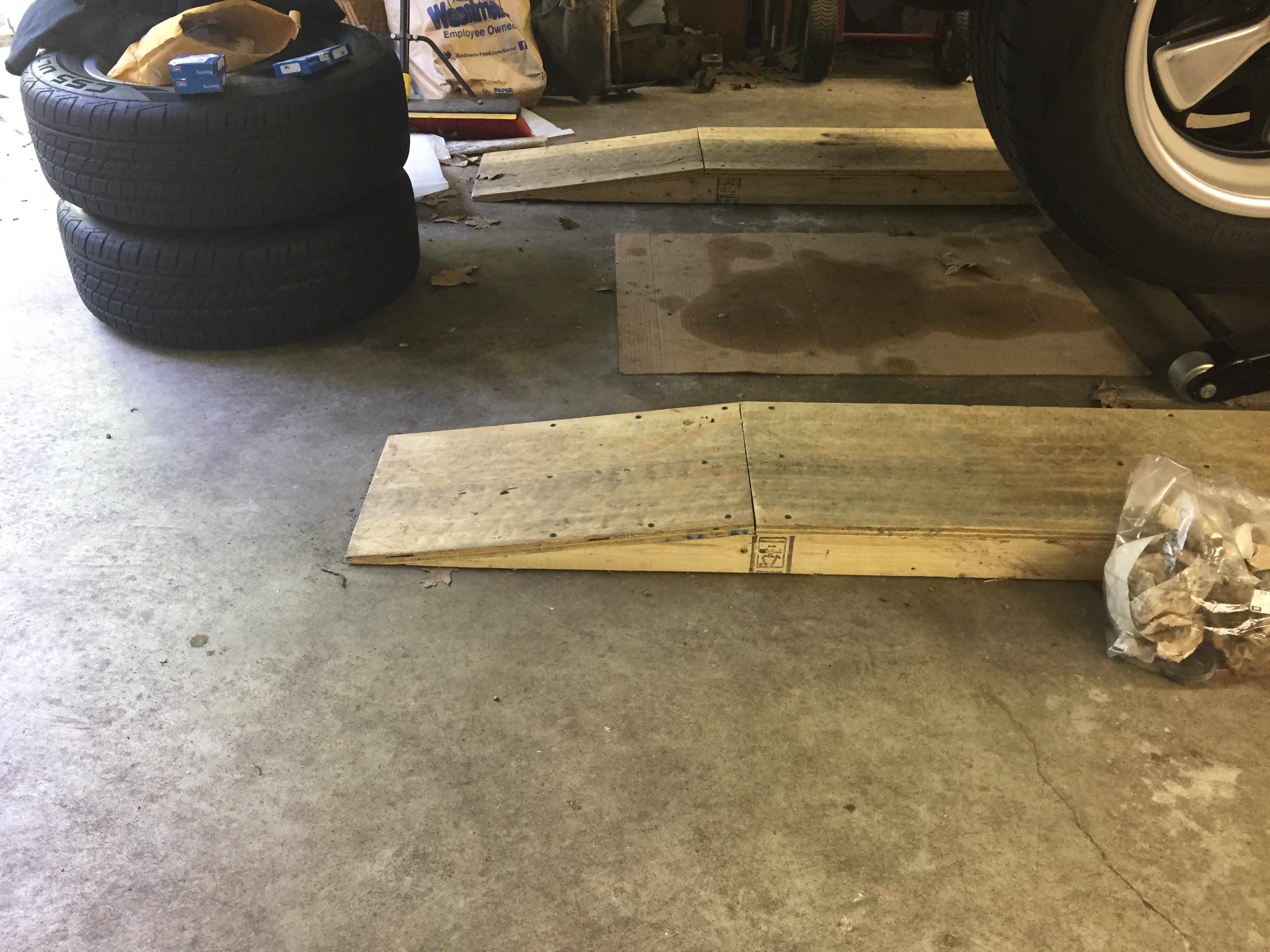

The ramps were an easy project made with some 2x3" lumber and 3/4" plywood decking. Attached Image

I realize these photos aren't helpful to the original poster, but are shown to help others that may want info on how to construct ramps. Mine are 140" long and 12" wide and attached handles on the side make them easy to move out of the way if desired.

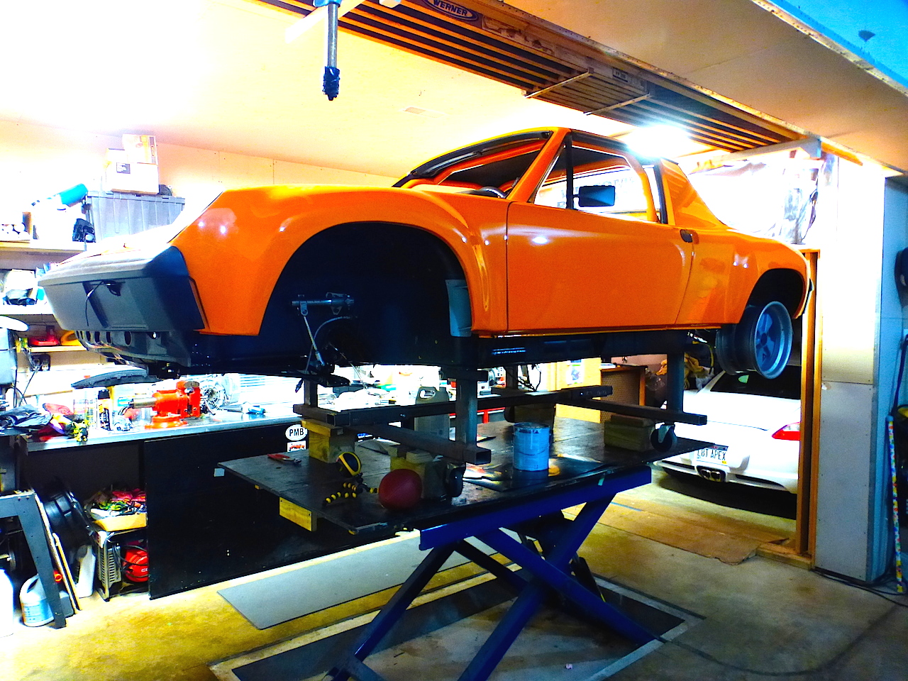

Michael, sounds a little familiar.....you will love it. Best, MarkAttached Image
