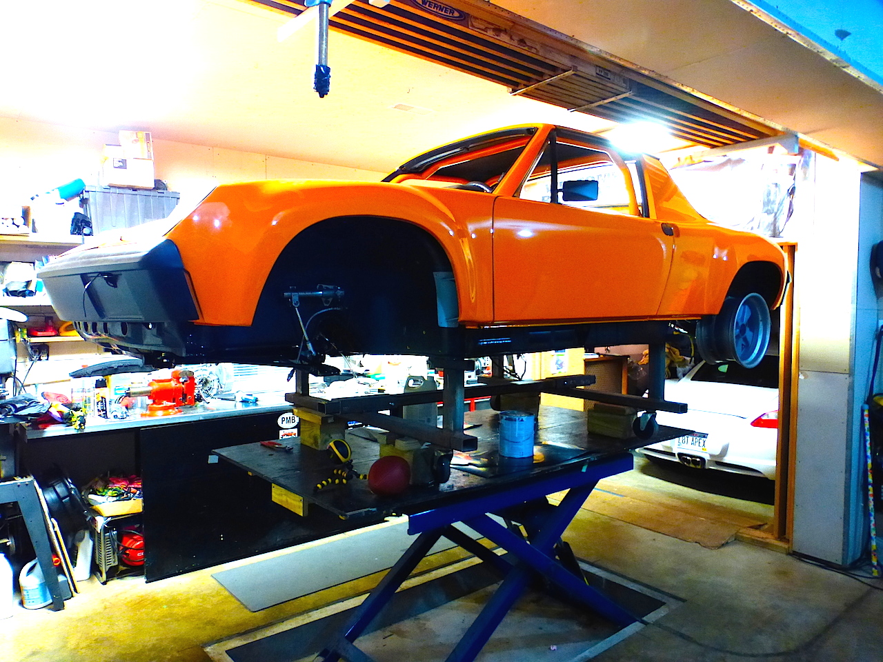

Sounds like an awesome plan and much like Jack Olsen's garage which is incredible.
http://jalopnik.com/the-amazing-diy-porsch...rage-1668857982

I have seen Jack Olsen's thread on Garage Journal and that was the thread that convinced me to go with porcelain tile. Since then I have done a ton of reading and if installed correctly, and that is the key, it is as hard as concrete floors. Plus it looks terrific and is easy to keep clean.

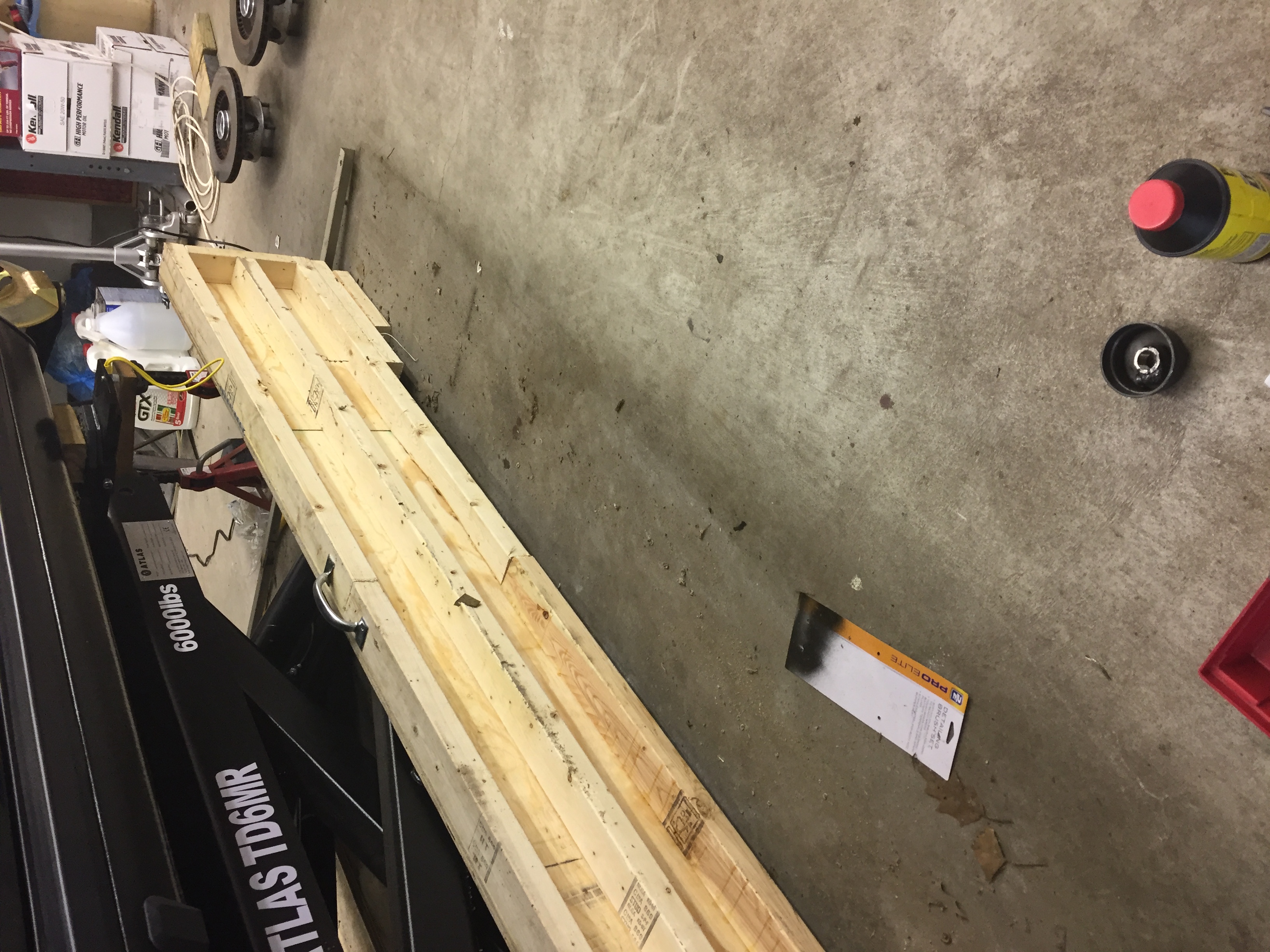

I built a ramp that I drive up on to clear the lift. I didn't want to fool around wth the concrete and if I move someday I can take the lift and ramp with me. I found instructions for the ramp on the Ferrari forum and just copied it. I park my car on it.

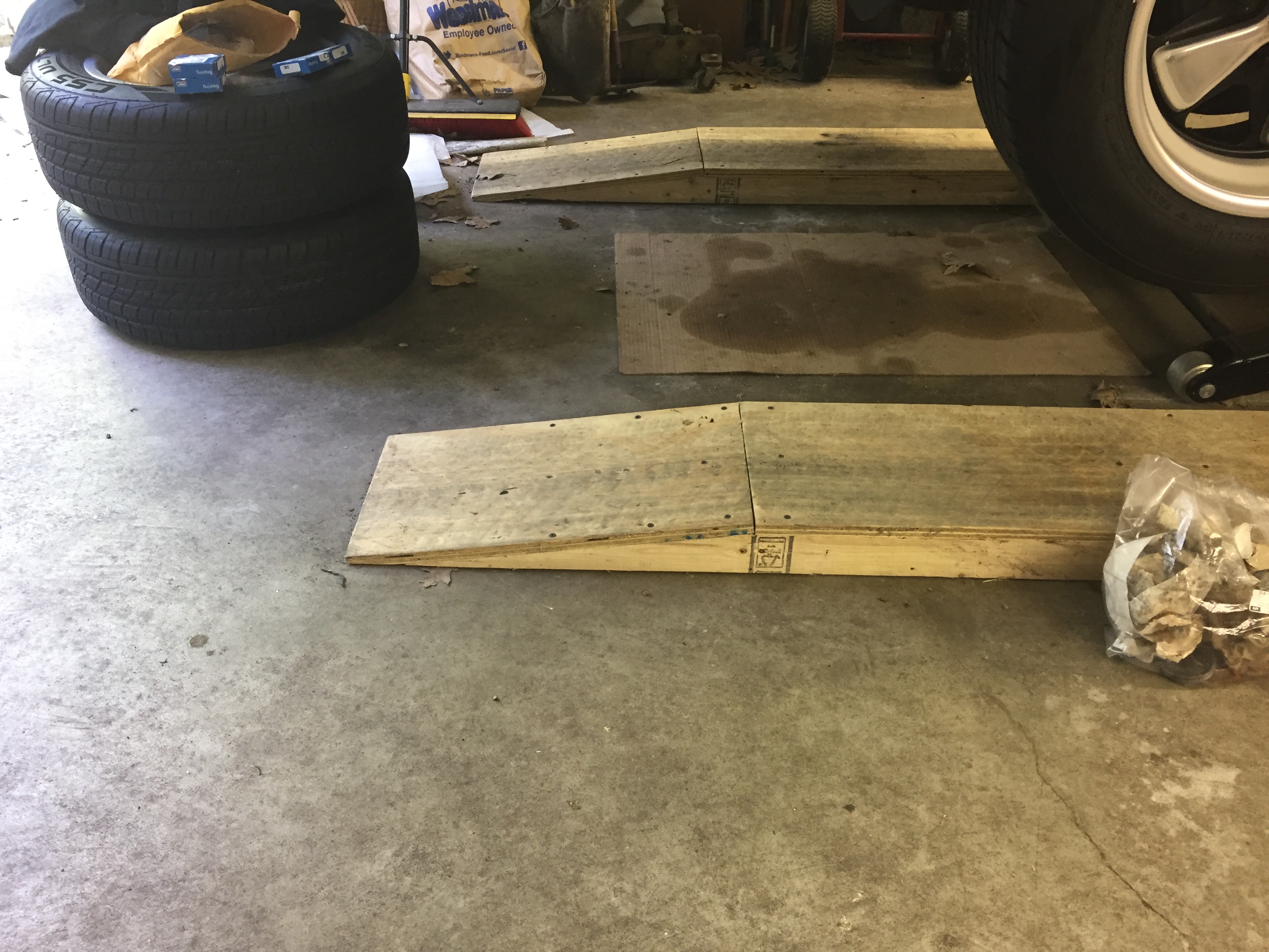

The ramps were an easy project made with some 2x3" lumber and 3/4" plywood decking.Click to view attachment Click to view attachment
GeorgeRud
I realize these photos aren't helpful to the original poster, but are shown to help others that may want info on how to construct ramps. Mine are 140" long and 12" wide and attached handles on the side make them easy to move out of the way if desired.

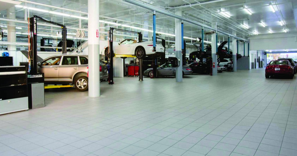

Tile works fine if installed correctly. If it's good enough for these guys, it's good enough for me.
