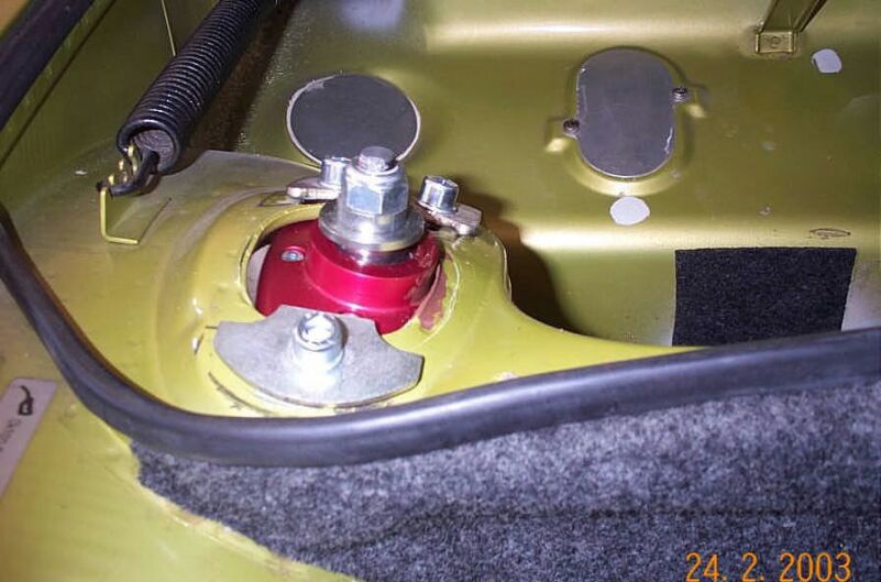

| J P Stein |
May 18 2005, 09:58 PM
#10
Irrelevant old fart ![]() ![]() ![]() ![]() ![]() Group: Members Posts: 8,797 Joined: 30-December 02 From: Vancouver, WA Member No.: 45 Region Association: None |
I went to a lot of time, $$ & effort to get -2 up front.
Now I gotta undo it. My new tiars like -.8 or so. Problem: I don't have room on the pass side front.. tire to fender...to let it out. Gonna wait till next winter to booger up my new paint job there. Attached image(s)

J.P.- those are the same camber plates I've got- see my post on adding plates, losing ground. What all did you need to do to get to -2.0, and what tires are you running now that don't need all that much camber?
