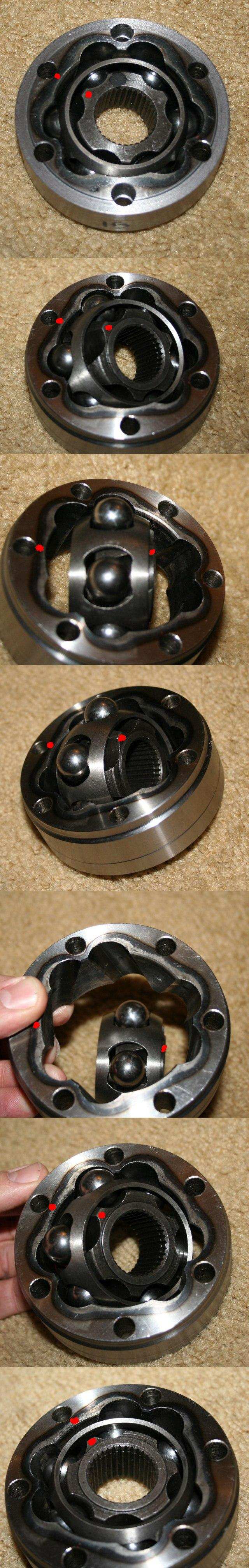

I am attaching a pic with the correct alignment...what I noticed when I was playing with it was if it is wrong then you will have the two narrow ridges in the lands facing eachother (I have highlighted those in red in the pic...red together is wrong) ...when you have it right the inner narrow ridge will be sitting inside the wider outer ridge...I have highlighted those in green...green is good)

Garry that picture is excellent! I found out the same thing (see above). I nominate this thread for classic status. It would nice to have that pic where you can find it easily. Other peopel are going to want that picture later.
What do you guys think?
I reduced the pic to 800x600 to illiminate the horizontal scroll bar.

Gint - not my picture, but it is a great one. I wished it was posted here before I hosed my CV - that's exactly what I did. I cannot get the damn thing apart again! I doesn't make any sense to me, I consider myself pretty good mechanically, but what's going on here? It went together easily - wrong - but no joy in getting it back apart. The cage moves some, but not enough to rotate it out. I'll post a pic later.

Mike Mueller provided a very good write up with pics in a recent htread in the garage.
massaging the balls
QUOTE(Mueller @ Jan 14 2007, 12:15 AM) *
follow the red spots..pay attention to the how the "point" goes to the "wide" section of the mating part.
starting at the top picture, if both hands are on the CV at the 9 and 3 o'clock postion, your fingers on your left hand would be pushing "up" while your thumb on the right hand would be pushing down.
When the middle section is about 90° to it's original postion, it will slide right out (with a little help, but not much)
reassembly is reverse...
