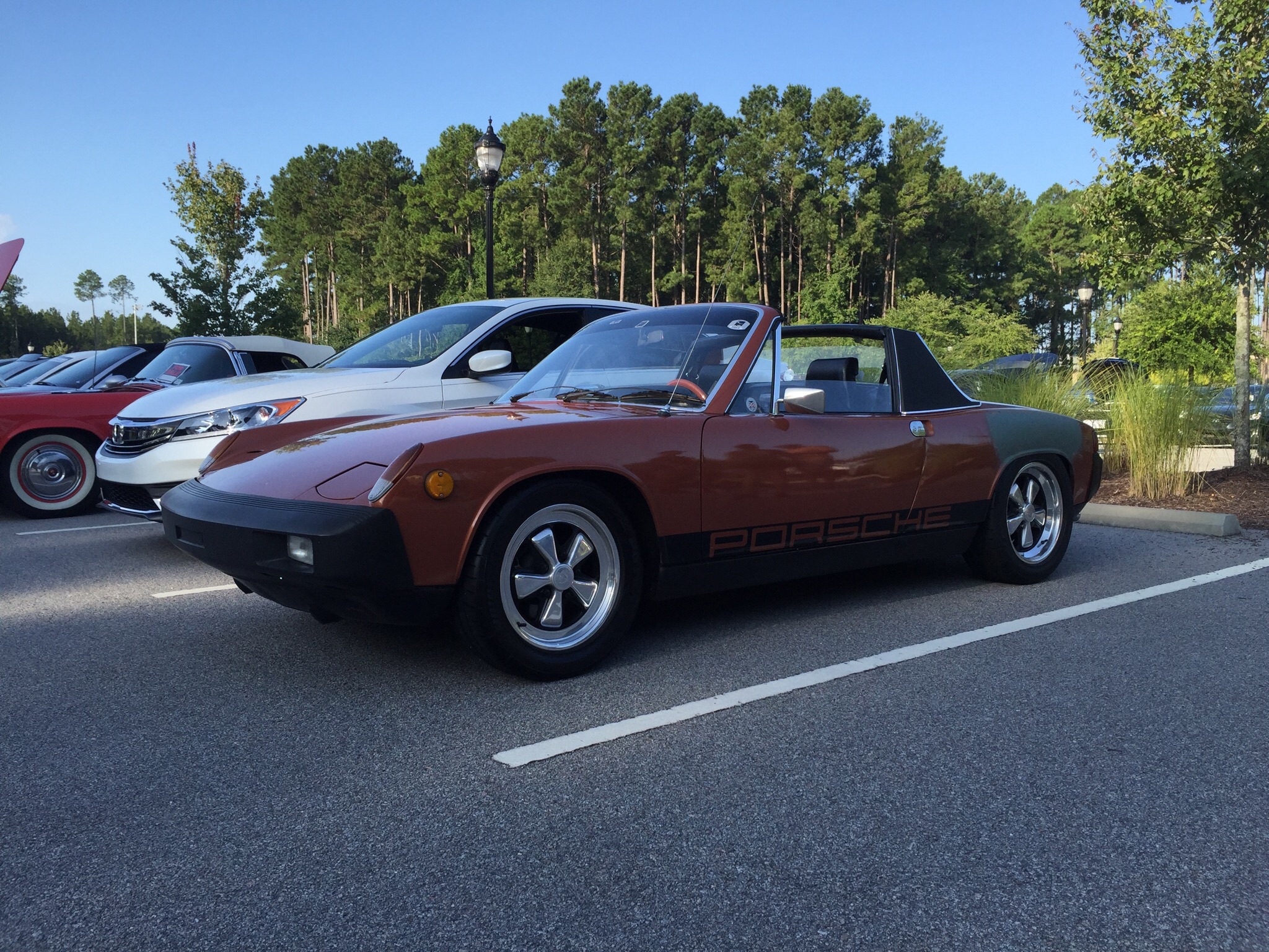

Here's what my 205-55-15 tire look like

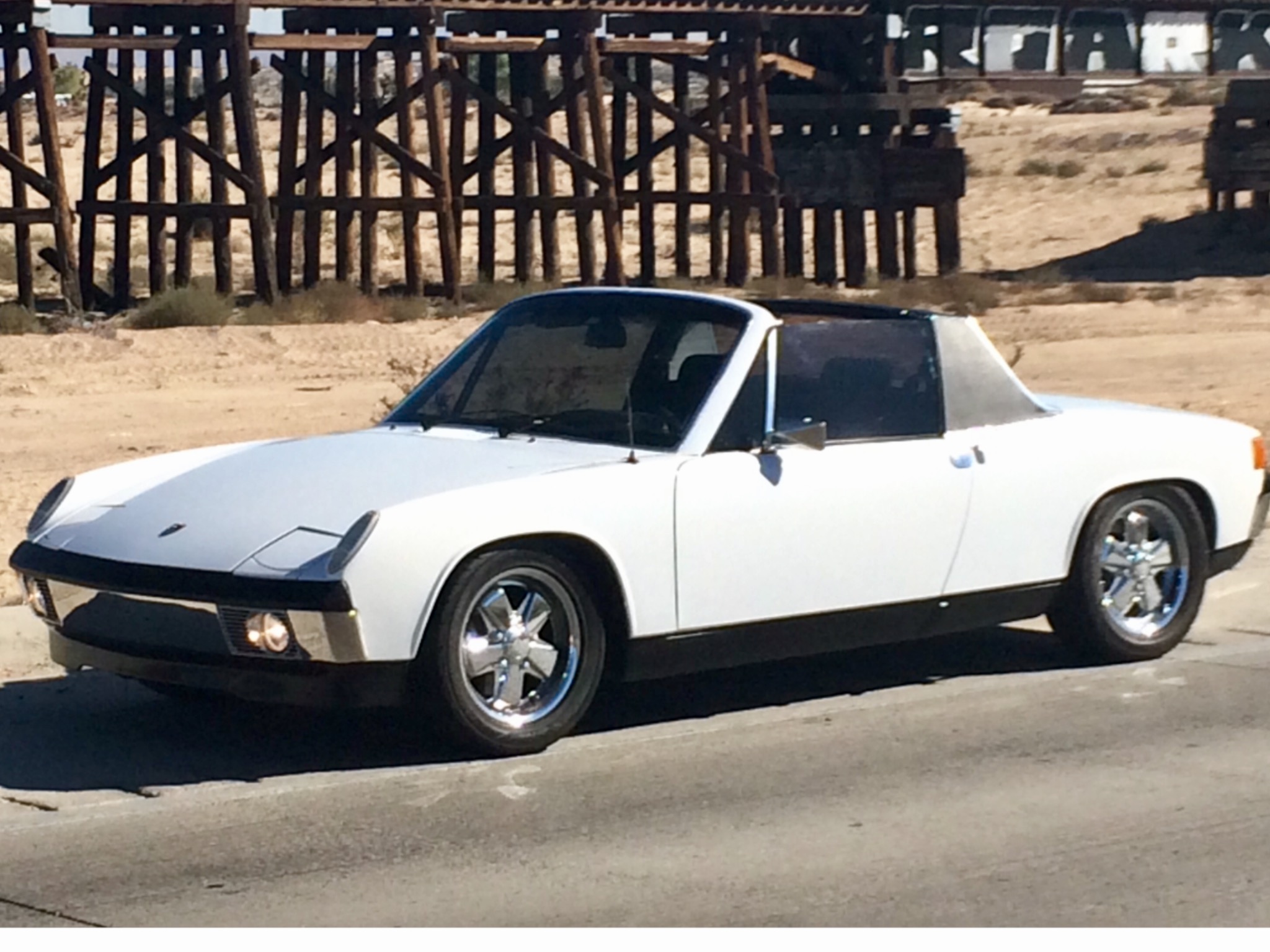

I am running Dunlop Direzza Star Spec 195-55-15 tire (no longer available). It made a noticeable difference in ride height. Getting in and out is a bit more difficult. The front fender fill looks good, but the back has some gap on the front and back of the wheel opening. The speedo is off. Hole shot acceleration is better, but more shifting and higher rpm cruising at speed is the con. I have the LE spoiler too, but not installed. I'm worried it will scrape when I pull in my driveway as well. I had 195-65-15 Pirelli P6000 tires before. They actually had a stiffer ride than the lower profile Dunlops.

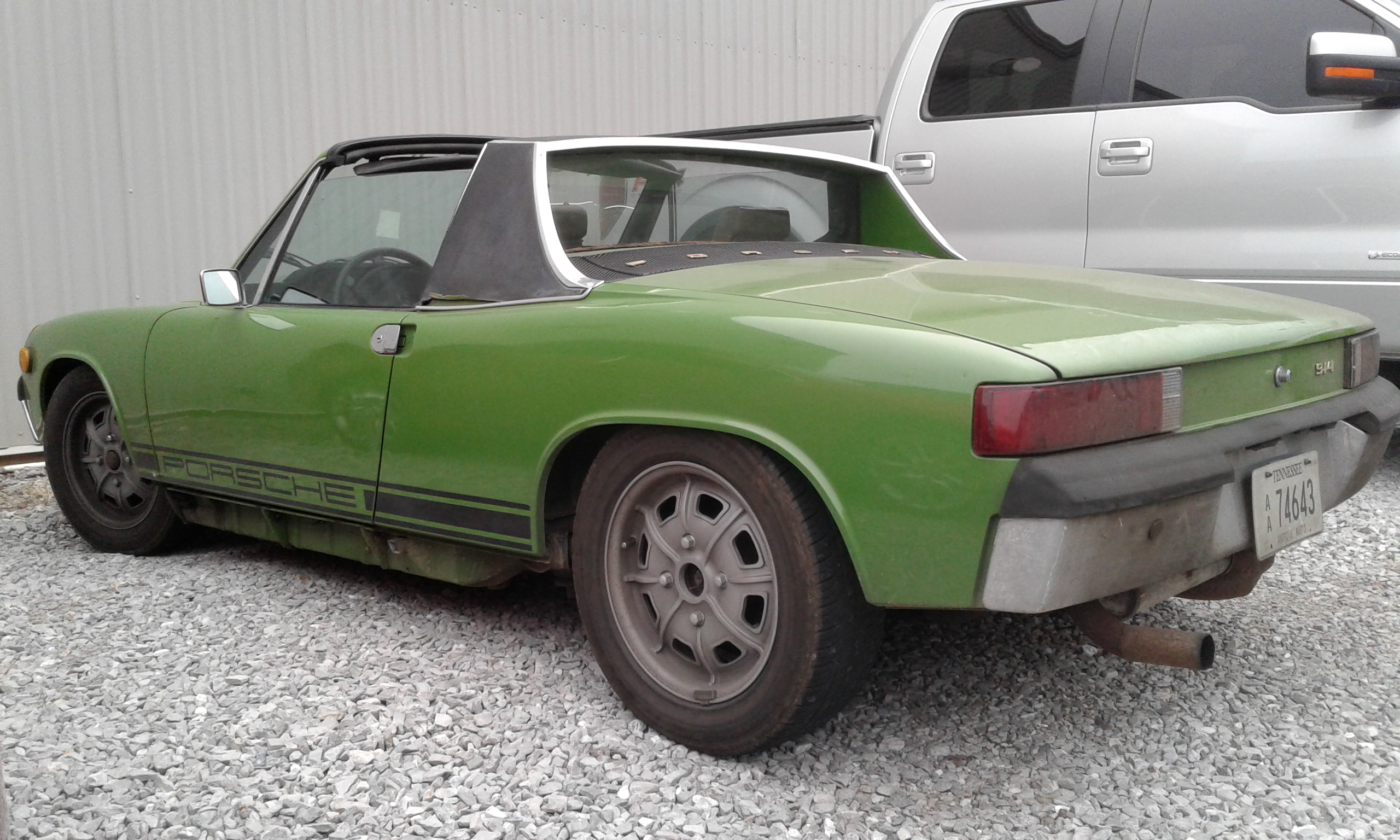

I used to run 195/50-15s. I liked them at the time. Eventually, I liked them less.
(IMG:http://www.914world.com/bbs2/uploads_offsite/forums.pelicanparts.com-121-1505109211.1.jpg)
I had originally used 195/60-15 in the same make and model, and found several differences when I went to 50-series tires:
- Lower gearing for better acceleration out of corners
- Stiffer sidewalls resulting in (slightly) more grip
- Better feedback from the tires
- Harder ride due to shorter sidewalls
- Freeway speeds required ~500 RPM more
- On a few autoX courses I had to shift up to 3rd and back, costing me some time
When I went to 50-series tires, I was finally able to feel the car well enough to catch a slide before it evolved into a spin. I had never done that on the 60-series tires.
Eventually, having to run higher RPMs on the freeway did get to me. The type of tires I wanted to run were also becoming harder to find in 195/50, so I wound up going with 205/60-15s.
--DD

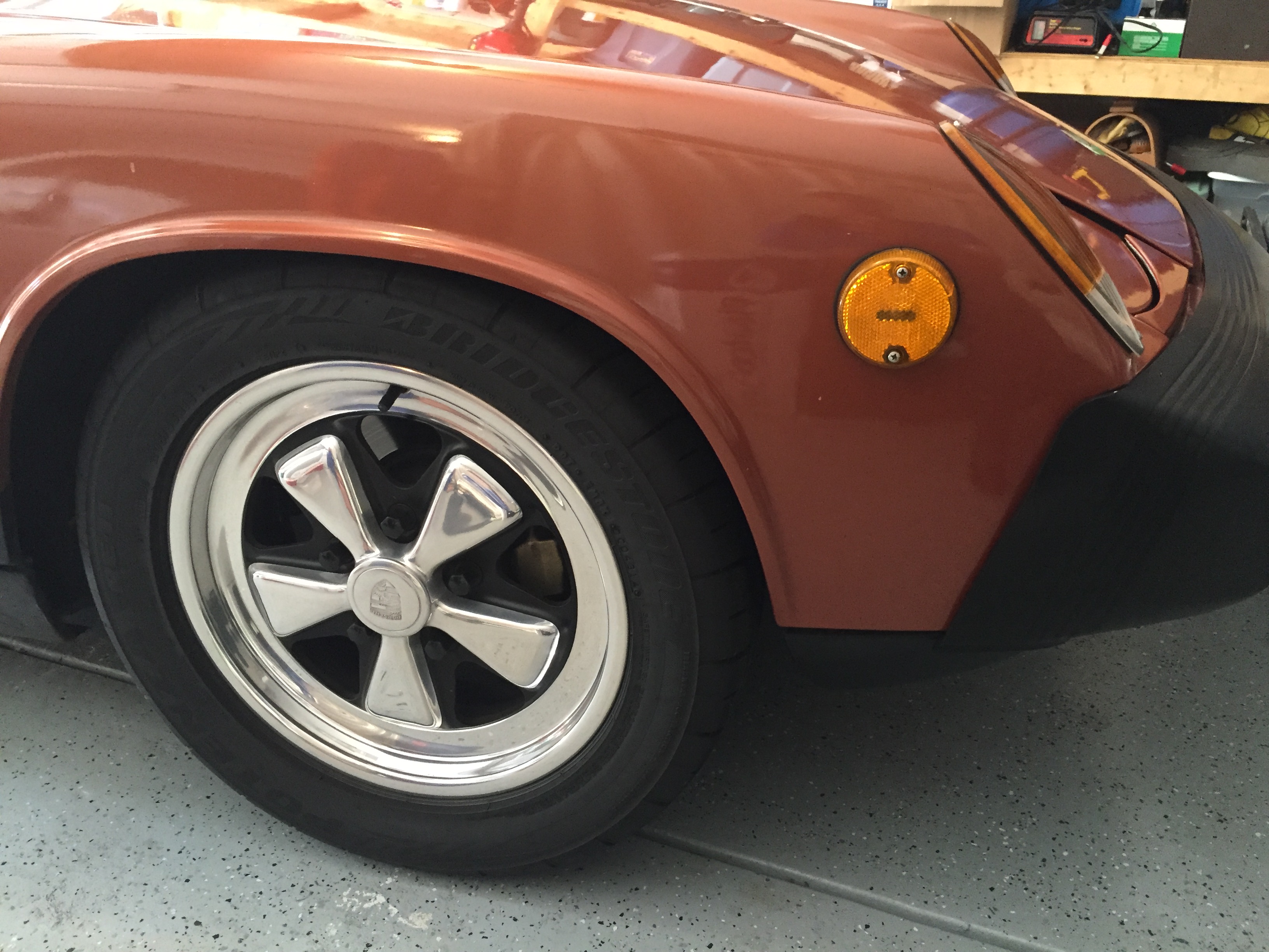

ive run 4 diifferent rims and tire set ups on my car-
- in summary, the 14" 5 lug fuchs from a 914-6 were a taller tire an so ride was much softer - you can see them on my car in the August 914 calendar for this year, i was running them at Okteenerfest on tail of the dragon couple years ago- nice classic look and a comortable ride if you have lots of bumps- i assume a stock 15" fuch with standard height tires or like a 195/60 or so should be similar.
-my current set up is 16" fuchs from a 911-6" front and 7" rear, 205/55-16
really these are stock size for a 911 but i should have 205/50 - 205/45 would be pretty harsh id bet- i like the feel right now, fairly firm and super awesome grip with the Bridgestone Poteza tires once warmed up very sticky! with 8.5" tread on rear( this is the actual width of tread on ground with a 7"rim) its more focused toward performace than ride comfort- I also like the look- the tires and wheels fill up the fenders with out looking jacked up and no rubbing- i have 5/8" spacers on front to push them out a bit and it looks way better than the 14" or 15 with low profile that looked so small inside those fenders -
i saw all the same issues that Dave listed with positive and negatives
good luck with your Journery
Phil
