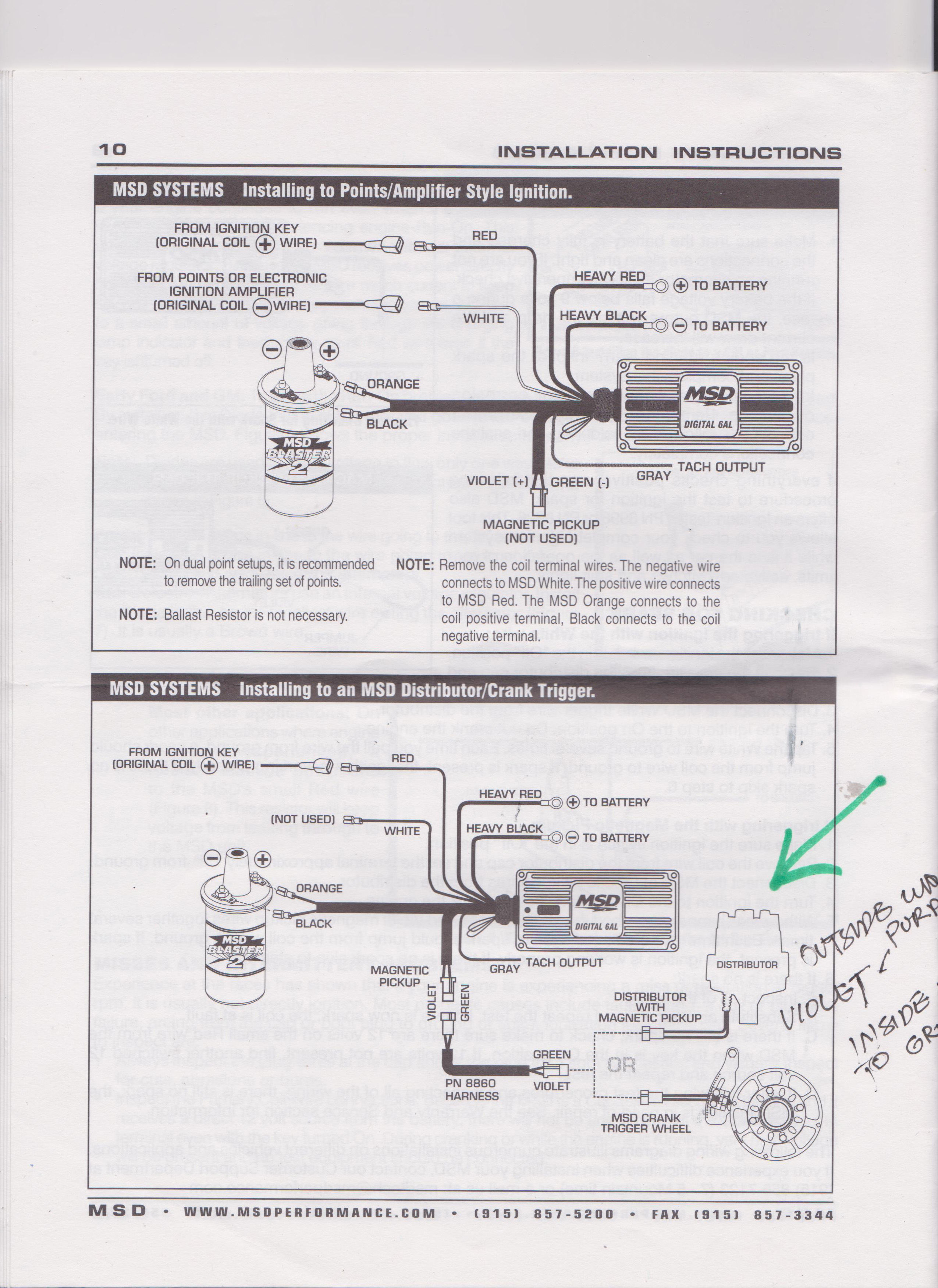

All leads from the MSD plug to the P.K. wiring harness (that has been flawless for the past several thousand mile of seamless spark) show continuity. the coil is good to go - as proven by exchanging Keiths with mine and mine with keith's... His car runs mine doesnt.
We performed several Parts Classic tests to prove that the distributor is good and not fouled in any internal way. I replaced the 85 dollar little green wire (Pelican Parts... ridiculous (IMG:style_emoticons/default/WTF.gif) ) then replaced the coil wire with another MSD unit with the "Power Tower" to allow a standard coil to mate to MSD proprietary wire ends.... another (IMG:style_emoticons/default/WTF.gif)

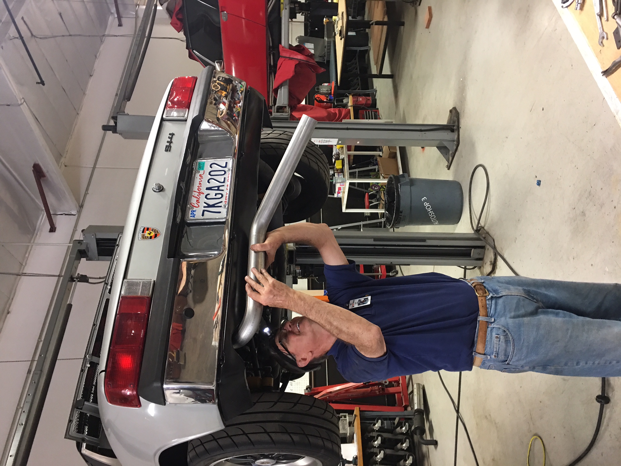

for general interest, a pic of our pal keith working on his car in the coveted upright position............

A question for MSD 6AL digital box people: Is there a rogue security feature kill-wire in the harness as delivered from MSD? I seem to remember something about using or not using a wire as a kill switch to ground...... maybe the white wire (unused in the diagram)
if so, that could be grounded somehow and simply killing my spark.

I would think you want to isolate the white wire, because in most MSD units that is for points. At least that is how I remember. Is it a 3.0? I am asking cause I just replaced the ignition box in my 911 with MSD. Digital is supposed to be more robust; I have an older one.

Does yours have the LED that blinks when it first gets power? Just switched to a 6AL a couple months ago when my VR went to 17V and fried my Mallory Hyfire box, the Unilite module, and my new Odyssey battery. 4 things bad made it hard to troubleshoot. Chose the 6AL for the diagnostic LED and the quick-change harness if it goes bad again.

What kind of pick up are you using as a trigger? Magnetic or other?
