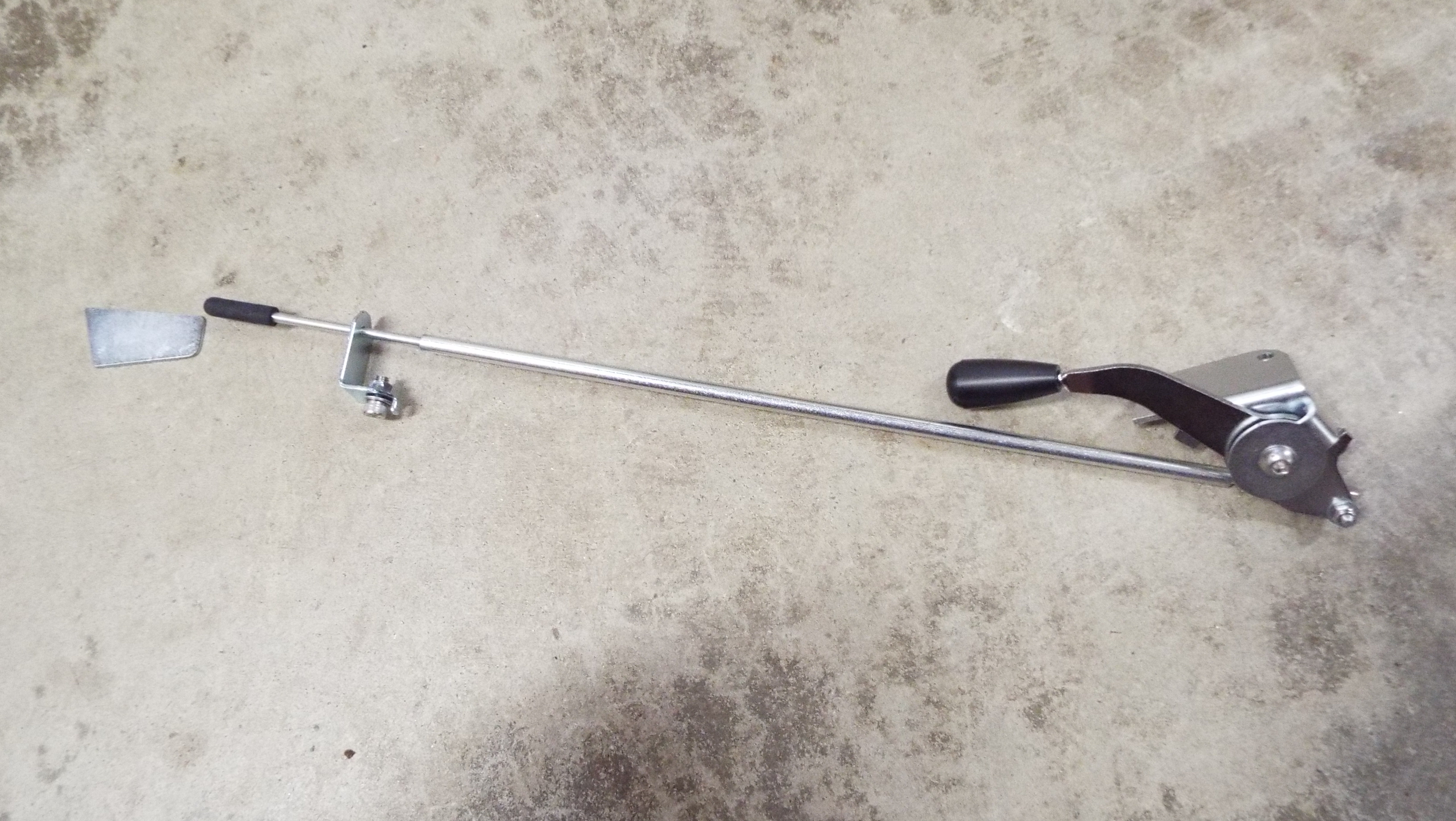

Agree! I was surprised at what I received as the picture on 914 Rubber did not show the "Shark Fin" or mention there was welding involved, or drilling and bolting, as the case may be. Also agree it would have been great to have the thing all ready to install. Perhaps in the future.
(IMG:style_emoticons/default/white914.jpg)
Picture from 914 Rubber site.

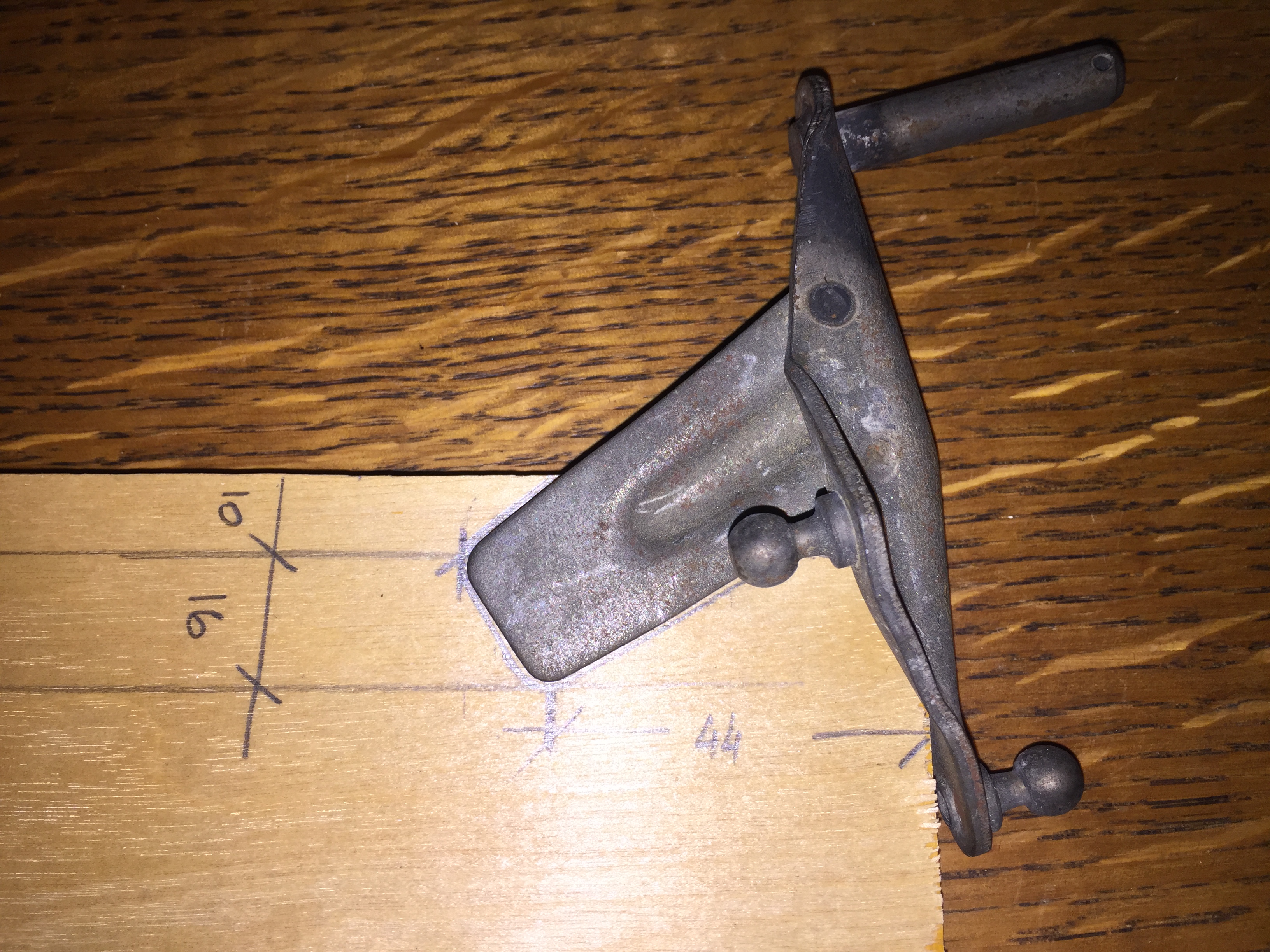

Here you go, I tucked the corner of the wood template into the leaver on the point where the flange changes direction
I assume 914 rubbers fin is exactly the same dim / shape. Looks very similar
Real fin has a dimple for strength / held on with a couple of small spotwelds
All dims in MM, dimension to the other fins corner is 55mm
Perfect illustration.

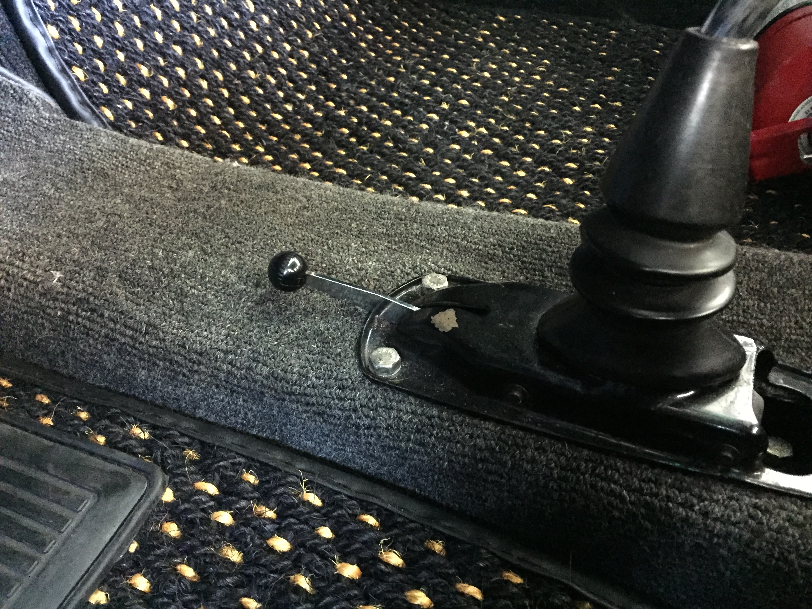

Just for kicks, this is my set up. Genuine 914-6 set-up in the tunnel and on the pedal. I used a 911 lever for it, and there is a knob Porsche made that says "Throttle" for my type of lever too. I think Eric Shea's car has one....?
It is good for cold starts, and it does work for "cruise control."
Thank you most helpful! (IMG:style_emoticons/default/beerchug.gif) This REALLY is what is needed! (IMG:style_emoticons/default/smilie_pokal.gif)

Just for kicks, this is my set up. Genuine 914-6 set-up in the tunnel and on the pedal. I used a 911 arm for it, and there is a knob Porsche made that says "Throttle" for my type of lever too. I think Eric Shea's car has one....?
Cruise control (IMG:style_emoticons/default/idea.gif) Nice! Thanks for the pic
As an aside isn't the carpet suppose to be over the shifter base? I have an original tunnel carpet with a slit in the front the hand throttle lever comes out of. Just asking.
