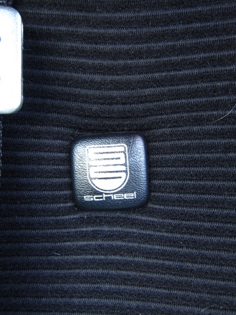

Those seats look like Scheels. Are they marked Recaro?

QUOTE(Larmo63 @ Dec 4 2017, 08:11 PM) *
And..... (IMG:style_emoticons/default/welcome.png)
Look at my Scheel (IMG:style_emoticons/default/welcome.png) logo on my seat. A little different shape?

This is a Konig driver's seat, but sure looks a lot like a Scheel 401/501, except for the leg bolsters
I looked up you seats and I think they are Konigs
Round logo.
There are great seats.

QUOTE(burton73 @ Feb 17 2018, 10:05 PM) *
Round logo.
Thanks for the input. The logo on both seats are so busy worn that I can't see them. I will look into Konigs.
