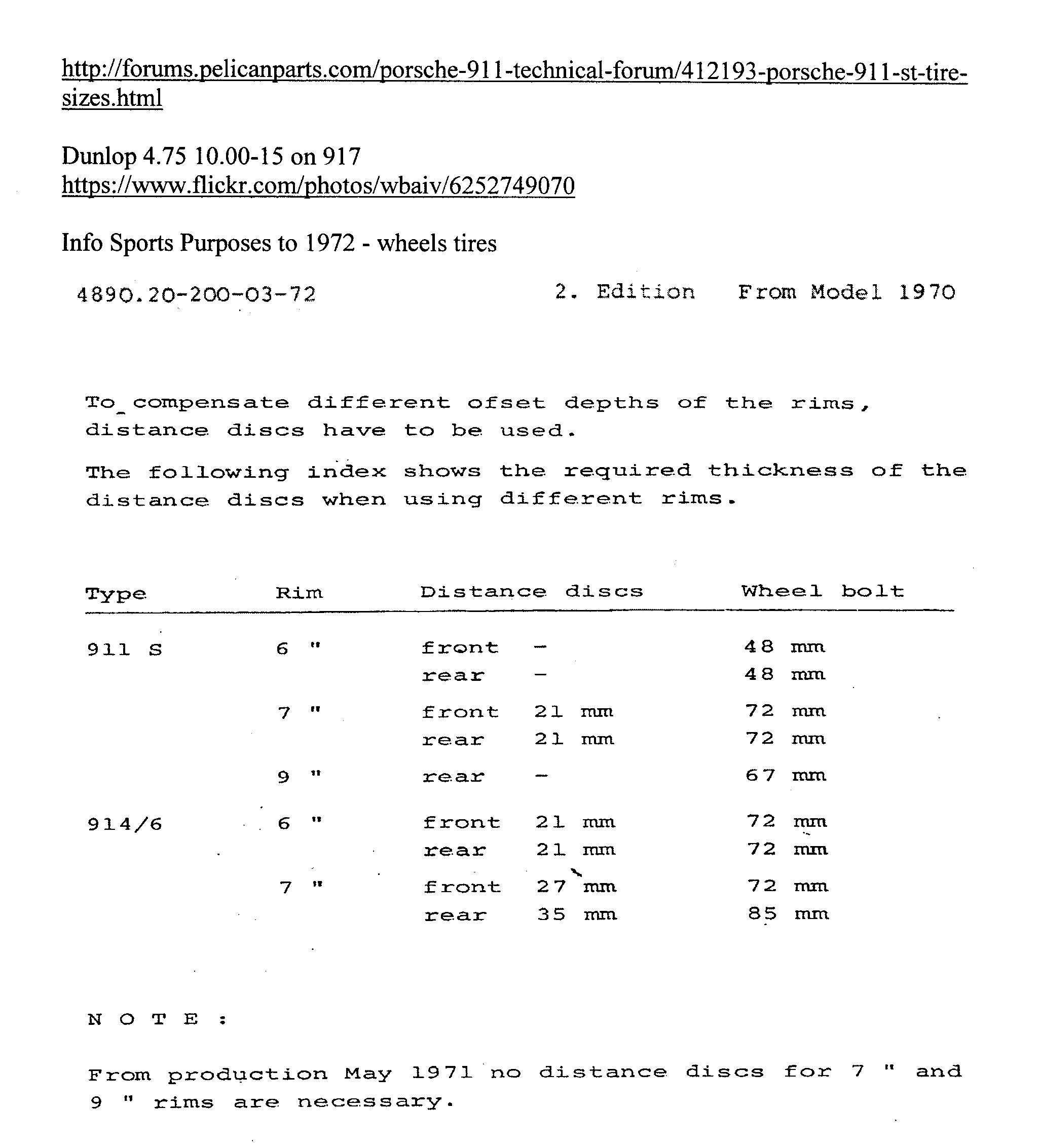

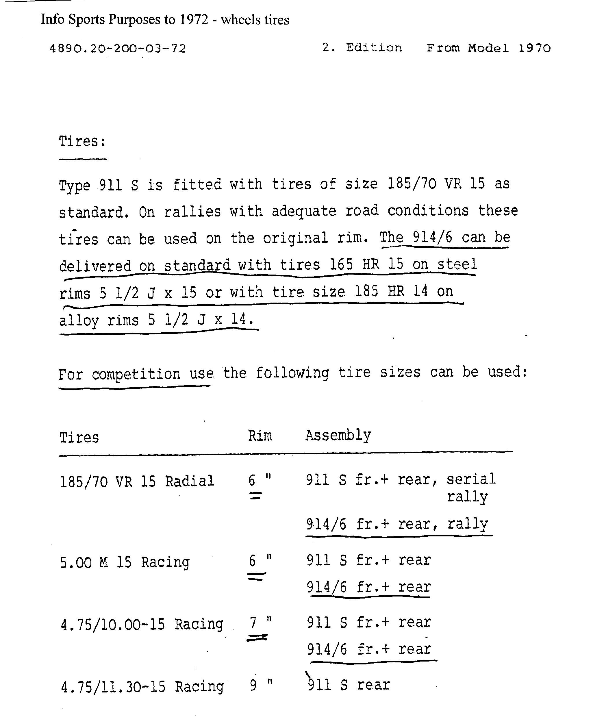

Factory specs - for those intent on duplicating originality

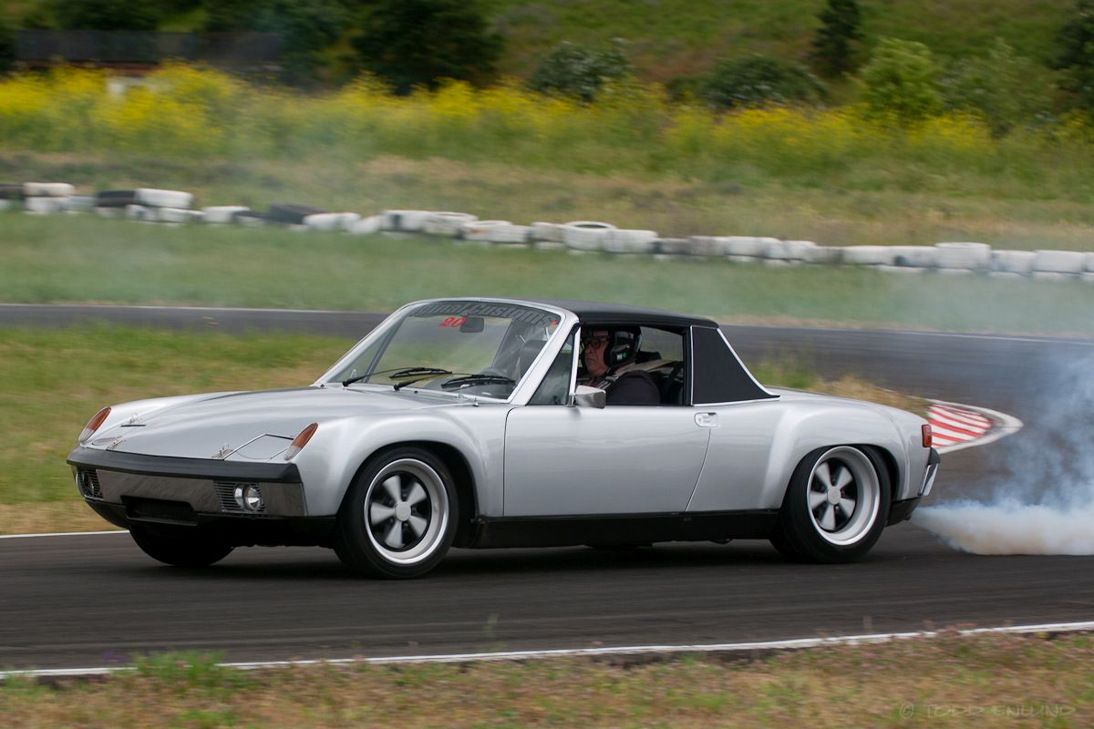

Here is an interesting set of 7's and 8's x 16's (IMG:style_emoticons/default/smile.gif)

The big difference between the wheels is the 8x16 & 9x16 will cost you multiples of all the other sizes.

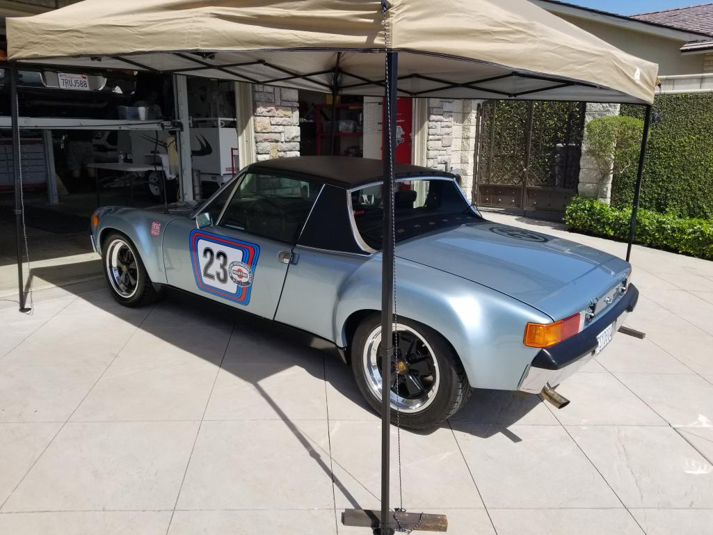

So far I’m the only 7X16 front 9X16 rear. My rears are actually custom built Weidman 8.5X16 but that isn’t a poll choice. My reason for going with these is tire option availability and the fact that it perfectly fills the wheel well in the rear.

QUOTE(ConeDodger @ Jan 19 2018, 06:35 PM) *
What's with the smoke screen? Great looking car.

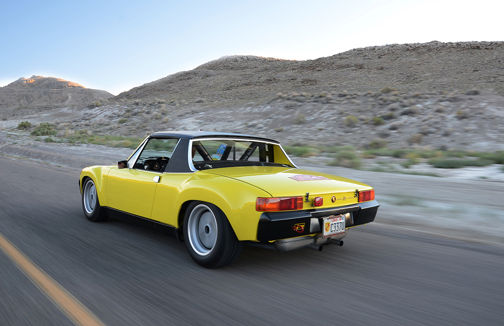

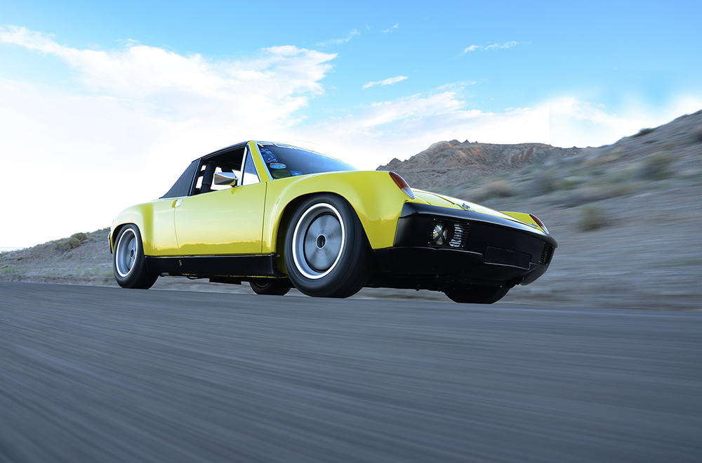

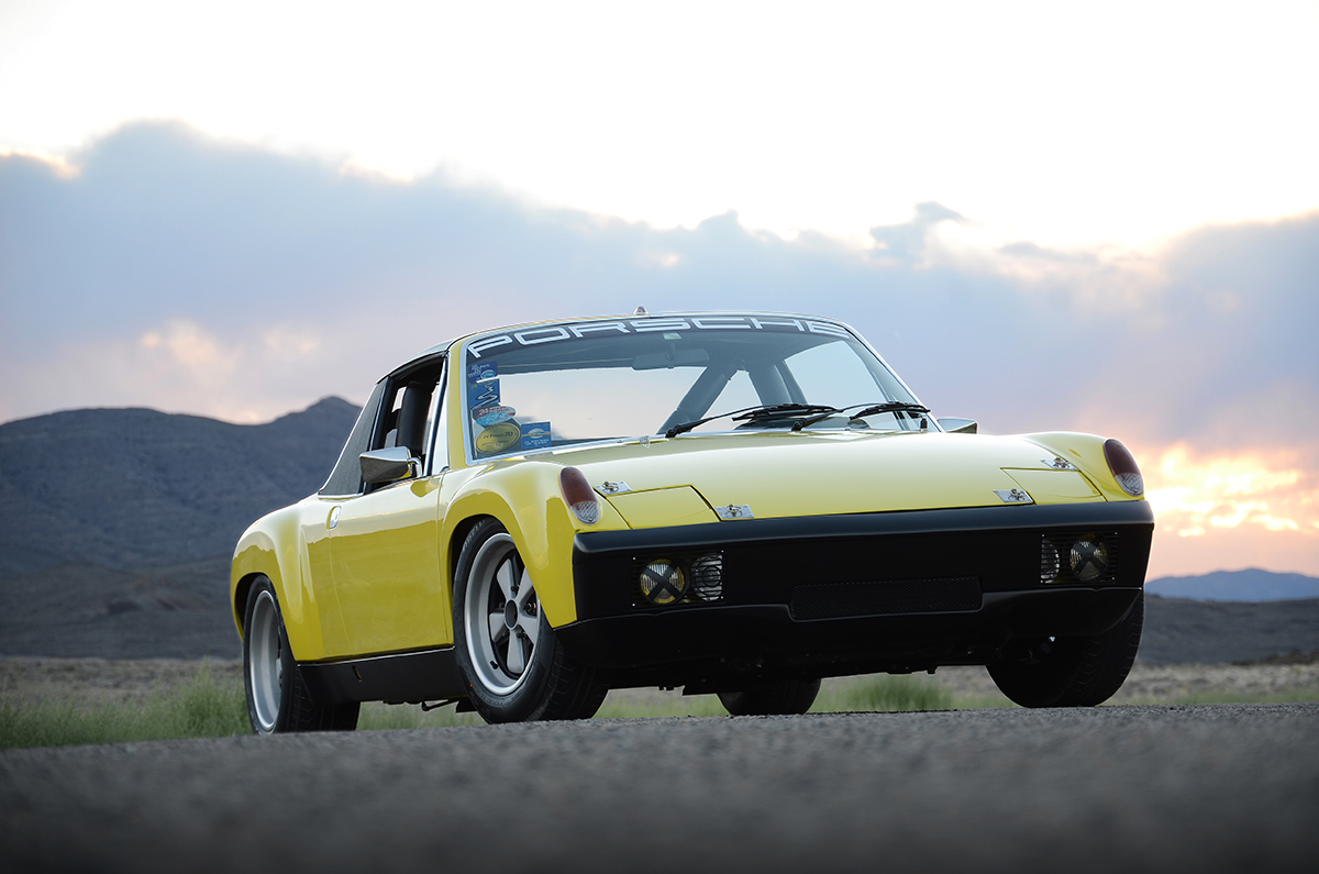

Just thought I'd post some pics of the # 2 option above. (IMG:style_emoticons/default/smile.gif)
Edit:
just adding a quote of a later post that mentions tire sizes for this yellow tribute (IMG:style_emoticons/default/smile.gif)
QUOTE(johnhora @ Jan 25 2018, 07:09 PM) *
I "talked" to Eric Shea and he is using 195/65/15 F and 215/60/15 R on his beautiful yellow 914-6 GT...this was mainly because he had some 7/8x15 Fuchs with tires on them from a 911 and they worked and no added extra expense....I'm all for that.
post Jan 22 2018, 02:10 PM
914-6 GT in waiting
Posts: 20,916
Joined: 19-September 09
Member No.: 10,825
Even better in person.
