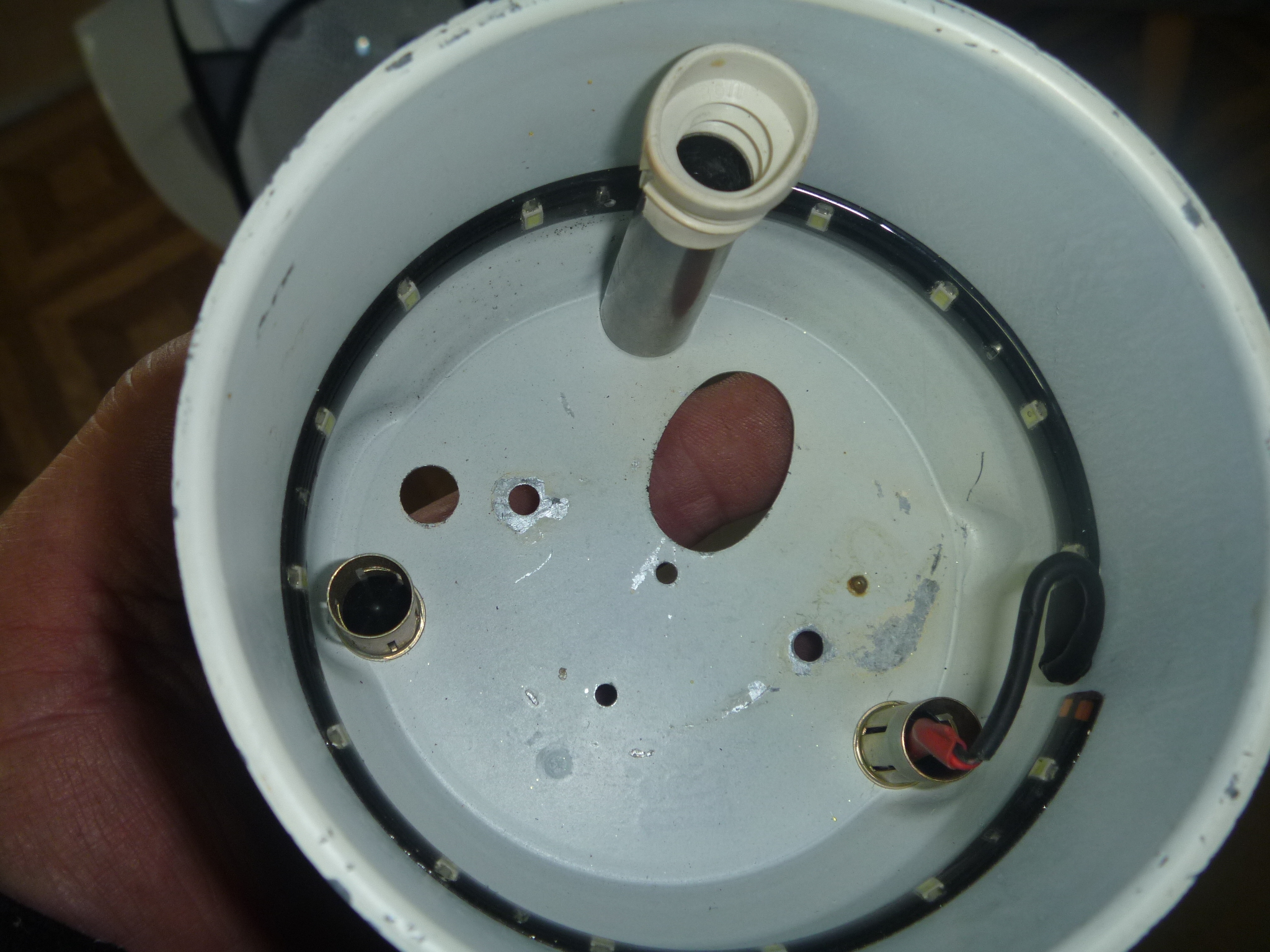

Since doing these conversions for other members, I did learn something not good since my original writeup, a electrical short. The flexible LED strip has a sticky adhesive on the back end. For whatever reason, when sticking the LED's inside the gauge can, the bottom of the flexible PCB shorted to the metal. Not taking any chances on future conversions, I have been applying a layer of double sided sticky foamy tape to the interior of the gauge can, then appling the LED strip ontop of this tape. The tape acts as a good electrical insulator and it also doubles as something to grab ahold of any loose light bulbs that happen to fall out of its lamp holder (IMG:style_emoticons/default/biggrin.gif)

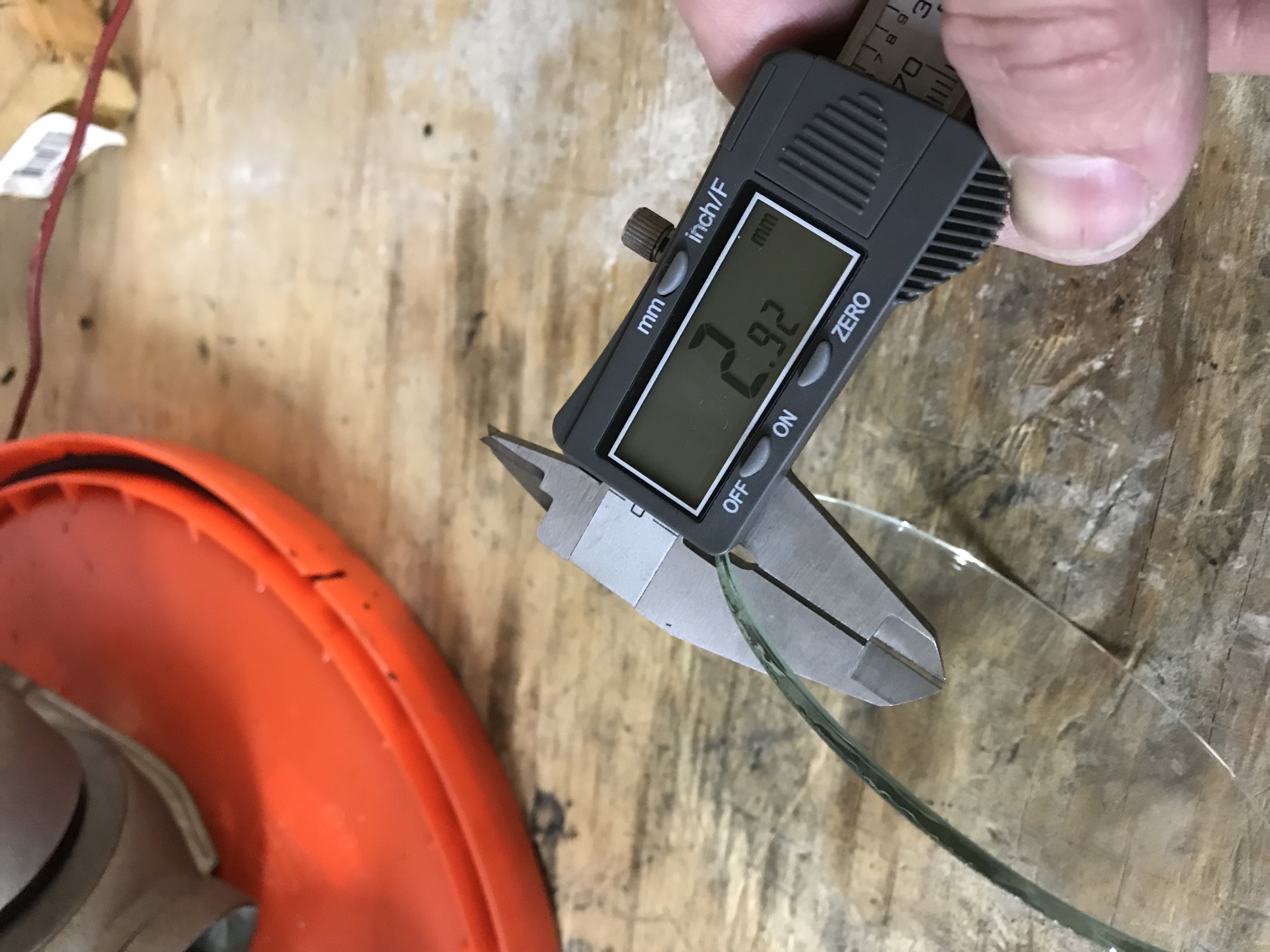

Happen to measure the thickness of the glass?
I've got a guy that will cut glass cheap but my later gauge, with the plastic lens, is about half as thick. Same thing with my 944 combo gauge, only 1/16" or so thick.

Here ya go... this is original glass. 2.92mm / .115 inches (or 7/64). I replaced the ones on my gauges and just told the glazier to match the thickness. keep in mind that if you powder coat the rings you may need a slightly thinner glass. These lenses are installed under surprisingly tight tolerances and if the glass/ring combo is too thick, there won’t be enough metal left to re-crimp.Attached Image

I see the OP posted above in the thread (post #12) the measured thicknesses. Its worth noting that if you do replace the plastic lenses with glass, then either use a bezel that came with OG glass lens, OR match the thickness of the plastic with the replacement glass. If you don't, re-crimping the bezel will be a bear of a task.
