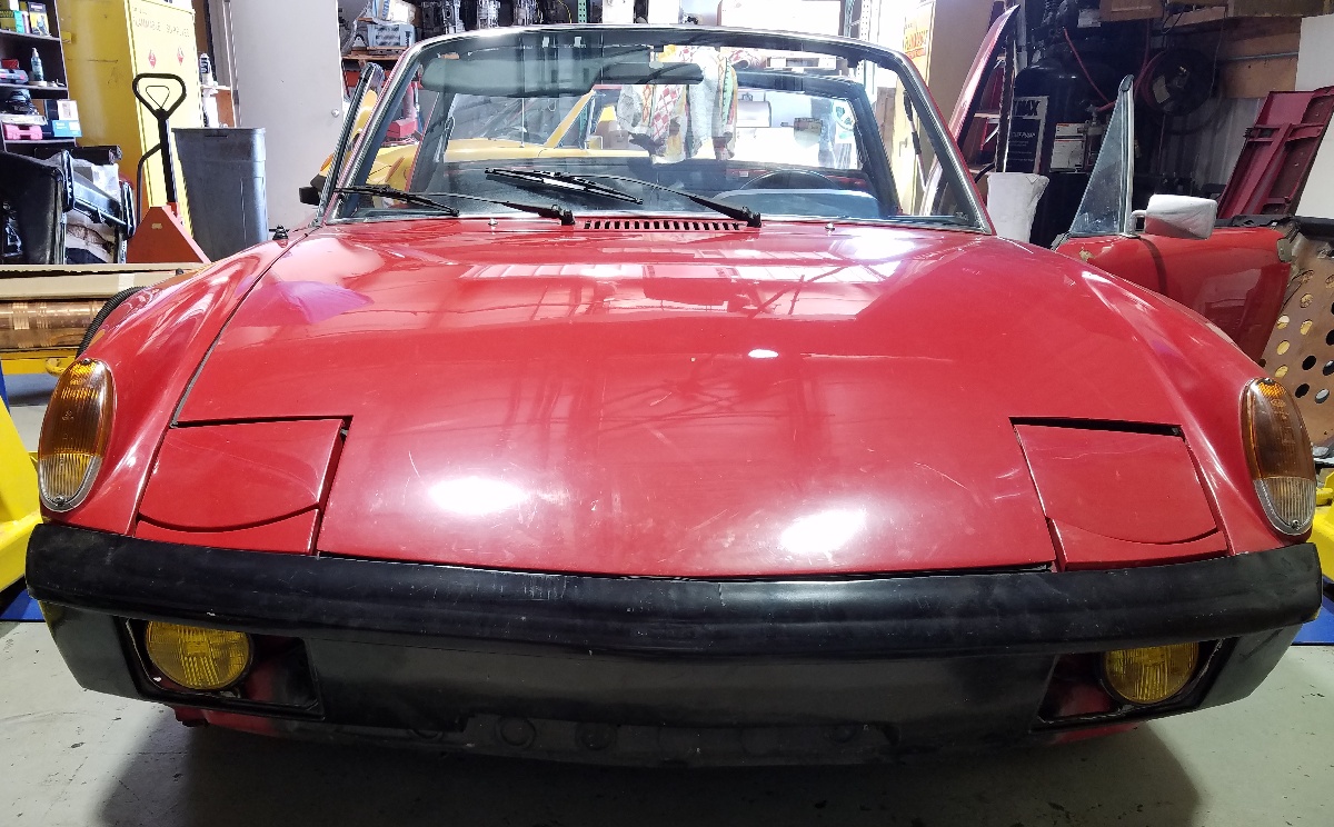

fixer34
post Mar 13 2018, 07:13 PM
Posts: 1,431
Joined: 16-September 14
From: Chicago area
Member No.: 17,908
You mean like this? Green one in the center of the photo.
Remove the wiper motor/assembly, loosen the arm on the motor and rotate it 180 degrees. Reinstall but do not attach wiper arms. Park the wipers, install wiper arms pointing toward the passenger side. Cycle the wipers to make sure they move like you want, then tighten the arms.
It may be possible to get to the motor arm with everything in the car...
windforfun
post Mar 13 2018, 07:15 PM
Posts: 2,098
Joined: 17-December 07
From: Blackhawk, CA
Member No.: 8,476
I see mucho driver's side windshield trim overlap. Is this the factory setting?

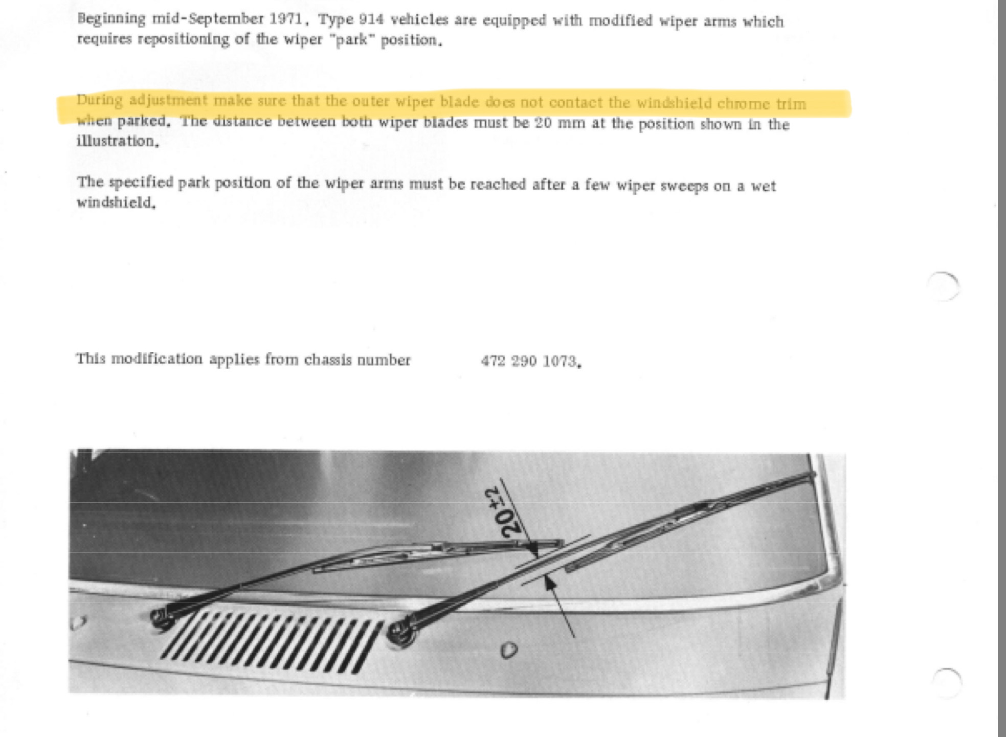

Firstcar
post Mar 13 2018, 09:17 PM
Obsessive amateur mechanic
Posts: 98
Joined: 17-March 11
From: MA -South Shore
Member No.: 12,831
QUOTE(windforfun @ Mar 13 2018, 09:15 PM) *
No this is the factory setting:

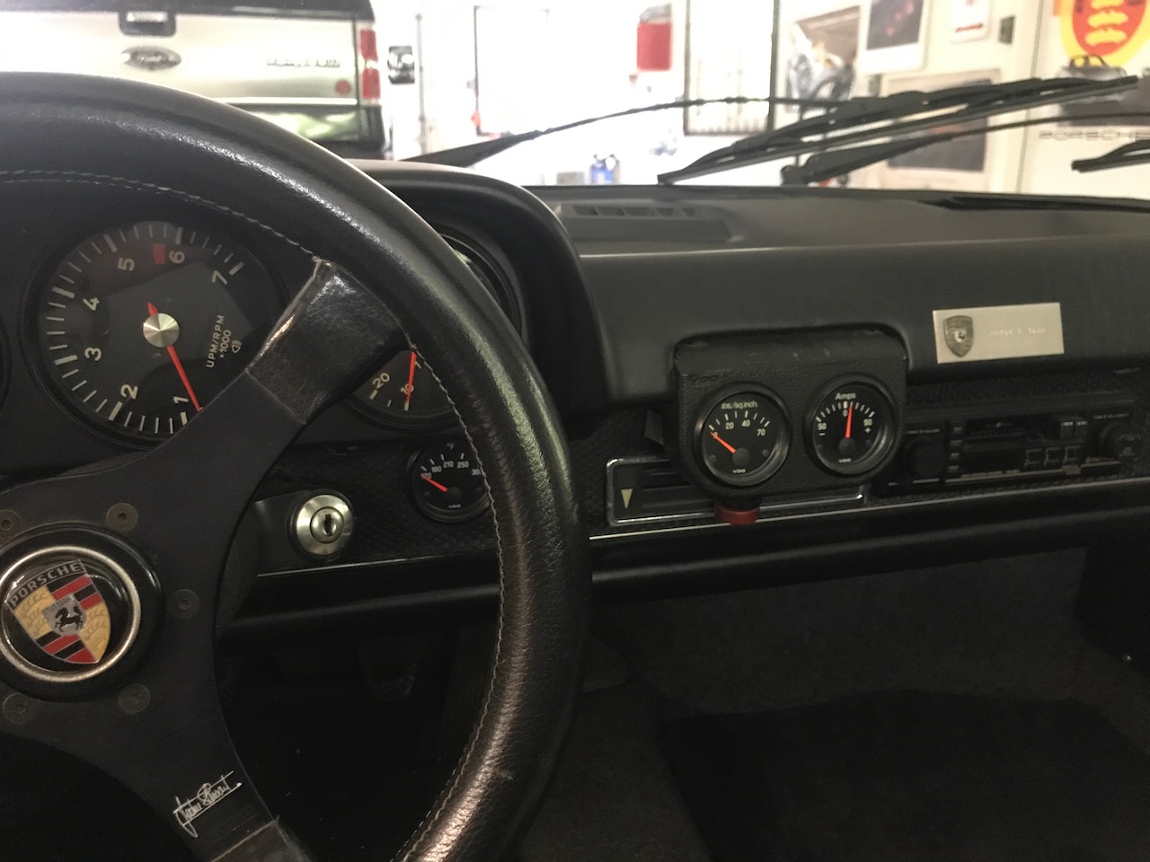

Elliot Cannon
post Mar 13 2018, 10:34 PM
Group: Retired Members
Posts: 8,487
Joined: 29-December 06
Member No.: 7,407
Parked on the right side. Or as some would say, "the correct side". (IMG:style_emoticons/default/av-943.gif)
