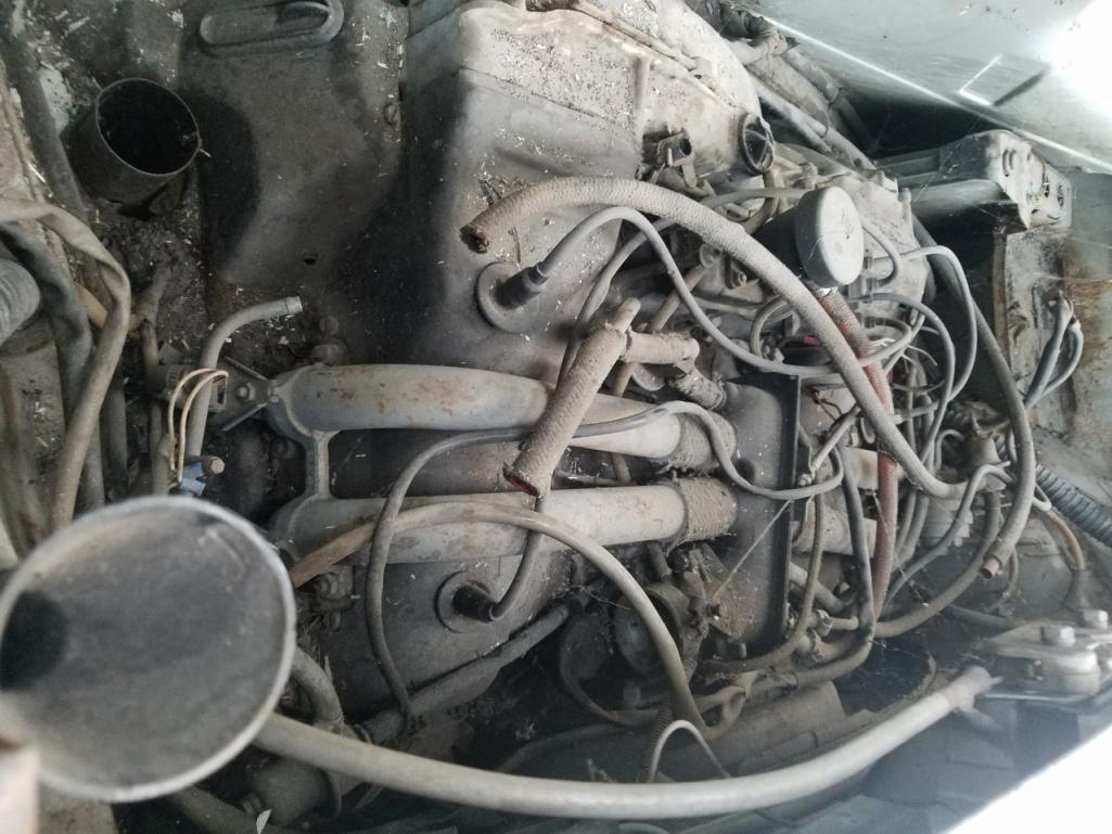

The engine seems to be missing some components and the harness for the fuel injection is in pretty bad shape. Also the engine seems to be from a 1973 model year because the number on it is EB005705 (IMG:style_emoticons/default/sad.gif)
Now since the engine isn't original for the car I do not know if it's worth to go on an all out restoration or to just do a repaint, fix all the mechanicals and get it on the road again, what do you guys think?

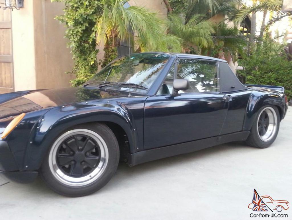

Oh and since I know how people hate threads without pictures here are some of the car for you.
And this is after I got the engine home on my truck.

I know the paint looks rough but it looks clean and straight, good door gaps - take the rocker covers off to see the longs better and take some pictures of the engine compartment and post - if those areas and under seats look good no structural rust I would clean it up, - if your budget it tight I would do a vinyl wrap until you can affor a full out paint job, or paint now - but if you are anxious to drive it , well then go thru the brake system first, check compression on motor, clean , drain etc and reinstall it and drive and enjoy for a while, - but it looks like your friend stopped after stripping it down some to do more work, maybe now if you have time, $$ and space, to do it now- but safety first- new gas lines and hoses, brakes flushed out and make sure new pads and no frozen up calipers, while motor is out it might be a good time to really check it out- do you know when motor ran last and what its condition is?

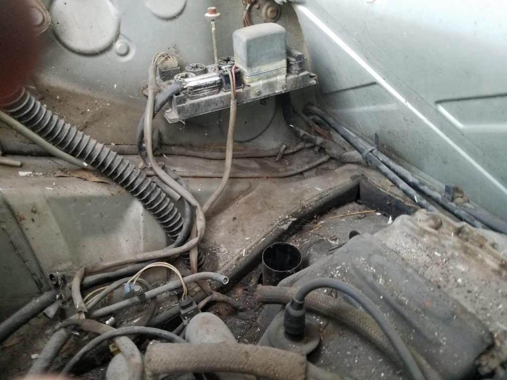

The idea is to do a full mechanical rebuild along with paint and body. I'm going to slowly start striping it down and get all the systems corrected. I do not know when the engine last ran, it didn't run back when my friend first bought it. I do know it turns freely and I am contemplating building this motor up to a 1911 with 96mm pistons but I would need to find some 1.8 or 2.0 heads.
Here are some pictures of the engine compartment, I just didn't take any after I took the engine out since I was covered in grease jajaja

The engine compartment looks dirty, but doesn't look a rusty mess like most of these cars usually are.

Thanks for the welcome, I'll get some better pictures of the engine compartment next time. I do see some rust up where the battery tray is. I will end up replacing the tray.

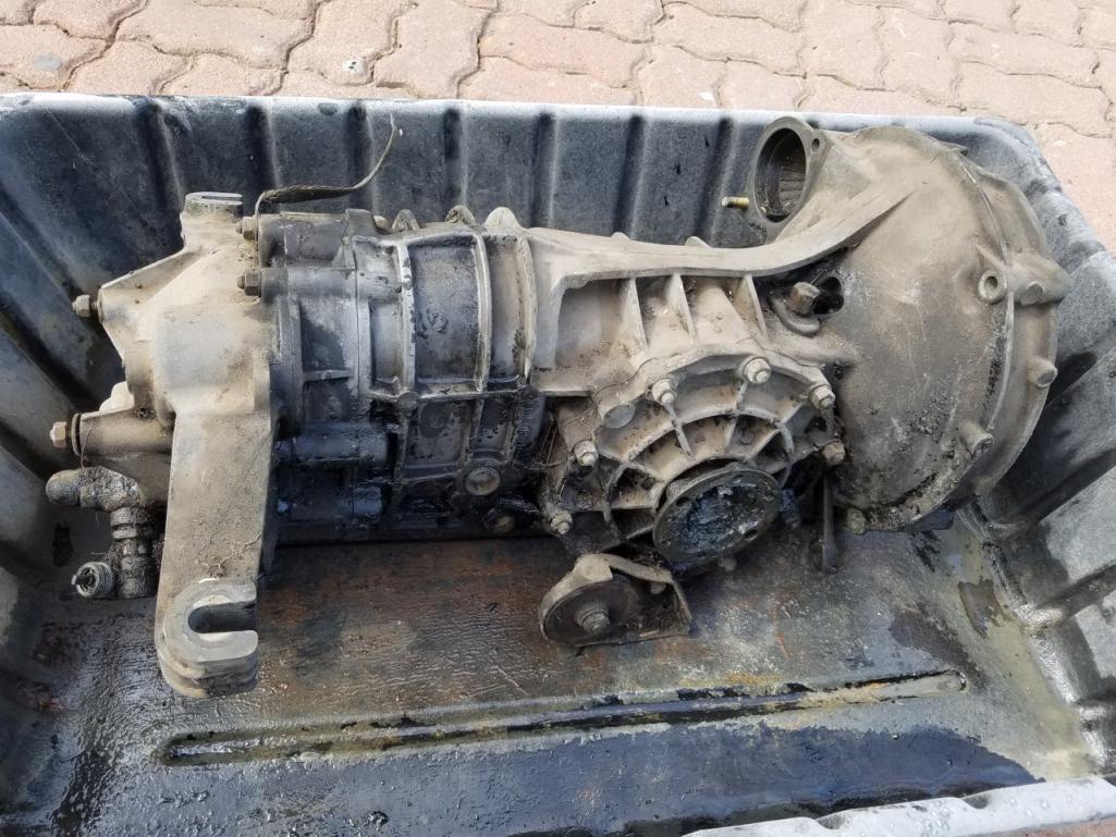

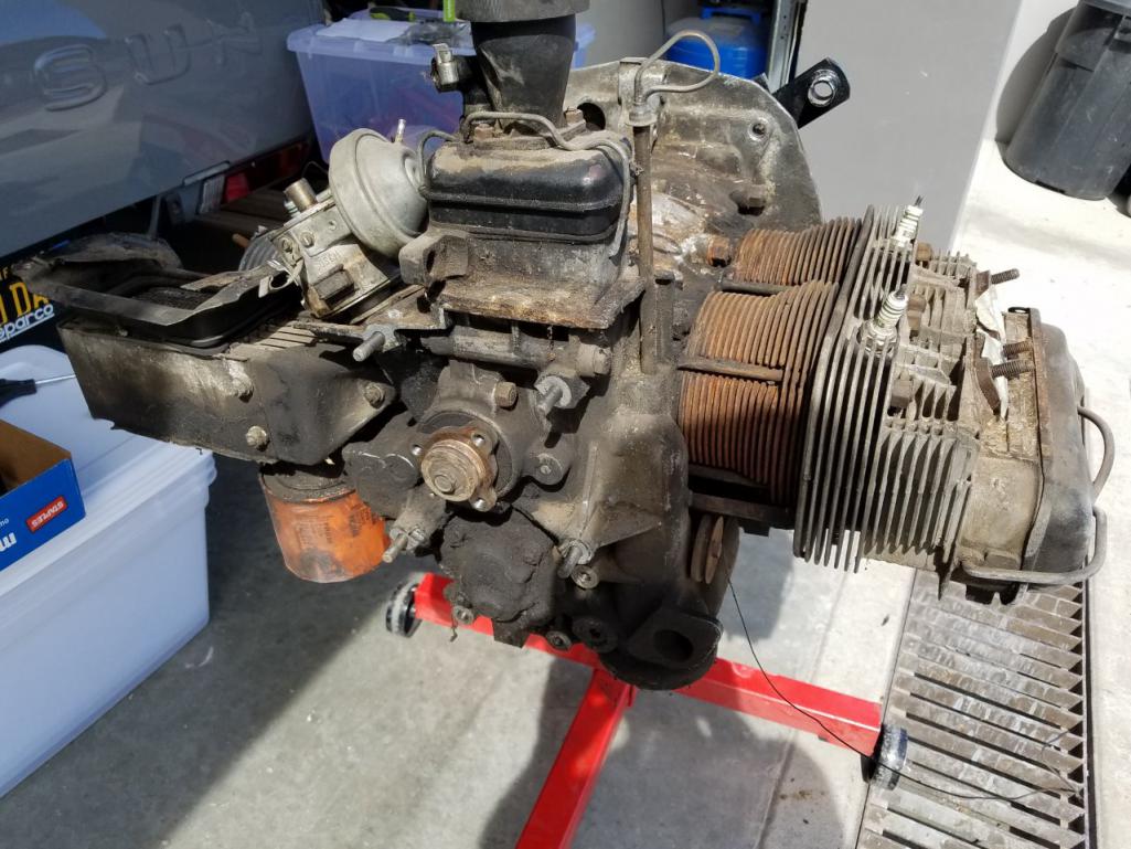

Got the engine semi torn apart and I also started cleaning up the transmission trying to get all the gunk off. Hopefully here next week I will be able to get most of the parts that I took off cleaned and sent out to get sand blasted.
I've decided to build my 1.7 motor to a 2056 and found a great local guy to get the 2.0 crankshaft and some other parts that I need for the rebuild. I also looking to get a copy of the Bug Me Type 4 Engine Rebuild video in case anyone has one for sale. (IMG:style_emoticons/default/biggrin.gif)
I'll be building the engine for street and freeway use but will need to go with Dual 40 carbs, if anyone has any recommendations or tips for me I would love to hear them. Thanks guys (IMG:style_emoticons/default/smile.gif)
