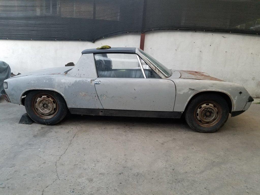

Hello guys, I am new here to the 914 World forum. I have really enjoyed the topics that are covered here and loved watching all of the build threads and restoration projects everyone has posted.

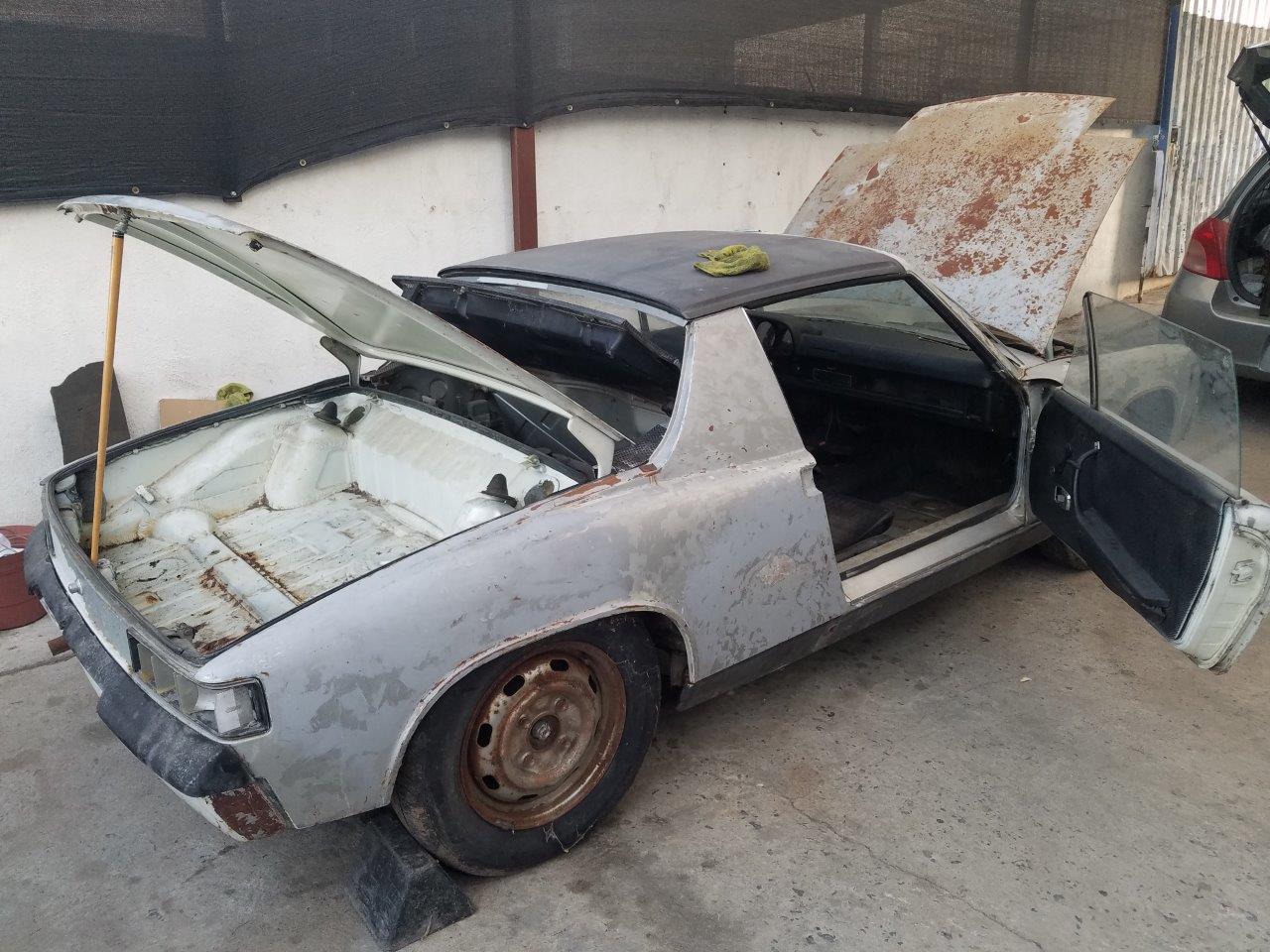

I just bought a 1972 914 from a friend a couple of weeks ago and I am trying to come up with a plan on how to get this car back on the road. It seems it has been off the road for more than 10 years and it has just sat since then. Luckily it had been kept from the elements so there is minimal surface rust and most body panels are straight.

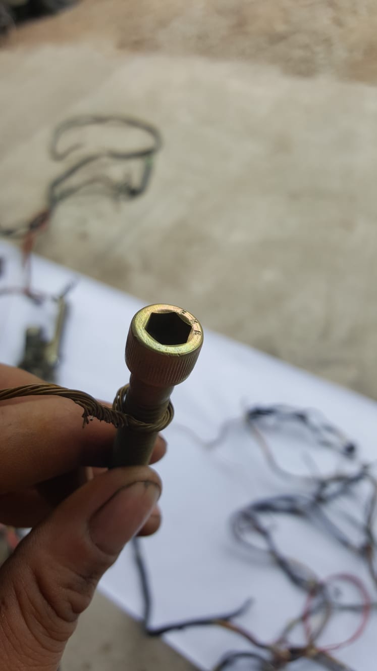

The engine seems to be missing some components and the harness for the fuel injection is in pretty bad shape. Also the engine seems to be from a 1973 model year because the number on it is EB005705 sad.gif
Now since the engine isn't original for the car I do not know if it's worth to go on an all out restoration or to just do a repaint, fix all the mechanicals and get it on the road again, what do you guys think?

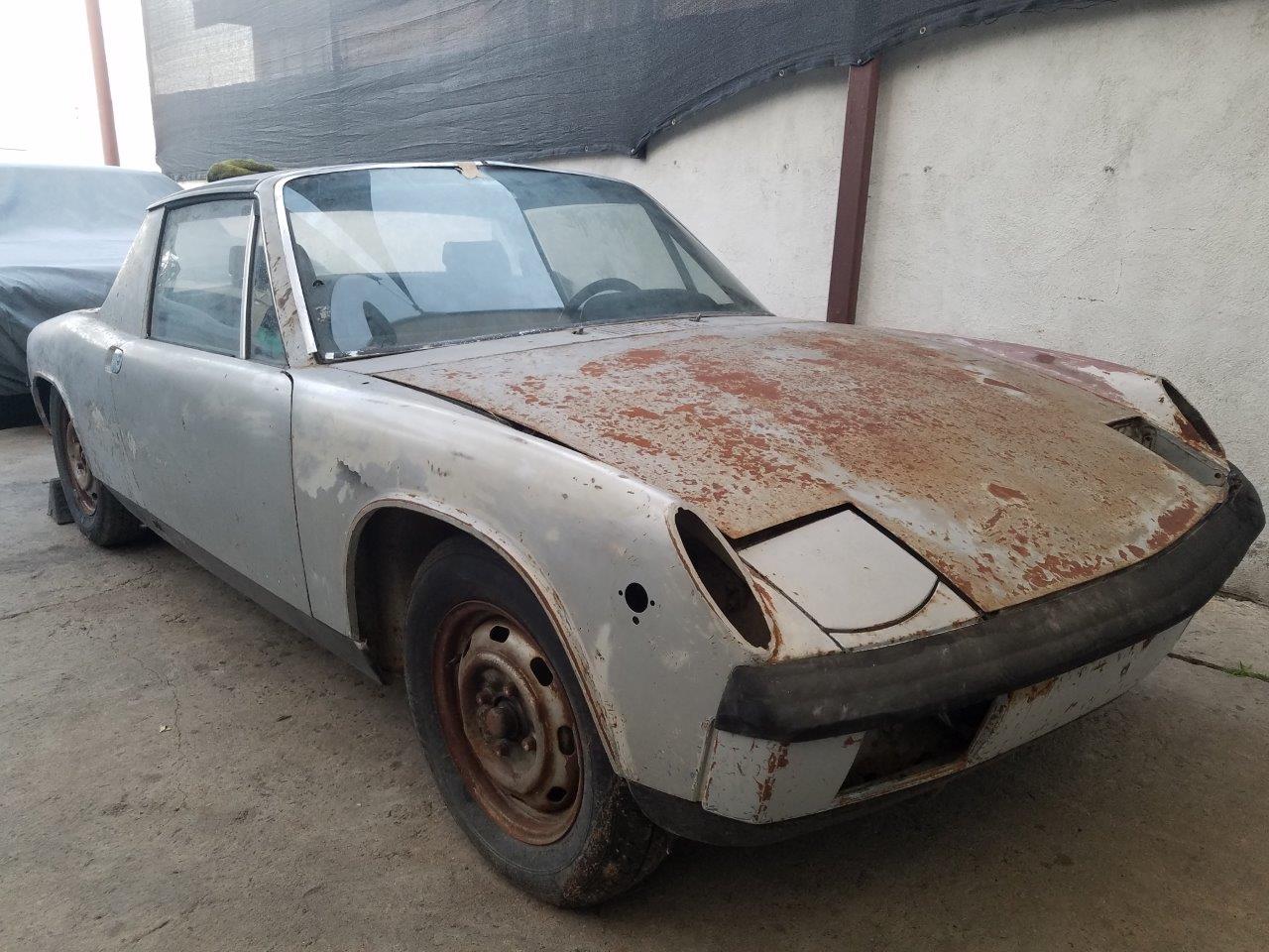

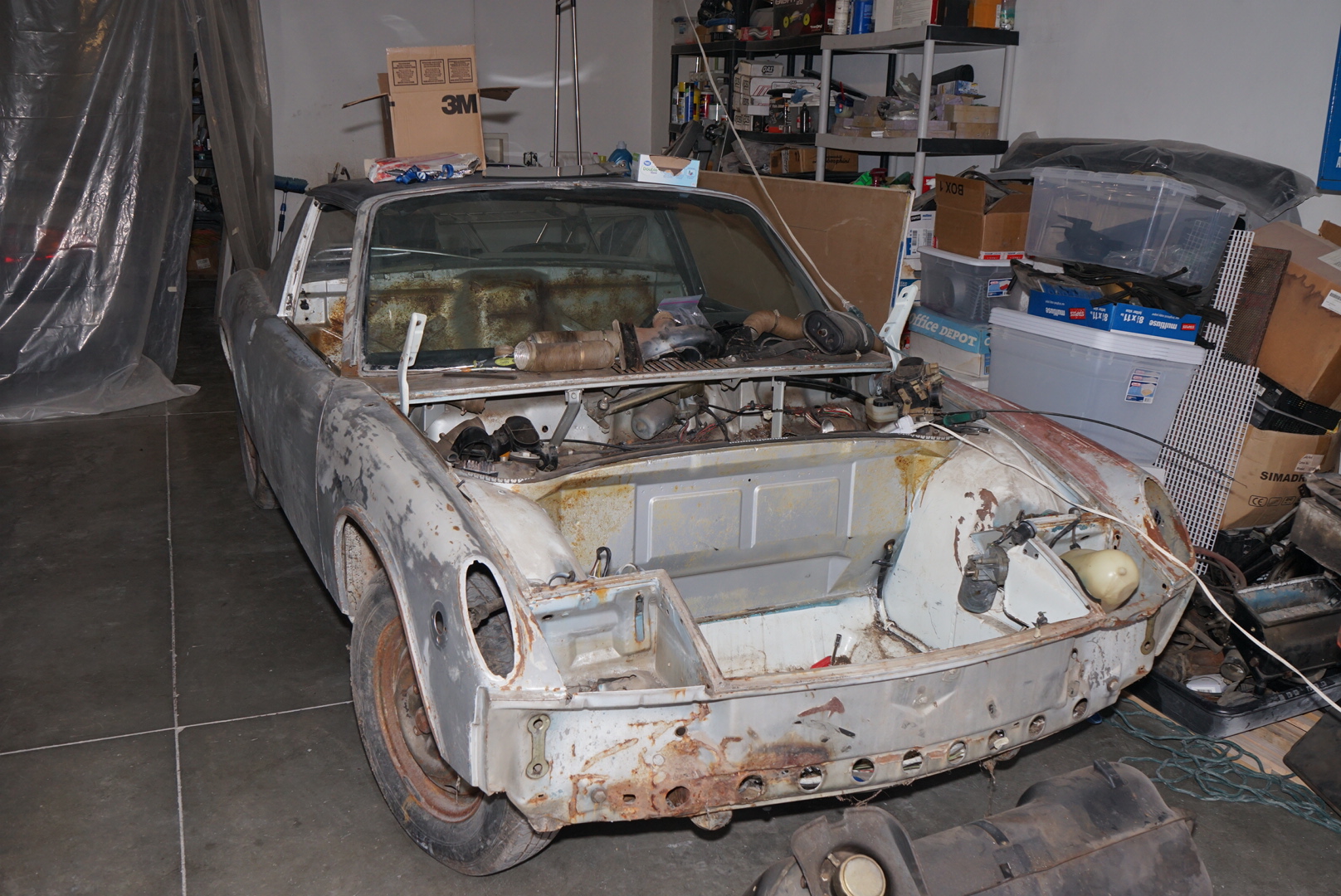

Oh and since I know how people hate threads without pictures here are some of the car for you.
And this is after I got the engine home on my truck.

I know the paint looks rough but it looks clean and straight, good door gaps - take the rocker covers off to see the longs better and take some pictures of the engine compartment and post - if those areas and under seats look good no structural rust I would clean it up, - if your budget it tight I would do a vinyl wrap until you can affor a full out paint job, or paint now - but if you are anxious to drive it , well then go thru the brake system first, check compression on motor, clean , drain etc and reinstall it and drive and enjoy for a while, - but it looks like your friend stopped after stripping it down some to do more work, maybe now if you have time, $$ and space, to do it now- but safety first- new gas lines and hoses, brakes flushed out and make sure new pads and no frozen up calipers, while motor is out it might be a good time to really check it out- do you know when motor ran last and what its condition is?

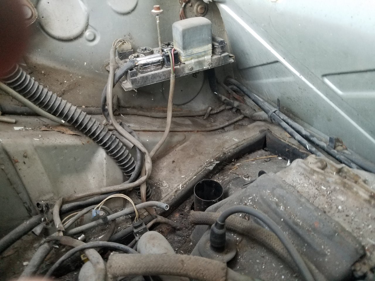

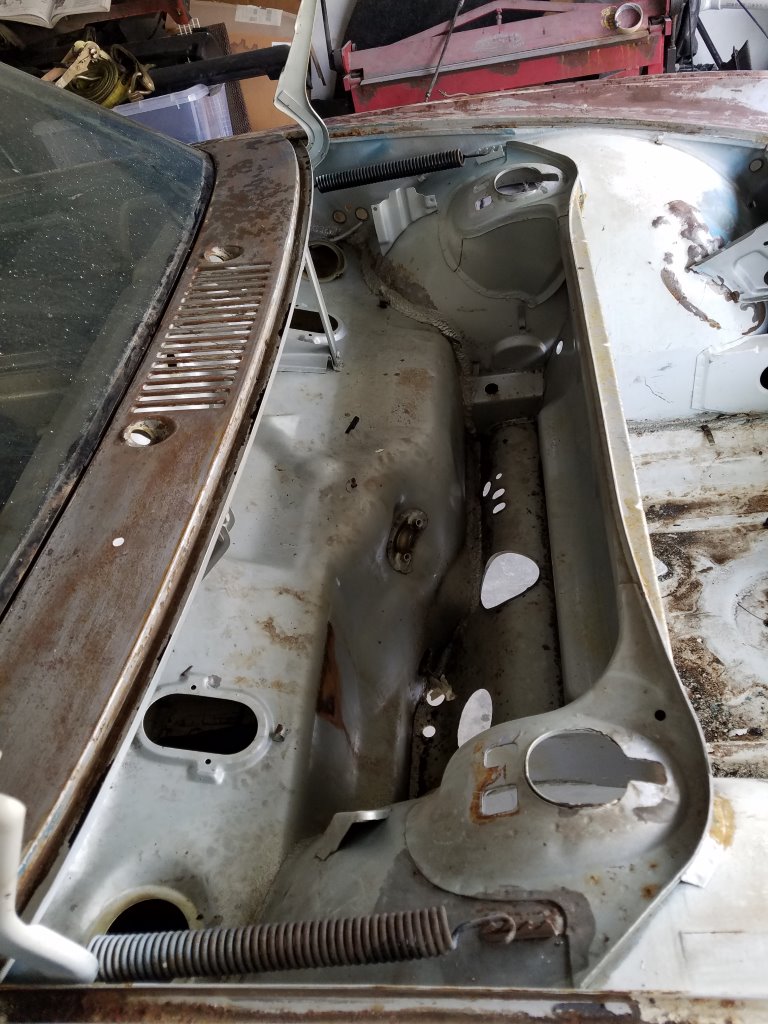

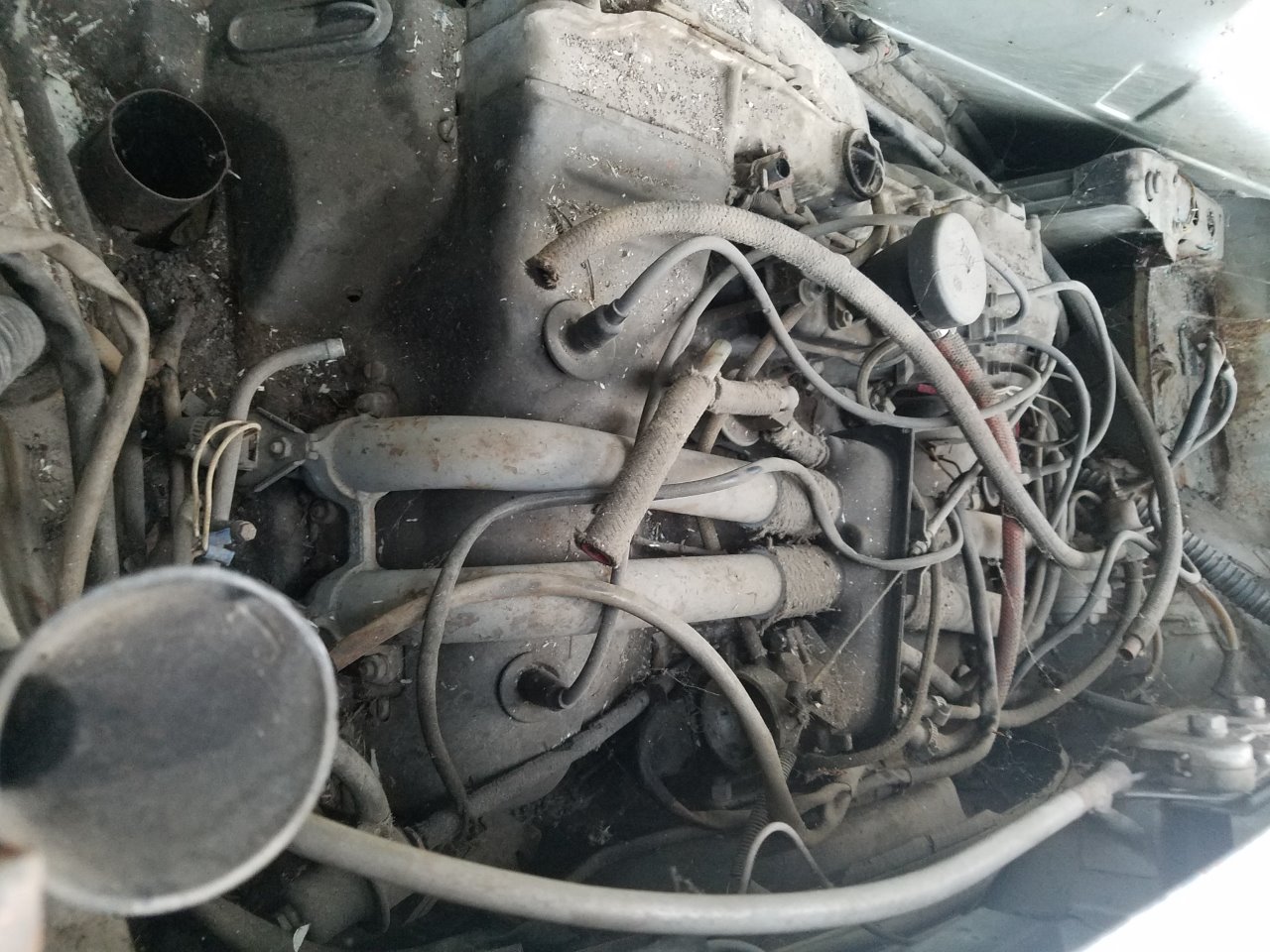

Here are some pictures of the engine compartment, I just didn't take any after I took the engine out since I was covered in grease jajaja

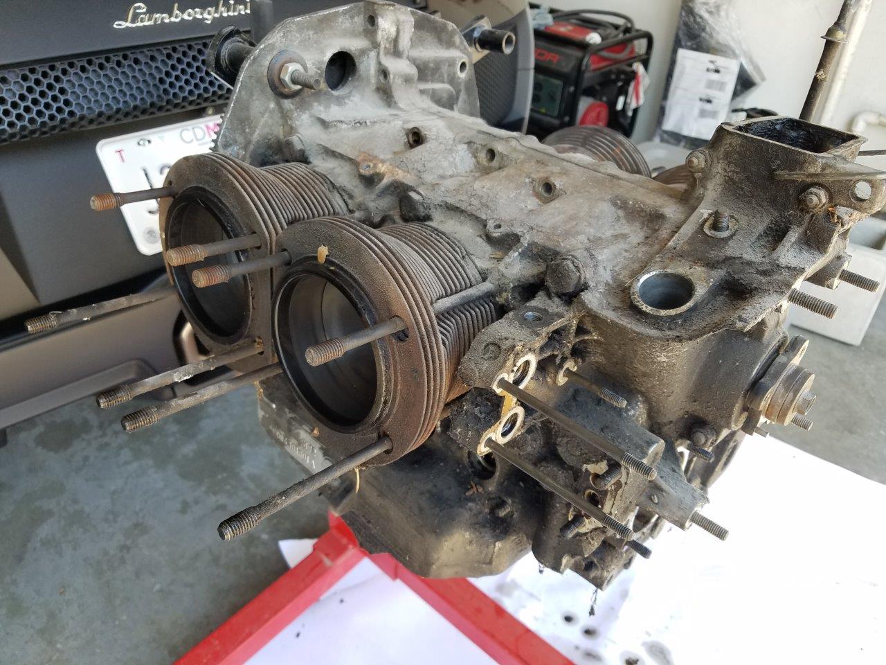

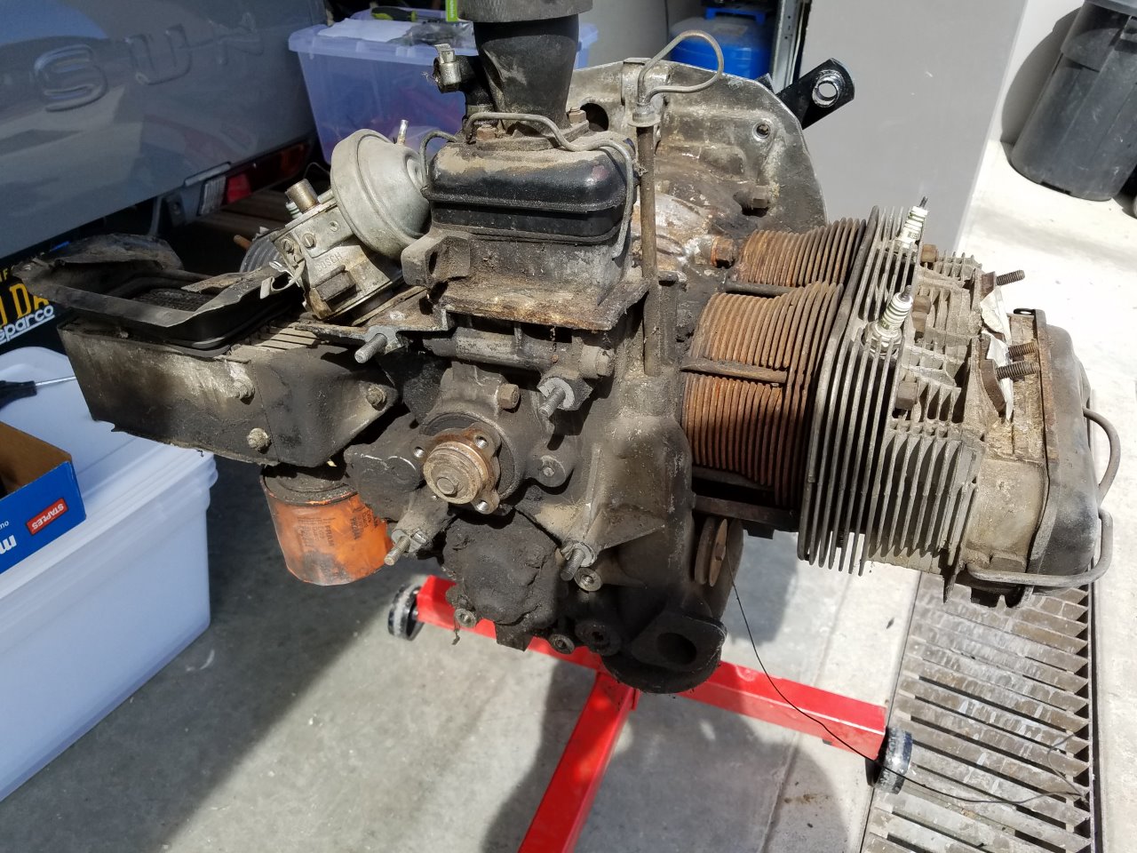

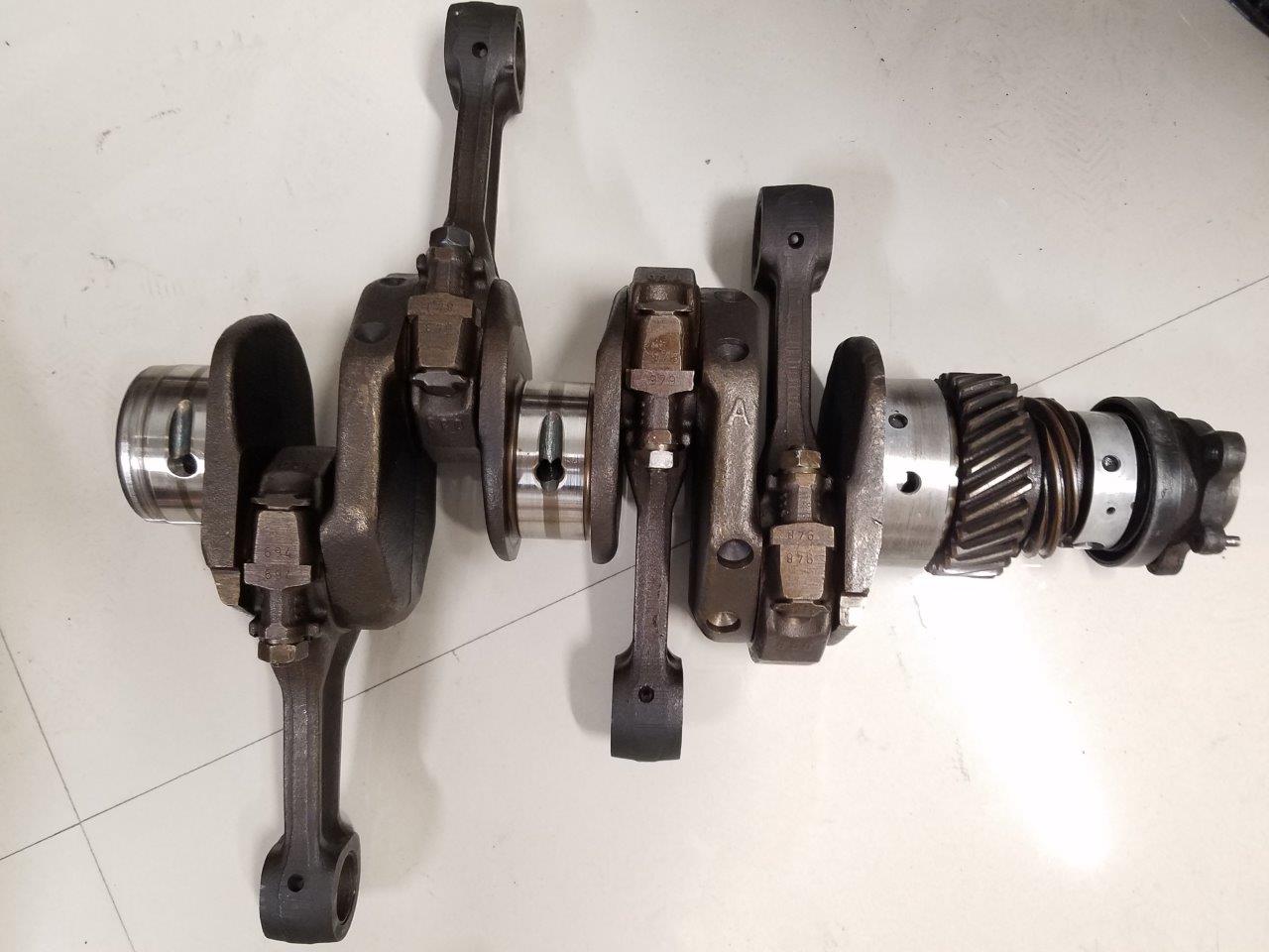

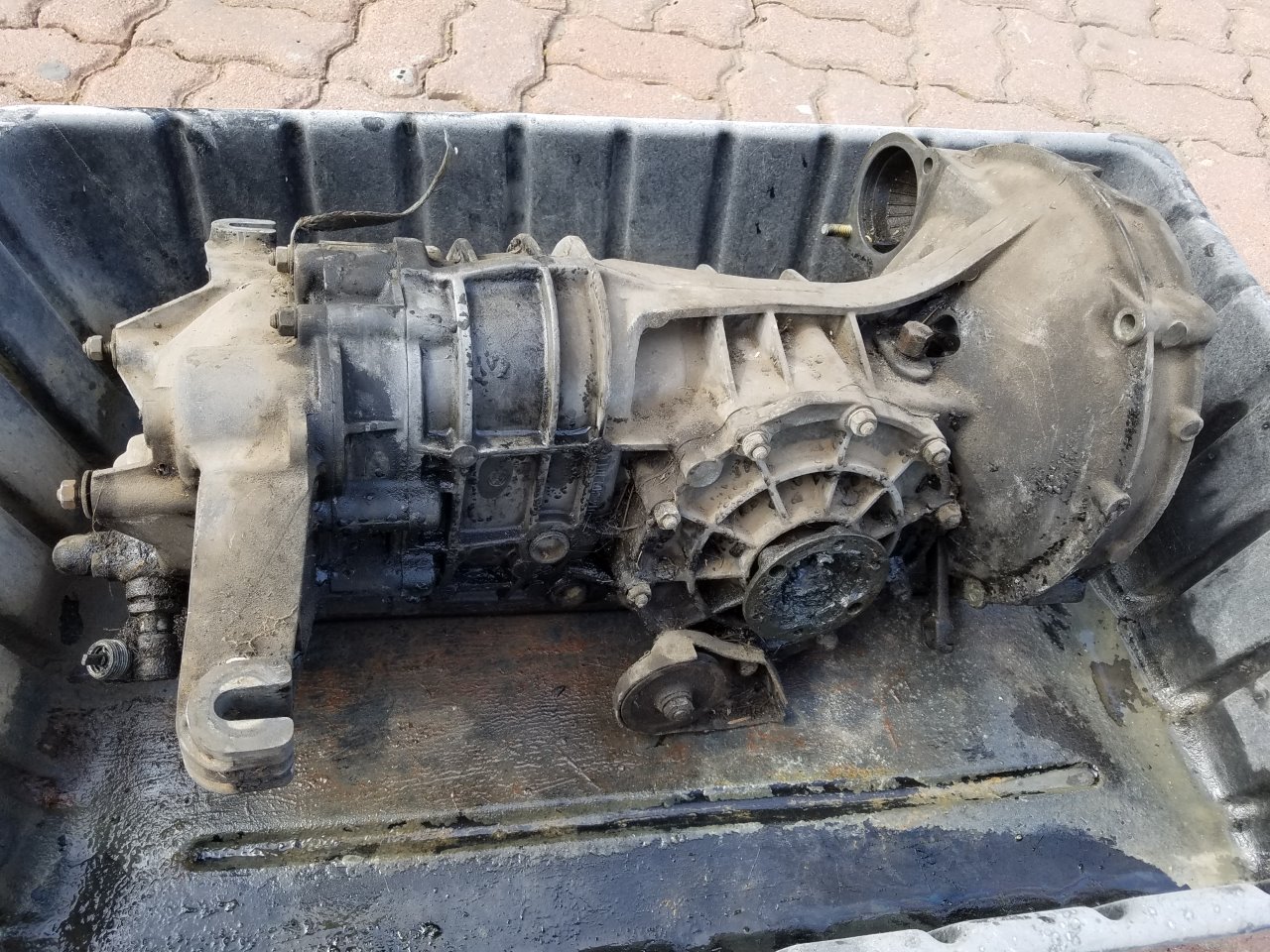

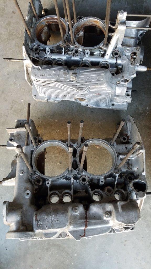

Got the engine semi torn apart and I also started cleaning up the transmission trying to get all the gunk off. Hopefully here next week I will be able to get most of the parts that I took off cleaned and sent out to get sand blasted.
I've decided to build my 1.7 motor to a 2056 and found a great local guy to get the 2.0 crankshaft and some other parts that I need for the rebuild. I also looking to get a copy of the Bug Me Type 4 Engine Rebuild video in case anyone has one for sale. biggrin.gif
I'll be building the engine for street and freeway use but will need to go with Dual 40 carbs, if anyone has any recommendations or tips for me I would love to hear them. Thanks guys smile.gif

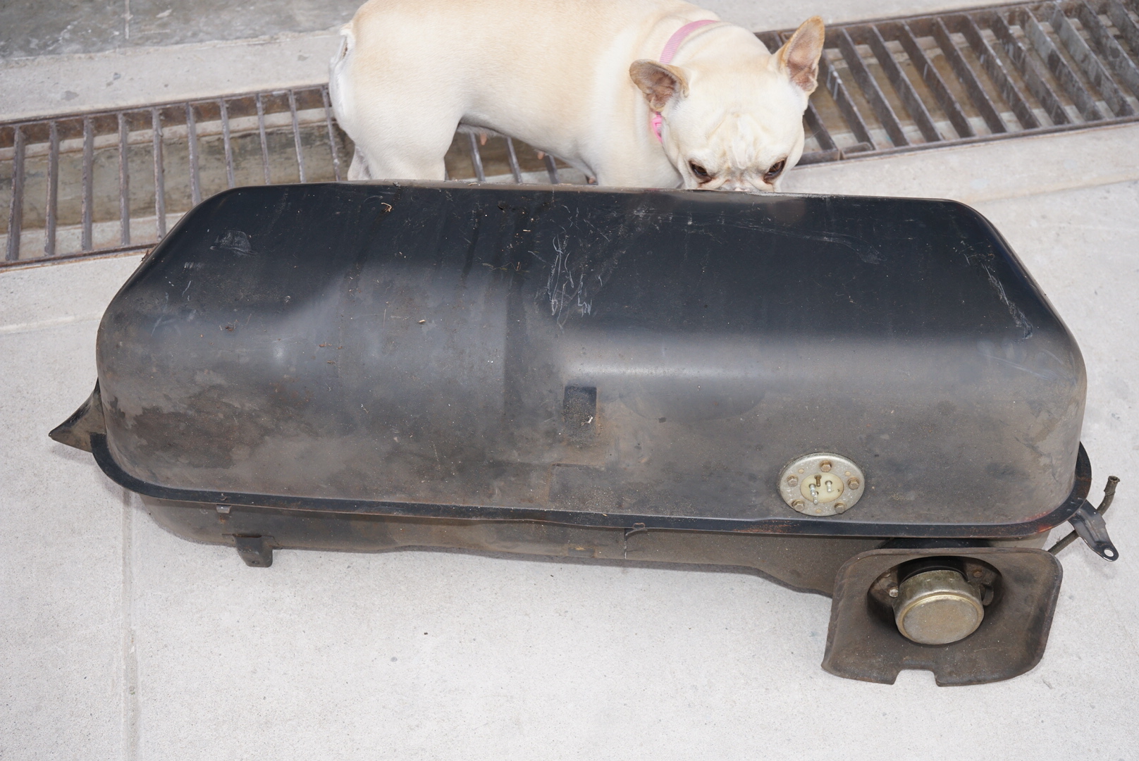

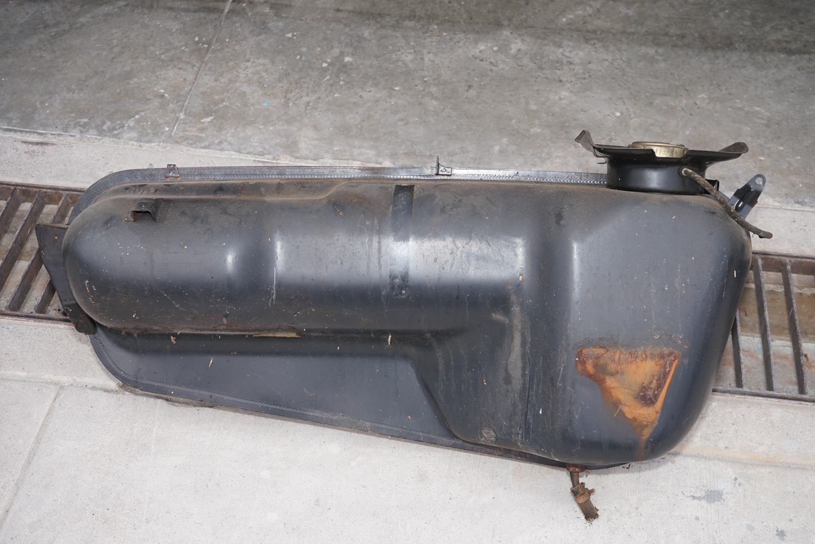

After I got it home I started tearing into it and removed the fuel tank along with other pieces in there. I was surprised that the fuel tank is in such good condition. Even inside it was really nice and clean.

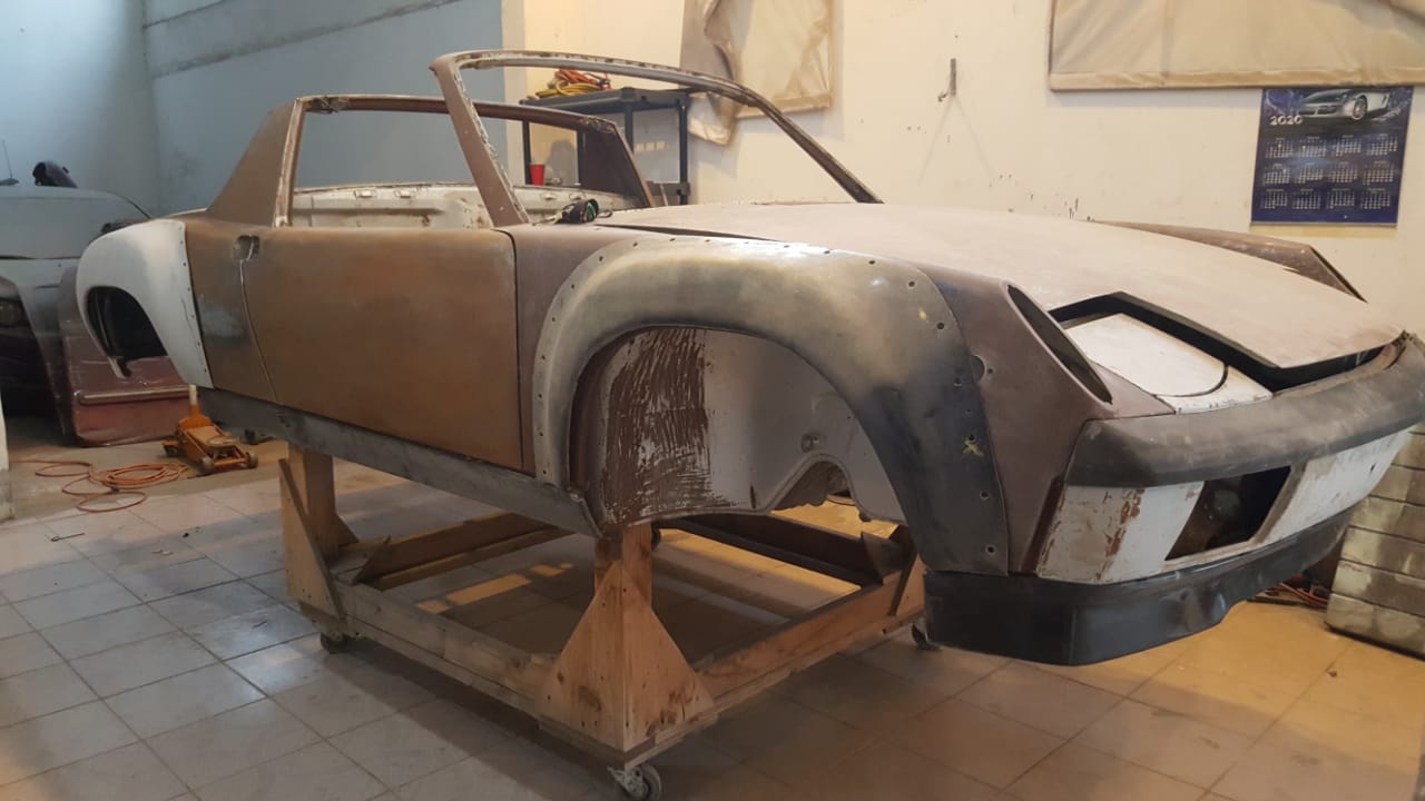

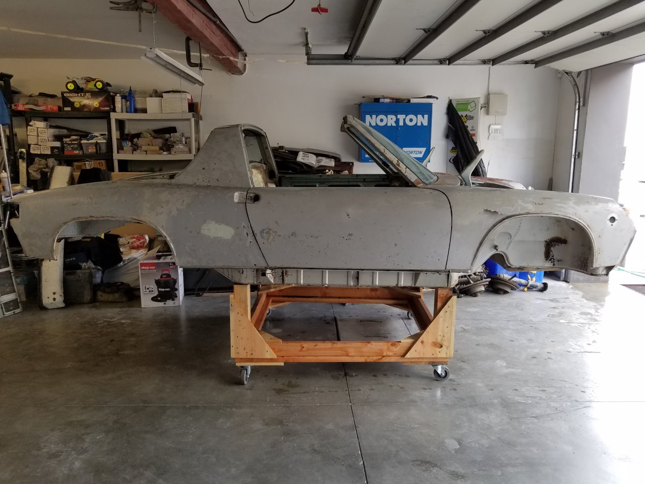

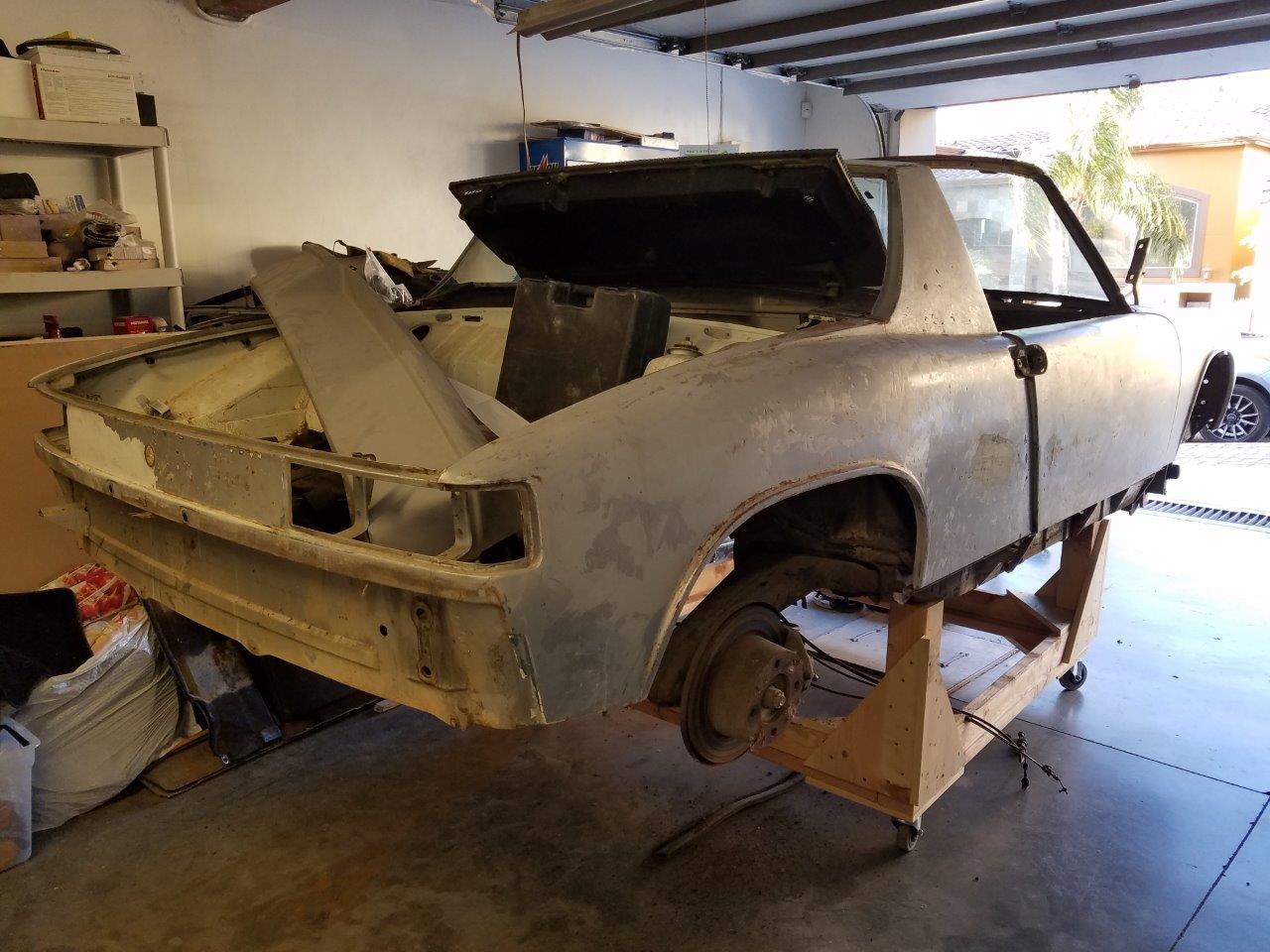

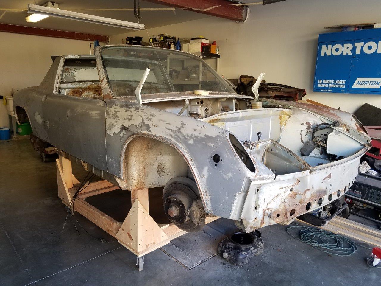

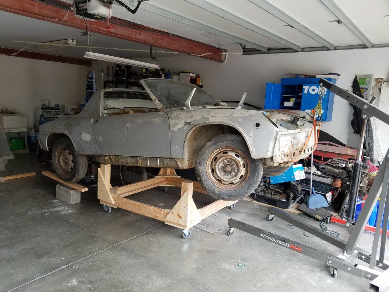

Some pictures of the disassembly process. I built the stand from some pictures and plans I saw on another members thread and I must say it's pretty awesome. Working on the car like this has been a pleasure and by back isn't all sore biggrin.gif
Here with the help of some friends we got it up onto the stand.

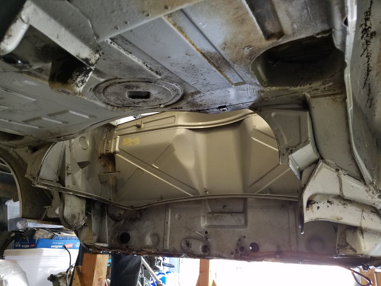

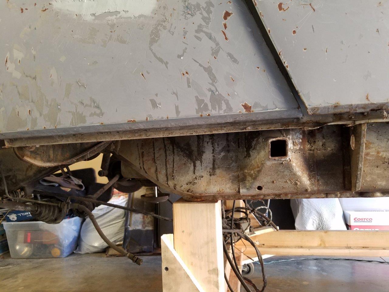

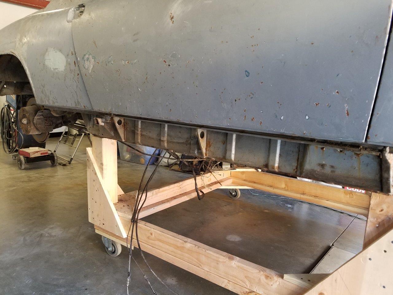

Someone had asked for pictures of the rockers, well here is the right side and it was in good condition so I am happy about that. The left side is mostly the same.
And a couple more overall pictures

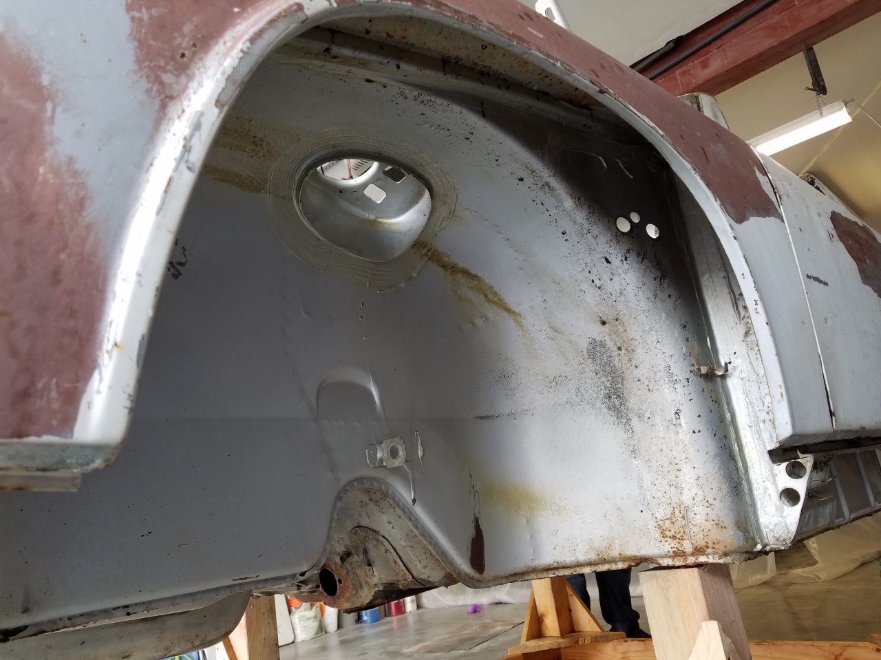

This past weekend I finished taking the car apart and then cleaned it up a bit. Everything came off fairly easily but I need to buy the socket to remove my front ball joints. Body work to start soon biggrin.gif

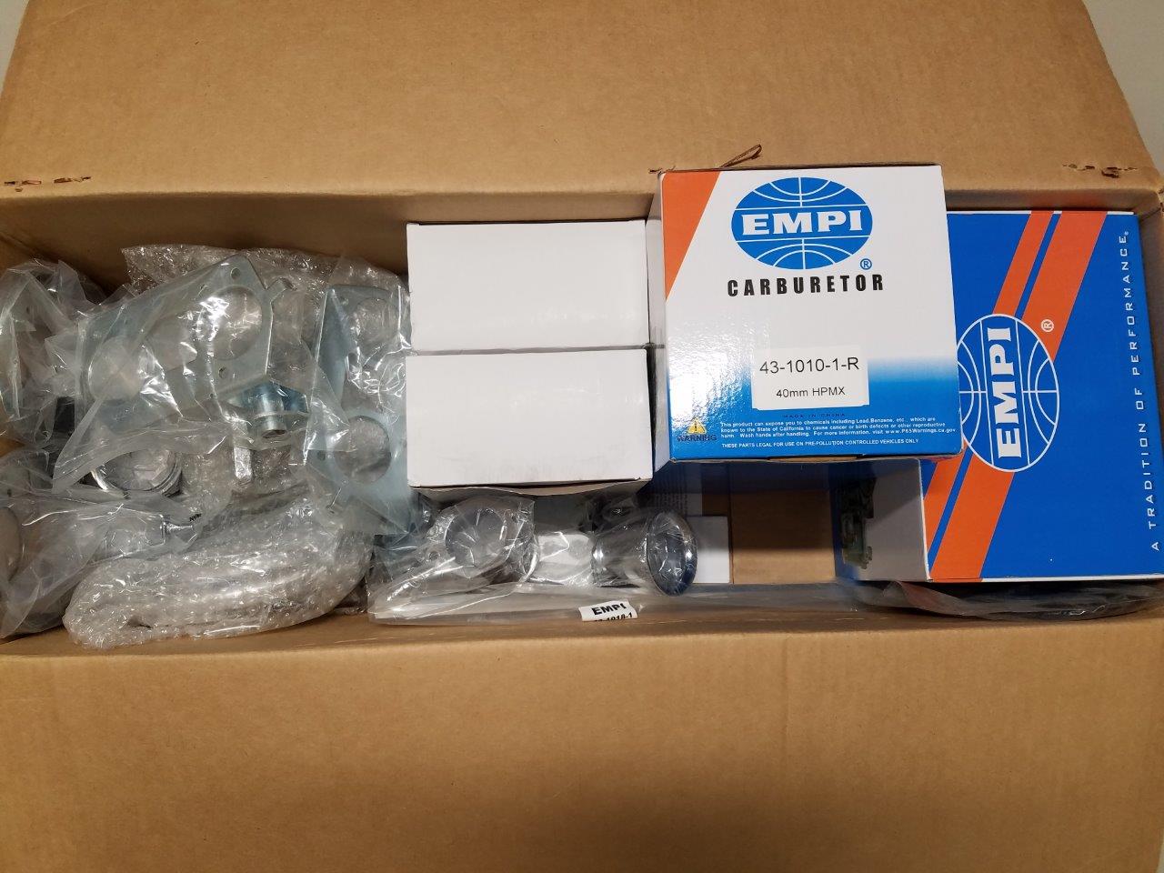

When I bought the car I did not find out until later that it came with some 40 Dual Carbs, a set of 96mm pistons and a 2.0 crankshaft with rods. The guy I bought it from called me up and said that I had forgotten some parts and to go pick them up. Imagine my surprise when I saw what they were. Now my engine is a 1.7 but I will need to rebuild my heads and get bigger valves for them. Hope you guys can let me know who I should take them to here in Southern California.

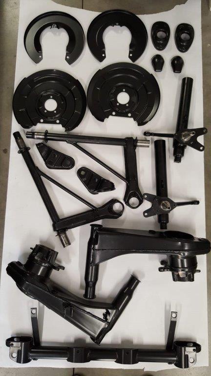

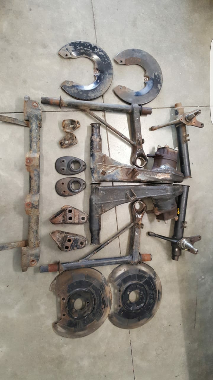

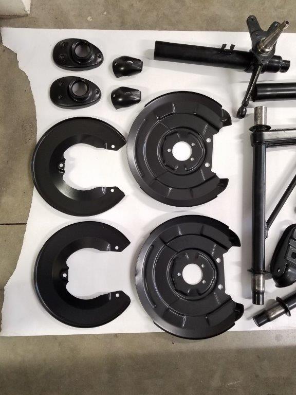

So I've been doing some of the tedious work of getting parts cleaned up and sent to get them powder coated. I sent them to a guy I had never used before in Tijuana and I was very pleased when I picked them up. He did a great job and had them ready for me the day he said. It only cost me $250.00 for all of these parts.

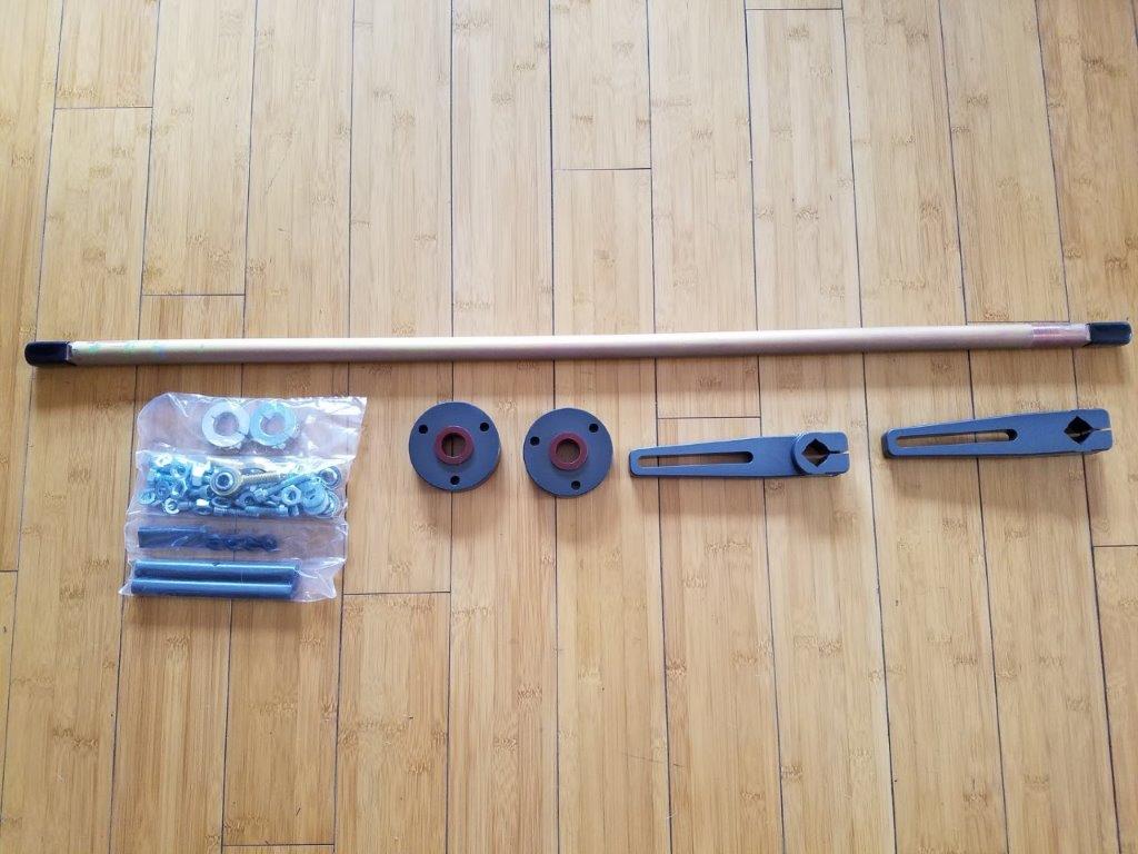

Since my car did not have a front sway bar, I decided to buy the on from GR German Parts Restoration. It was shipped out very quickly and I had it the same week I ordered it. I was very impressed with the quality and the parts look great. I really can't wait to put this on my car smile.gif

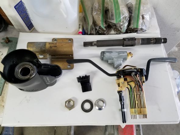

Ok, where did I leave off so long ago sad.gif , yes I remember, I was trying to restore a 914 biggrin.gif

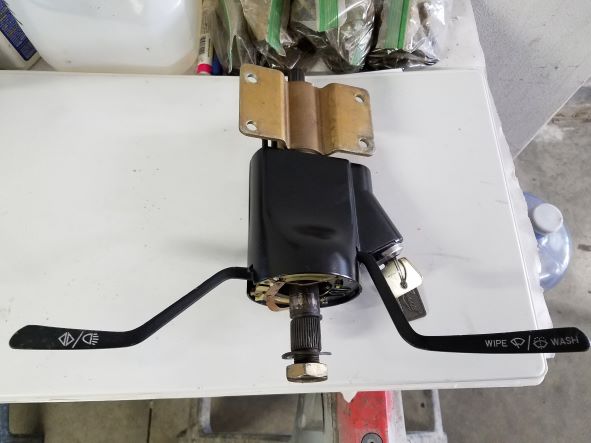

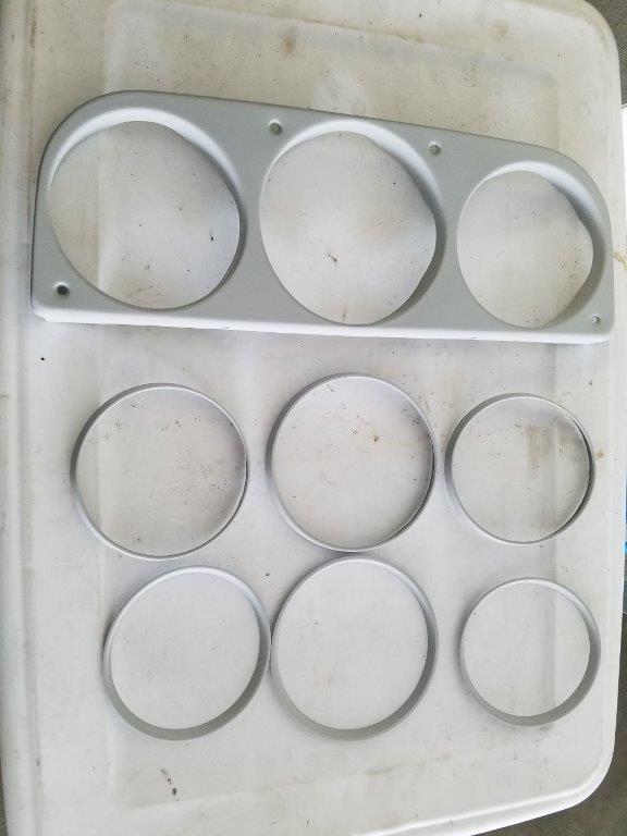

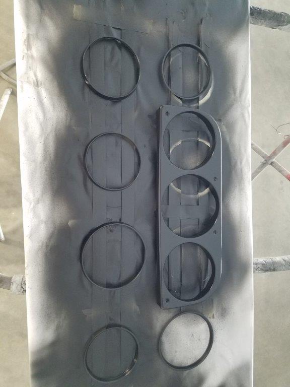

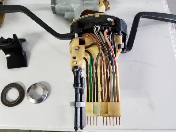

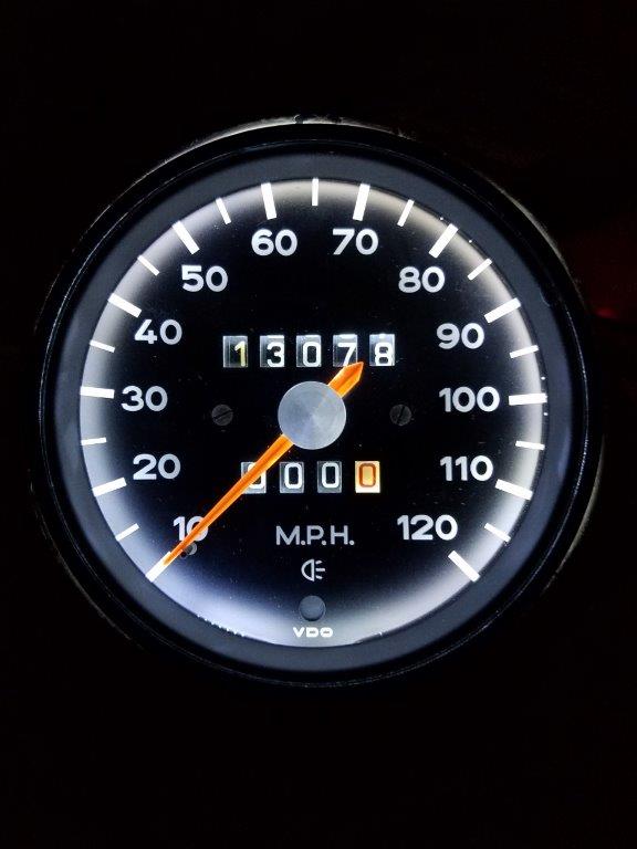

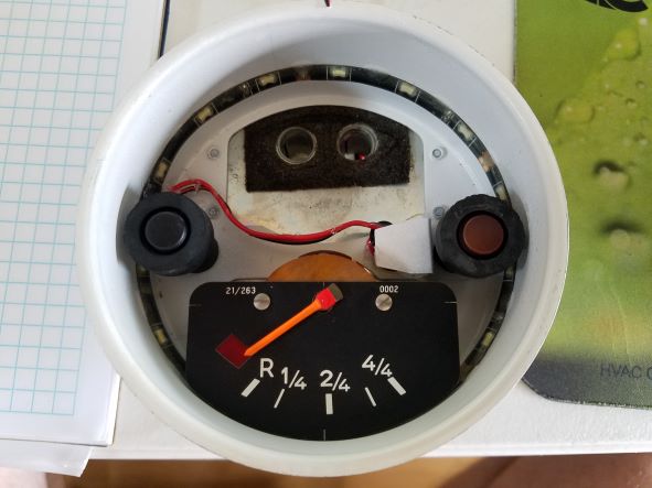

Added LED's to my gauges and now they are nice and bright, my eyes will be able to see them at night now

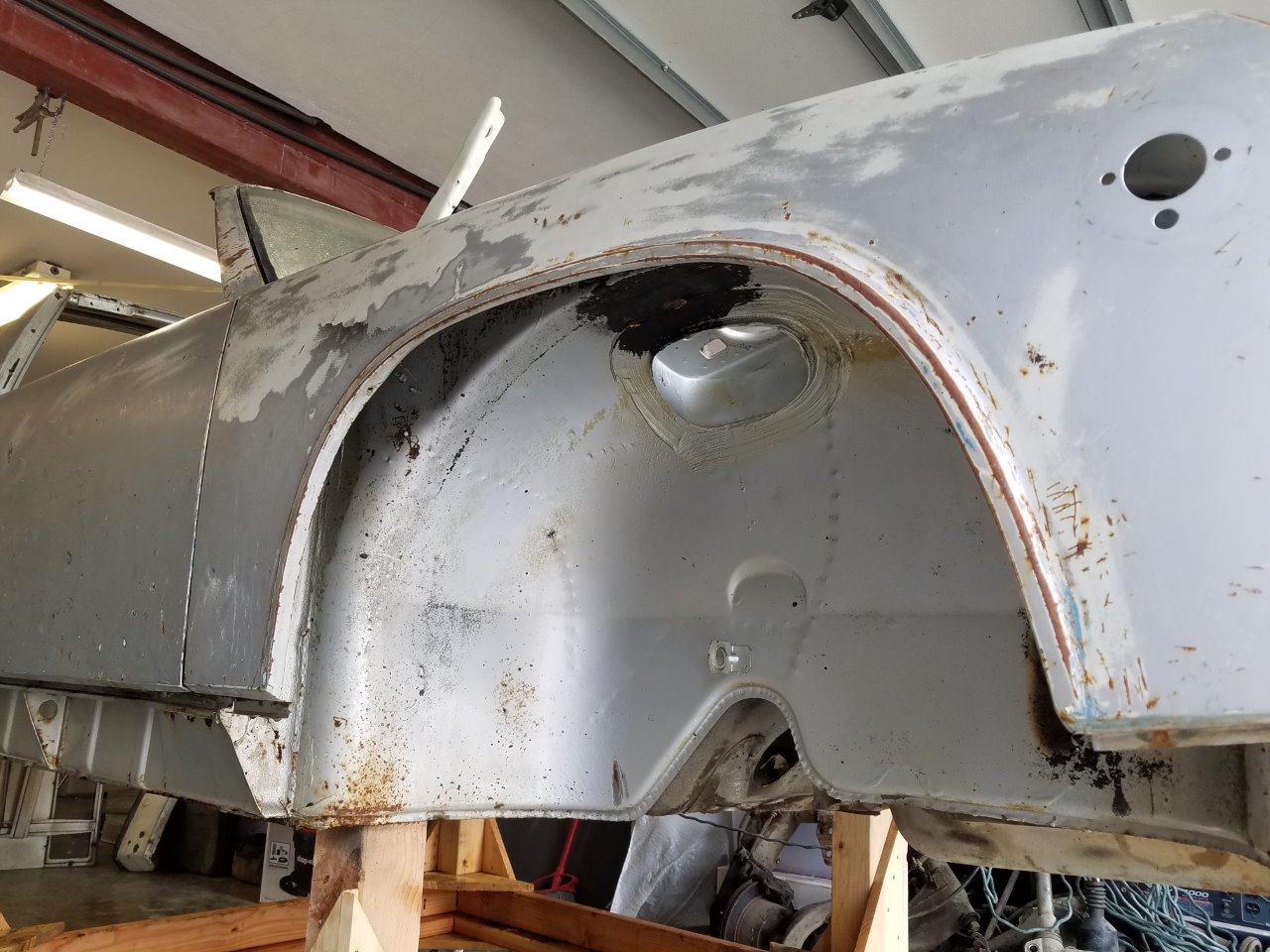

Had to do a bit of wire repair and paint, I was lucky that the original stamping was still visible on the parts so I avoided painting over those.

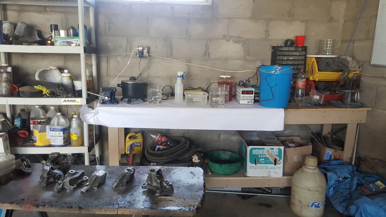

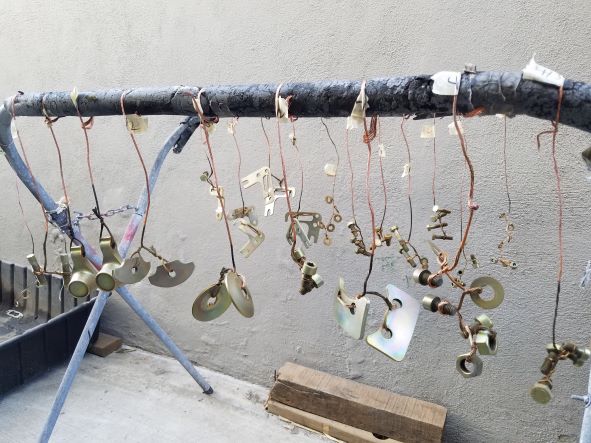

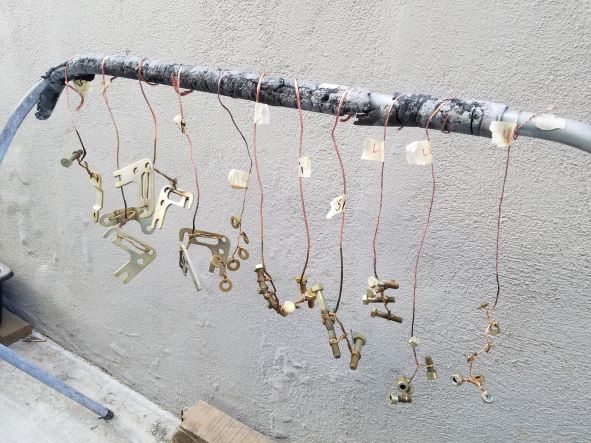

My homebrew plating operation stirthepot.gif Not professional quality results but I am happy with the way they turned out.

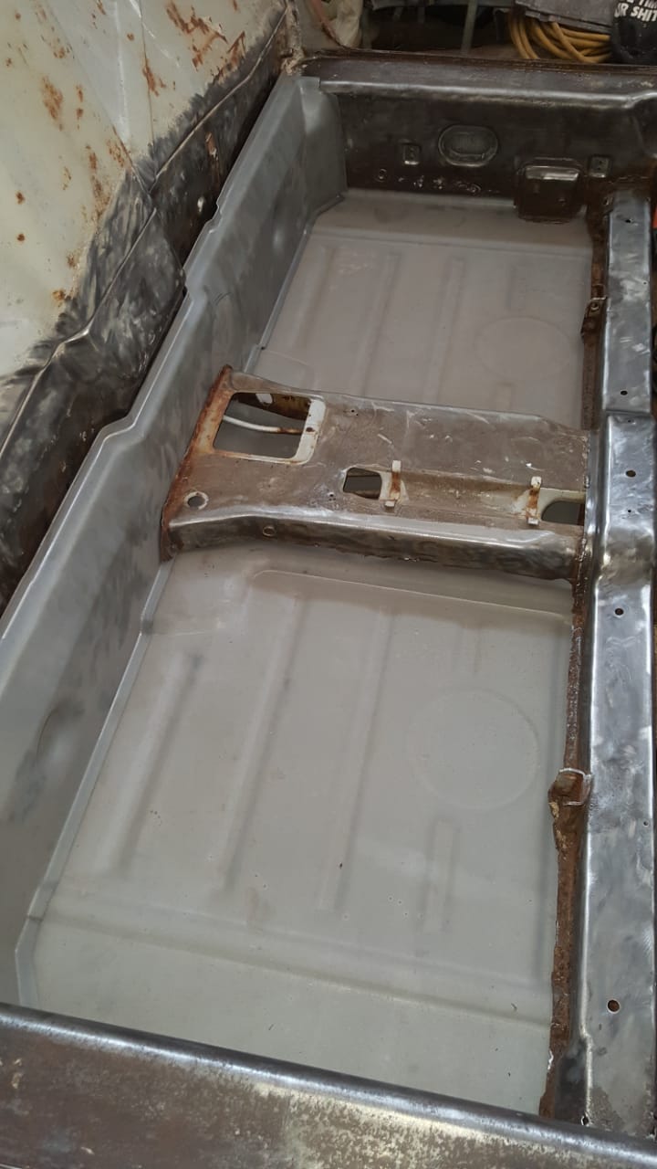

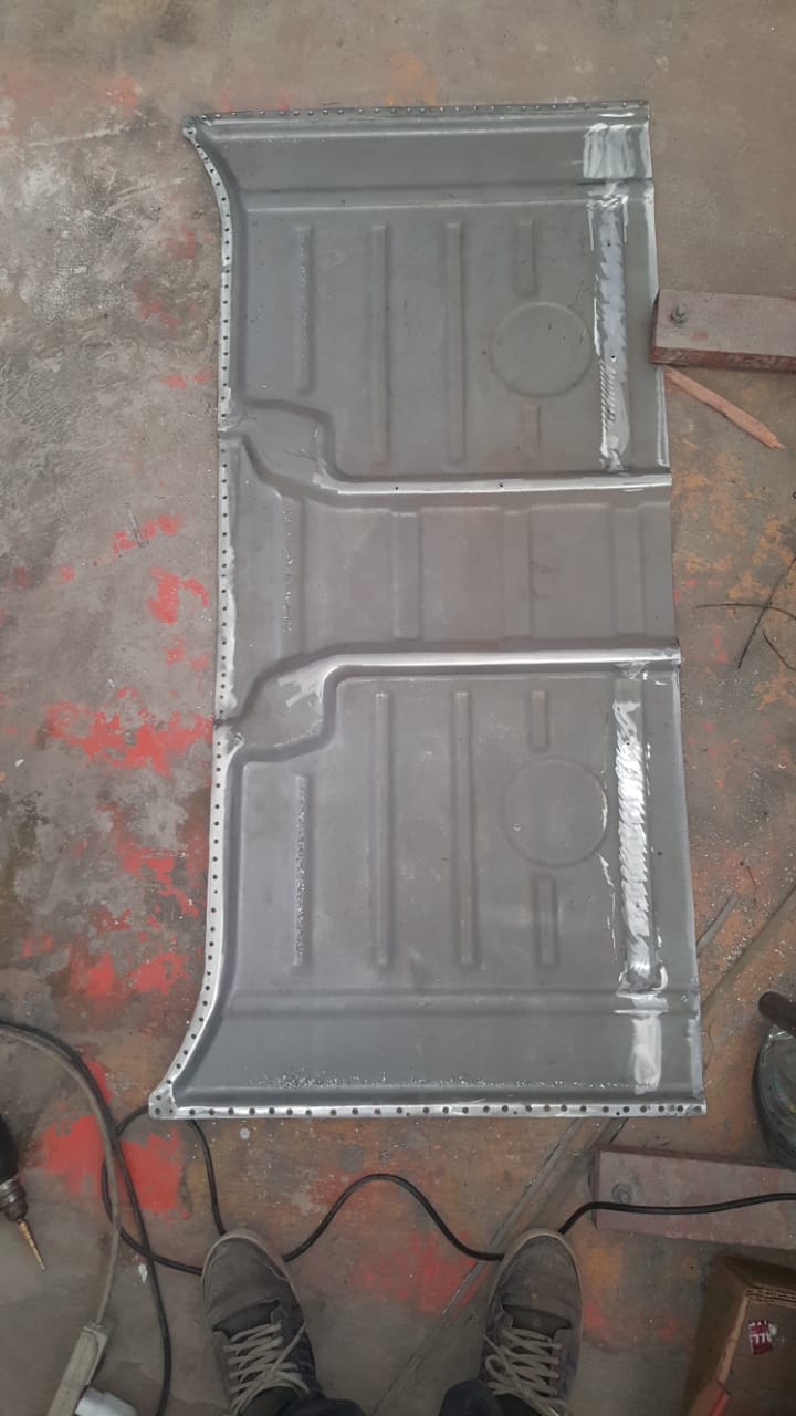

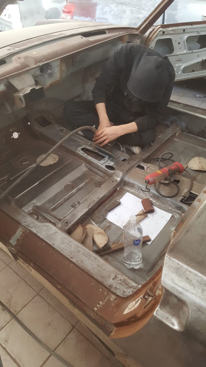

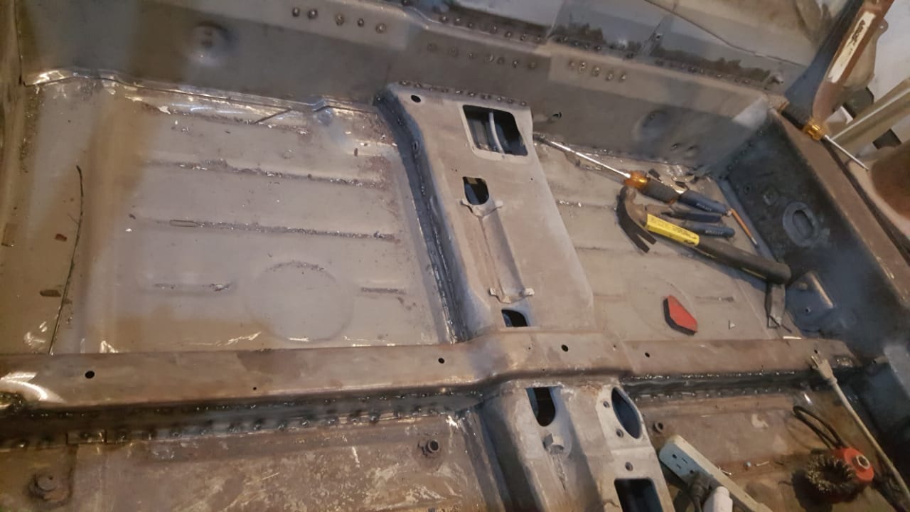

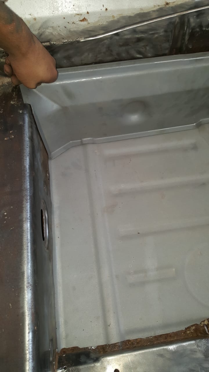

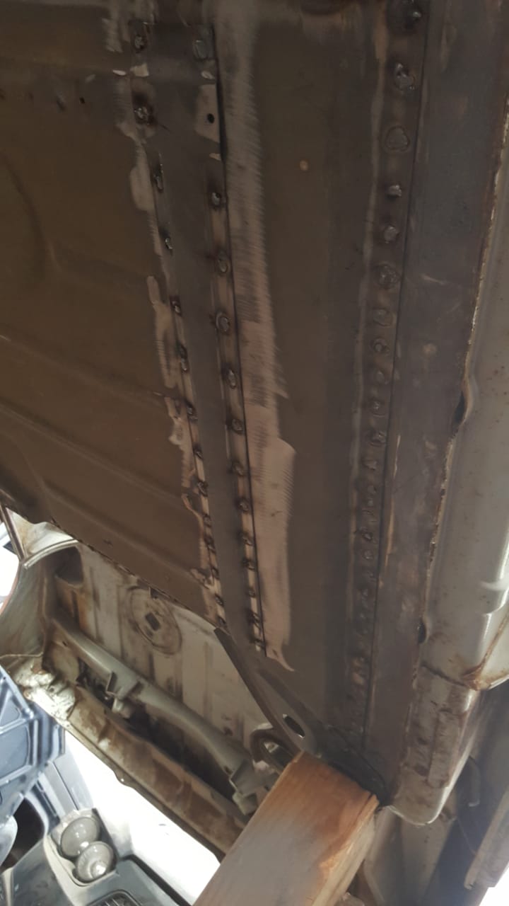

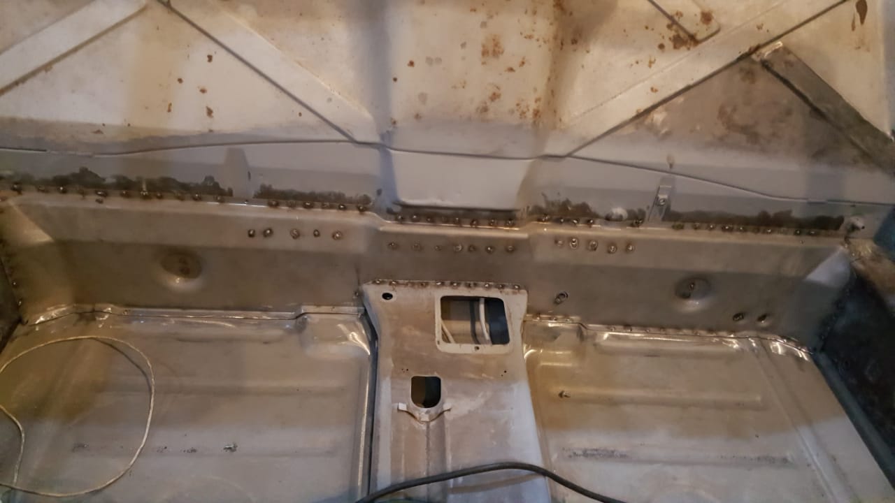

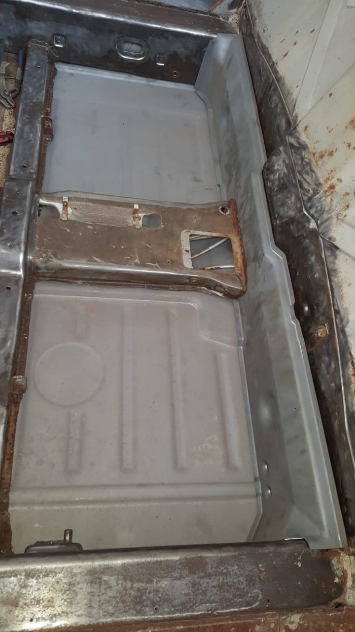

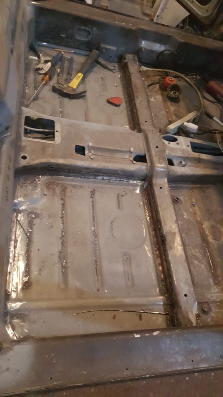

Even though the car was fairly rust free, the rear floor section had some pretty bad rust. I bought the replacement panels from Restoration Design and they fit great right out of the box cheer.gif
autopro

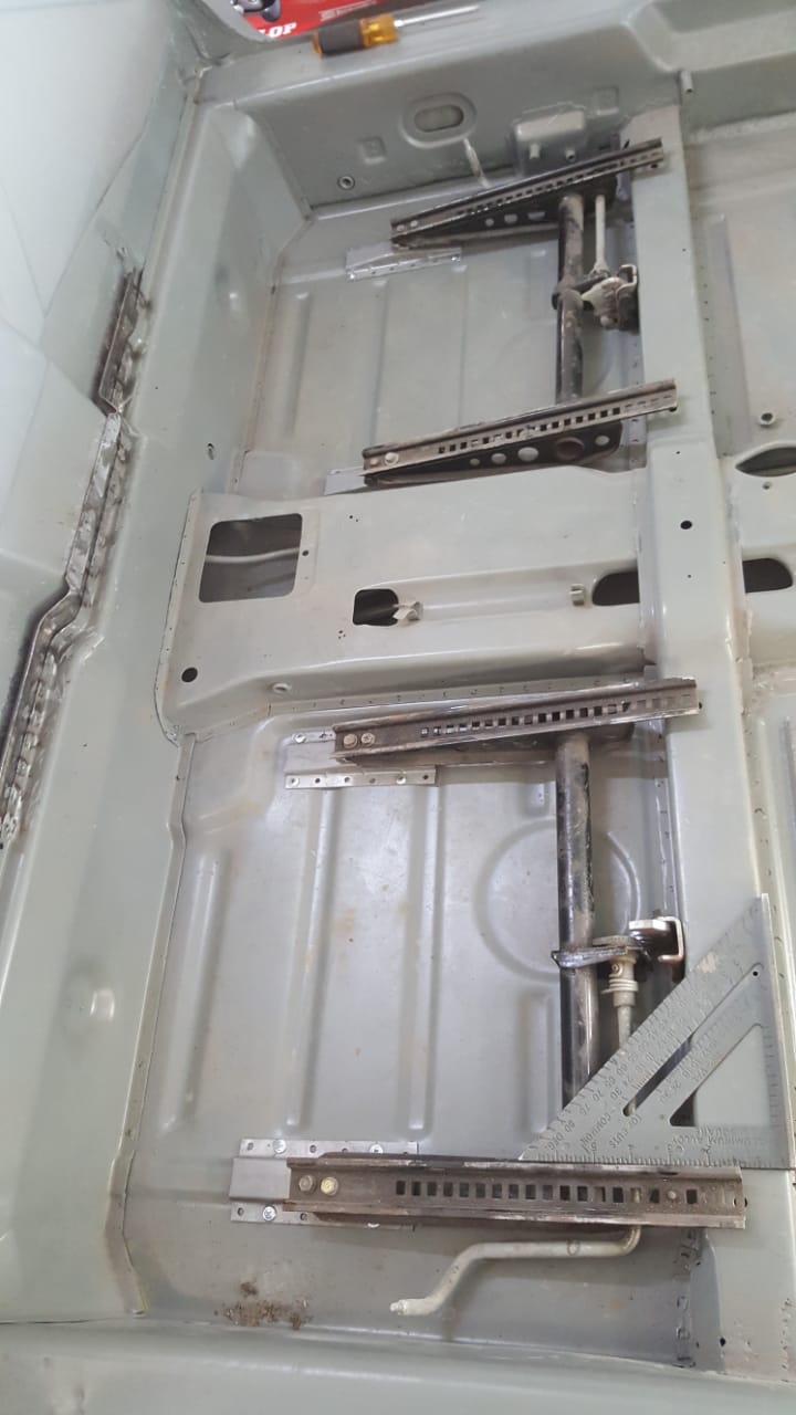

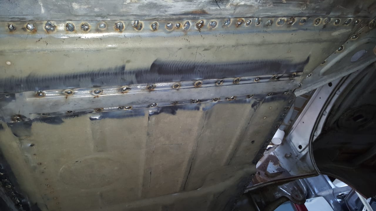

At this point I was happy how everything was fitting so I started welding everything up. When I was done I noticed that I forgot to install the bracket for the back seat upholstery blink.gif Needles to say I had to drill out the welds and put the bracket back in.
autopro
Here is the bracket installed and the installation of the seat rails.

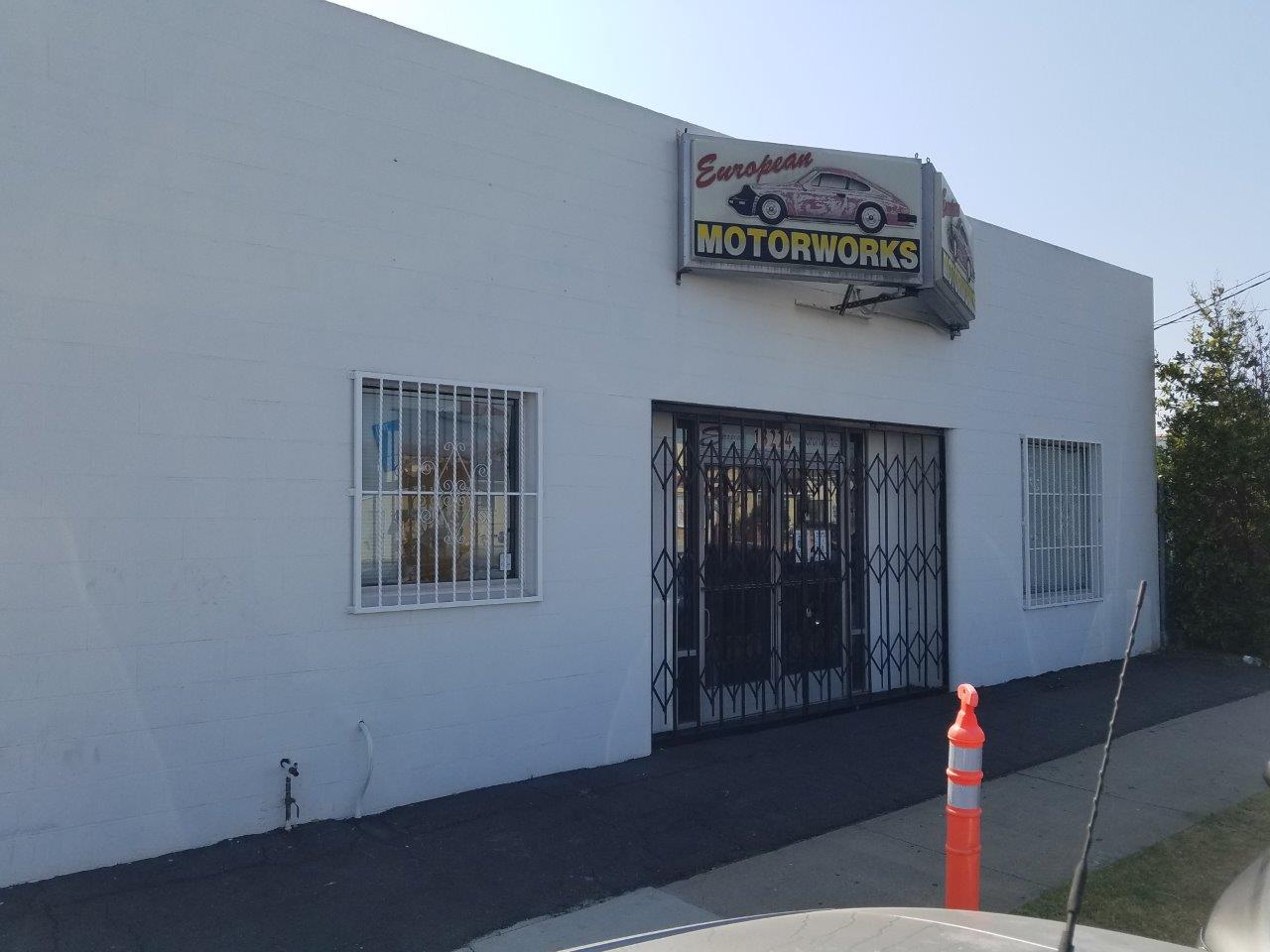

Last week I took my engine on a little trip to LA, some of you might recognize the place. It has been great working with them, Jorge and Carlos have been great to work with.

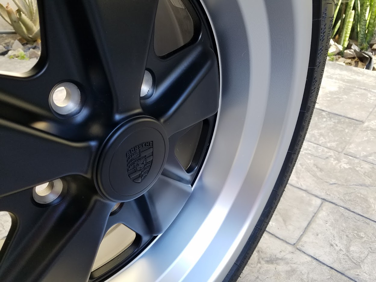

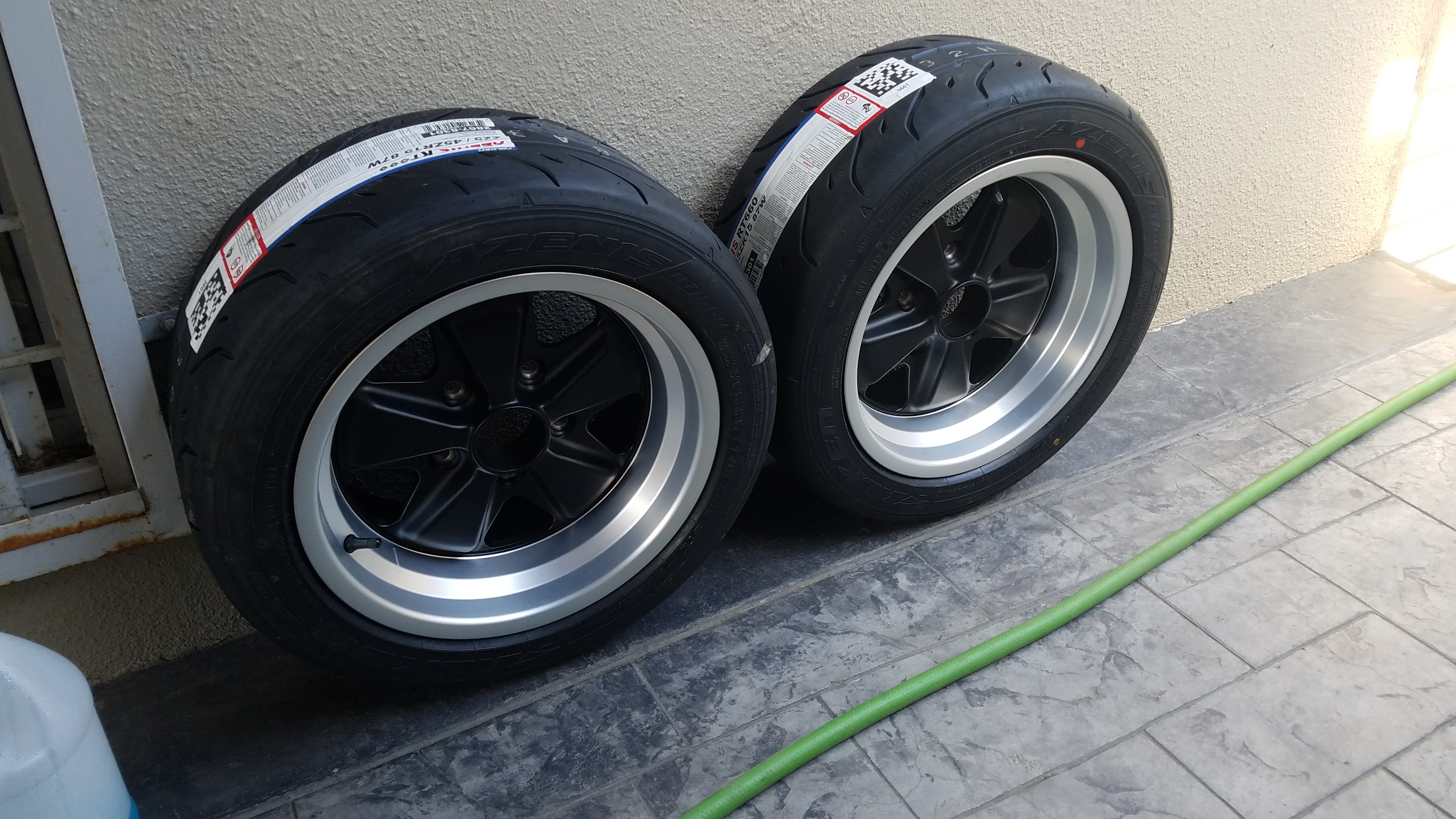

Got my boy some new shoes. Bought these from Maxilite wheels and I think they look great. Sizes are 8x15 and 9x15, tires are FALKEN AZENIS RT660 225/45ZR-15 and 245/40ZR-15

Thanks Oscar, I am going wide-body. It was a tough decision to cut up the car sawzall-smiley.gif but I love the look, so no looking back now.

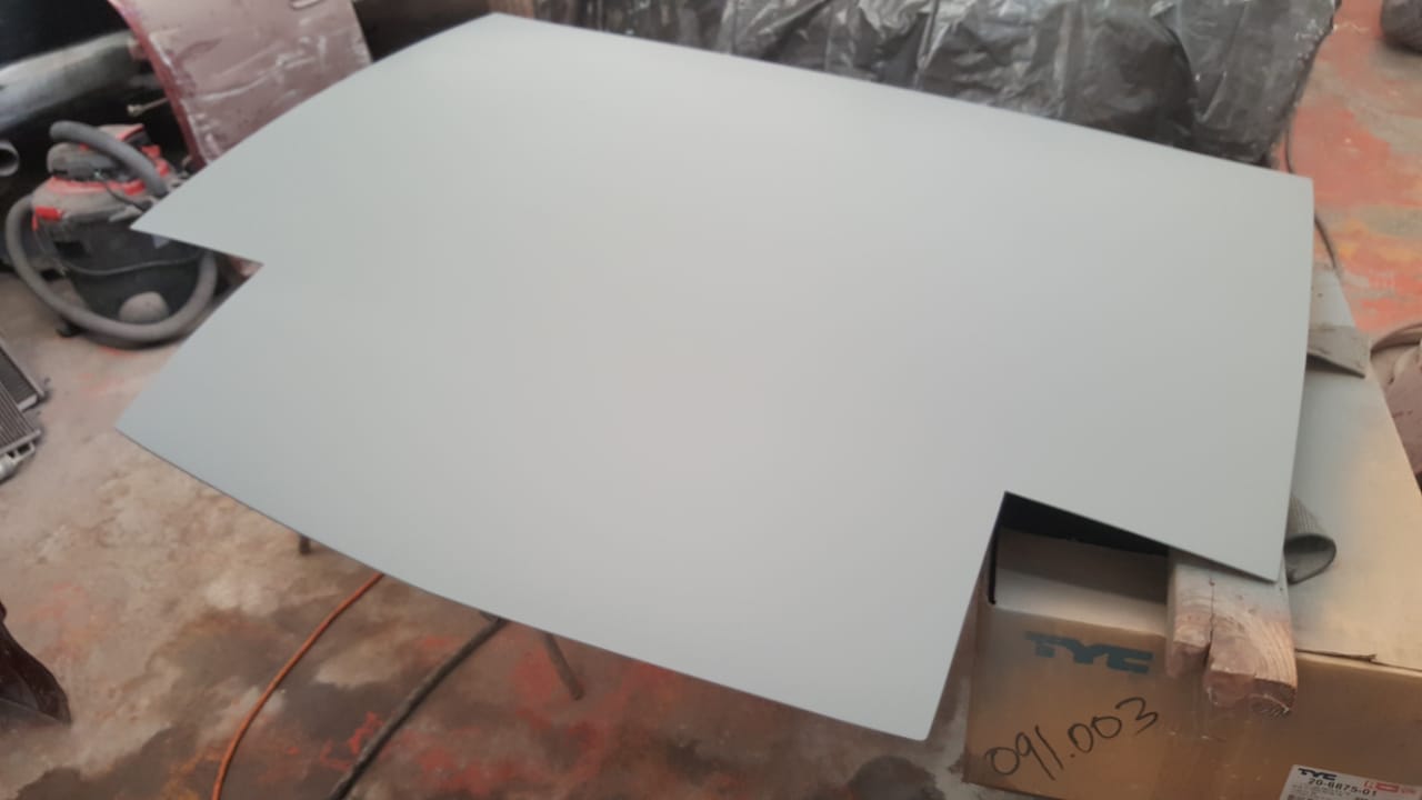

autopro

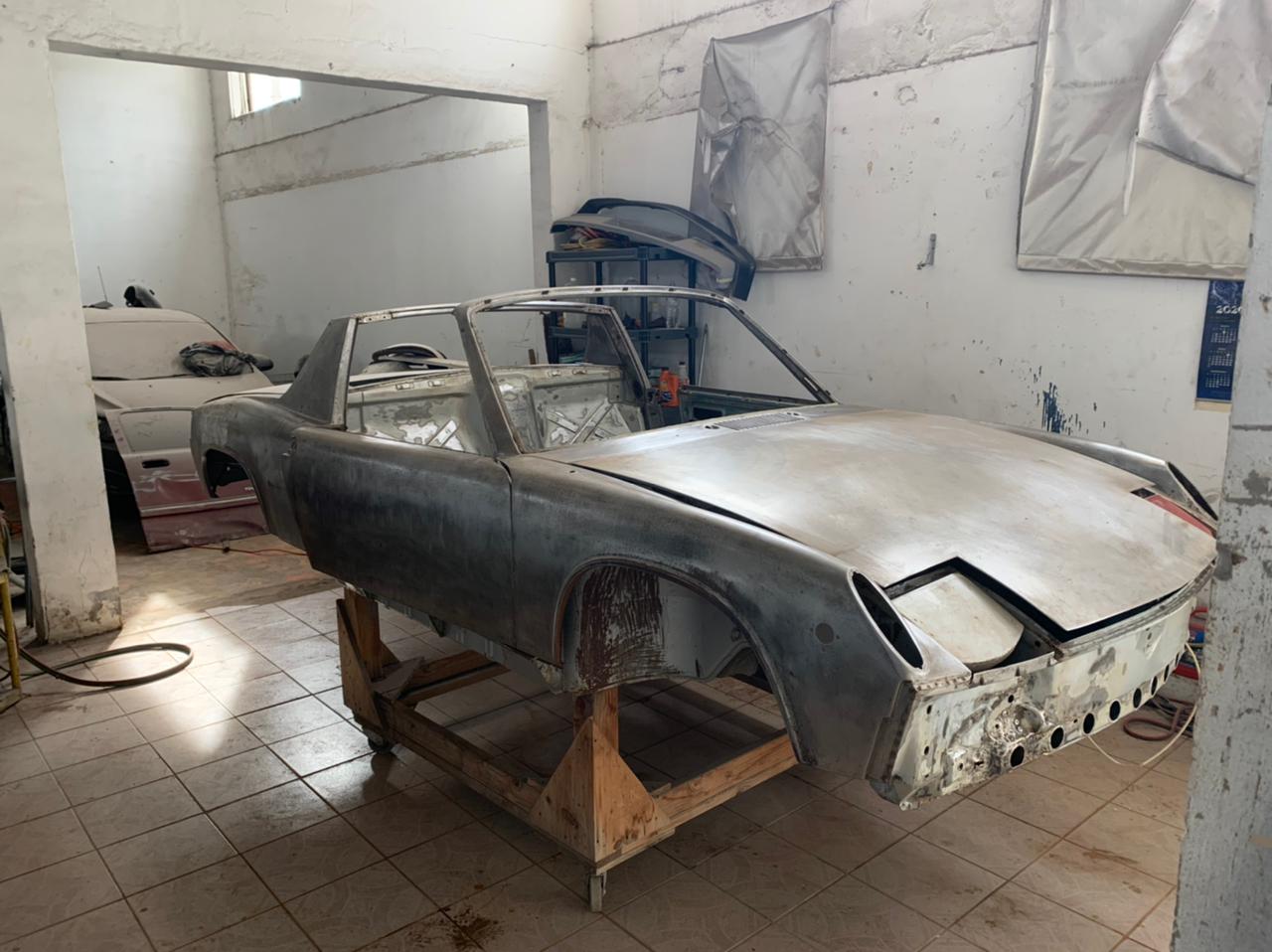

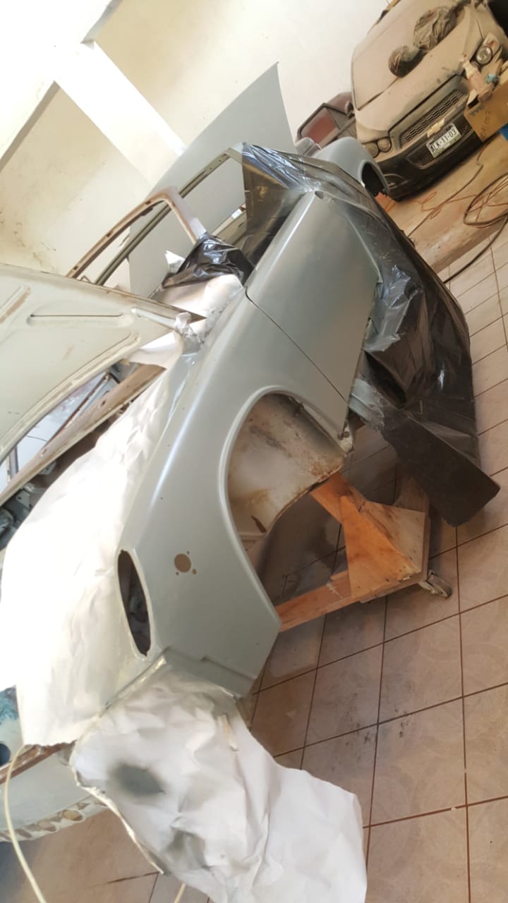

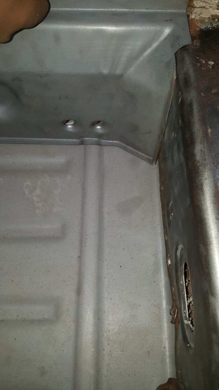

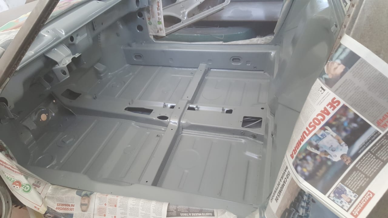

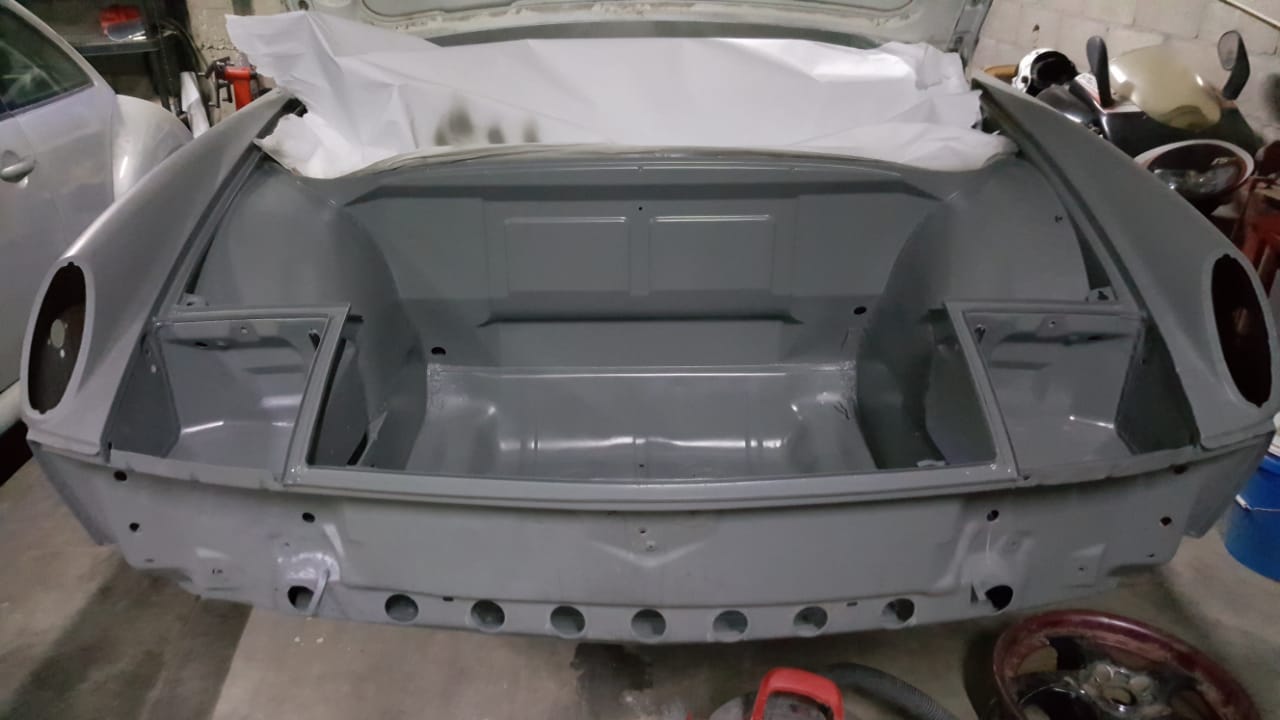

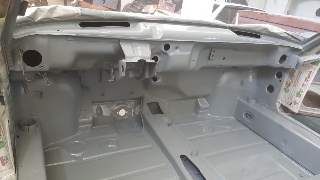

Primer inside the cab so it doesn't rust again.

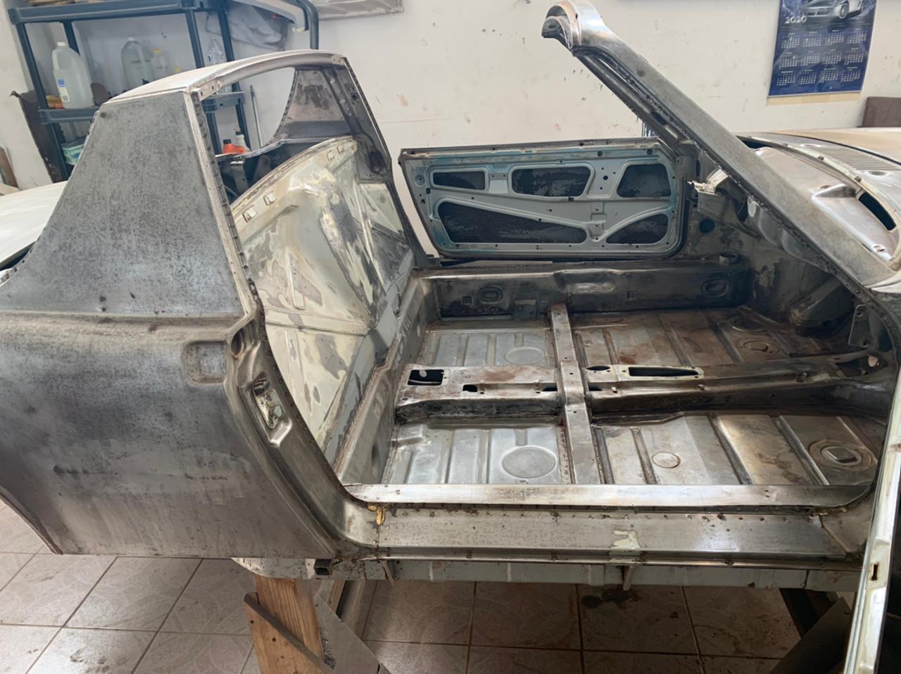

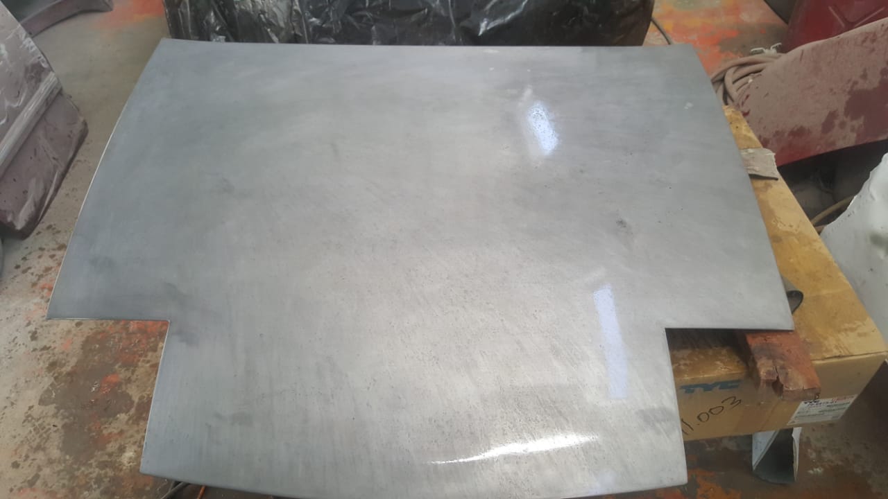

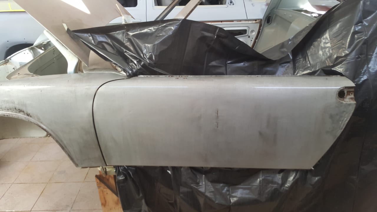

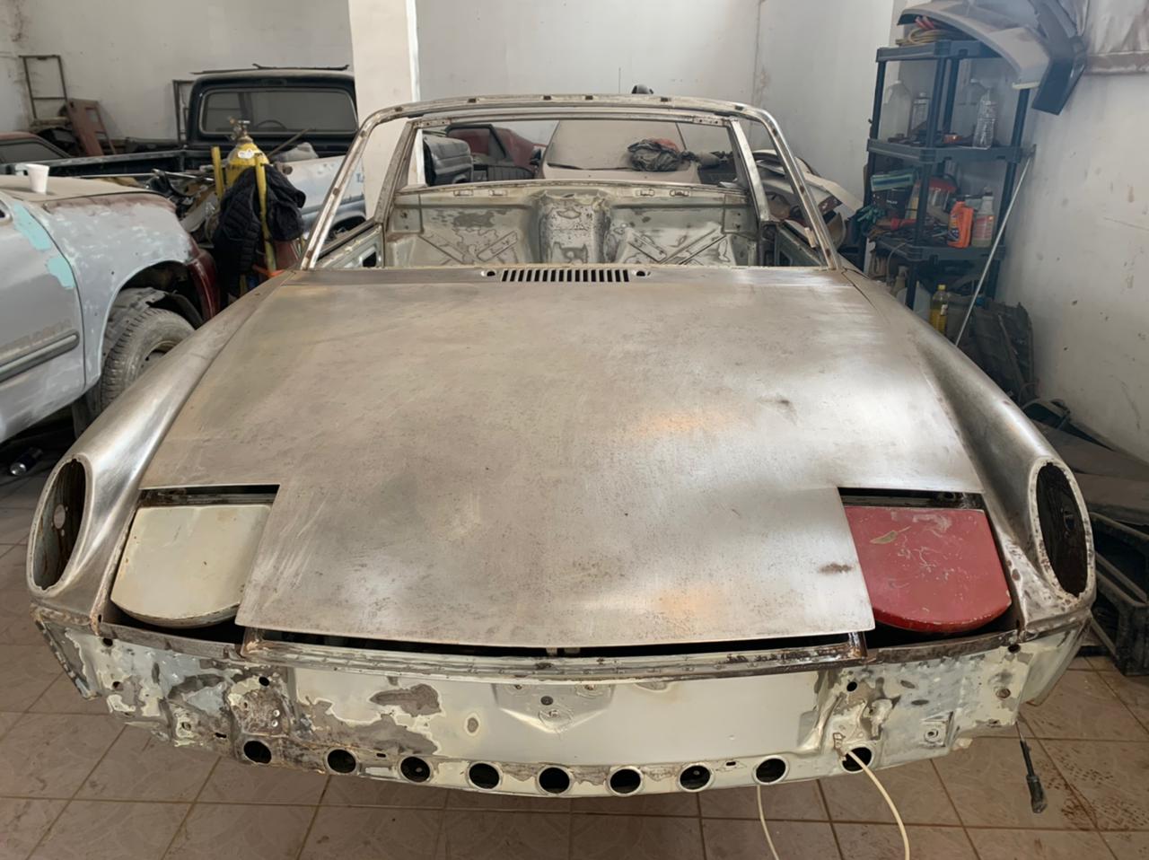

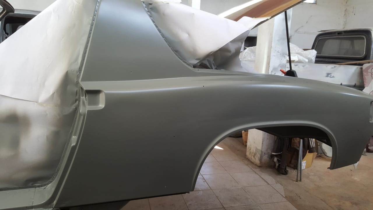

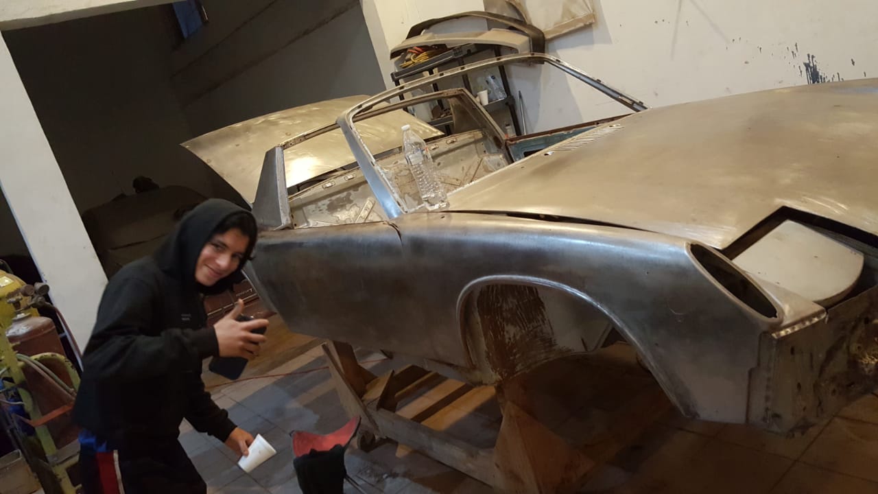

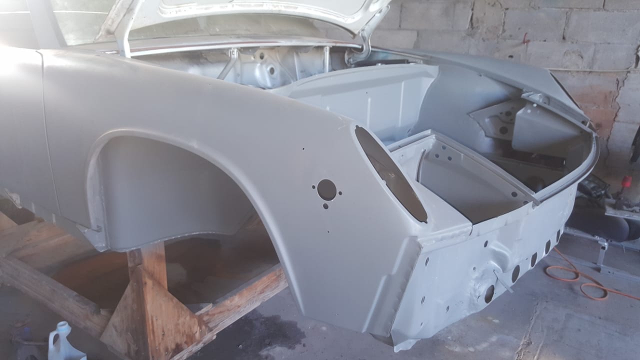

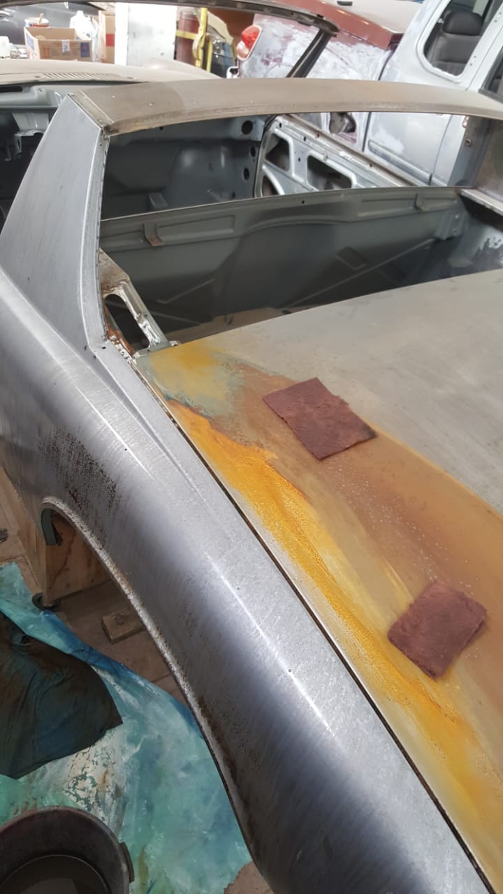

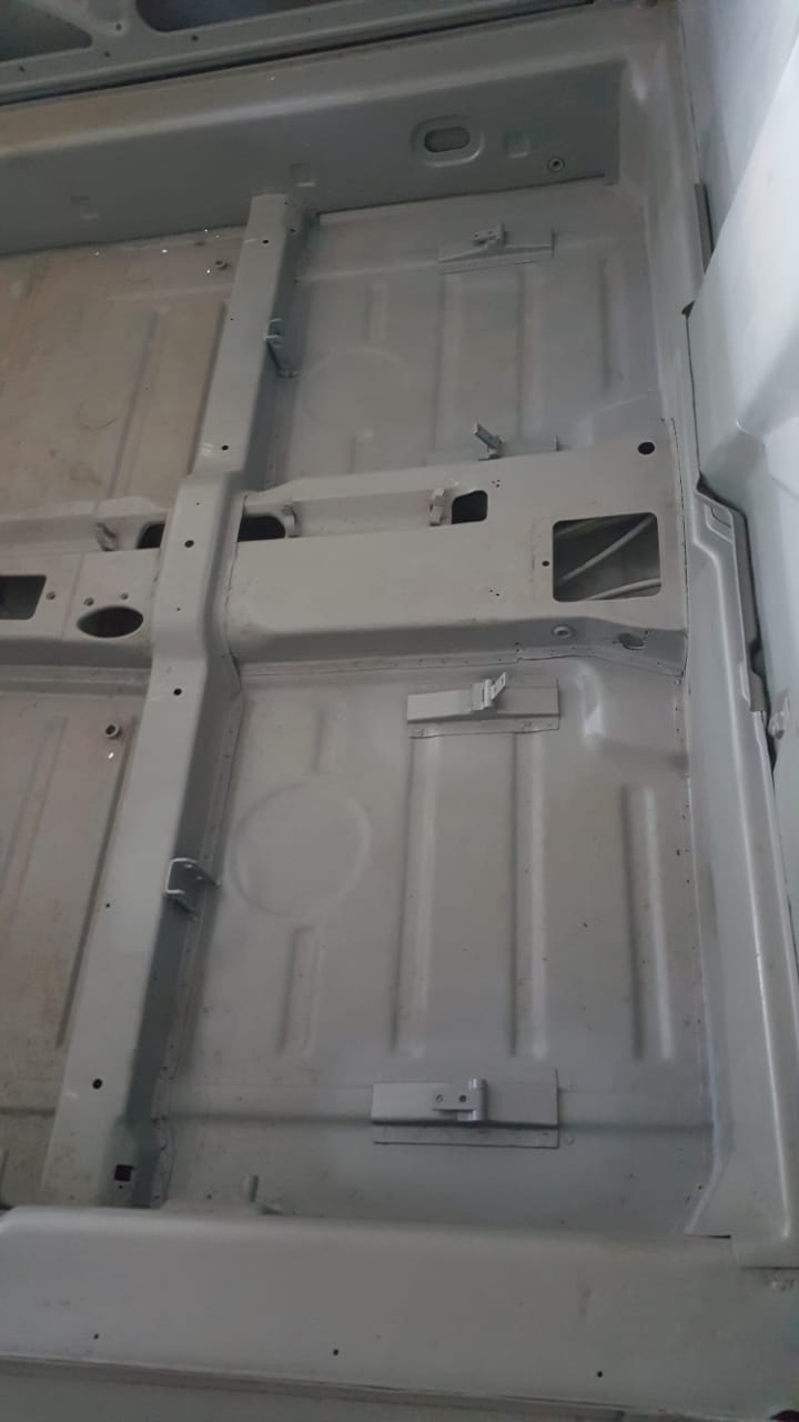

Work continues on the metal prep prior to epoxy primer. Had to work in sections to get the epoxy primer on before the panels developed surface rust again.
autopro
A few more. I was able to finish the whole car and now it will be ready for body work.
