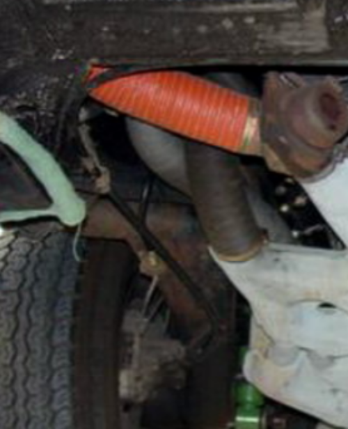

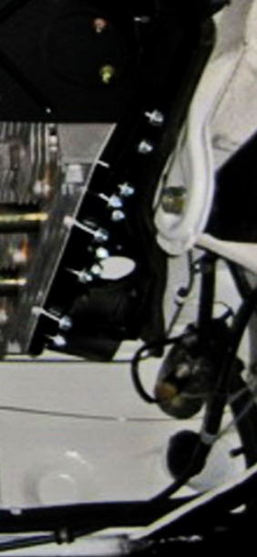

Been wondering about these orange straps, I have only seen a very few. What do we know about them?
What is their function?
My limited info suggests they are on the 1973 cars...but were these provided on all/other years? D-Jet only or L-Jet too? All engine sizes?
Original factory equipment or recall?
What are these made of - cloth, vinyl, rubber? Length/width/thickness? A pair of holes for mounting?
Anyone have these available or willing to repro them? I will buy one if available.

We have actually reproduced these and are in the process of trying to figure out the same thing. I believe they were made to hold the throttle cable at an optimum angle.
Our sample was from a 73 also.
Pics to follow tomorrow

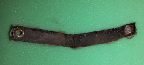

Yes. My '73 has one and it is known to be original on the car. In fact, I think the pic Jeff is showing is my car. Also noticed there is one on the '73 that George is currently selling. Noticed it because you never see them.
A pic from George's car:

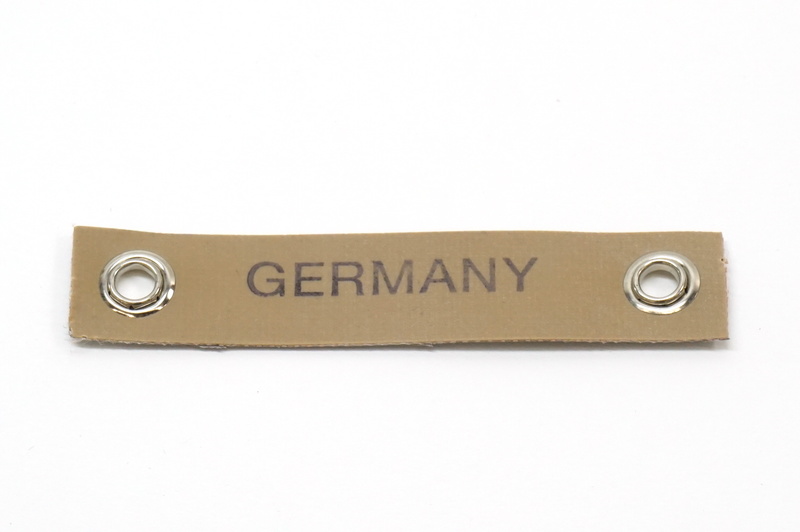

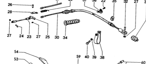

is iit this strap ,, re-purposed ??
on a six ive seen they were grey...maybe thats my hair color though
914Sixer
post Jan 23 2019, 07:06 AM
Posts: 9,453
Joined: 17-January 05
From: San Angelo Texas
Member No.: 3,457
Yep, repurposed strap. Also used on early 911 to hold brake cables same as the 914
sixnotfour
post Jan 23 2019, 07:17 AM
Posts: 11,184
Joined: 12-September 04
Member No.: 2,744
https://www.pelicanparts.com/More_Info/9114...-424-341-01-OEM

yes throttle holding cable, you can certainly see how original a car is if it is still connected,. Same part number as a 356 cable strap, available for years. Just no one knew about it., Just got a car in and still has it attached. Neat vintage concours item

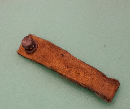

Well I'll be...! I've had this thing in my grungy spare hardware bin for 30 years and never had a clue what it was. Now I know. Thanks! (IMG:style_emoticons/default/beerchug.gif)

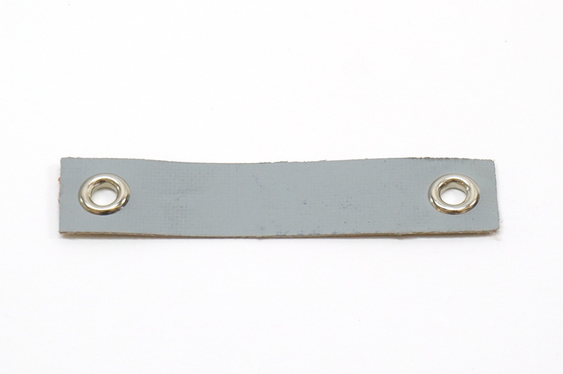

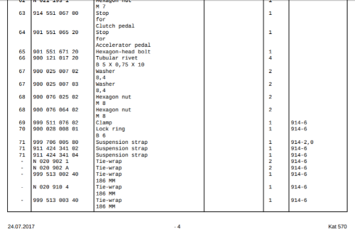

Great dialogue...but questions remain:
They have been documented here on several 1973 /4 cars so far...but were these provided on all/other years? D-Jet only or L-Jet too? All engine sizes? They are appropriate for /6s apparently but how were the three PN's used and how were they mounted in a /6?
Material - cloth, vinyl, rubber? Length/width/thickness? A pair of holes for mounting? Grommets/no grommets?
The two from Pelican above look similar to but not the right color or length. Three PNs are listed...for the /6's.

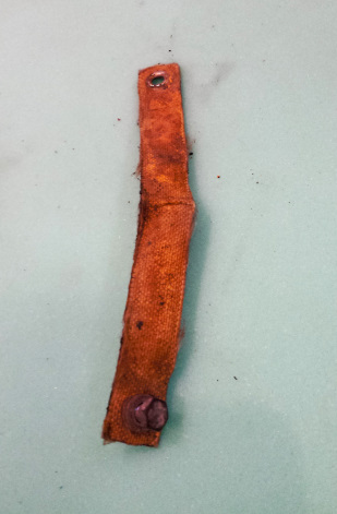

Jeff, Happy to take more pics and get measurements on mine this weekend. As I recall it is cloth with a rubberized backing.
bbrock
post Jan 23 2019, 09:33 AM
Posts: 5,269
Joined: 17-February 17
From: Montana
Member No.: 20,845
Mine too. Cloth canvas with what appears to be a tar or bitumen type backing. The orange color looks like it was sprayed on somewhat thick originally and is flaking off on mine. Mine came off a 73. Most likely from a 2.0 L but I can't rule out (about a 30% chance) that it came off a '73 1.7L I used to drive.
I want to keep mine but would be happy to loan it out if it helps for reproduction.

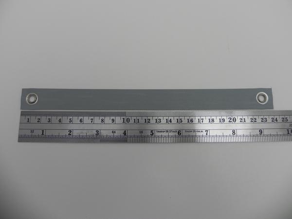

brent whats the length ??
bbrock
post Jan 23 2019, 11:01 AM
Posts: 5,269
From: Montana
Member No.: 20,845
QUOTE(sixnotfour @ Jan 23 2019, 09:54 AM) *
18cm x 2cm (and folded in half of course). Grommets are centered 1cm from each end. Secured with an M6x15 bolt and flat washer.

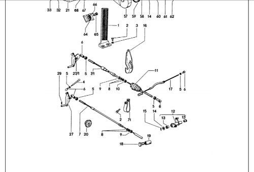

here it is related to accelator parts

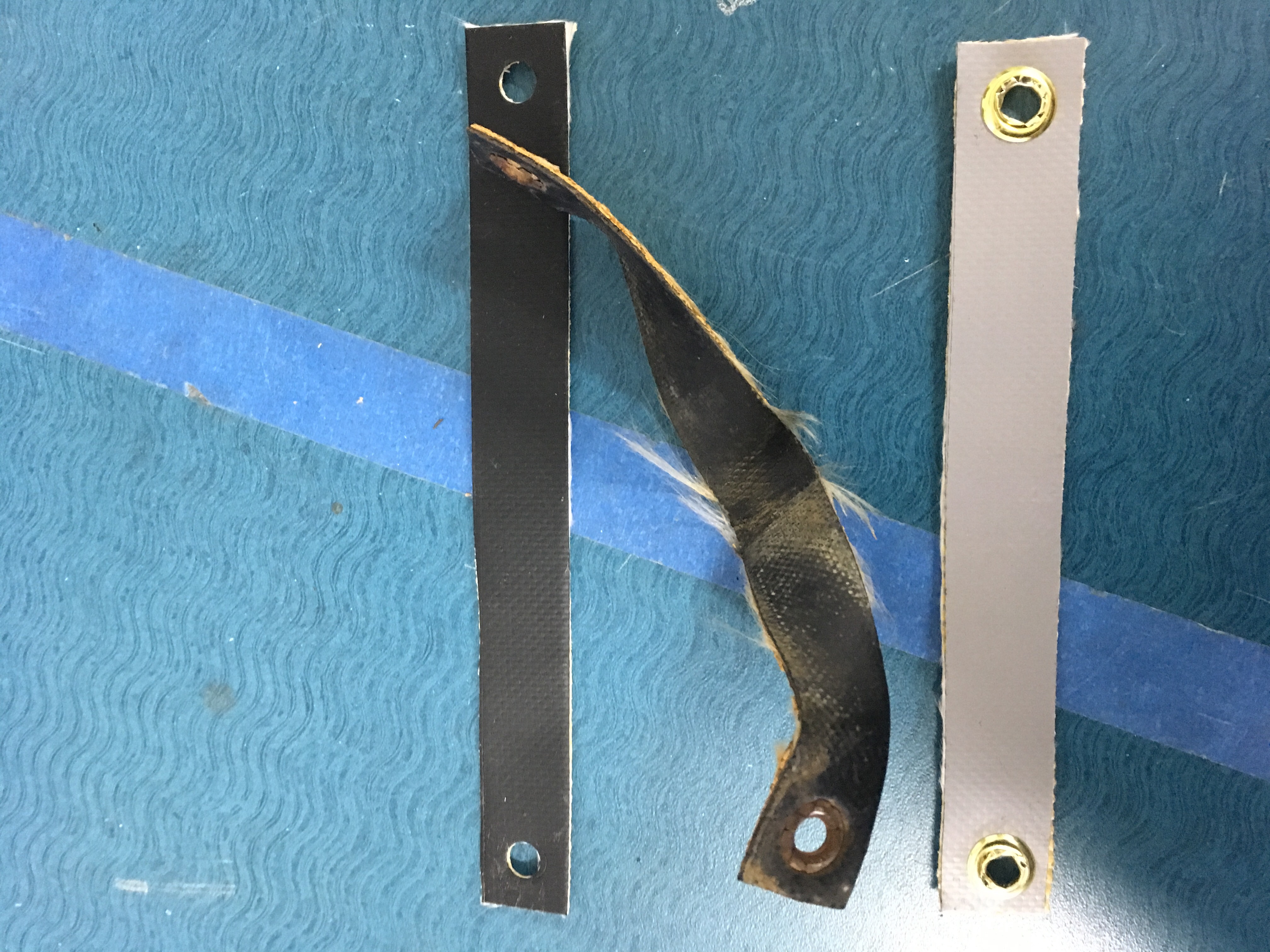

Mikey914
post Jan 23 2019, 01:47 PM
The rubber man
Posts: 12,772
Joined: 27-December 04
From: Hillsboro, OR
Member No.: 3,348
Grey or black $6
Will be ready next week
