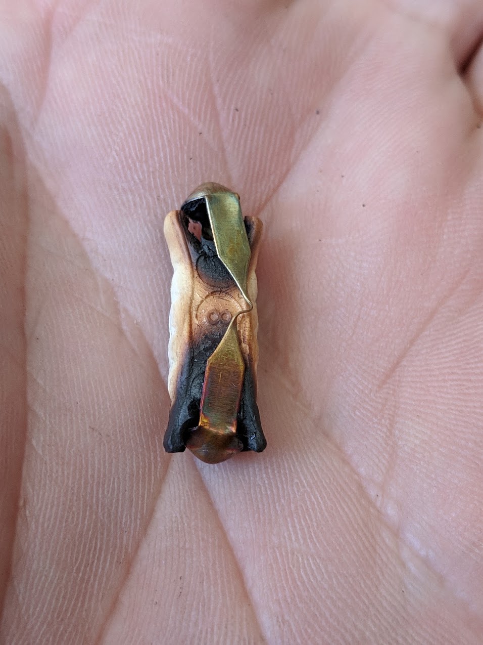

I was looking closer at the fuse and whadya know, the metal is intact. What causes the ends to get roasted like this without the wire breaking?

QUOTE(Jameel @ Apr 19 2019, 09:38 PM) *
You're showing an 8 amp fuse but said earlier you expect the current to be 20A. Did you try a 20A fuse?
Notice the fuse plastic melted on the ends. This means there is quite a bit of resistance between the fuse ends and the metal tabs of the fuse panel. Have you cleaned the fuse ends and panel metal tabs? I recently did this on my 914 using a dremel and wire wheel. Had to be careful not to bend any tabs or break any fuses.
When I say quite a bit of resistance I mean like 0.1 ohm.
Power = I * I * R. Say you have 8amps and 0.1 ohm, that comes out to 8 x 8 x 0.1 = 6.4W! That amount of power dissipation will definitely melt the plastic without blowing the fuse.
If you can't figure out the existing fuse arrangement, Mark's suggestion is a good solution.

Great info. Thanks! I have not yet taken a close look at the panel. And for all I know the PO had the wrong fuse in there.

QUOTE(Jameel @ Apr 19 2019, 05:38 PM) *
Heat due to a voltage drop due to contact resistance. Current melts the metal, but not the plastic.

Took a closer look at the panel. I don't have an owner's manual, so I'm a little unsure of what fuse does what, and what size it's supposed to be. The cover plate has an icon of fog lights on the 3rd fuse from the right, but my melted fuse was the 4th one over. Weird. I think the PO wired things up wrong. There is a inline fuse going to the switch too, definitely not Porsche stuff. If anyone has a fuse box diagram for a '71 I'd love to see it. Looks like I've got some sorting to do to get this right.
