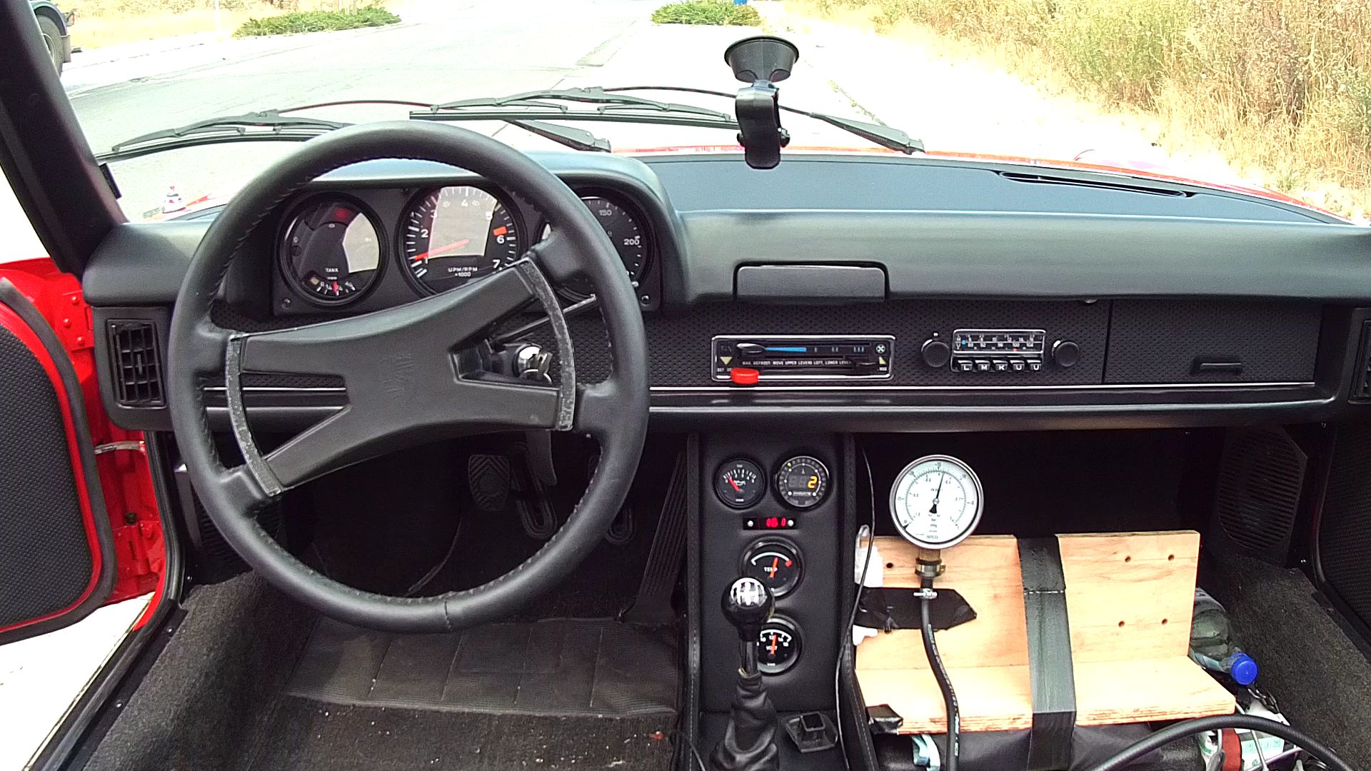

Just to follow up on this. I tapped a hole in the oil filler, threaded a fitting in it, and connected it with vacuum hose to air cleaner t reduce crankcase pressure. I also realized that I'm missing a sealing ring on my oil filler neck. Not the cork gasket, but there is a sealing gasket below the oil filler. Comparing with one from my other engine, I realized that must be part of the issue, so I swapped oil filler housings.
Right now the oil leaks on top have stopped. Some combo of relieving crankcase pressure, making sure the oil filler was sealed, and/or rings seating seem to have helped. I don't see anything really bad underneath, and I am now thinking at least part of the oil under the case was actually leaking from on top.

Good news is oil leaks are significantly better, and the engine gives nice power - a lot of fun to drive (IMG:style_emoticons/default/driving.gif) and the weather is looking NICE for the next few days.
