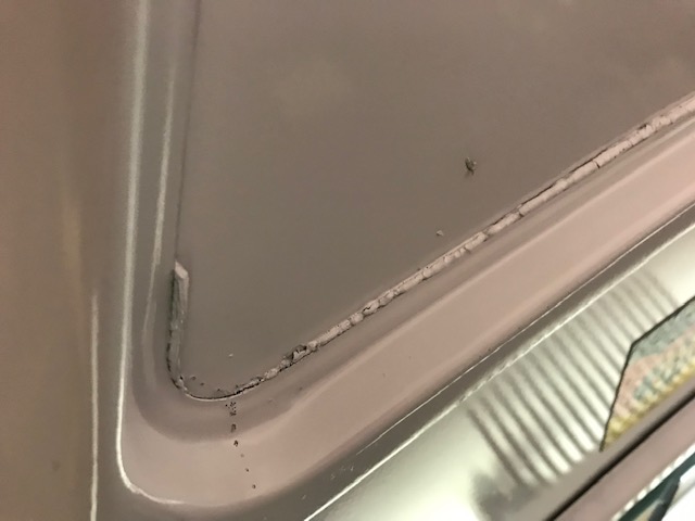

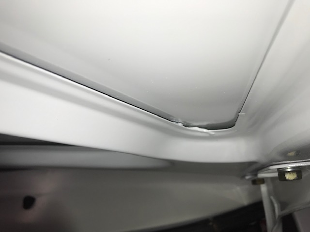

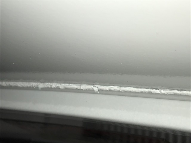

I agree with Bob, after reading his post, I would leave it alone. I did a close inspection of mine, looks like 45 years of temperature change, gravity, and stresses. Kind of like me!
Here are a few shots, of mine, just reference.

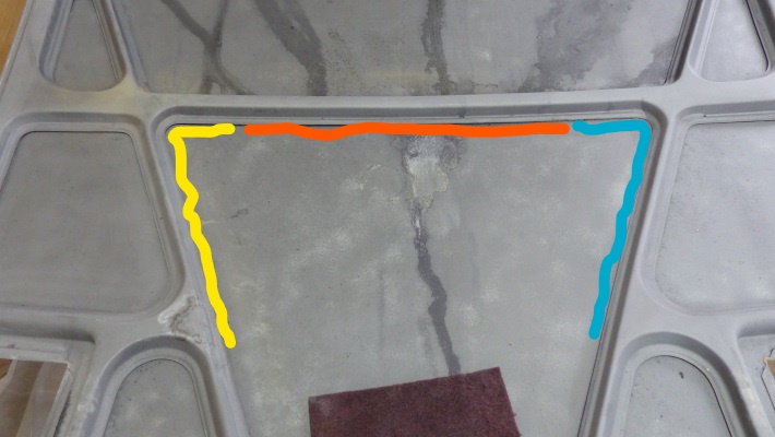

All, Thanks for the suggestions. Let me explain a bit more about what is going on here and what I plan to do.
First, the lid fits great. I've checked it several times to be sure. The gap between the frame and skin I want to bond is very small. It is only 1/16" to 3/32". The frame can easily be pressed tight to the skin with light thumb pressure
Below is a pic of the frame. I've done a lot of careful probing to verify how this thing is bonded. The blue line is the area where the frame is firmly bonded to the skin. I can neither flex (gently of course) the frame away from the skin there, nor can I slide a thin putty knife blade under that area. It is tight to the skin. My plan is to bond the matching area of the frame next to the yellow line. I'm unsure whether the orange area was originally bonded. This is the only area the frame is attached to the skin other than the perimeter that is crimped over the frame edge. This is clearly intended to allow the panel to float to allow for expansion and contraction. But this is precisely why I think an elastic adhesive is called for here.
So why did the frame lift off? Maybe the glue just broke down with age but I'm pretty sure it had some help. At the front end of the yellow line, you can see a small patch I welded in. The hood had been shut with a wrench or something laying near the shock mount that punch a little crinkle in the frame. It did not affect the skin and the distortion of the frame was slight but I'll bet when it happened, the force was enough to pop the frame loose along the yellow line. I've patched and straightened the damage to the frame and now just need to restore the rigidity to match the other side.
And yes, I'll be checking the fit again before committing the lid to paint. BTW, I'm not the only one to re-glue a frunk lid http://www.914world.com/bbs2/index.php?s=&...t&p=2590450 Now that I've looked at that again, I'm thinking I'll just do the same here.

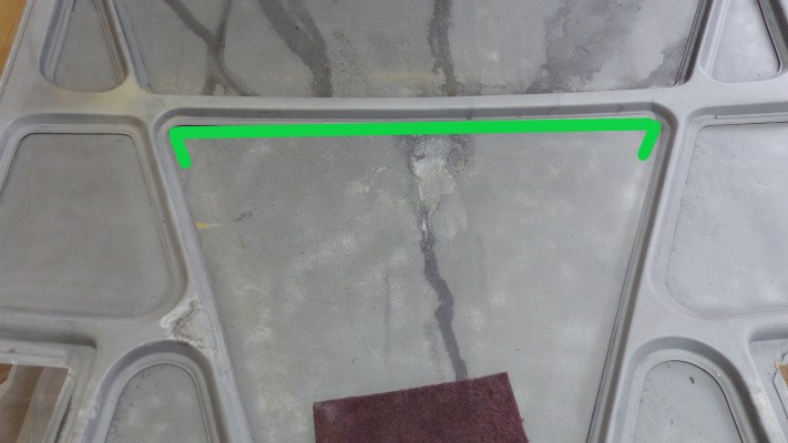

After refreshing my memory on what Kent did in the link I posted above on Cairo's Six, I decided to follow his lead and clean out the old factory adhesive. Doing that was great because I was able to see exactly where the factory applied adhesive and what they used. The stuff I pulled out is clearly a butyl caulk, still tacky and stretchy in the parts where the frame hadn't separated. I ran a test with scrap metal and verified that cured 3M weatherstrip adhesive is pretty much identical in look, tackiness, and stretch. The foam would probably be the superior product to use, but the weatherstrip adhesive will be more economical and will very closely replicate the original factory treatment.
Below is an updated image showing where the original adhesive was applied. Same as what Kent did but figured I'd post here in case someone stumbles on this in the future. The caulk was applied to the inner flange of the frame member only. (IMG:style_emoticons/default/beerchug.gif)
