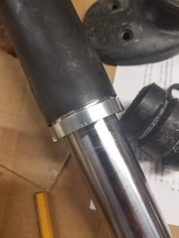

There is usually a 2-3mm gap between the strut body and the top cap. That's normal. It looks like it should screw down flat but it doesn't. That way you know it's tight without bottoming out the cap.
Also, Bilstein says no oil in the bottom of the strut like the old days. I still put in a tablespoon just in case moisture gets in to the strut body.

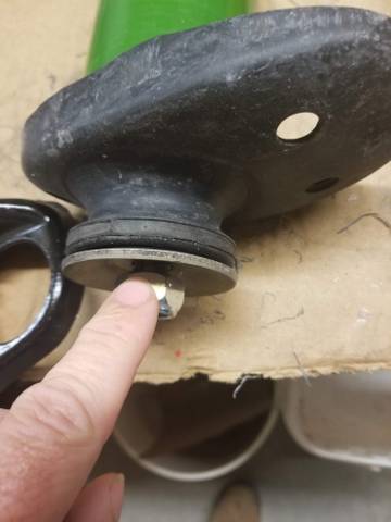

Is the special nut that ties the insert to the spindle housing supposed to tighten down flush, or is that the gap you are talking about. Mine wont tighten until the flange actual touches the top of the housing.Attached Image Attached Image What washer is supposed to go under the lock nut?

Is the special nut that ties the insert to the spindle housing supposed to tighten down flush, or is that the gap you are talking about. That’s the gap. Looks wrong but it’s right. I confirmed with bilstein the first time I did one.
Mine wont tighten until the flange actual touches the top of the housing. Correct.
The washer under the locknut is a thin washer with a small tang on the inside that lines up in the grove of the shaft so it won’t spin.

As I reread my post, I see how poorly its written. So the gap is supposed to be there, hmm any reason not to put an o-ring in there just to keep out moisture?
