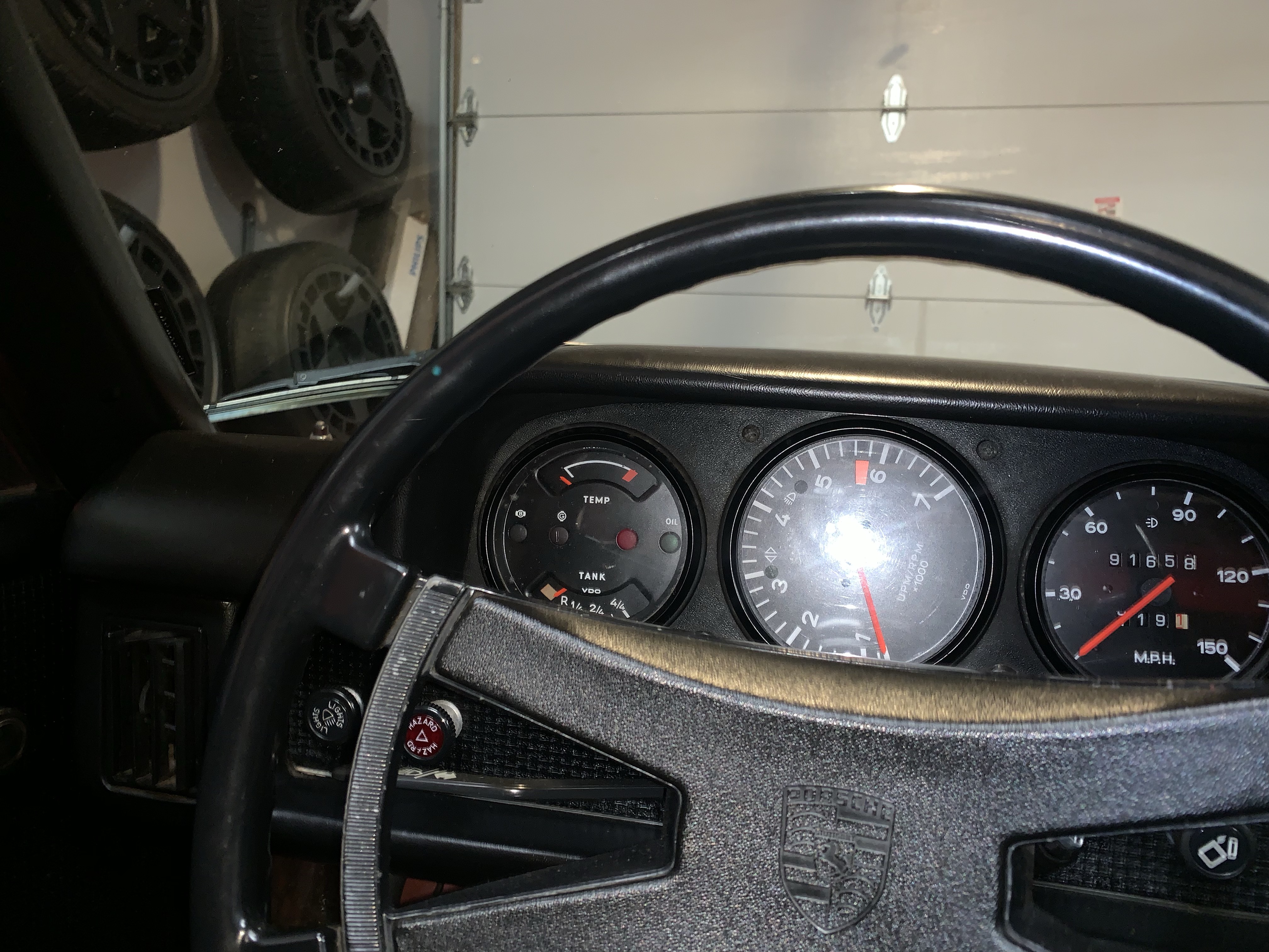

Yes, my temp gauge runs hot after 10 mins.

Since no picture are posted. Let's be sure we are talking the same part. I'm a bit confused since there really should be no tool access issues with getting to this sensor once the exterior cover plate is removed. Beware, removal of the two bolts will likely dump all oil if not drained and you start trying to loosen the sensor.
Here is the Taco plate located underneath the engine as shown in the Classified Forum.
http://www.914world.com/bbs2/index.php?showtopic=340764
Are we absolutely talking the same parts?
If so, the sensor probably isn't the issue and is more likely blocked cooling fins, blocked oil cooler, and be sure to check the fan to make sure you don't have a plastic shopping bag or other debris in the fan itself.
Early temp gauges had a wide red band. The tendency to run near the red band causes lots of worry without due cause. Later temp gauges had a much narrower band almost all the way to full scale.
See the difference in Kevin's link for consoles and gauges for sale. Early on left, Late on Rt.
http://www.914world.com/bbs2/index.php?showtopic=340745
Are you deep in the red?

Unfortunately, yes
RolinkHaus
post Sep 27 2019, 07:25 PM
Posts: 253
Joined: 21-July 18
From: Noblesville, IN
Member No.: 22,330
My gauge is in the deep red after 10 mins of driving.

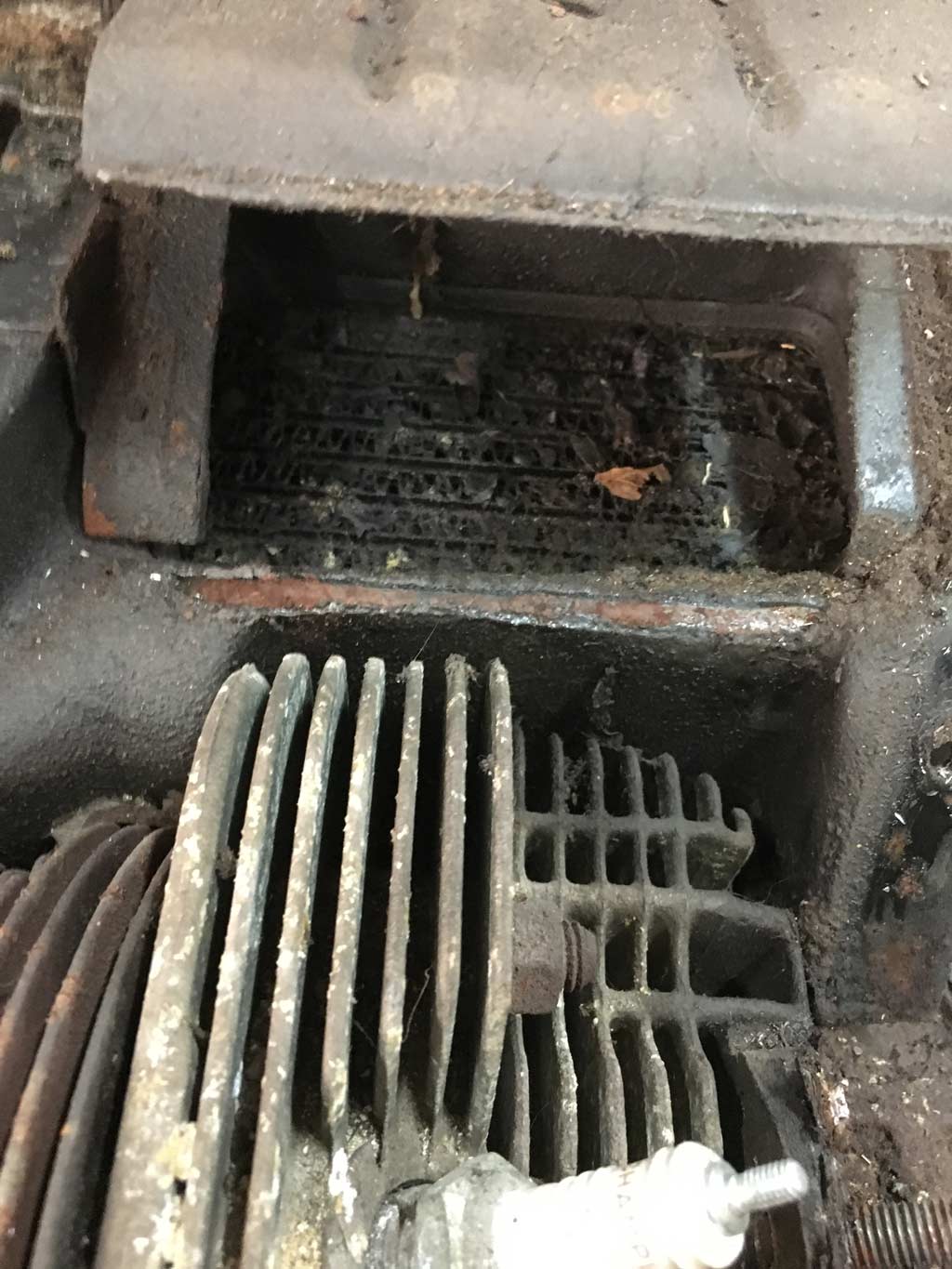

Blocked oil cooler is very possible. I've seen blocked cooler on all three engines I've torn down this year GA004310, GA000099, and the 2.4L six. Midwest cottonwood fluff is nasty and clogs leaky oily coolers.

You're scaring me. low oil pressure is consistent to severe overheating. Oil pressure light not on or flickering at idle when started cold?
Need to limit driving and engine overheating until you can figure out what is happening. Do you have an oil pressure gauge in your car or just the light? The light comes on only at ridiculously low pressure (something like 7psi). Way too low for a running engine at driving speed. Don't keep driving it with that light illuminated.
I forgot, but if I recall you car has cooling flaps still in place correct? Flaps are necessary to direct air over the oil cooler. Flaps move freely and not bound? Fail safe of the stock thermostat and flaps is for the flaps to go to the full hot position that directs max airflow over the oil cooler.
Post picture of the flap position both cold and hot. I just dropped all my shrouds off for powder coat or I'd take a picture to demonstrate what is inside and what you're looking for.
Per previous post, you need a means to look inside engine tin though the spark plug holes to make sure you don't have a mouse house like this.
Or a blocked / clogged oil cooler like this
Either via cheap borescope like I used on that 2.4L engine (~ $120) or USB version that will work with your laptop, or something.
