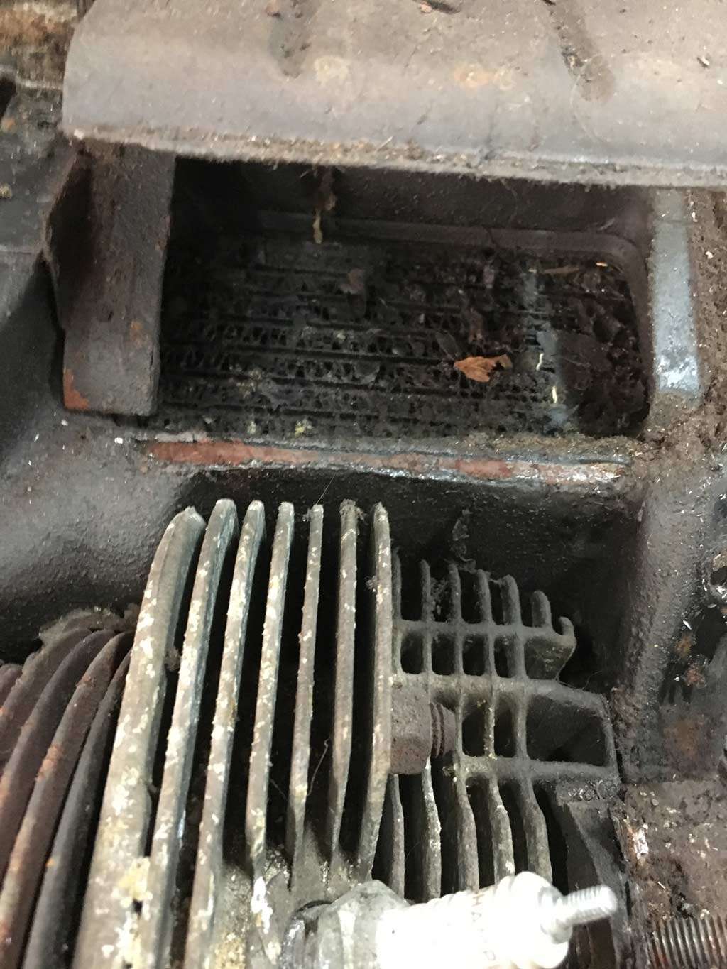

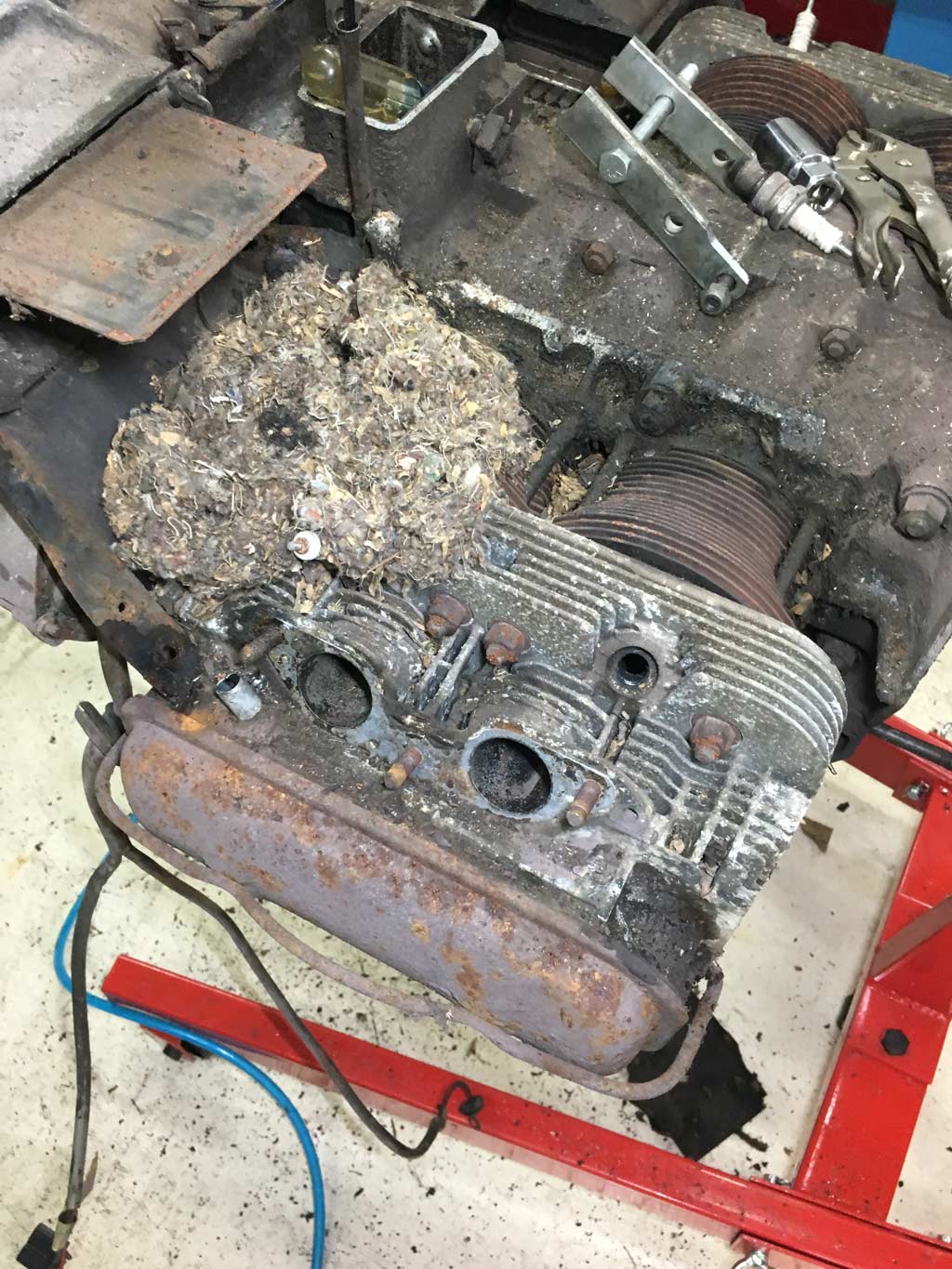

Per previous post, you need a means to look inside engine tin though the spark plug holes to make sure you don't have a mouse house like this.
Or a blocked / clogged oil cooler like this
Either via cheap borescope like I used on that 2.4L engine (~ $120) or USB version that will work with your laptop, or something.
