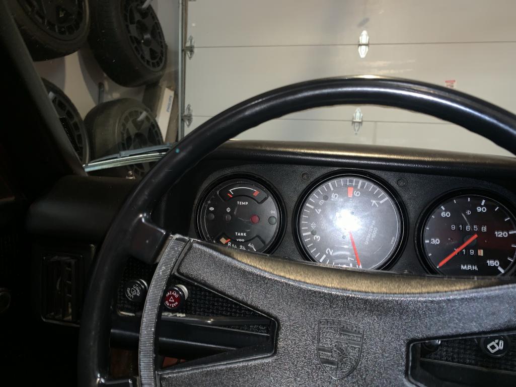

Superhawk996   Since no picture are posted. Let's be sure we...   Sep 27 2019, 06:39 PM
RolinkHaus   Unfortunately, yes   Sep 27 2019, 07:12 PM
RolinkHaus   My gauge is in the deep red after 10 mins of drivi...   Sep 27 2019, 07:25 PM

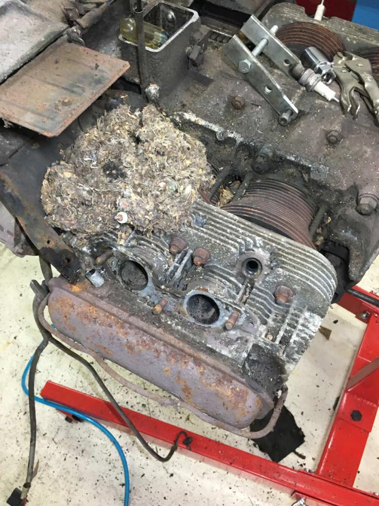

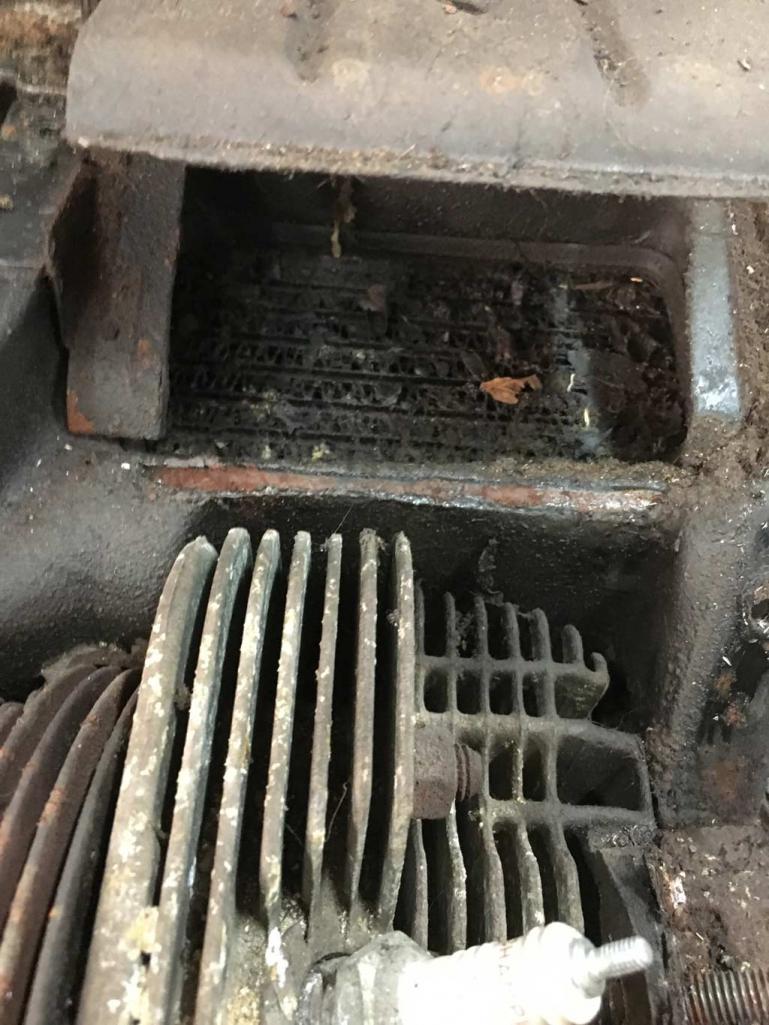

RolinkHaus   Could the oil cooler internally have build up or b...   Sep 27 2019, 07:29 PM
Superhawk996   @914Sixer 1st we need to make sure you have the ...   Sep 28 2019, 03:29 AM
IronHillRestorations   Find a friend with a non contact IR thermometer to...   Sep 28 2019, 07:43 AM
