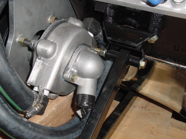

1. Per Scott's instructions, I rotated the water pump to point the 1 1/4' inlet outward but now locates one of the 1" fittings under the head, not like in their online instruction picture. Why is mine "special"?

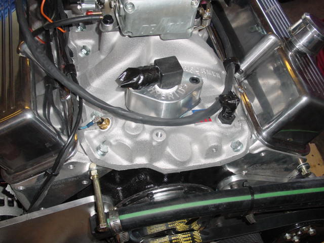

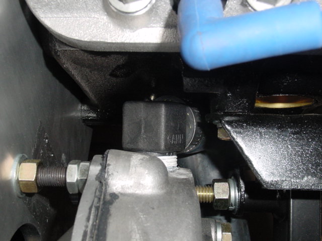

2. that hose inlet to xbar is CLOSE...

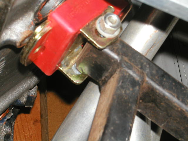

3. My slick Polyurethane engine mounts are "short", you might be able to see the bottom bolt is ~1/4" from the engine boss. Hope the guys at Speed Merchant will exchange these purchased months ago...

Felix, this is going to sound too easy but, the 1.25 inlet can turn around without having to turn the WP. Remove the WP and install it the way you need it and turn just the inlet around.

The problem is it only rotates 180 degrees because RH uses a tstat housing... I can point it up or down. (IMG:http://www.914world.com/bbs2/html/emoticons/screwy.gif)
My Simpson fitting screwed in so you could position 360 degrees...

My concern is the short hose has to make virtually a right angle to the outlet under the head.

For that t-stat housing check Summit Racing's site. There are a dozen options including one that pivots to any angle and some that have 0 degrees of rise. I am sure you can get a fit.

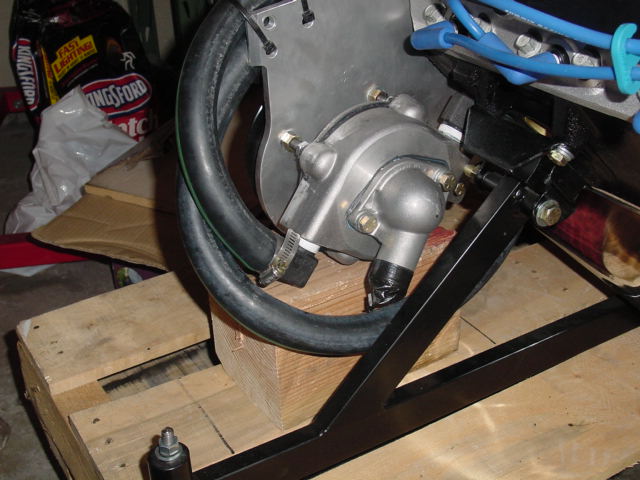

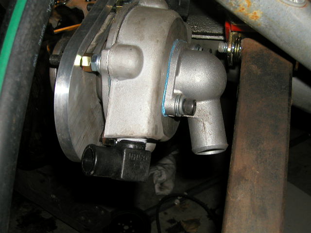

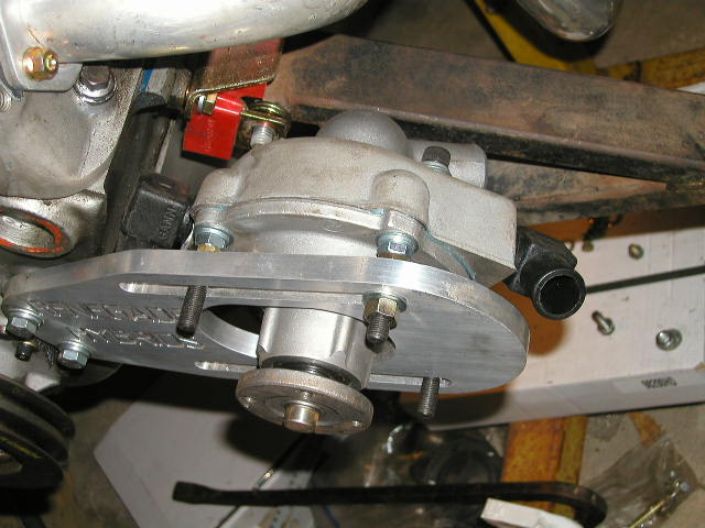

Felix,
Here's a few shots of my RH setup from the RH "factory". You can clearly see the hose is kinked and will need straightening. Also, the last shot shows how close to the block the bend goes.
Bill P.
nine14cats
post Jul 3 2005, 04:49 PM
Bill Pickering -- 914-6 GT aka....Leeloo
Posts: 2,618
Joined: 10-February 03
From: Campbell, CA
Member No.: 287
water pump
nine14cats
Posts: 2,618
From: Campbell, CA
Member No.: 287
#2
nine14cats
post Jul 3 2005, 04:50 PM
Posts: 2,618
From: Campbell, CA
Member No.: 287
water pump #3
nine14cats
Posts: 2,618
From: Campbell, CA
Member No.: 287
WP#4
neo914-6
post Jul 3 2005, 05:05 PM
neo life
Posts: 5,086
Joined: 16-January 03
From: Willow Glen (San Jose)
Member No.: 159
Bill, that hose goes ~300 degrees around the pump! (IMG:http://www.914world.com/bbs2/html/emoticons/blink.gif) I may try to find some tstat housings at Summit...
BTW, let me know if you need sketches of graphics you are thinking of for your race car...
neo914-6
post Jul 3 2005, 05:08 PM
neo life
Posts: 5,086
Member No.: 159
I'm liking AN fittings like on Chris' car...
nine14cats
Posts: 2,618
From: Campbell, CA
Member No.: 287
I asked Mike about the routing of the hose. He said it is to minimize kinks with soft radius bends.
Let me know what you come up with on the t-stat housings.....
I'm gonna go stare at the hoses again.... (IMG:http://www.914world.com/bbs2/html/emoticons/blink.gif)
Bill P.
