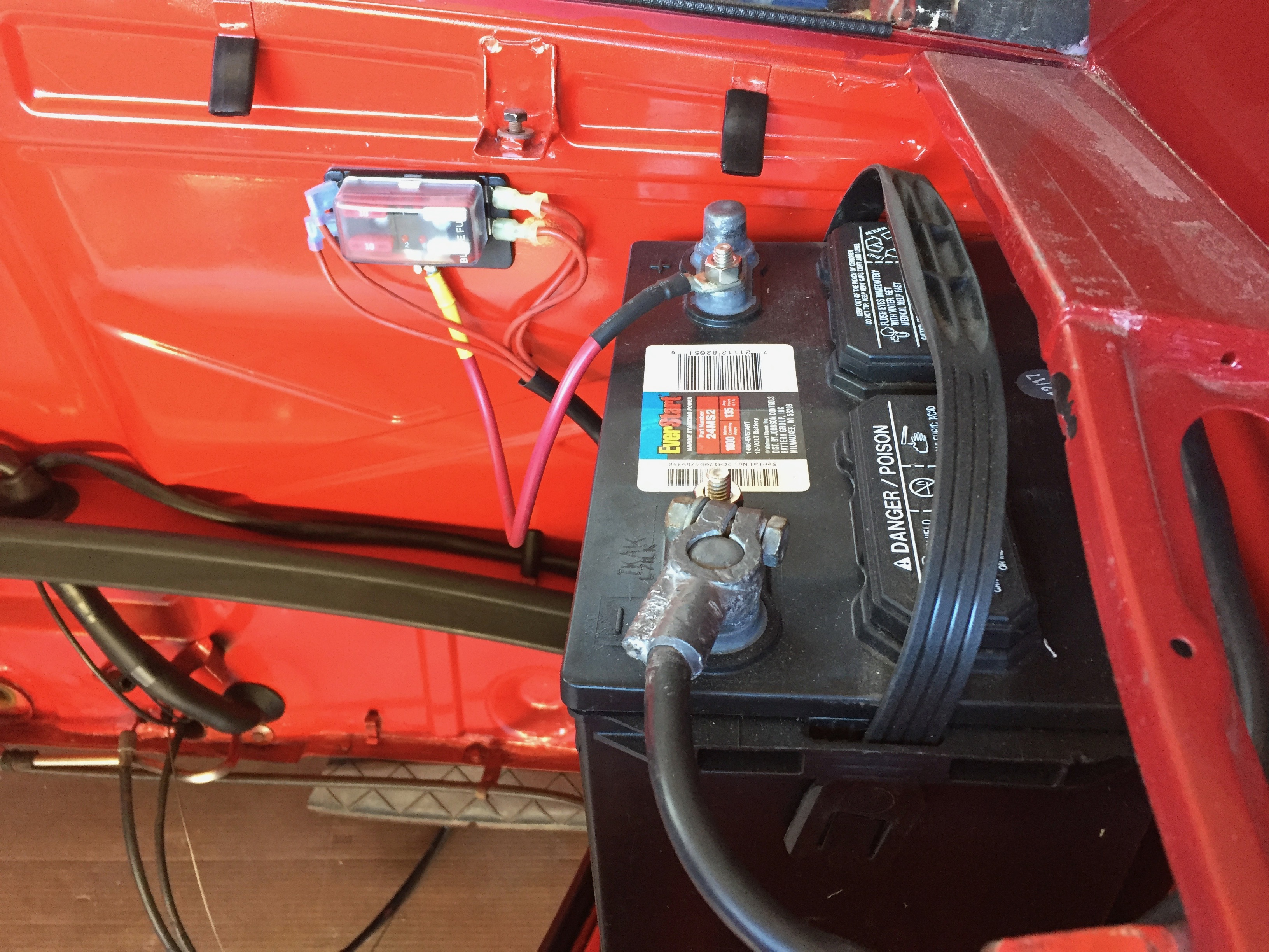

barefoot
post Jan 4 2020, 07:29 AM
Posts: 1,538
Joined: 19-March 13
From: Charleston SC
Member No.: 15,673
QUOTE(Costa05 @ Jan 3 2020, 10:43 PM) *
If you are a bit detail obsessed like me, I found that brake cleaner, hard nylon brush, then a soapy water can clean up a tired existing harness pretty well. Rewrap it with new cloth tape from HD.
Also I would add new fuse terminal block to the four main high amp feed wires (10 ga. red) coming off your battery terminal block. I think the stock setup is a bit under designed in my opinion (mine was) Cheap easy insurance.
Agree here, I had to install a new to me main harness & was afraid of a short somewhere.
here's my new fuze box.

Costa05
post Jan 4 2020, 08:58 PM
Posts: 320
Joined: 27-October 16
From: Phoenix, Arizona
Member No.: 20,535
QUOTE(barefoot @ Jan 4 2020, 08:29 AM) *
Exactly. That is a clean install.
