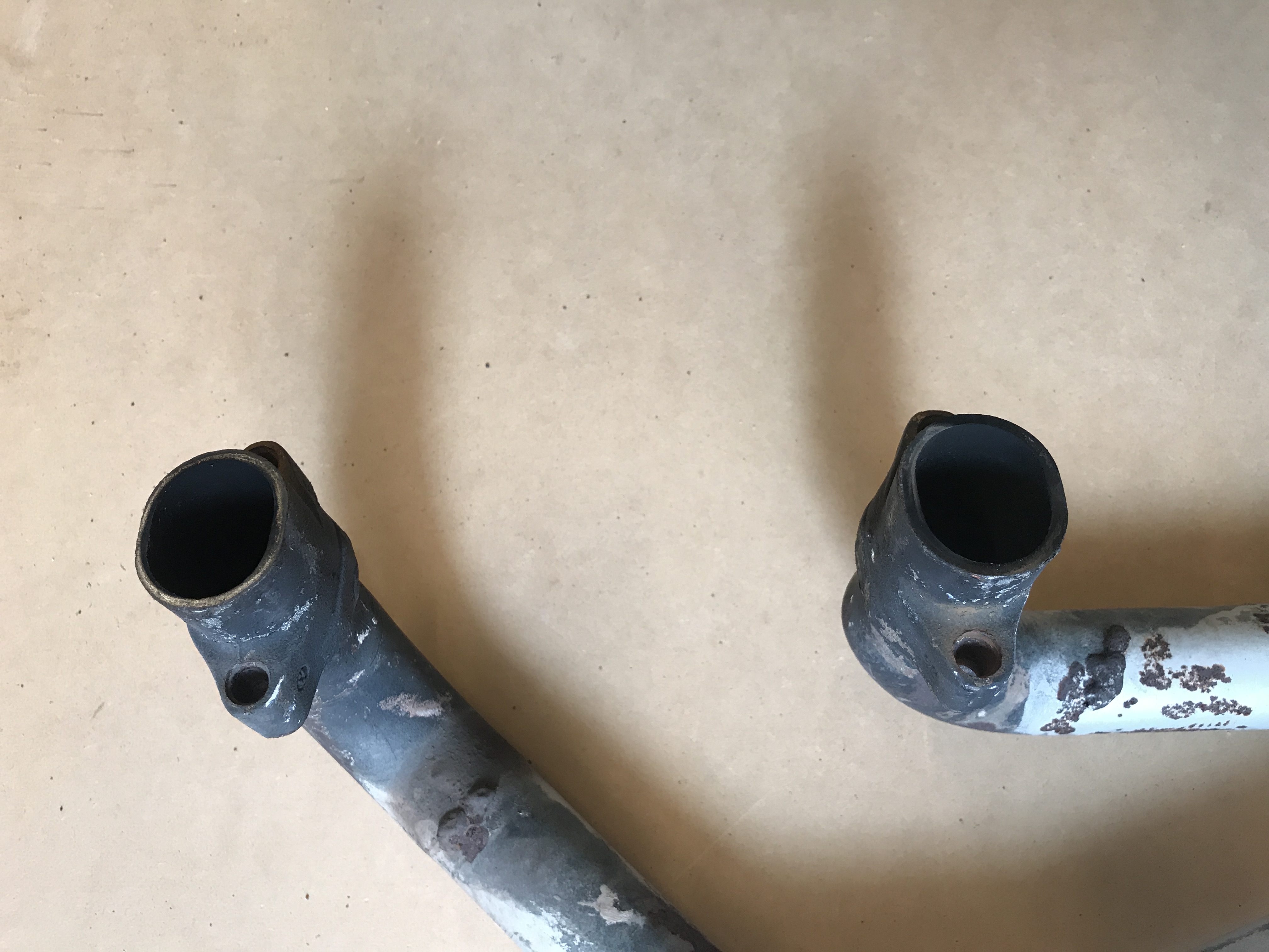

Car didn’t pass inspection because of an exhaust leak.
So... Just ordered some manifold gaskets from Pelican Parts.
Question is.
Is this copper soft out of the box, or does it need to be annealed before install?
Thanks for sharing your experiences.

I've never had to do any prep to the gaskets. Just put them in. Check the head surface to make sure its clean doesn't have any erosion, and you can run a flat file over the ends of the exhaust to make sure they're flat before bolting them up.

Perhaps not ... but it sure would never hurt.
The gaskets are press stamped from cold rolled copper.
As mentioned put a long file along the mating surfaces so that the 2 ports are level and flush.
Use a torch and get them red hot. The difference is significant.

I’ve had brand new ones leak
With annealing I’ve never had a leak
Make sure you run a fine on the mounting face before installing

Sorry. There are no HE’s, just some pipes.
But will anneal the gaskets when they come in.

Did anneal the gaskets.
It makes a huge difference. Not sure why not everyone is doing this.
After fixing the leak on the driver side a leak appeared on the passenger side.
To find out that the threats were stripped. In one spot the PO had installed an Allenbolt instead of the stud. This bolt engaged no more then 1/4”.
A Helicoil tool is on order to correct this problem.
Question: can I expect this Helicoil to take the torque needed to seal the exhaust manifold? Just asking because the Helicoils are not as long as the original threaded hole.
Lots of threads here showing people doing this repair, just didn’t find the confirmation that it’s strong enough.
