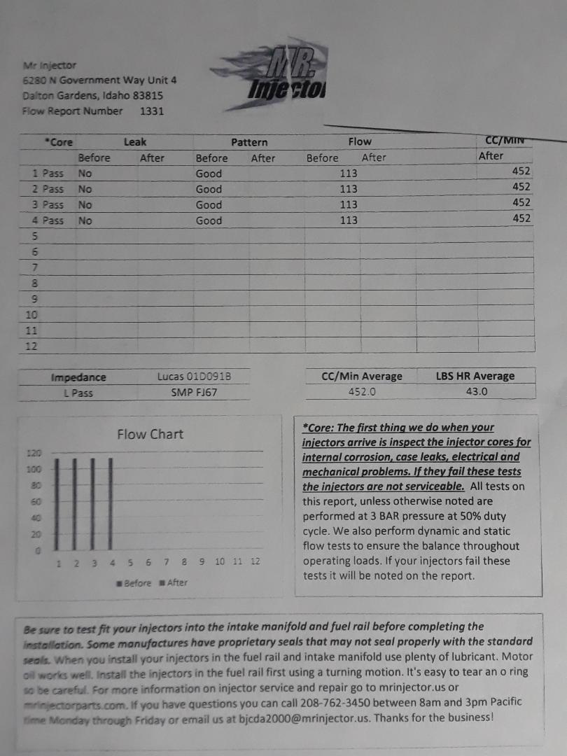

So I went ahead and bought a set of Intermotor FJ67 injectors, which should be an aftermarket replacement for the stock 2.0 injectors. Based on a great suggestion from @GregAmy I'm sending these off today to Mr. injector.
He said he would gladly flow test the set so that we have some baseline #'s. I think that there are already some flow test #'s for these injectors floating around this site, but I figured why not get some real #'s on an entire set...if nothing else, just to see the consistency between the 4. Anyhow, I'll post the results when I get them back.
Included a few pics.
Craigers17
post Apr 2 2020, 04:50 PM
Posts: 917
Joined: 5-August 17
From: Rome, GA
Member No.: 21,317
Just to follow up, I sent the new injectors to Bill Johnson of Mr. Injector, and I have included his email response to me following his flow tests of said injectors. It is as follows:
"Hi Craig,
Your injectors have been tested. They are a good match for the 914 2.0. They have consistent flow rates (around 440cc to 460cc depending on dynamic vs static testing) that I see with the Bosch 280 150 019 and 280 150 038 injectors that are original equipment. These injectors are built by Lucas and are an excellent product. I have never seen one with an electrical problem or case leak and the dynamic performance is always spot on. There will be a full flow report in the package.
It's getting difficult to find the OEM injectors that are good enough to accept a service so it's nice to find a good replacement to keep these old cars on the road. "
BTW, he received these injectors from me yesterday, and already has them tested and back in the mail to me today. Awesome service! Thanks to @BeatNavy & @GregAmy for suggesting that I turn to Bill for injector servicing. Great Guy!
That said, I will post the full flow report when I receive it with the injectors. For those much smarter than me on this website, (insert pretty much everyone's name here), I'm sure the actual flow reports will have much more data to analyze.

Flow Test Report:

Brief Follow-up on the FJ-67 injectors. I have installed these and they are working great. The only thing I noticed was that it seemed to me that the tip of the FJ-67 injector is a little more "snub-nosed" than stock and, thus, doesn't seem to protrude into the intake quite as far. That said, it seems to seal up well, with no issues.
Finally, I also sent 4 of the stock Green injectors to Mr. Injector for service. They were the Bosch P/N that ends in 019 mentioned previously. Only 2 were serviceable, but I just got them back with the flow report. I thought it was worth including that report to compare apples to apples. You can view the other report a few posts previous to this one. Here's the report:
