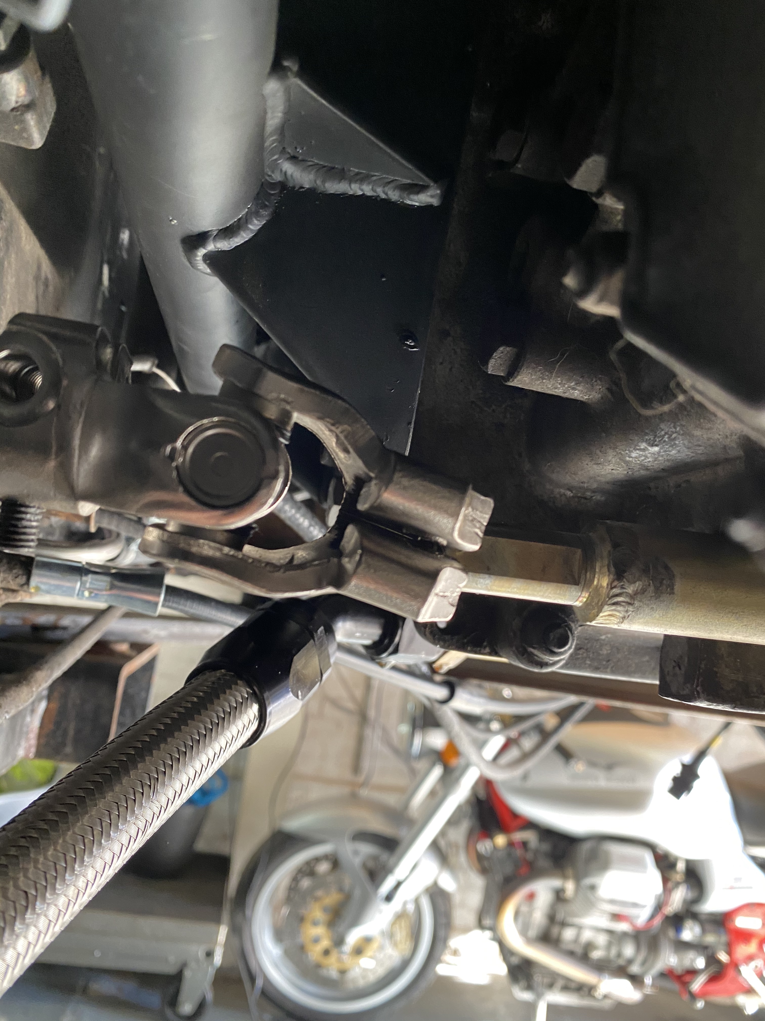

So... the engine is in (I’m using the NaroEscape -6 front mount) and, seeming because of the mount, it sits lower than stock. The Patrick Motorsport -6 shift linkage rod I intended on using, wont work. It interferes with the engine case and doesn’t seem to have a workaround. If the engine were 1/4” - 1/2” higher at the firewall, it looks like it would slip in, but alas, the engine is not going anywhere, lol.
I’m tempted to just bend the PMS bar end upward (maybe a couple inches from where it goes from the narrow shank to the bar rod) to give it the clearance but that would change the angle it goes into the rear bushing and connects to the shift lever... so I figured I’d ask if anyone else had an issue with the bar hitting the engine case and any options I might have. I’m OK with modding the old -4 rod too. Might be worth a shot but figured I’d ask here first.
The other threads I found look like the stock rod modded is the move.
Thanks
RichAttached Image

I would call James Patrick on Monday. He had to bend my previously installed PMS bar when i had Bens exhaust setup installed.

You will have to bend it in 2 place otherwise you will get binding @ the gearbox connection,are you tail or side shift? ,my engine was the same being too low,it appeared the repop factory bulkhead mount was welded in the right place but something wasn't right with the engine mount so I cut and rewelded it.
The whole issue if the engine is perfectly positioned in the enginebay its makes it very hard to remove because of the tinware which is hard to remove (in situ) and is in the way.
I don't remember of hand how much I moved it upward but I did found the engine was more horizontal in the opening instead of being nose down if that makes sence,the rear "breast plate tin " fitted better in to the rubber seal also so I knew I was close to correct.
I build a custom shifter set up from the crappy rear rod the PO supplied and ditched the factory alloy coupler,now running 2 uni-joints and a double metal bush console.
Lots of measuring cutting ,adjusting ,machining and pulling it apart many times (IMG:style_emoticons/default/headbang.gif) but it works very well....huge improvement.
Good luck.

Good job I also built my own shift rod, this is the best set-up for the 914 side shiftier.
Chris at tangerine can hook you up with this shift rod set-up.
http://www.tangerineracing.com/transmission.htm
Rich the rod you have can be modified to work. (IMG:style_emoticons/default/sawzall-smiley.gif) (IMG:style_emoticons/default/smash.gif) (IMG:style_emoticons/default/welder.gif) (IMG:style_emoticons/default/idea.gif) (IMG:style_emoticons/default/smash.gif) (IMG:style_emoticons/default/welder.gif)

My conversion side shifter mechanism was a straight shot, no bends. I made it from scratch and used an Apex helicopter joint. Also made my own nylon bushing rear slider in a lathe. Ben's heater boxes were not in the way.
Your mount must be pretty low.

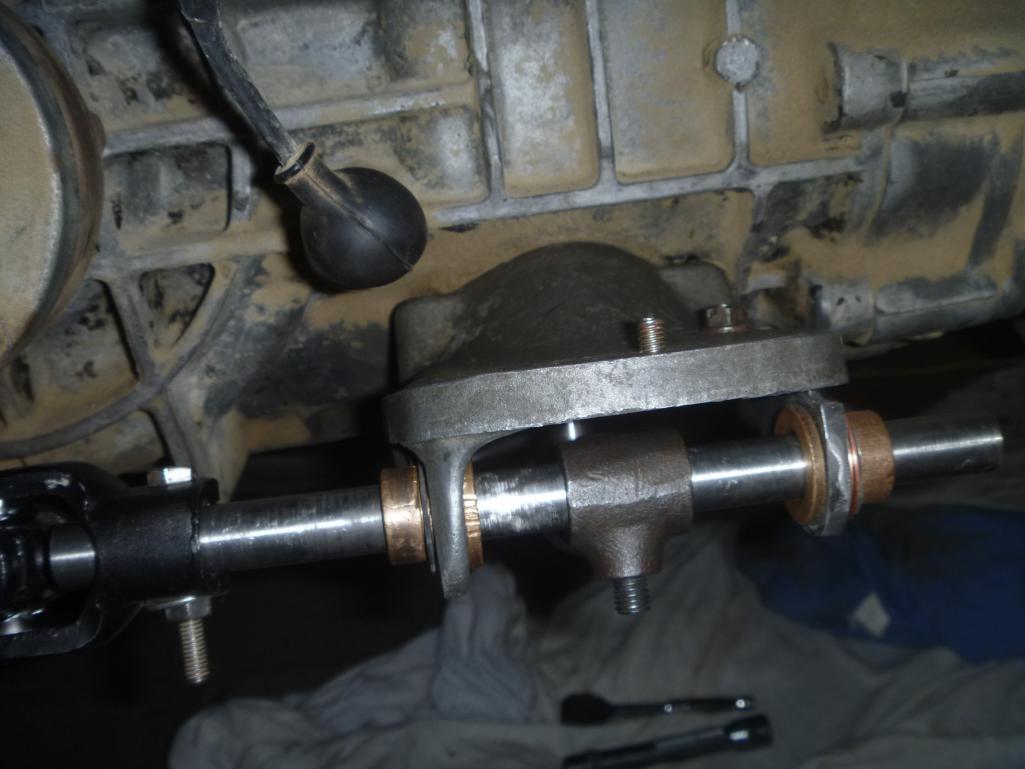

Retroracer
post May 11 2020, 10:04 PM
Posts: 669
Joined: 7-July 13
From: Bend OR
Member No.: 16,100
I purchased the PMS shift rod for my -6 conversion; side shifter and Maddog motor mount. I had a minor clearance issue with it rubbing the engine casing, with the mount welded as per guidance.
I could see from how the engine tin aligned with the apron surround - the rubber seal was not sitting correctly- that the engine was (maybe) 5mm too low in the chassis. It looked as though if I raised the engine slightly then both issues would be helped. I made up some shims to go under the 911 sport mounts from 6mm material; and that did the trick. Not sure if your mount allows the same hack...
So - my advice would be to double check the engine is sitting at approx. the right height, before modifying the linkage?
- Tony

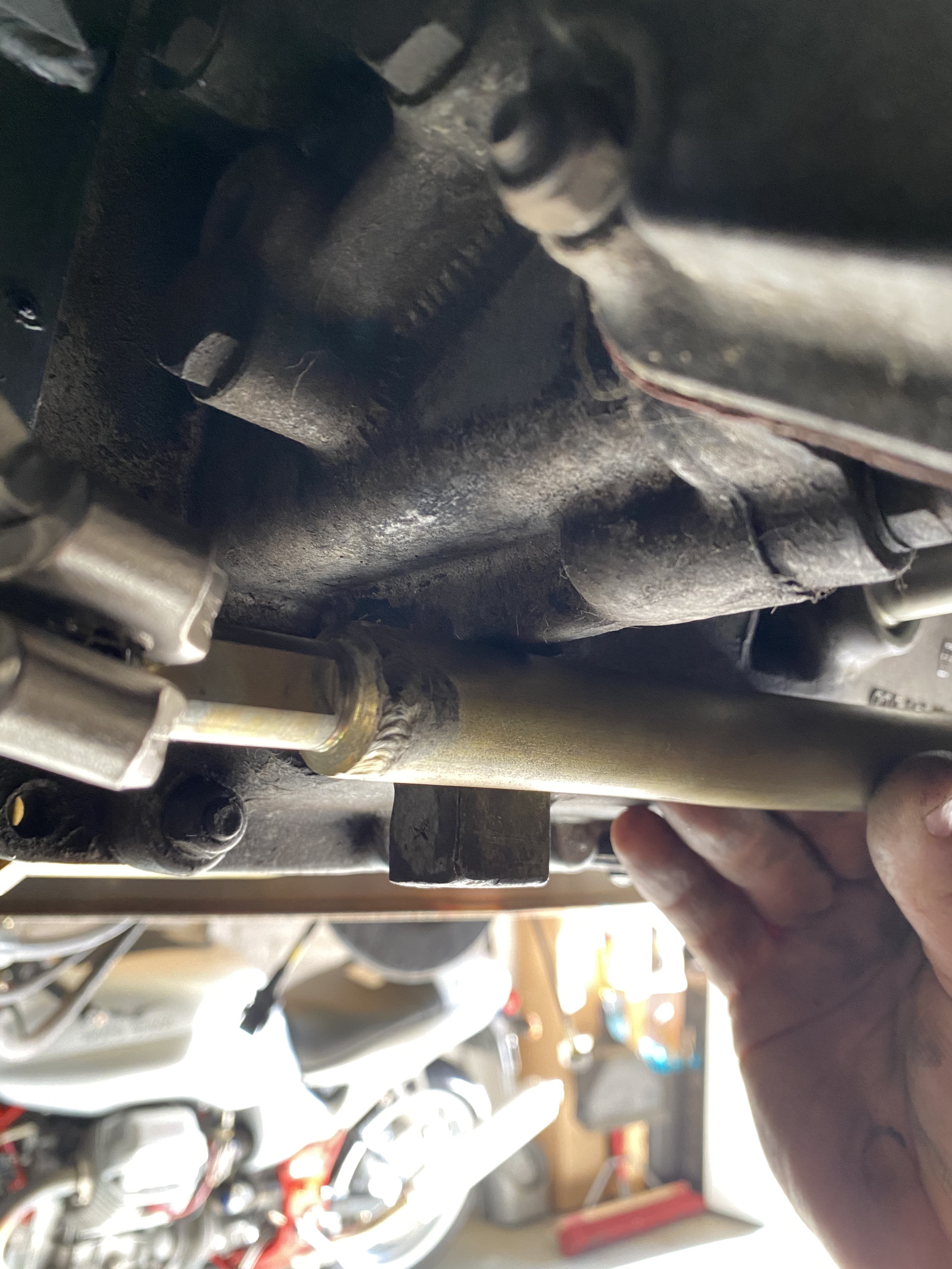

Thanks everyone. Just getting back around to this issue now. Had I known the engine was going to cause shift rod interference sitting as low as it does, I would have asked Translog to weld it in 3/4" higher. I welded it exactly where they say to weld it. It looks exactly like that blue pic above.
The rod only moved back/forth and rotates so I'm not dealing with any side clearance issues with the heat exchanger box... just the bottom of the engine case. I think I can "notch" it where it will go under the case, back up and straight into the side shifter guide without any funky geometry.
-Rich

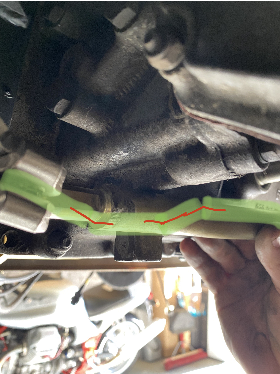

Maybe something like this...

I had the same issue with a conversion I did for a customer. I had to cut the bare half way through in 2 spots about 3 inches apart. Then I welded a flat plate in to reinforce. This allowed me to clear the case just enough.

This looks to be a pretty straight forward modification to the rod. @mb911 Is welding the mount 3/4" higher and option or will this cause other interference or geometry problems with the driveline, tin, "levelness" angle etc...???

I would highly recommend it .. I personally have now gone to suggestions of using either the Rich Johnson mount or the maddog OEM style to eliminate this issue. The heater valves are also an issue that has to be worked around with the Naro mount.

I’m using my oem rod but rotated it so it clears the engine and Ben’s HEs. I had new holes drilled for the pins on both ends. If you’re going that way be sure to drill them correctly. It’s not just a hole, it bevels back so the pin seats properly. A machine shop will have the right drill to do this. The fox hangs down a bit and I plan to cut it and add a straight section one of these days.
