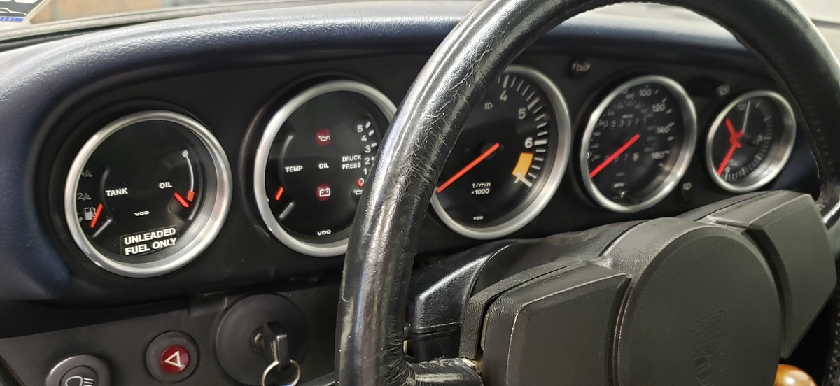

Thanks for the info. I'm mostly interested about the center console gauges. Especially the rings which holds the glass.
I'm in the process to have some trim rings done, and need to figure out if the center console gauges would use the same trim ring as the late model, like my 76.
This is what the rings look in the 911. So the rings for Tach and speedo would work for the early 914, however, I'm not sure about the 3 small gauges.
(IMG:http://www.914world.com/bbs2/uploads_offsite/carmagic.us-12404-1590146355.1.jpg)
Thanks

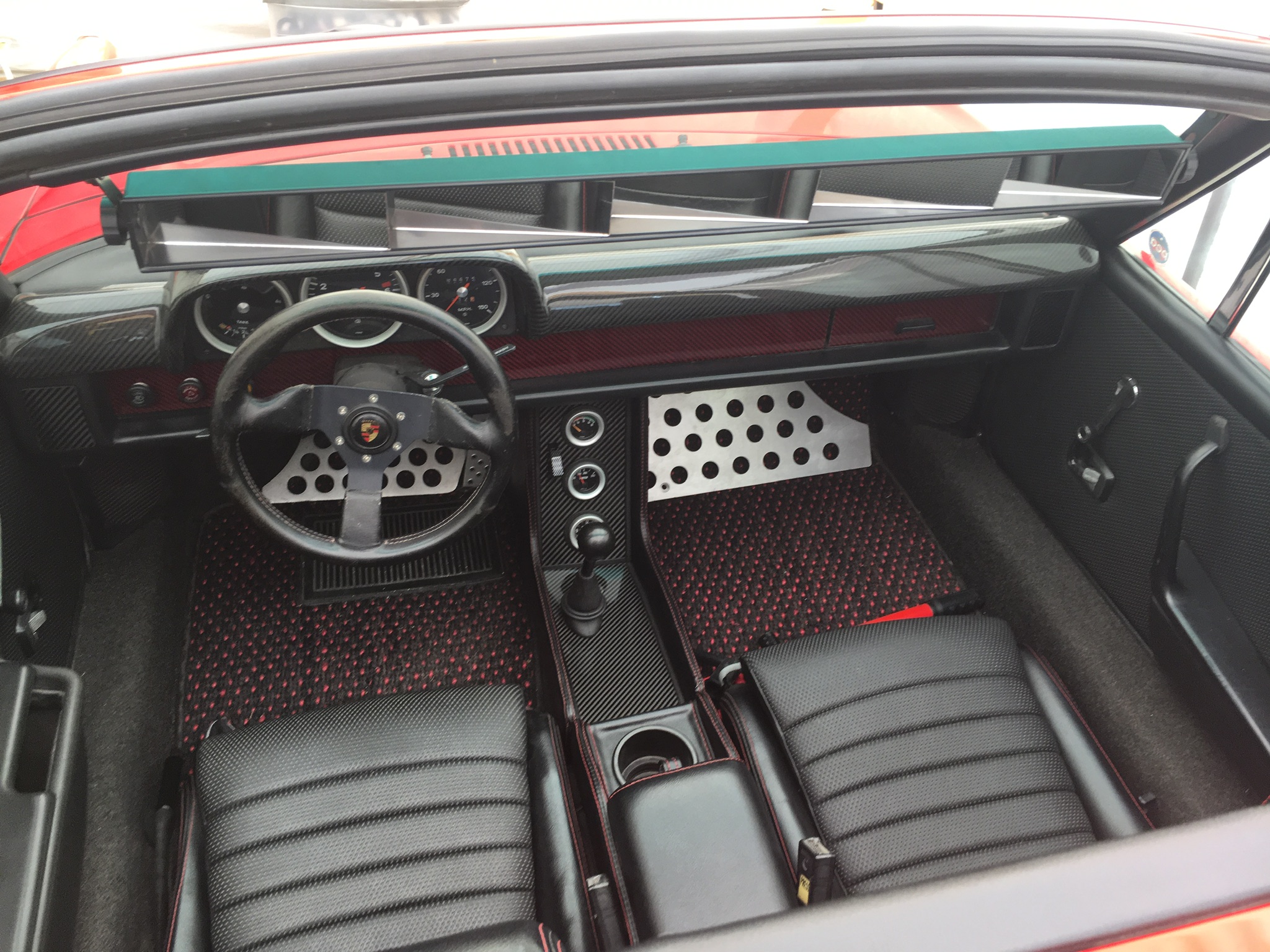

Attached Image Here’s what I did ..I got the gauges from Bruce stone. The aluminum bezels from summit racing to match dash bezels that I got from camp 914 .Used small piece of 2 in pvc pipe to fit.
Blue6
post May 22 2020, 10:34 AM
Posts: 1,057
Joined: 3-October 13
From: SoCal
Member No.: 16,470
QUOTE(sb914 @ May 22 2020, 09:22 AM) *
Eddy, that interior looks fantastic. The rings and especially that carbon fiber dash pad..... (IMG:style_emoticons/default/first.gif)
