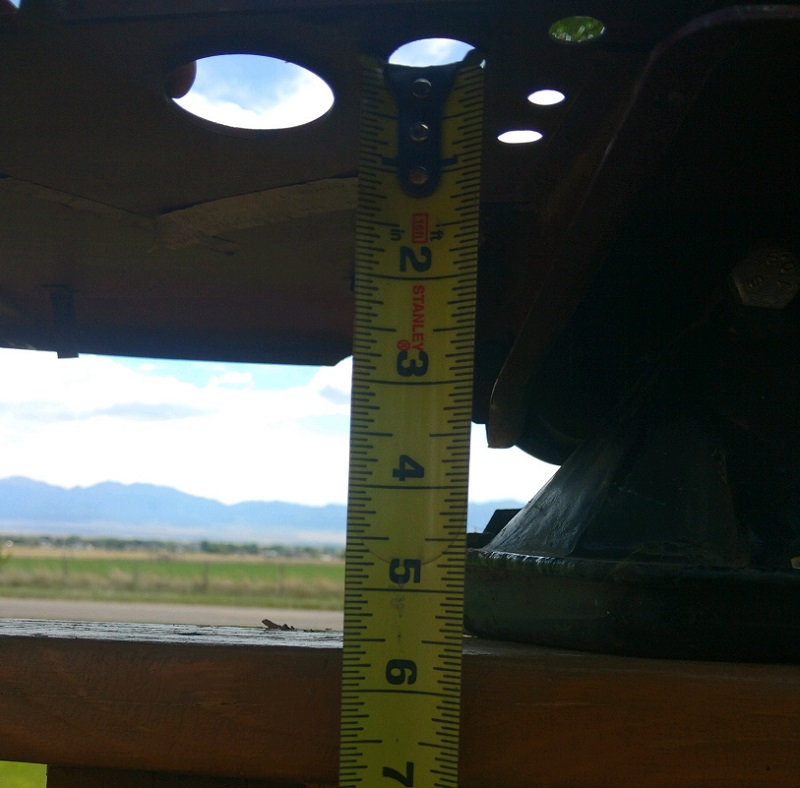

First pic shows the Distance form Firewall to Engine mount Surface.

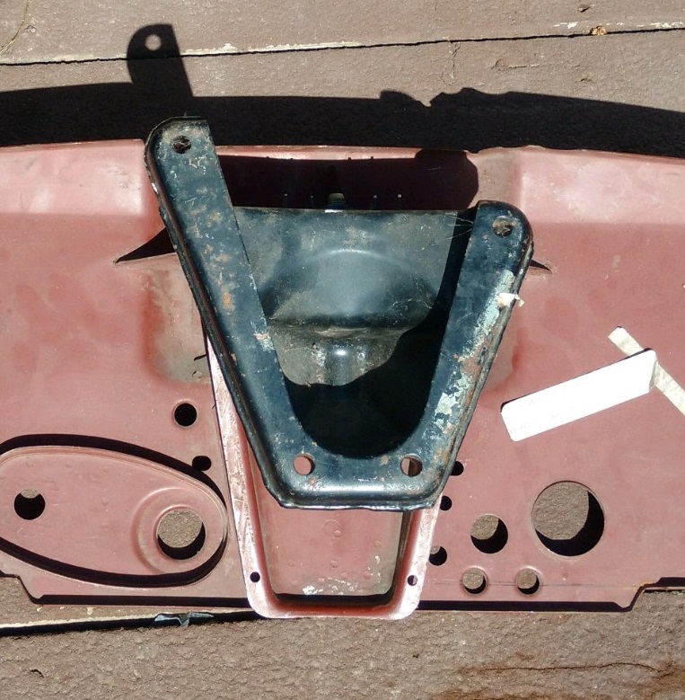

Second pic show the drop in the center of the firewall..

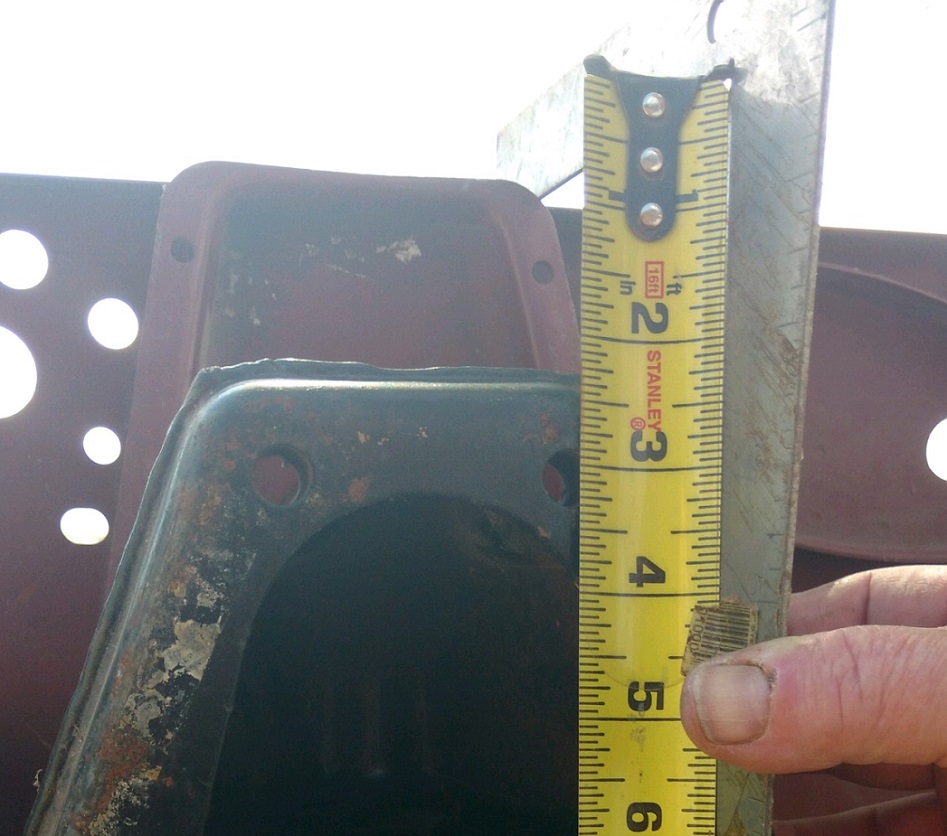

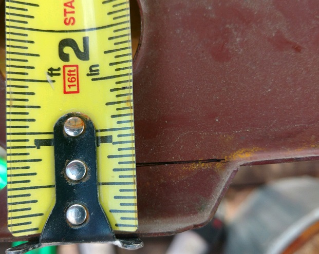

Third pic shows Distance from bottom of drop to bottom hole in mount.

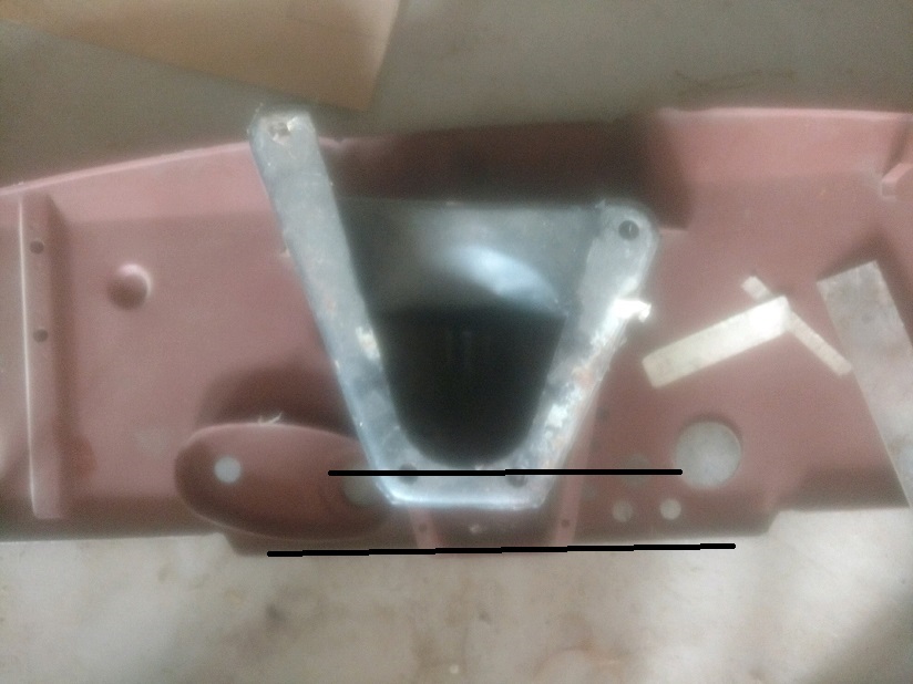

Final pic 6 mount
